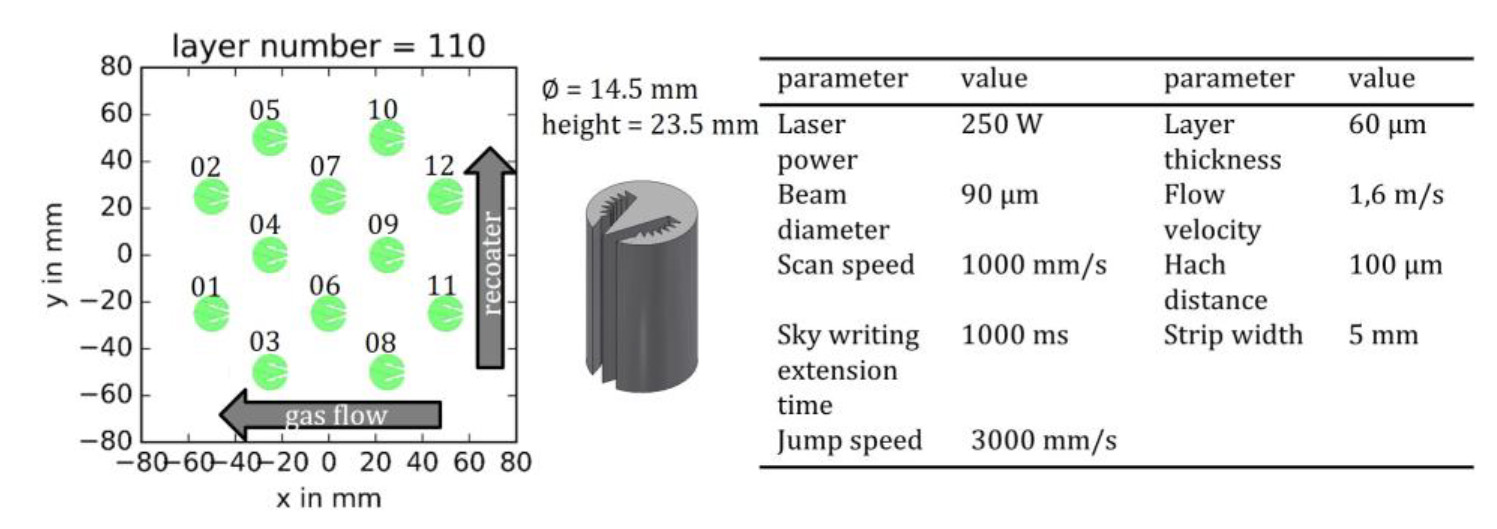

Two models will be developed that enable the prediction of thermal emission. To evaluate the accuracy of the prediction and to calculate the emissivity, test specimens are built and the resulting thermal emission is measured via an on-axis pyrometer. The specimens are cylindrical with triangles in the center (see Figure 1), resulting in areas with small vector lengths.
Figure 1: Specimen arrangement, specimen geometry and process parameters.
The samples are manufactured on an L-PBF machine AconityMIDI (Aconity3D GmbH, Germany, Herzogenrath). The AconityMIDI is equipped with a 1,200W AFX-1000 laser (nLIGHT, United States, Washington). The samples are made from 1.4404 powder “m4p™ 316l” (m4p material solutions GmbH, Austria, Feistritz i. R.) with an average grain size of 45 µm. The thermal radiation generated in the process is detected in the wavelength range from 2.0 µm to 2.2 µm with a measuring frequency of 100 kHz using a customized non-linearized KG 740-LO pyrometer (Kleiber Infrared GmbH, Unterwellenborn, Germany). Due to the lack of linearization, the emissivity set on the pyrometer corresponds to a division of the measurement signal by the emissivity. To maximize the measurement signal, the emissivity is set to 0.1, which corresponds to the minimum adjustable emissivity.
The build platform is preheated to a temperature of 100°C to produce the test specimens. The process parameters used for production are listed in Figure 1. The samples are exposed in sequence (part 1 to 12) against the inert gas flow in order to reduce the influence of spatter. A meandering stripe hatching is used as the exposure strategy, which is rotated by 33° layer by layer. Vector directions with an angle of less than 45° to the shielding gas flow are omitted in order to reduce the interaction of the laser beam with the metal vapor, cf. [14].

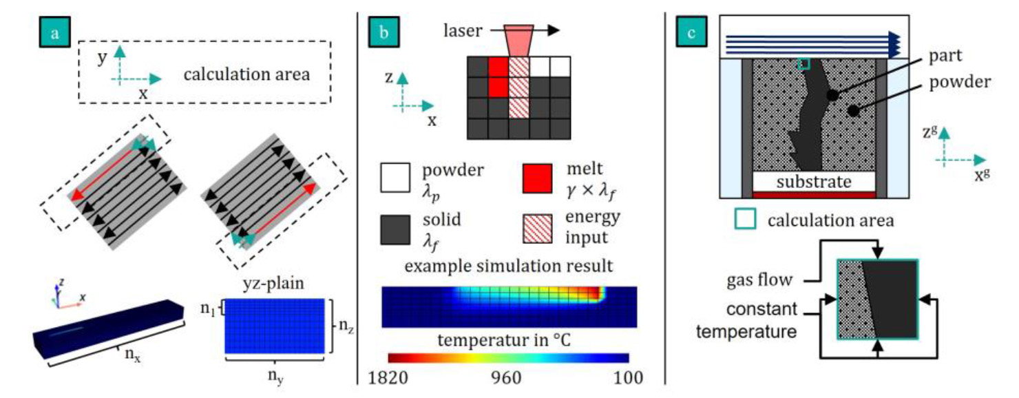

For the thermal simulation, a model is developed that only considers the environment of an exposure vector. This approach makes it possible to map pre-heating effects due to the exposure strategy while keeping the numerical effort to a minimum. The model is programmed in Python and is based on the finite difference method.
Figure 2a shows an example of the calculation area for different vectors. The simulated scan vector is shown in red. The size of the calculation area depends on the length of the exposure vector. The origin of the calculation area is always at the starting point of the exposure vector, while the exposure direction is the X-axis of the calculation area. This means the calculation area rotates relative to the part depending on the orientation of the exposure vector. The advantage of the described calculation area is that the meshing only has to be carried out once, as the meshed grid is only shifted or rotated. A structured grid with different element sizes in the Z-direction is used for meshing.
Figure 2a shows that, in the area of the laser-material interaction, the mesh is finest in the Z-direction (element height = layer thickness). From a given number (n1) of elements, the element size in the Z-direction is doubled. The number of elements in the Z-direction is nz = 12. The element size is doubled after n1 = 6. The element size in the X- or Y-direction corresponds to the track spacing (100 µm). This corresponds to the largest possible element size for mapping the exposure vectors. The number of elements in the Y-direction is ny = 21, and the number of elements in the X-direction is determined by the length of the longest exposure vector of a layer to be simulated and a specified edge distance of seven elements.
Figure 2: (a) mesh and calculation area (b) modeling of the heat source (c) boundary conditions.
The part layers of the part to be simulated are simulated independently of each other, i.e. preheating by already exposed layers is neglected. To simulate a layer, the vector information is loaded from a CLI (common layer interface) file. The element state (powder or solid) is also assigned based on the CLI file. When starting the simulation of a layer, the temperature of all elements is set to the preheating temperature (see Section 2). As a boundary condition, it is assumed that the global part temperature corresponds to the preheating temperature, so that the side surfaces and the bottom surface of the calculation area are set to the preheating temperature as a constant boundary condition (see Figure 2c).
The upper surface of the calculation area borders on the shielding gas flow. In order to map the shielding gas flow in the simulation, the mean heat-transfer coefficient with forced convection is calculated for a longitudinally flowing flat plate with laminar boundary layer according to [15]. It is assumed the shield gas has a temperature of 60°C, and the characteristic length l is equal to the diameter of the substrate plate (170 mm).
The calculation of the material values is based on references [15-21]. Due to the melt pool dynamics, which cannot be represented by the purely thermal simulation, more heat is dissipated from the melt pool (cf. [22]). In order to take the influence of Marangoni convection into account in the thermal simulation, the thermal conductivity within the melt can be artificially increased by a correction factor γ = 3 [23] (cf. [8]). In the simulation model, the enthalpy of melting is neglected for the purpose of simplifying the model. However, this can be incorporated into the specific heat capacity in subsequent investigations. The thermal conductivity of the powder λp is calculated according to the equation by Meredith and Tobias [24]. To calculate the thermal conductivity of the powder, the volume ratio ϕ of solid to gas is estimated at 70%.
The specific heat capacity cg and the density ρ of the powder are calculated from the volume ratio of the solid and gas properties. To map the energy input by the laser, a cuboid volume with a constant heat flow is used as the heat source, cf. [25]. The power density W is calculated according to W = Plμl/2Δzsnw with the laser power Pl, the absorption coefficient μl, the track spacing h, the layer thickness Δzs and the number of elements nw. The number of elements nw represents the depth of the melt pool in the Z-direction. The energy input takes place in nw elements in the Z-direction. Figure 2b shows the heat source for nw = 3 and the simulated temperature of an exposure vector in a cutaway drawing. The elements where the energy input occurs are shaded. The absorption coefficient is assumed to be 60% and indicates the proportion of the laser power that is absorbed by the molten pool, cf. [25].

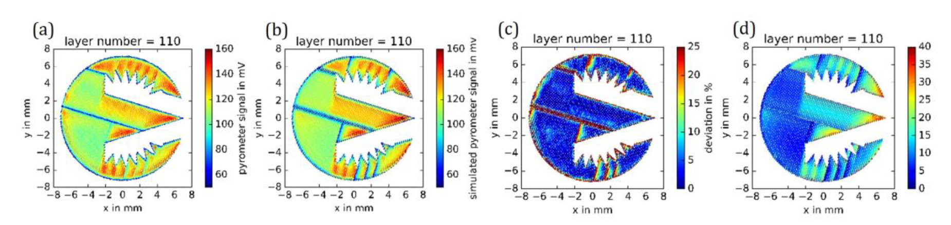

The averaged measured thermal emission signal for an exemplary layer 110 is shown in Figure 3. The emissivities that lead to the smallest deviation between the predicted and measured signal are: εϕ<=1,000°C = 0.482 and εϕ>1000°C = 0.131. A comparison with values from the literature shows that, despite differing absolute values, the ratio is of a similar magnitude: εϕ=700°C, sandblasted = 0.7 and εϕ>1600°C, ϕ<1800°C = 0.28 [26]. The prediction of the thermal emission provides an accurate prediction with an average deviation of 4.5% (9.4 mV) for layers 100 to 150. The deviation is greatest at the edges of the stripes.
Figure 3: (a) measured thermal emission (b) simulated thermal emission (c) deviation (d) signal component of the neighboring vectors.
This deviation is probably due to the neglect of the pre-heating of already exposed strips. With each shift of the calculation area, the preheating temperature is assigned to the elements that lie outside the calculation area of the last time step. Particularly in the case of step vectors, this procedure means that local part overheating is no longer considered. Despite the existing deviation, the thermal simulation can map the preheating effects caused by the exposure strategy and enables a prediction of the thermal radiation generated in the process. Figure 3 shows the signal component caused by the thermal emission of neighboring vectors.
To calculate the proportion of neighboring vectors, the signal proportion of the area with a temperature below 1,000°C is evaluated in a simplified manner. The signal component increases to approx. 35%, especially in the area of small vectors. The influence of neighboring, not yet completely cooled vectors on the measured thermal emission is possibly the reason for the observation that the porosity increases when using a closed-loop process control.
