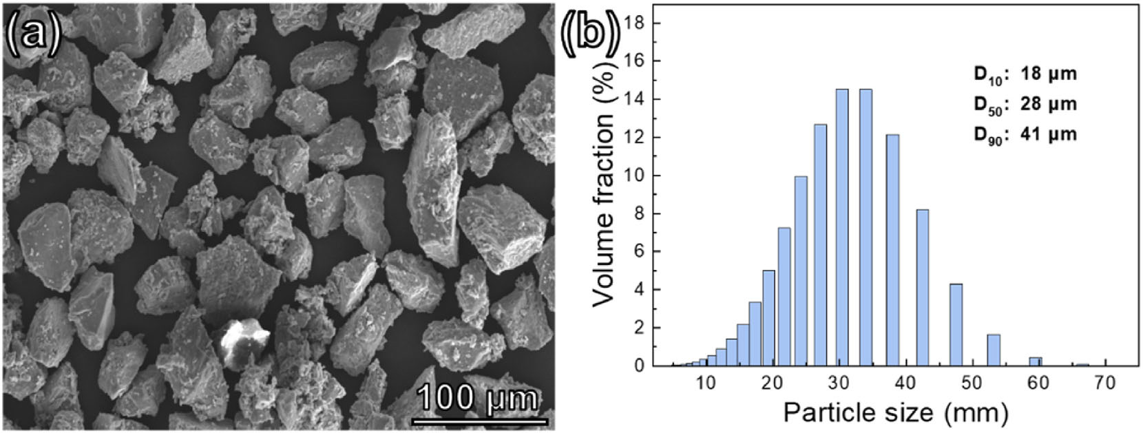

Figure 1: (a) SEM image and (b) size distribution of the commercial pure Ti powder.

Commercial pure Ti powder, sieved through a 325-mesh sieve, served as the raw materials. Figure 1 shows morphology (a) and particle size distribution (b) of the used commercial Ti powder in this work. The Ti powder exhibits irregular morphology with a size ranging from 15 to 60 µm. Notably, the absence of satellite powder and agglomerations contributes to enhanced deposition efficiency superior deposit quality.

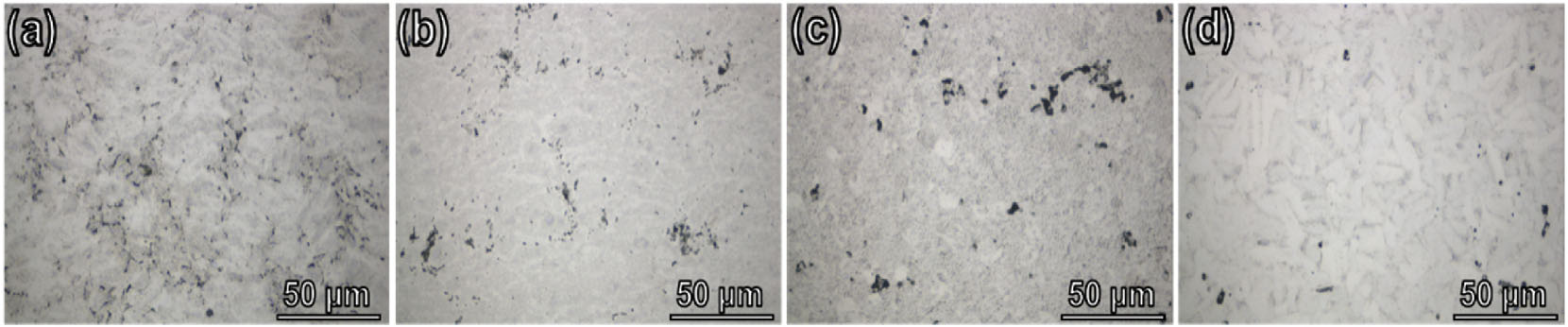

Figure 2: Metallograph of CSAM Ti at various conditions: (a) CS-Ti; (b) CS-Ti-600; (c) CS-Ti-800; (d)CS-Ti-1000.

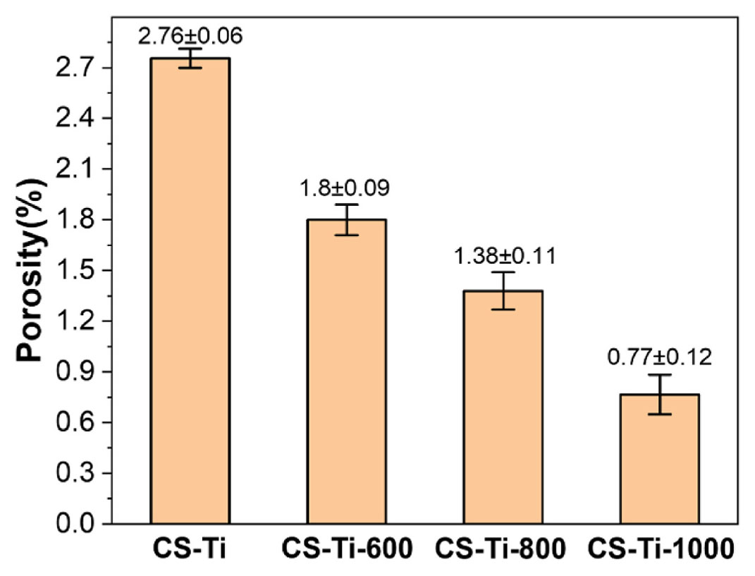

Figure 3: Porosity of CSAM Ti at different conditions.

Figure 2 shows the metallographic structure of CSAM Ti at various conditions. As it shown in Figure 2a, tightly bonded Ti particles with a wavy pattern are evident, a result of cumulative particle deformation during spraying. Numerous black pores at particle boundary sites originate from inadequate particle deformation. The porosity of CS-Ti is measured at 2.76% according to Figure 3. After the annealing treatment at 600°C, the metallograph of Figure 2a reveals cleaner and more distinct particle boundary outlines, accompanied by the disappearance of select micropores. Nonetheless, the deformed particle boundary features persist.
Elevating the annealing temperature to 800°C leads to the vanishment of these boundary characteristics, as depicted in Figure 2c, where the emergence of equiaxed grains signifies recrystallization. Meanwhile, the porosity further reduces to 1.38%, leaving predominantly larger pores. Further increasing the annealing temperature to 1,000°C induces substantial grain growth and a porosity reduction to 0.77%. Notably, pores assume an elliptical morphology, indicative of extensive solid-state diffusion facilitating the healing of smaller pores and the transformation of larger ones into quasi-spherical shapes to minimize surface energy.

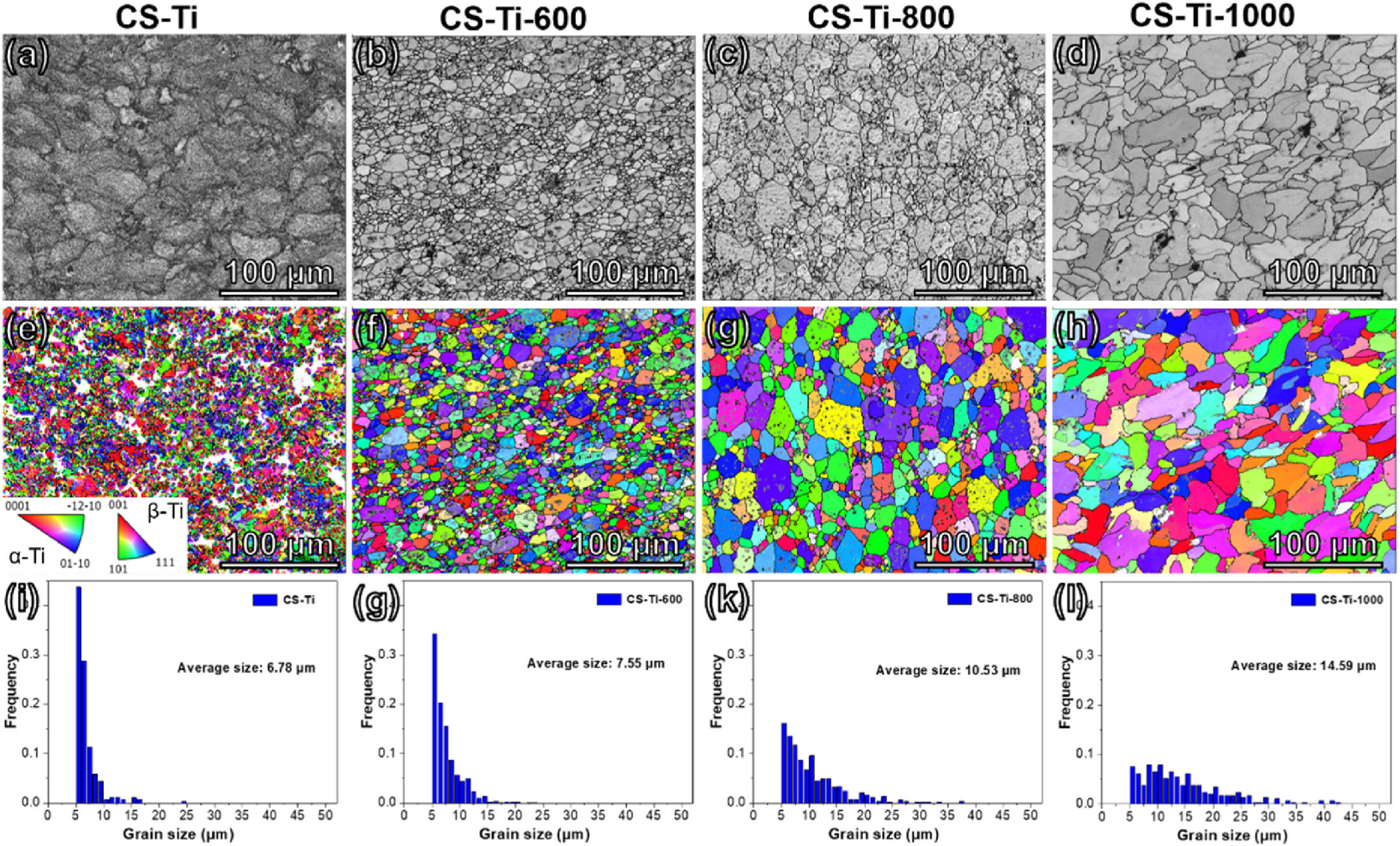

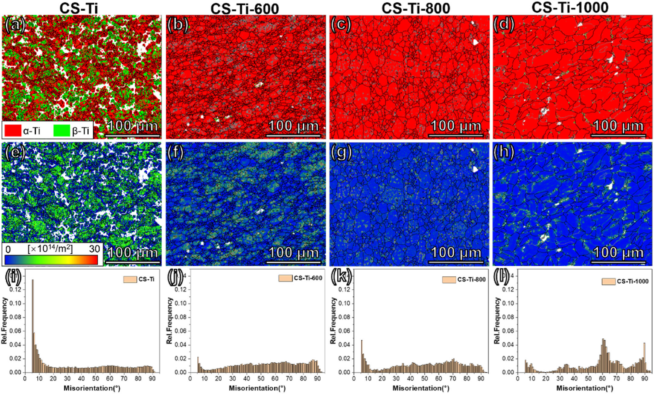

Figure 4 presents the band contrast (BC) maps, inverse pole figure (IPF) maps, and grain size distributions of cold sprayed Ti (CS-Ti) under different conditions. Severe plastic deformation during the cold spraying process induces significant residual stresses within the CS-Ti, particularly at particle boundaries, resulting in a low resolution in EBSD analysis. Despite this, the reconstructed BC map clearly shows deformed Ti particles (Figure 4a). The IPF map reveals fine grains around particle boundaries with a few larger grains corresponding to undeformed particle cores (Figure 4e).
The grain size distribution indicates that approximately 90% of the grains are smaller than 7 µm (Figure 4i). After annealed at 600°C, tiny grains form around the cores of prior Ti particles, creating a satellite ring around the large cores’ grains (Figure 4b-f). Compared with CS-Ti, the average grain size increased slightly from 6.78 µm to 7.55 µm (Figure 4i-g). Annealing at 800°C results in complete recrystallization, with all particles growing uniformly (Figure 4c). The average grain size increased to 10.53 µm (Figure 4k). However, core and boundary grains remain distinguishable.
Figure 4: BC maps (band contrast), IPF (inverse polo figure) maps, and grain size distribution curves of CSAM Ti at different conditions.
At 1,000°C, exceeding the β-Ti transformation temperature, the annealing process involves α♦β and β♦α phase transformations. The structure of CS-Ti-1000 is completely reconstructed, eliminating the cold spraying microstructure. The average grain size increased to 14.59 µm (Figure 4l), indicating accelerated grain growth at 1,000°C, suggesting that further increasing the annealing temperature is not advisable.
Figure 5a-d illustrate the phase maps of the samples at different conditions. The β-Ti contents for the four samples are 26.7%, 0.3%, 0, and 0.2% respectively. In CS-Ti, the β-Ti grains are small and arranged in a ring formation around the prior Ti particles. The β-Ti formation may be attributed to the severe deformation and localized temperature elevation during the impact moment. Consequently, during annealing at 600°C, most β-Ti transforms into stable α-Ti. By the time the annealing temperature reaches 800°C, β-Ti has already disappeared. The reappearance of a minor amount of β-Ti in the CS-Ti-1000 sample could be due to insufficiently slow cooling rate during annealing. Figure 5e-h shows the (geometrically necessary dislocation) GND maps of the samples.

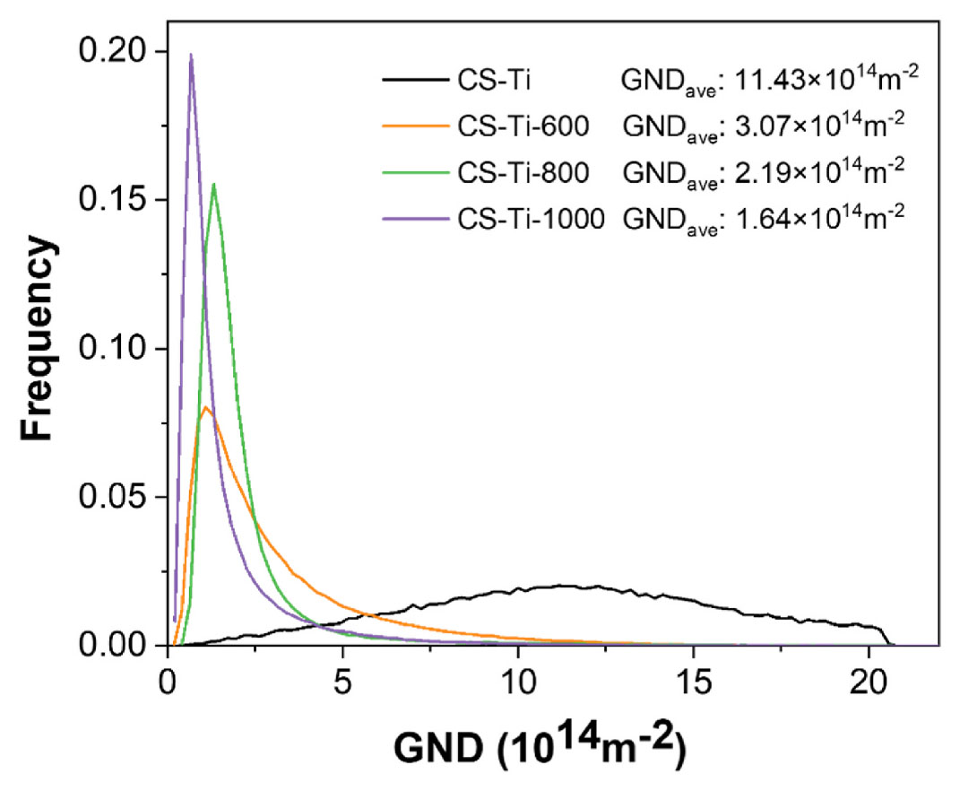

It is evident that the substantial amount of GNDs introduced during spraying were largely eliminated by 800°C annealing. As for the CS-Ti-1000, high-density GNDs sporadically distributed between grains correlate significantly with pore defects and newly formed β-Ti grains. Figure 6 shows the GND curves of CSAM Ti, clearly indicating that, as the annealing temperature gradually increases, the GND curve shifts toward lower values. The average GND value decreases from 11.4 ↔ 1014m-2 in CS-Ti to 1.64 ↔ 1014m-2 in CS-Ti-1000. The disorientation angle distribution in Figure 5i-l reveals some microstructure of the samples at different conditions. The high proportion of small angle disorientations in CS-Ti indicates its internal structure predominantly consists of deformed grains. As the annealing temperature rises, the proportion of low angle disorientation significantly decreases. There are three peaks in the misorientation angles (9.48°, 60°, and 90°) of α-Ti-1000, which result from the Burgers Orientation [31].

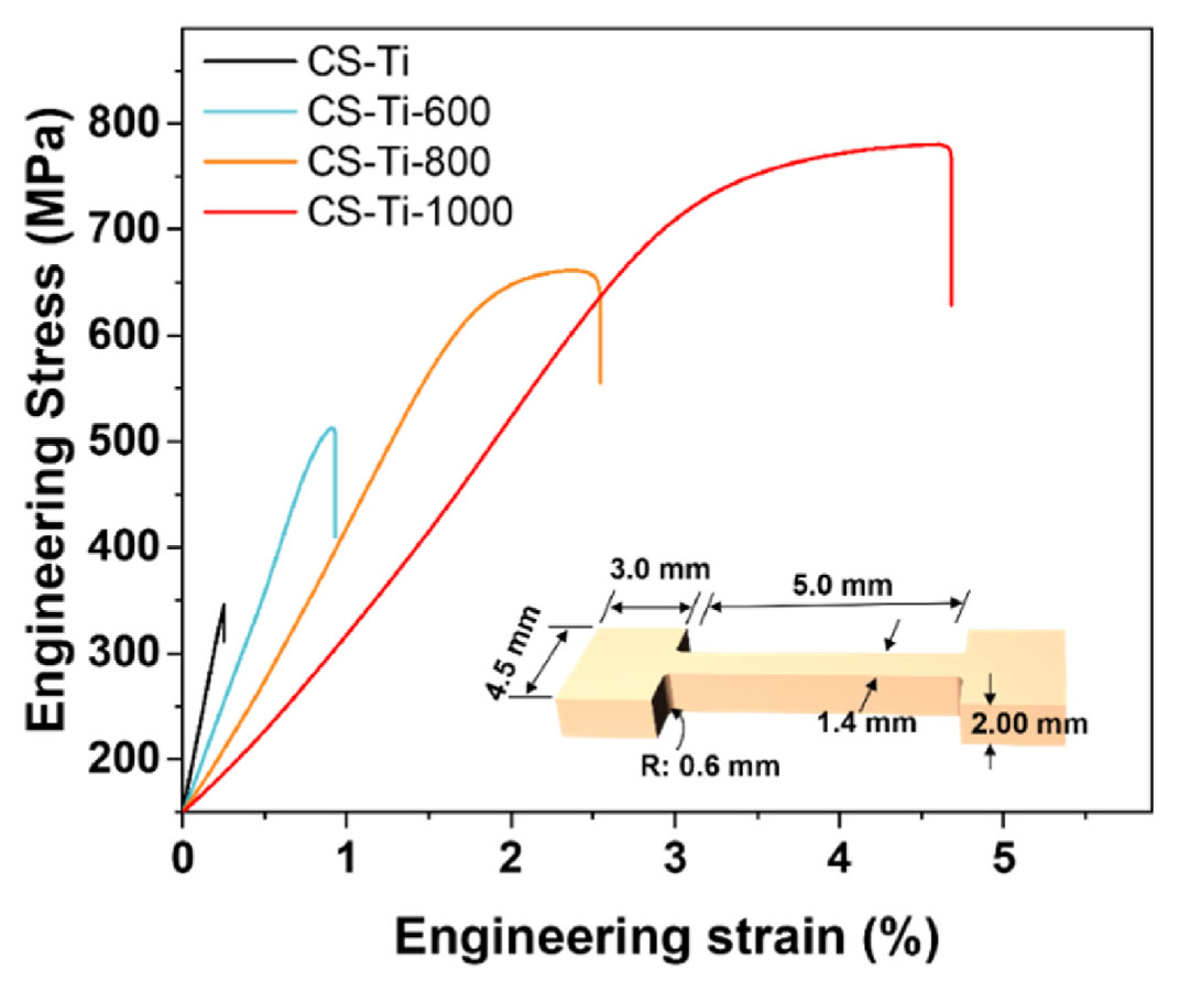

The engineering stress-strain curves of CSAM Ti at different condition is shown in Figure 7. Initially, the CS-Ti has a tensile strength of only 346 MPa and a minimal elongation of only 0.25%. Annealing at 600°C enhances the tensile strength to 512 MPa and the elongation to 0.92%. Further annealing at 800°C raises the tensile strength to 661 MPa and elongation to 2.53%, while annealing at 1,000°C results in a tensile strength of 780 MPa and a significant elongation of 4.67%. These results indicate annealing substantially improves both the strength and ductility of CSAM-Ti, with tensile strength increasing by 125% and elongation by a factor of 17.68 post-annealing.
Figure 5: Phase maps, GND (geometrically necessary dislocation) maps and disorientation angle distribution of CSAM Ti at different conditions.
Comparatively, commercial pure Ti plate prepared by traditional rolling possess a tensile strength of 420 MPa and an elongation of 42% [30]. Although CS-Ti annealed at 1,000°C surpasses pure Ti in tensile strength, its elongation remains considerably lower, primarily due to intrinsic porosity within CSAM Ti. Despite the porosity being reduced to less than 1% in CS-Ti-1000, the presence of pores can still lead to premature failure during deformation. As depicted in Figure 8, there exists an inverse correlation between porosity and both tensile strength and elongation for CSAM Ti. The elimination of porosity through methods such as hot isostatic pressing or additional rolling could potentially augment its mechanical properties. Nonetheless, considering the economic viability and simplicity of a single heat treatment, with its elevated post-treatment strength, can feasibly substitute for wrought Ti in applications where extreme toughness is not a primary concern.

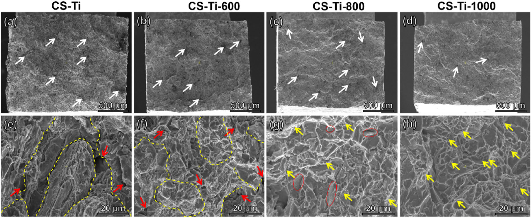

Figure 9 illustrates the fracture morphologies of CSAM Ti at different conditions after tensile test. A notable presence of pores is evident on the fracture surface of CS-Ti, as highlighted by the white arrow in Figure 9a. In the higher magnification fracture image, these pores can be seen more clearly as unbonded areas during cold spraying process (Figure 9e). Since the bonding mechanism of powder particles in cold spraying are primarily reliant on cold deformation and mechanical interlocking, it allows for the distinction of original titanium particle boundaries, outlined in yellow dotted lines in Figure 9e.
Figure 6: GND (geometrically necessary dislocation) curves of CSAM Ti at different conditions.
Persistent porosity is observed across the entire fracture surface of the CS-Ti-600 specimen. Nevertheless, an increase in surface roughness compared to CS-Ti signifies enhanced particle cohesion. While particle outlines remain discernible at sites indicated by yellow dotted lines in Figure 9f, evidence of intergranular cleavage fracture emerges, contributing to the improved tensile strength of this sample. In the overall fracture images of CS-Ti-800 and CS-Ti-1000 samples, some wavy tear marks are found, proving the improvement of toughness of the samples.
Specifically, CS-Ti-800 displays a mixed fracture mode characterized by shallow dimples (yellow arrows) alongside brittle fracture features like tear ridges (red ovals), suggesting a combination of ductile and brittle mechanisms. Conversely, CS-Ti-1000 showcases a dense array of uniform dimples, signifying superior plasticity among the tested samples. However, compared with the fine and dense deep dimples in the forged pure Ti, the dimples in CS-Ti-1000 are larger in size and shallower in depth, indicating its toughness is far from reaching the level of wrought pure Ti [32]. This is still a difficult problem that needs to be overcome in CSAM Ti.

Figure 7: Engineering stress-strain curves of CSAM Ti at different condition.

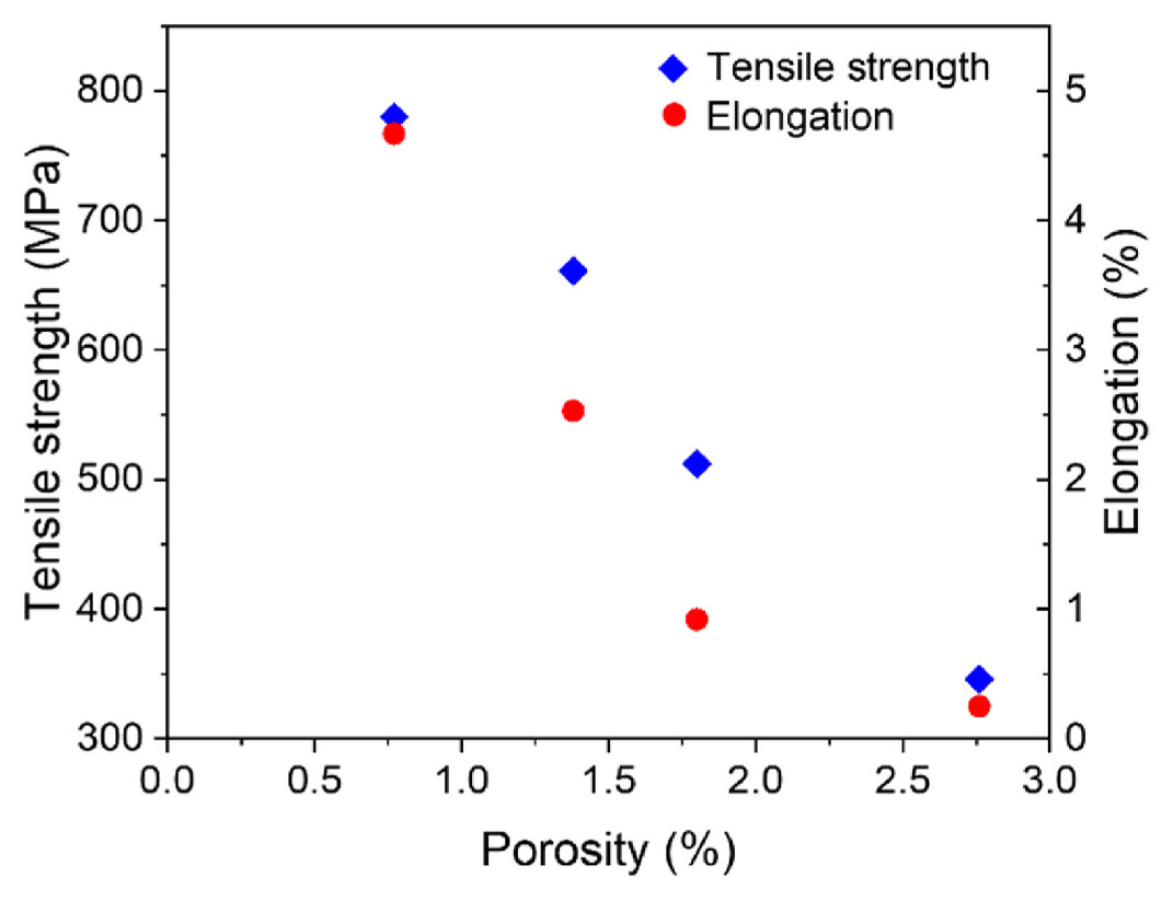

Figure 8: The relationship between porosity, tensile strength, and elongation.

(1) Porosity reduction: The primary source of porosity in CSAM Ti stems from inadequately deformed particles during the spraying process. Annealing facilitates atomic diffusion and recrystallization, leading to the disappearance of smaller pores and the elliptical transformation of larger ones. Notably, annealing at 1,000°C for 2 hours reduced the porosity to 0.77%.
(2) Microstructural evolution: Annealing at 600°C initiates recrystallization at the peripheries of original Ti particles. As the temperature rises to 800°C, full recrystallization is observed, subsequently giving way to grain growth. Following annealing at 1,000°C, the average grain size attains 14.59 µm.
(3) Mechanical properties enhancement: Annealing concurrently enhances the tensile strength and ductility of CSAM Ti. Specifically, post-annealing at 1,000°C yields a tensile strength of 780 MPa, surpassing that of wrought pure Ti, albeit with an elongation of merely 4.67%, significantly trailing that of its wrought counterpart.

Figure 9: Fracture morphology of CSAM Ti after tensile test at different condition.
