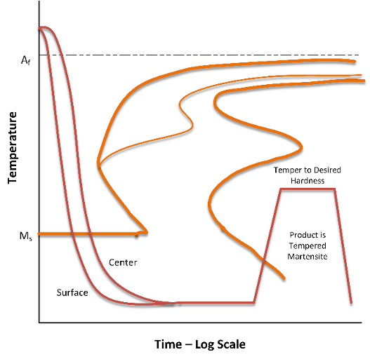

The most common method of hardening steel in industry today consists of heating the steel component to the austenitizing temperature, quenching in a suitable quenchant, and tempering to the desired hardness. This is shown schematically in Figure 1 [1].
In this example, the part is austenitized and then quenched in a quenchant fast enough that the surface and center of the part miss the “nose” of the TTT curve and are completely through hardened. The slowest possible quench to achieve through hardening corresponds to the quench rate enough to just miss the “nose” of the TTT curve. Slower quench rates than the minimum will result in the formation of non-martensitic transformation products of ferrite, pearlite, and bainite. It should be noted that the TTT curve has no bearing on the tempering reaction.
Figure 1: Schematic representing typical quench and tempering to a typical TTT curve.
For most applications, the austenitizing temperature is approximately 25-30°C above the Ac3 temperature. After properly soaking at temperature, the part is then quenched rapidly into brine, water, polymer, or oil. The quenchant is generally less than 80°C for oil, and at ambient temperature for the water-based quenchants (water, brine, and polymer). This rapid quenching ensures that the part meets hardness requirements but also creates a steep temperature gradient between the surface and the core. The result can be higher internal stress, more warpage, and a greater risk of quench cracking, especially in parts with abrupt section changes or tight tolerances

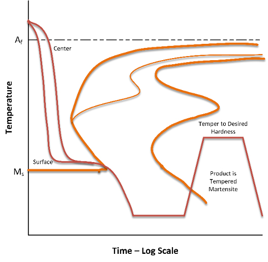

Martempering is a specialized process that should only be used when distortion and high residual stress are an issue. In this process, parts are quenched from the austenitizing temperature into hot oil or molten salt at the approximate martensite start temperature (100-200°C). The part is held at the oil temperature until the surface and center temperatures of the part are nearly the same. Once the center of the part has reached the quenchant temperature, the part is removed from the quenchant and allowed to cool in any convenient manner (usually air cooling). This minimizes the formation of thermal stresses due to unequal cooling between the center and surface (Figure 2) [1]. It also reduces the transformation stresses due to martensite transformation occurring at different times.
Figure 2: Schematic representation of martempering.
If complete hardening is to occur, the austenite must cool sufficiently fast to allow the center cooling rate to miss the “nose” of the TTT diagram. Since the TTT diagram shows the martensite start temperature, Ms, the TTT diagram is useful for selecting the optimal quenchant temperature and estimating the time the part must be held at temperature to prevent the formation of bainite.

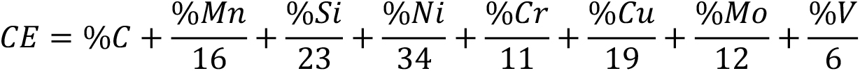

One criterion for the applicability of martempering is the tendency of a part to crack or distort. This is based on the carbon equivalent, or CE. The carbon equivalent is calculated in Equation 1 [6, 4, 1]:
Equation 1
Where concentrations are given in weight percent. In each case, quenching cracking was determined to be a problem if the carbon equivalent (CE) > 0.52%. If the carbon equivalent of the steel is greater than 0.50%, then the steel is a good candidate for martempering.
