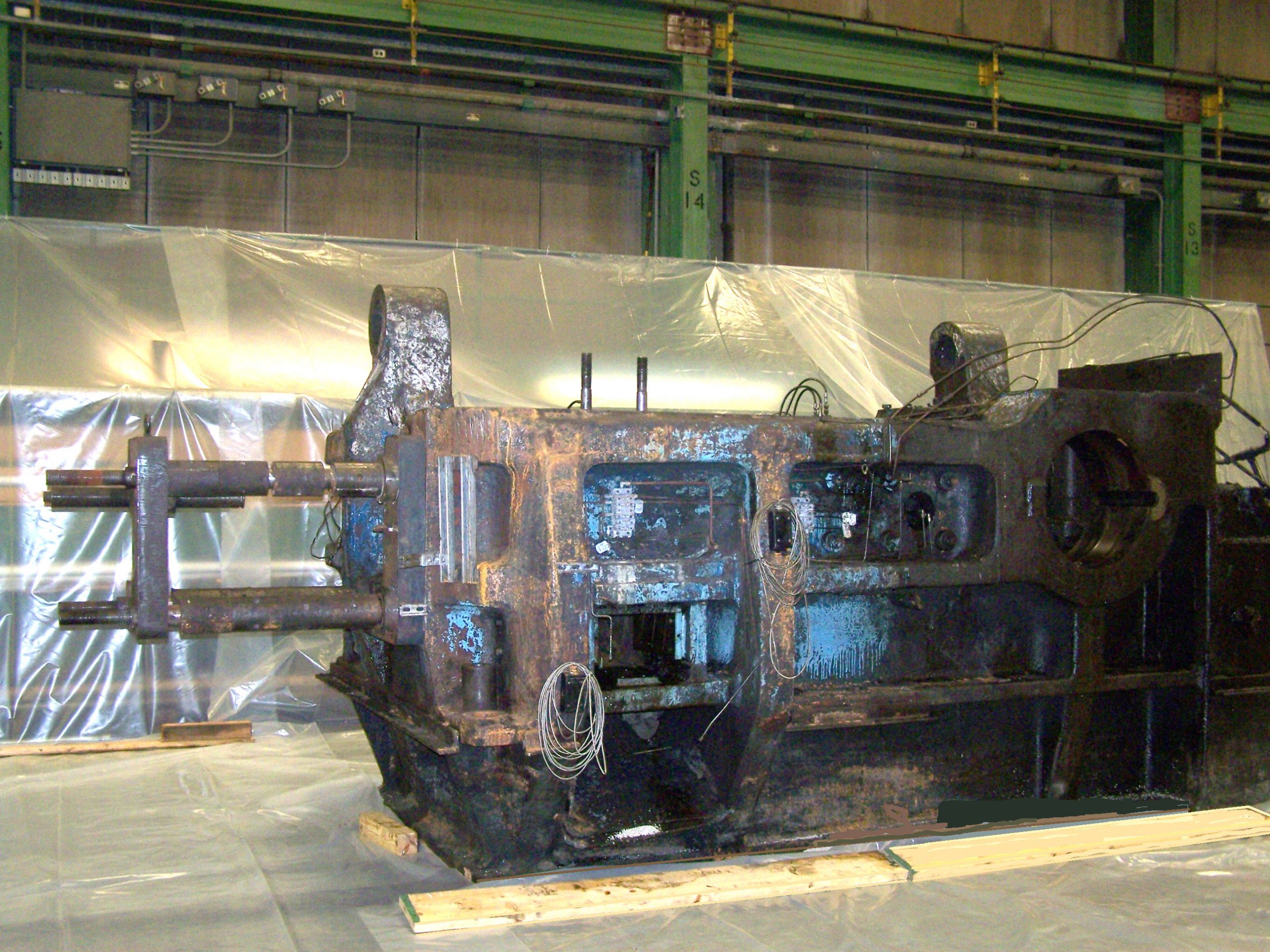

To meet this demand, forgers are modernizing existing equipment that in many cases is several decades old.
Modernizing a forging press often involves removing major machine components and repairing or replacing them with OEM parts to restore the equipment to its original manufacturer specifications.
Because the heavy-duty steel frames of many older forging presses remain structurally intact and continue to function after decades of service, modernization of a forging press is a relatively low-cost alternative to purchasing a completely new piece of equipment.
The ability to quickly move into production with upgrades is a major advantage, as opposed to purchasing a brand-new forging press, as the delivery and commissioning of a new press may take up to a year or longer. In addition, many modernization projects can be completed while the forging press remains stationary on site, reducing disruption.
Another benefit of upgrading an existing forging press is increasing its lifespan, enabling the machine to run dependably for many more years. A typical refurbishment will extend the production life of the forging press by 20 to 30 years.
In many cases, modernization can also result in performance improvements nearly equivalent to those obtained with a new machine. Modern digital controls, improved sensors, enhanced automation features, and modern hydraulic systems enable an older forging press to achieve better precision, greater efficiency, and higher reliability than the older configuration.

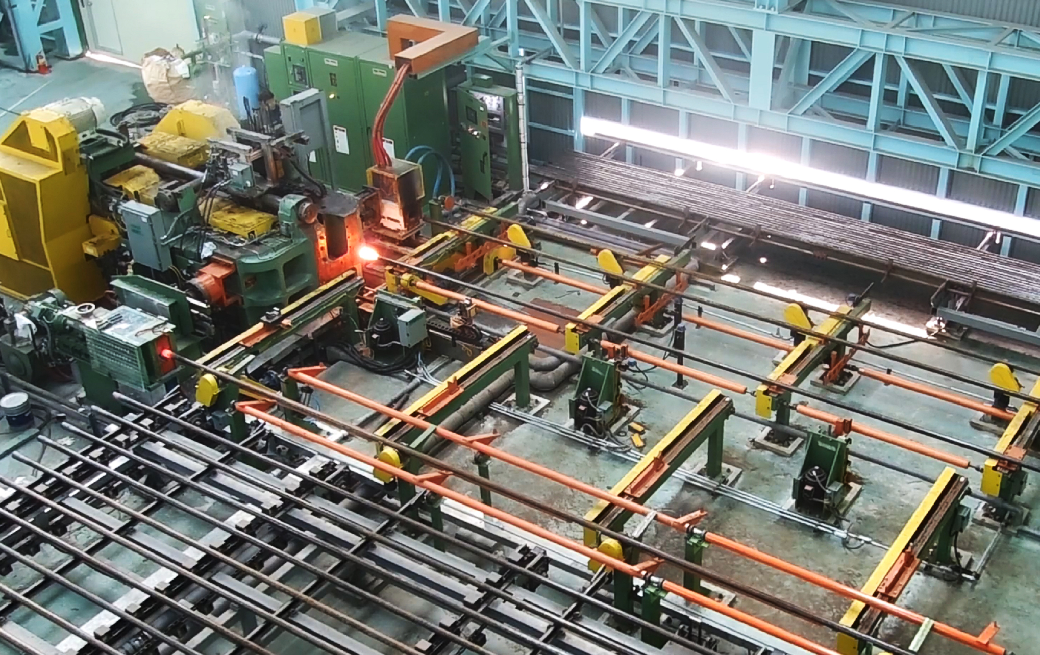

Automation and Material Handling
Automation is now one of the most common features in modernized forging lines. Many older presses relied heavily on manual handling of billets and forged parts, which limits production speed and exposes workers to high-temperature materials.
Today’s systems, like ones offered by Ajax-CECO-Erie Press, include automated manipulation systems, robotic billet and part handling systems, and transfer mechanisms that move parts between furnaces and presses. These automations improve consistency and increase productivity while reducing operator fatigue and safety risks.
By automating forging operations to perform some of the tasks of a human operator, productivity can increase from several hundred pieces per hour up to 3,000, depending on the type of products being forged.

Refurbishment of Ram and Mechanical Components
When a forging press is modernized, its mechanical components are often repaired or rebuilt at the same time because the ram, guide systems, and wear surfaces are subjected to extremely heavy loads during operation. This process may involve reboring the ram guides, replacing wear plates and gibs, repairing structural components, and installing improved lubrication systems.
Sourcing parts from the original OEM can offer advantages compared with having components reverse-engineered and produced by independent machine shops.
Machine shops often do not have access to critical specifications about high wear parts, including the material grade of the steel, the heat-treating process used, and tolerances — all of which were engineered specifically for that piece of equipment.
