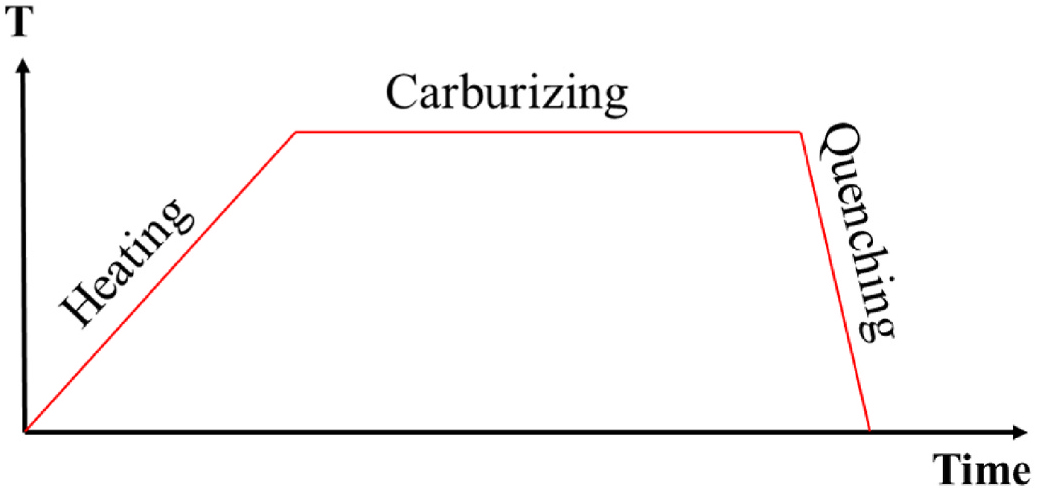

Figure 1: Temperature profile for the carburizing – quenching process [2].
The carburizing-quenching process takes place in three successive steps (see Figure 1), which can be repeated. The first step is the heating of the part in a carburizing furnace [3] until it reaches a uniform temperature and a homogeneous austenitic state. The second step is the diffusion of carbon atoms from the surface, which creates a concentration gradient. The third and final step is quenching. This stage involves rapid cooling of the carburized part to obtain a martensitic microstructure, which plays a major role in the final mechanical properties. Martensite exhibits high strength and hardness [4], and the martensitic transformation generates residual compressive stresses at the surface, which are beneficial to the mechanical properties. However, tensile stresses are also present within the sample volume [5], which must be controlled carefully.

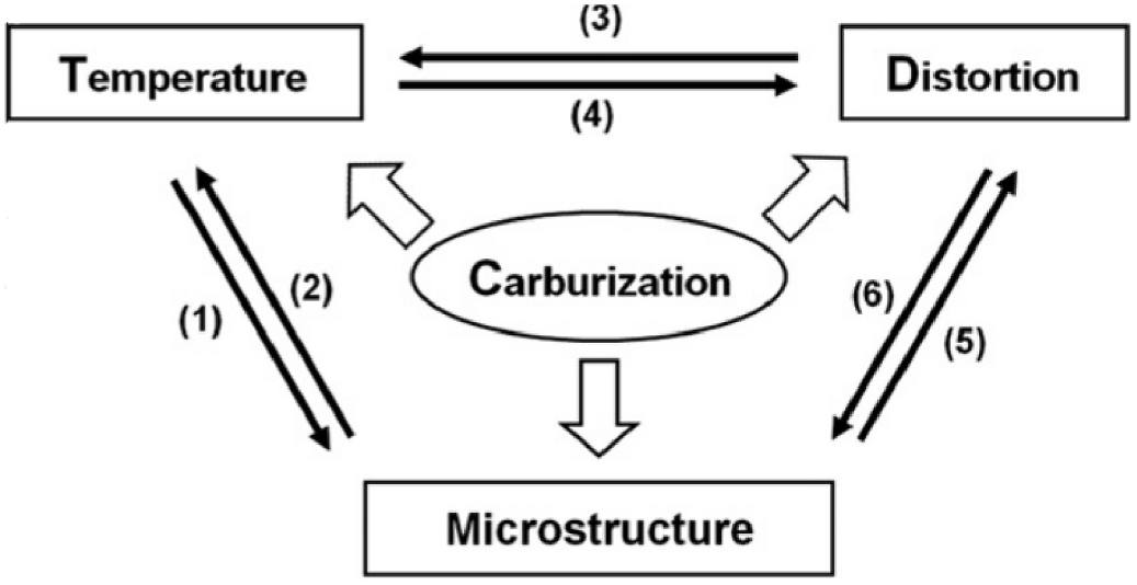

Figure 2: Interactions during the carburizing-quenching treatment [7].
The coupling between the mechanisms involved appears at different levels (see Figure 2): The diffusion process drives the carbon-concentration profile; phase transformations are driven by temperature evolution and carbon-concentration; temperature fields are influenced by phase transformation; thermal stresses affect the mechanical response. Lastly, phase transformations are associated to transformation strains that can generate transformation plasticity [6]. Stresses can influence the kinetics of the martensitic transformation.

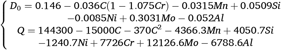

where Vc is the partial carbon molar volume, D the diffusion coefficient, R the perfect gas constant. PH = –/3trσ is the hydrostatic pressure, σ being the stress tensor. The diffusion coefficient D is modeled by an Arrhenius function [30] in Equation 5:
Equation 5
Q is the activation energy and D0 is the pre-exponential factor. Both are assumed to be composition-dependent such that [31] in Equation 6:
Equation 6

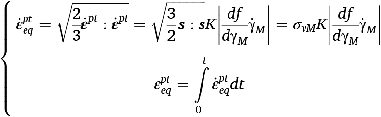

where βM is the coefficient describing the expansion induced by the structural modifications [19] and γM the martensite volume fraction (Equation 9). Last, transformation plasticity strain rate ε˙pt is given by [35] in Equation 17:
Equation 17
where K is the material-dependent transformation coefficient, s is the deviatoric stress tensor and f(γM) is a function describing the progression of the transformation. An equivalent transformation plasticity strain εpteq can be introduced such that in Equation 18:
Equation 18

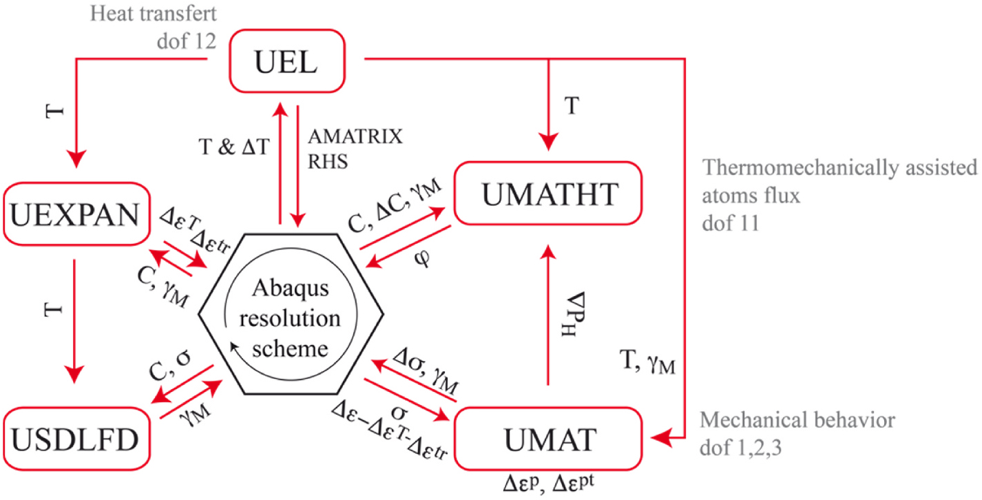

2.5 Implementation
To solve the coupled chemo-thermo-mechanical problem, the Finite Element software Abaqus is used, together with several User Subroutines [27]. The “coupled-temp” displacement procedure has been used, with the degree of freedom (dof) 11 for the carbon-concentration C.
To add all the specific features presented in the previous sections, the following User Subroutine were used, either from previous developments or specifically designed for that work:
  • UMATHT: Definition of the pressure-dependent particle flux [36].
  • UMAT: Thermo-elastoplastic mechanical behavior (isotropic hardening) and computation of PH [36]. This subroutine has been modified to account for εpt, using the algorithm presented in [34].
  • UEL: Multi-diffusion problem [37], and especially, transient heat transfer [38].
  • UEXPAN: Thermal expansion [38] as well as εtr and eC.
  • USDFLD: Computation of γM as a function of C and T.
The flowchart is presented in Figure 3. From the implementation strategy, all material parameters can be dependent on temperature, carbon-concentration, and martensite/austenite fraction.
Figure 3: Flowchart for the resolution of the coupled problem.
It is worth noting that the chosen implementation strategy allows the resolution of all problems simultaneously, except the phase transformation. As underlined previously, in the specific context of carburizing-quenching, this specificity is not mandatory.

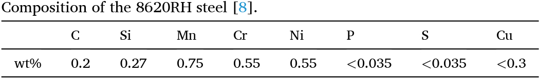

Table 1: Composition of the 8620RH steel [8].
3.1 Configuration

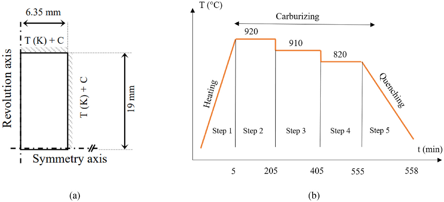

The configuration is a cylindrical sample made of 8620RH steel (see its composition in Table 1), depicted on Figure 4a, loaded on all outer surfaces by both temperature and gaseous carbon-concentration.
Figure 4: (a) Dimensions of the sample and (b) And heat treatment process.
The loading scenario is divided into five steps:
  1.  Heating from 25°C to 920°C during 5 min.
  2. Carburizing at T = 920°C during 200 min under a 0.9 wt% C atmosphere.
  3.  Carburizing at T = 910°C during 200 min under a 0.85 wt % C atmosphere.
  4. Carburizing at T = 820°C during 150 min under a 0.75 wt % C atmosphere.
  5. Air quenching to 25°C during 3 minutes.
The problem is modeled in 3D (due to the way PH is computed – see [36] for further details), meshed by full integration linear hexahedral elements C3D8T. A refined mesh was used near the surface and along the symmetry axis in order to better capture stress and strain gradients. In these regions, the element size was reduced to 6 10–3 mm. In the rest of the domain, especially toward the revolution axis, the element size was progressively increased up to 1.5 10–2 mm.
Initially, γM = O everywhere in the sample (i.e., γAi = 1).

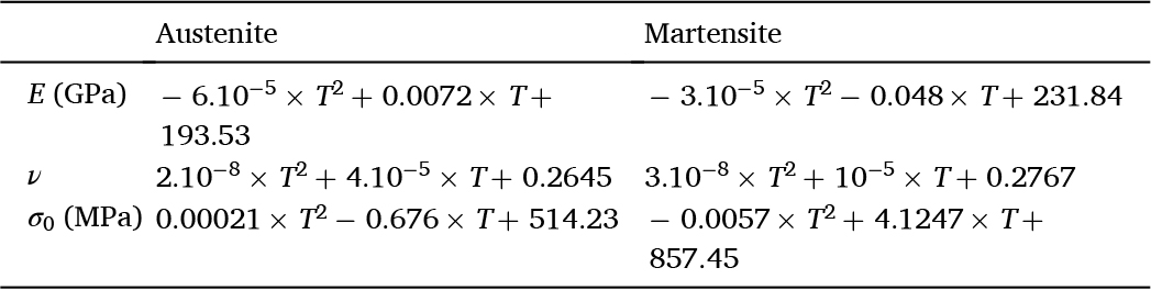

Table 2: Material parameters: Young Modulus (E), Poisson ratio (v) yield stress (s0) [35]. T is the temperature in K.
3.2 Material parameters
Temperature-dependent mechanical parameters were extracted from [35] for pure martensite and austenite, and fitted by polynomial functions (see Table 2).

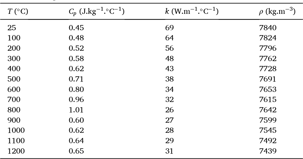

Heat-transfer parameters (thermal conductivity k, density ρ and specific heat Cp) are provided in Table 3, from data extracted from [20]. As it was difficult to identify a polynomial function to fit these data satisfactorily, they have been used in a tabular way. It is worth noting that the evolution of the heat transfer parameters with T are not monotonic.
Table 3: Heat transfer parameters [20].

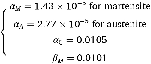

This is due to the metallurgical transformation occurring at about 800°C from BCC ferrite to FCC austenite. Thermal expansion for the martensitic an austenitic structure, volume, and phase transformation coefficients have been obtained from [8] in Equation 19:
Equation 19
For non-pure phases, all parameters are computed based on the percentage of each phase: e.g., α = γMαM + (1 – γM)αA.

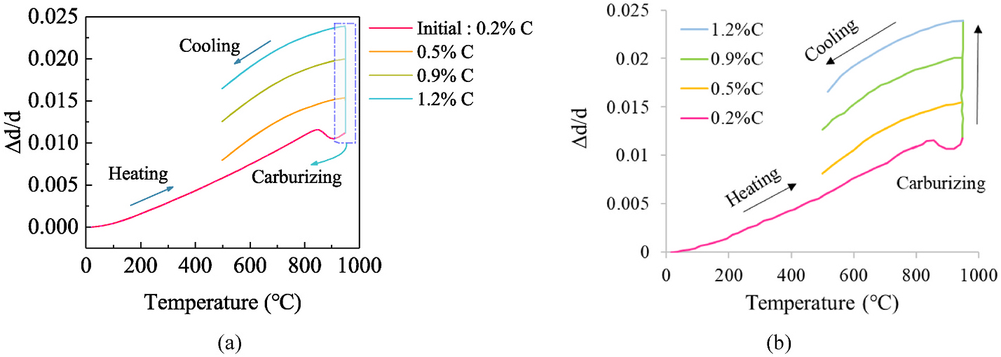

αC (Equation 19) has been identified from the results provided in [8], in which the dilatation of the sample’s diameter Δd/d is provided as a function of the temperature and the carbon content of the surrounding atmosphere.
Figure 5: Variation of the diameter of the sample Δd/d due to both heat transfer and carbon atoms diffusion (a) From [8] and (b) Obtained in the current study after identification of aC.
In Figure 5, the Δd/d evolution from [8] and in the present study are compared, based on the inverse identification of αC: as it can be observed, results are consistent with [8]. It is worth noting that, as temperature decreases to the ambient temperature (e.g., during step 5), the thermal strain becomes negligible compared to the dilatation induced by carbon atoms.

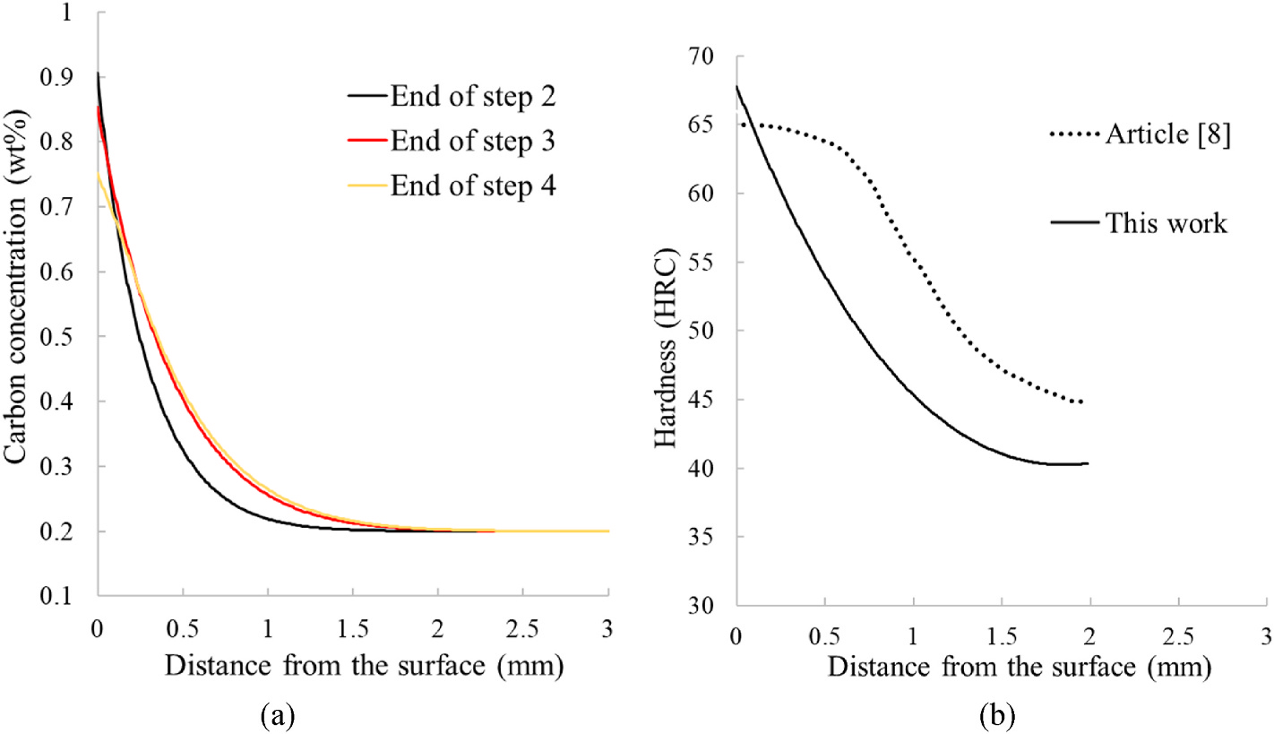

Figure 6: (a) Carbon penetration in the sample and (b) Comparison of the computed HRC hardnesses with [8].
Equation 6 and Table 1 have been used to compute the diffusion coefficient D as a function of the carbon concertation C. The partial carbon molar volume Vc is set to 3.9 10–6 m3/mol [18]. The transformation plasticity coefficient K is set to 2.5 10–5 [35]. Last, the temperature Ms at which martensitic transformation begins and the material parameter AM are computed using Equations 10 and 11.

3.3.1 Carburizing steps
Figure 6a shows the diffusion profile at the end of each step under a carbon-rich atmosphere (steps 2–4).
It can be observed that carbon remains at the sample’s surface (less than 1 mm deep for a radius equal to 6.35 mm), consistent with the low value of D at 900°C. Step 4 shows no evolution of the diffusion profile, as the diffusion coefficient at 820°C is too low (equal to 9.29 10–7 mm2/s when C is equal to 0.9 wt%). From these carbon profiles, the Vickers hardness HV can be estimated using the following relationship [8] in Equation 20:
Equation 20
where VM is a critical cooling rate for martensite, equal to 10°C/s (concentrations in Equation 20 are in mass.fr).
The equivalence with the HCR’s hardness is set following [39] in Equation 21:
Equation 21
The HCR hardness prolife is plotted in Figure 6b along the symmetry axis and compared with the one from [8]. If maximum values are the same (which is expected as the carbon boundary condition are the same in both studies), it can be observed that the carbon penetration in [8] is more important, i.e., the value of D used in [8] is probably greater than the one considered here. It is worth noting this value has not been provided in [8], where it is only mentioned that it is temperature and carbon-concentration-dependent: This variation in D certainly has an influence on the identified αC as well (see Figure 5).

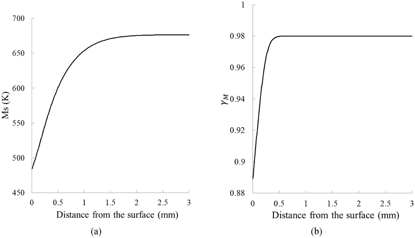

During the quenching step (step 5), the initially austenitic structure transforms into martensite, depending on both the carbon-concentration and the temperature. This process, assumed to be instantaneous as previously underlined (Equation 9), is controlled by the transformation temperature Ms, which is decreasing with C (see Equation 11). Ms and γM profiles along the symmetry axis of the sample are plotted in Figure 7, at the end of the quenching step (step 5).
Figure 7: (a) Ms and (b) gM evolutions as a function of the radius along the symmetry axis at the end of the quenching step.
Ms increases from the surface of the sample to about 1 mm deep, from where it becomes constant, consistently with the carbon profile depicted in Figure 6a. The martensite fraction γM is lower near the outer surface because the local decrease in Ms slows down the onset of the martensitic transformation.

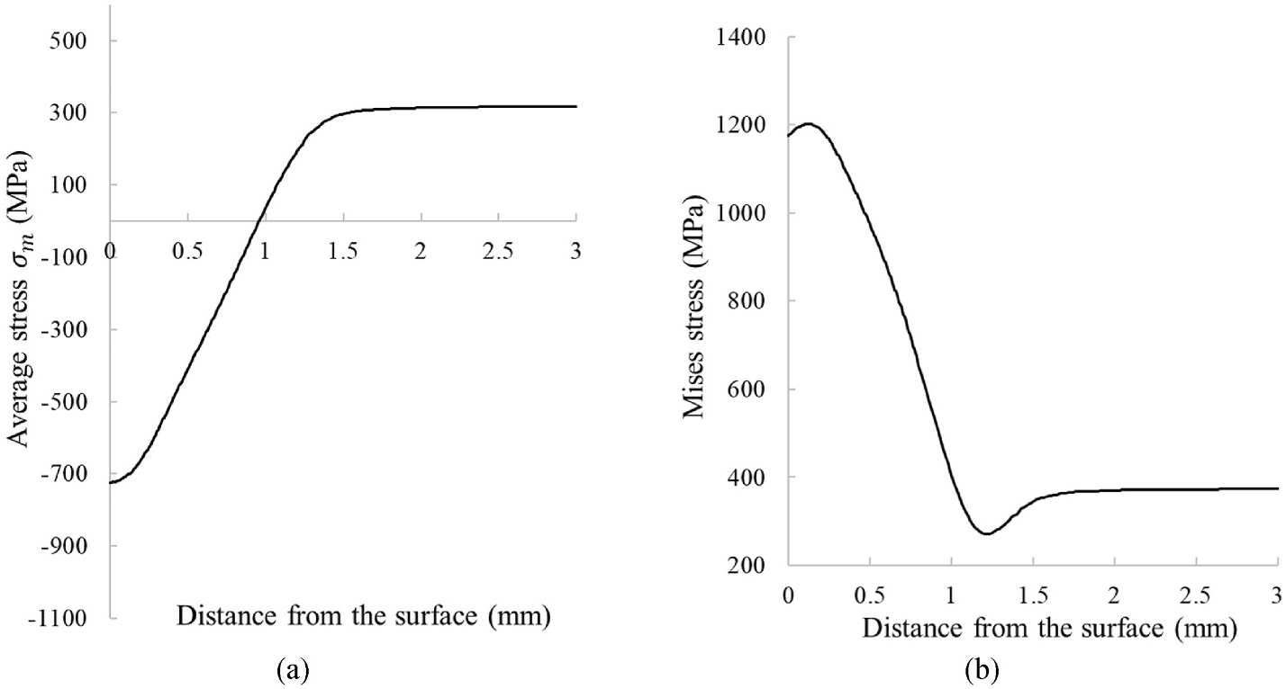

3.3.3 Mechanical fields at the end of the quenching process (step 5)
Figure 8a shows the repartition of the average stress σm = –PH along the symmetry axis. Compression can be observed below the sample surface (i.e. where carbon atoms have diffused), inducing a tensile stress elsewhere. There are two reasons for this behavior: Firstly, volume expansion is greater in the martensite-rich core, which tends to expand during transformation. The surface, which is cooler, less transformed, and thus mechanically more rigid, slows down this internal expansion. This blocking creates a state of compression on the surface and traction in the volume, which is consistent with observed tendencies (see, e.g., [12,14,19,35]). Secondly, dilatation linked to carbon diffusion also plays an important role, since it creates compression zones.
Figure 8: Evolution of (a) The average hydrostatic pressure sm=−PH and (b) The von Mises stress along the symmetry axis at the end the quenching step.
This compression is associated to a very high von Mises stress (Figure 8b), reaching its maximal value close to the surface, due to strong transformation-induced incompatibilities and the coexistence of martensite and retained austenite, which generate significant deviatoric stress components. The martensitic transformation deforms the material unevenly and in specific directions, since it occurs locally — some areas transform before others.
The surrounding material (still austenitic or already transformed) resists this deformation, creating internal stresses. It can be observed that, at depth, where the effects of cooling are less marked, residual stresses gradually decrease. This zone is generally characterized by low-amplitude stresses [12,14,19,35].

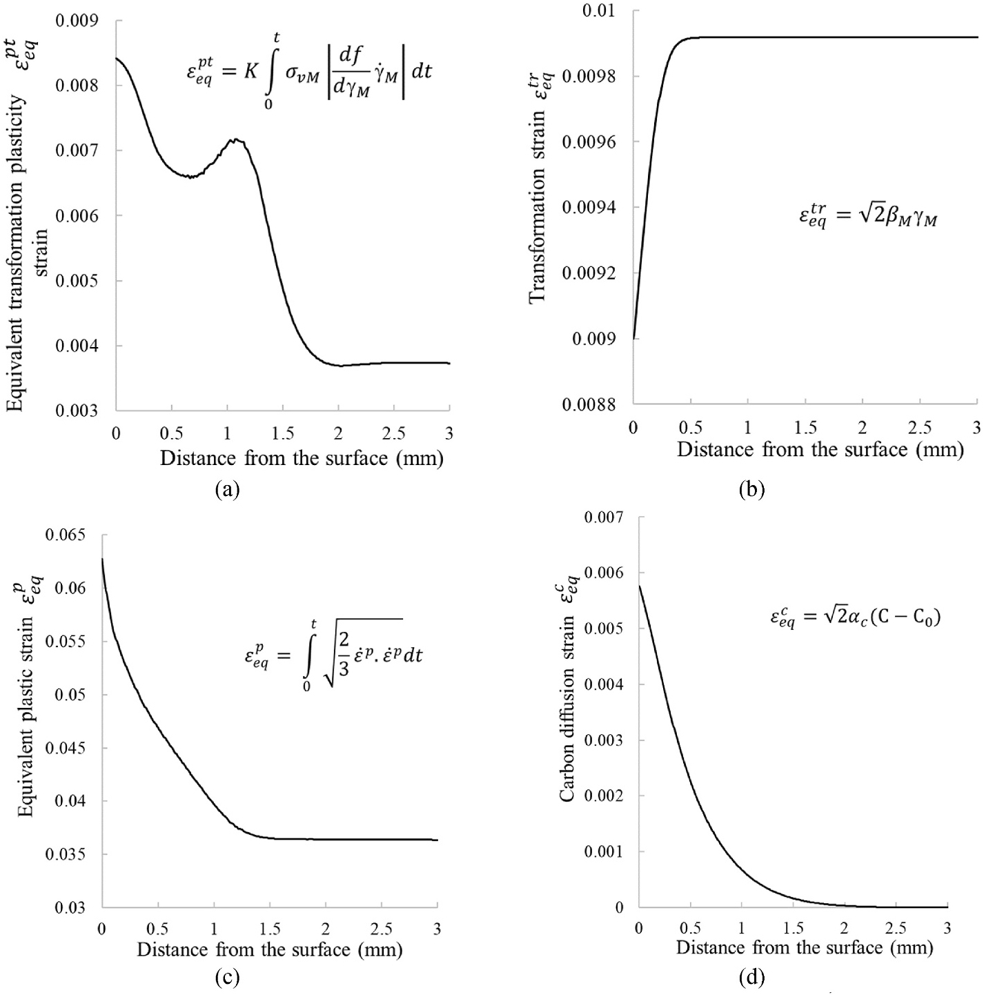

Figure 9: Variation along the symmetry axis of (a) The equivalent transformation plasticity epteq, (b) The equivalent transformation strain etreq, (c) The equivalent plastic strain epeq and (d) The equivalent carbon diffusion strain eceq in %.
The evolution of stresses can be interpreted through the different strain contributions within the material:
The equivalent transformation-induced plastic strain εpteq (Figure 9a) exhibits a pronounced maximum near the surface, followed by a local peak at about 1 mm in depth. The peak indicates the place where the beginning of the martensitic transformation takes place. During quenching, the temperature of the sample is not constant, but shows its maximum value at the axis of revolution. The martensitic transformation is triggered when the temperature becomes lower than Ms, which occurs at the peak after 100 seconds of quenching (see Figure 10). This peak is linked to a low von Mises stress value (Figure 8b).
The equivalent transformation strain εtreq (Figure 9b) is proportional to the martensite fraction (Figure 7b). It is minimal at the surface, where retained austenite remains, and maximal in the core, where the microstructure is predominantly martensitic. This induces additional mismatch with the less-transformed surface.
These gradients are accompanied by plasticity εceq, which is pronounced near the surface and strongly correlated with the von Mises stress (Figure 9c).
The equivalent carbon-induced strain εceq reaches its maximum at the surface and gradually decreases toward the sample’s center (Figure 9d). This trend directly reflects the carbon-concentration profile, where local expansion at the surface is mechanically constrained by the geometry and less enriched regions, leading to compressive stresses.

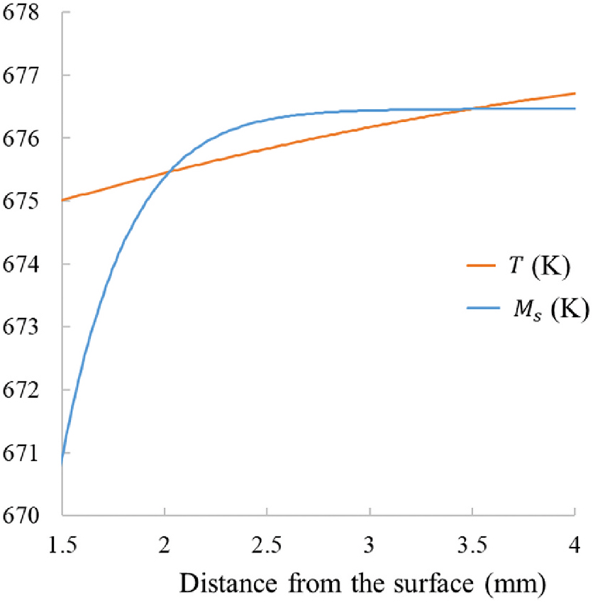

Figure 10: Evolution of the martensite transformation temperature and the temperature along the symmetry axis at = 95s.

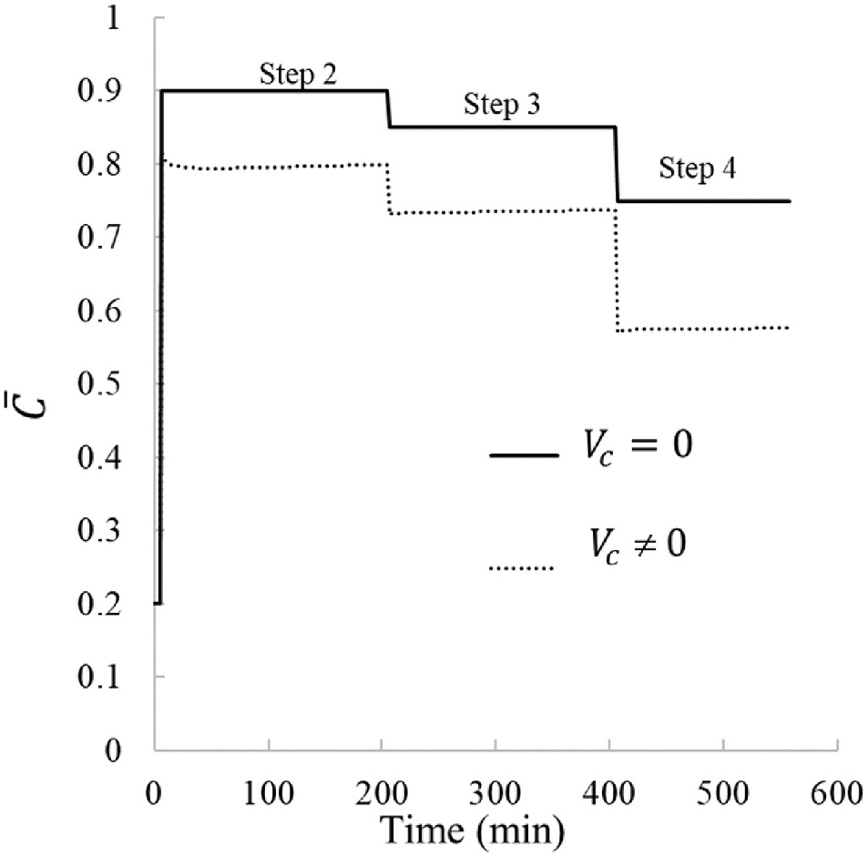

Hydrostatic pressure on carbon diffusion has two main consequences: First, the carbon flux is modified (Equation 4) and carbon atoms tend to diffuse faster through areas in expansion (PH<0). Second, the carbon adsorption/absorption process is also modified: considering an instantaneous carbon adsorption/absorption reaction, the chemical potential equality between the gaseous carbon, and the atom in solution is given by the following boundary condition for C [40,41] in Equation 22:
Equation 22
in which C0 represents the carbon-concentration values in the neighboring atmosphere (0.9 %, 0.85 and 0.75 %). The evolution of C is presented in Figure 11 with or without accounting for the impact of PH (i.e. considering respectively Vc ≠ 0 and Vc = 0).
Figure 11: Carbon-concentration boundary condition`C without (solid line) and with (dashed line) PH.
It is worth noting that Equation 22 has not been implemented in the flowchart presented in Figure 3, but computed using the previous PH-free results (week coupling).

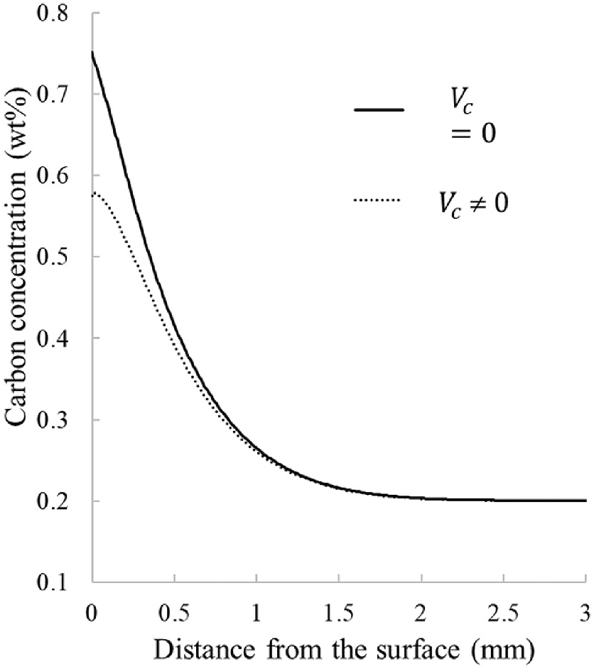

Figure 12 shows the comparison of the carbon-concentration profiles along the symmetry axis with and without PH, at the end of the diffusion process. It can be observed that the diffusion depth is not modified, but the level of C at the sample surface is significantly lower.
Figure 12: Carbon-concentration evolution along the symmetry axis at the end of the diffusion process (step 4).

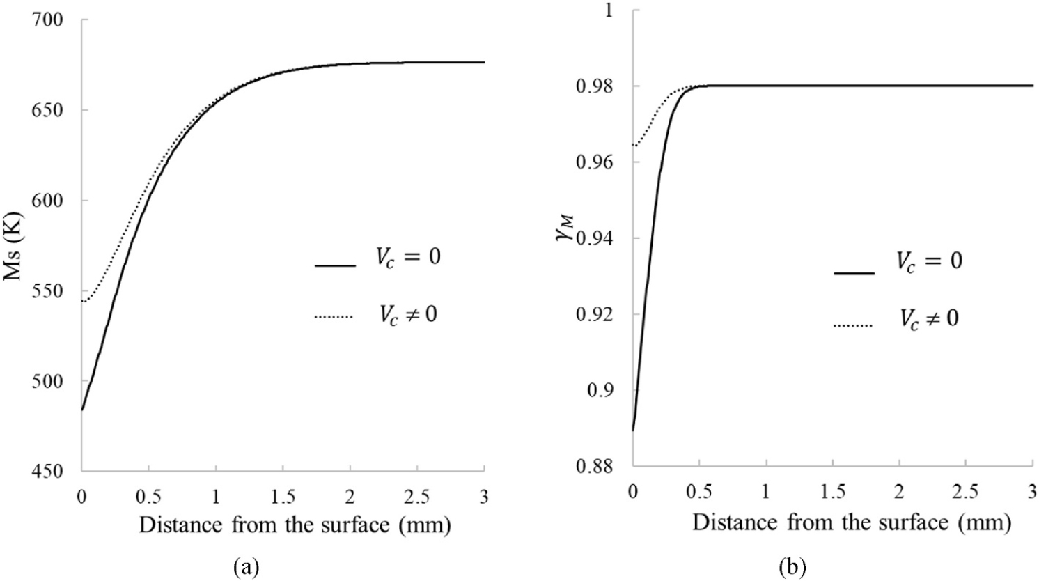

The consequences on the quenching process are illustrated in Figure 13, in which both Ms and γM evolution along the symmetry axis are plotted. Compared to the case without hydrostatic pressure, Ms starts from higher values at the surface, due to the lower carbon content, resulting from the hydrostatic compression that hinders carbon absorption in the sample. Consequently, the martensite fraction γM is also higher in this region, as the transformation is facilitated by the earlier intersection between temperature and Ms during cooling (which occurs at t = 80 seconds, at the same location than in the previous section).
Figure 13: (a) Ms and (b) gM as a function of the radius along the symmetry axis at the end of the quenching step.

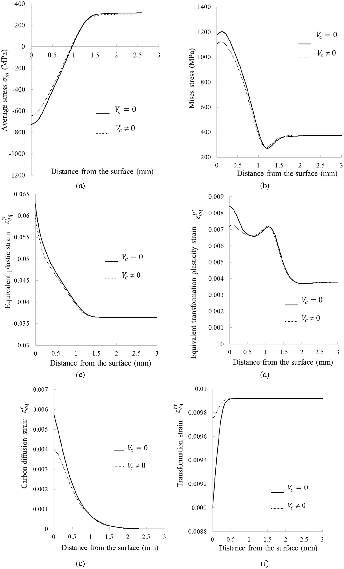

The consequences on the mechanical fields and equivalent strains can be seen in Figure 14, in which mechanical fields and strains evolution along the symmetry axis are plotted at the end of the quenching step, and compared with the results without PH (previous section).
Figure 14: Variation along the symmetry axis of (a) The average sm=−PH stress, (b) The von Mises stress, (c) The equivalent plastic strain epeq, (d) The equivalent transformation plasticity strain epteq , (e) The equivalent carbon diffusion strain eceq and (f) The equivalent transformation strain etreq without (solid line) and with (dashed line) PH.
Due to the increase in the martensitic fraction γM at the surface, the transformation differential is reduced, thus reducing the average compressive stresses σm at the surface (Figure 14a). This attenuation is also reflected in von Mises stresses (Figure 14b). On the deformation side, diffusion deformation εceq directly follows the concentration profile, and clearly decreases with it (Figure 14e).  Transformation strain εtreq (Figure 14f) increases at the surface, following the new distribution. At the same time, plastic transformation strain εpteq and plasticity strain εpeq become more homogeneous (Figure 14c and d), reflecting a reduction in internal mechanical gradients. Thus, hydrostatic pressure tends to reduce internal heterogeneities and residual stress peaks, making processing more mechanically balanced.
It should be noted the impact on PH diffusion is limited to the diffusion steps (2-4), for which the temperature T is sufficiently high. As soon as quenching occurs, diffusion tends to become negligible.
