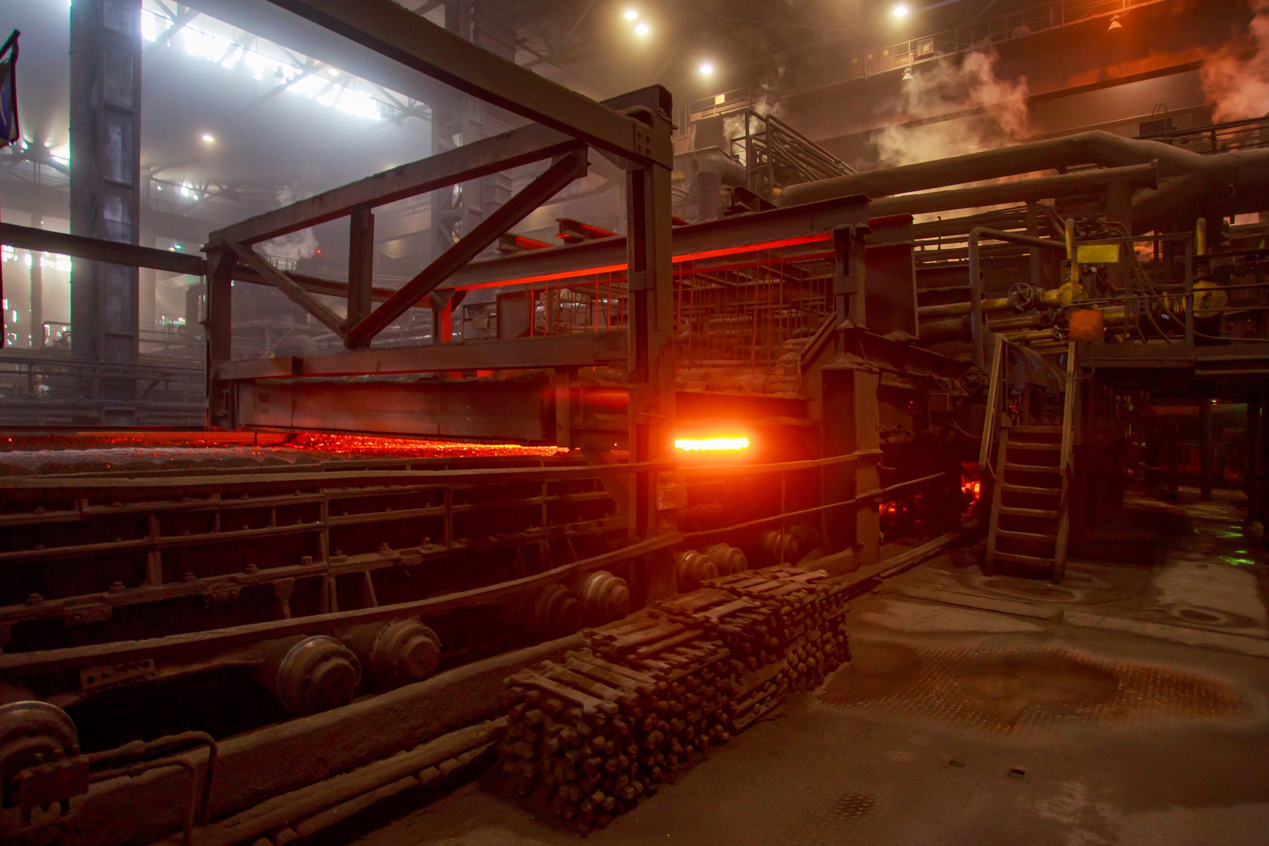

In process cooling, few applications push the limits quite like powder metal sintering. Inside a sintering furnace, temperatures in the high-heat zone can reach several thousand degrees Fahrenheit. The process bonds and shapes metal particles using heat and pressure without fully melting the material. This controlled fusion creates strong, precise parts while maintaining the desired material properties.
At the Pennsylvania facility, the water leaving some furnace zones is nearly boiling, requiring a specialized cooling system.

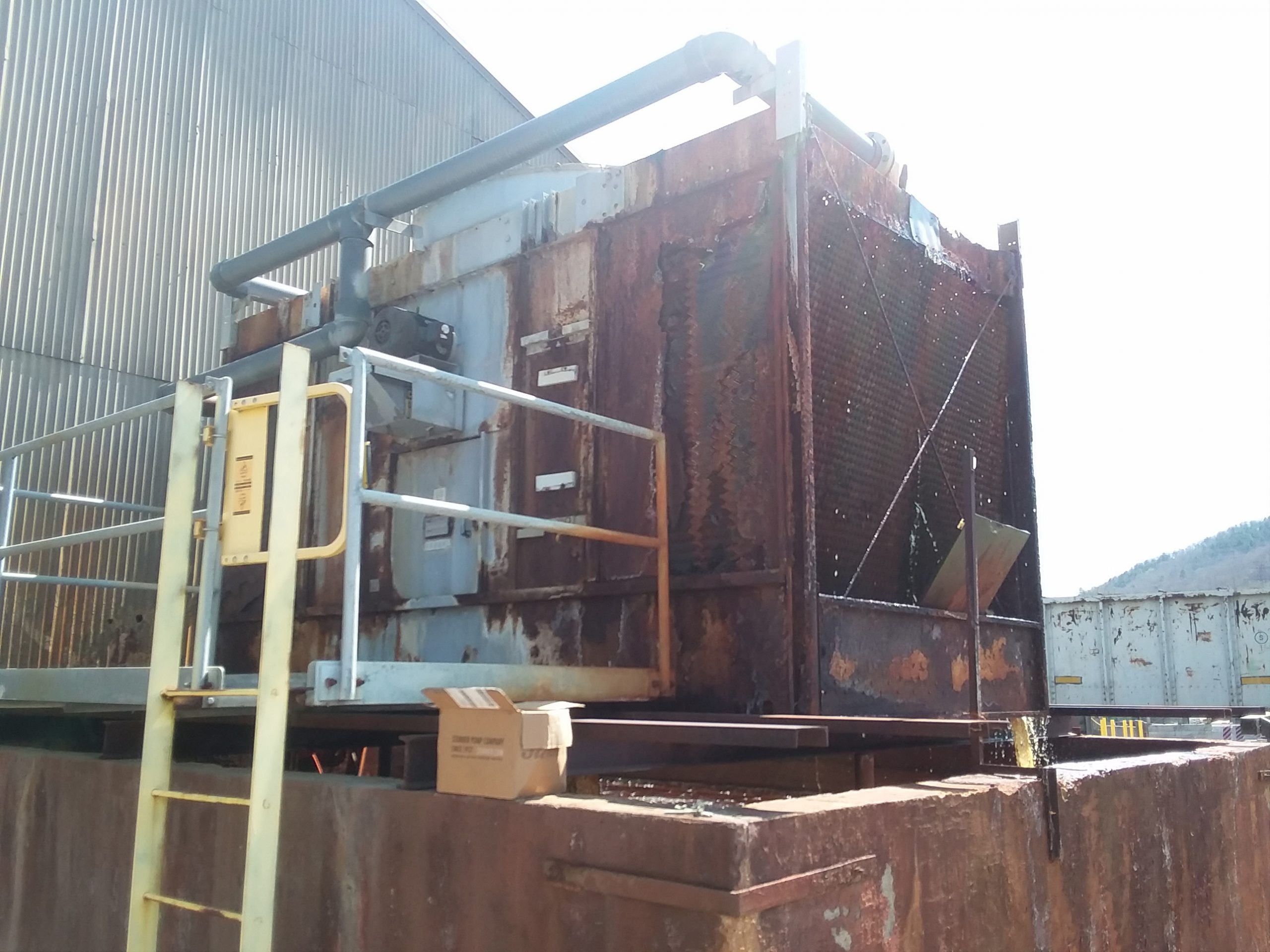

For decades, galvanized metal has been the default material for cooling towers. While it can perform well in certain environments, metal is vulnerable to a range of chemical and mechanical stresses that limit its lifespan.
“With galvanized steel, you have to be very careful with your water chemistry,” Keister said. “If the pH goes above about 8.2, you get what’s called white rust. That eats the galvanized coating right off, leaving bare metal exposed, and corrosion sets in very quickly.”
Keister has personally witnessed metal towers disintegrate in as little as five years, and most fall in the 10- to 15-year range.
While it can perform well in certain environments, cooling towers made of metal are vulnerable to a range of chemical and mechanical stresses that limit their lifespan. (Courtesy: ProChemTech)
Even stainless steel, often viewed as the premium option, is not invincible. In areas with high chloride levels, operators risk chloride-stress corrosion cracking, especially at points where the metal has been bent or formed. In some cases, chlorides and certain chemical additives can react to form chlorine, which aggressively attacks stainless surfaces.
“I’ve seen stainless towers develop pinholes through the bottom within just a couple of years if the water chemistry is not just right,” Keister said.
The financial implications go far beyond maintenance costs. While a new tower itself might cost anywhere from $80,000 to $150,000, installation can be double or even triple that. Cranes are required to lift the old unit out and place the new one, sometimes requiring nearby rail lines or roads to be closed.
Keister recalls one project where an aging metal tower was so badly corroded that it broke in half mid-lift, nearly causing catastrophic damage to the building below.
“When you add up the cost of replacing the tower and the installation every 10 or 15 years, it becomes incredibly expensive,” he said. “If you can avoid those repeat installations, you’re way ahead of the game.”

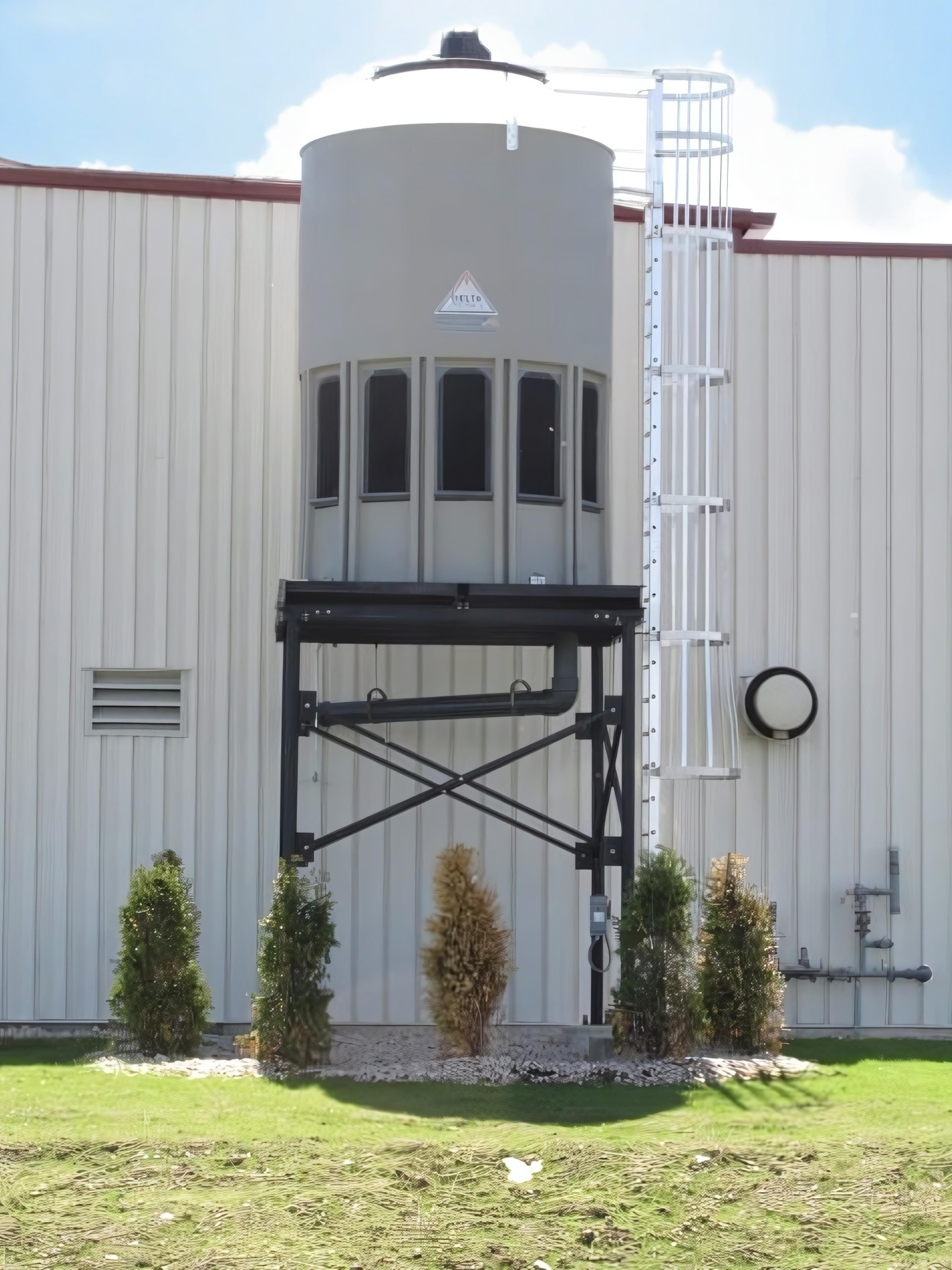

When it came time for their latest upgrade, the Pennsylvania sintering plant carefully evaluated its options. The facility needed a 435-gallon-per-minute unit that could meet current production demands while supporting expected growth over the next decade. After reviewing stainless steel and engineered plastic designs, the decision was clear: engineered plastic offered a level of durability, reliability, and long-term performance that metal simply couldn’t match.
For a sintered metals facility in western Pennsylvania, the decision to break away from traditional metal cooling towers was driven by both necessity and experience. (Courtesy: ProChemTech)

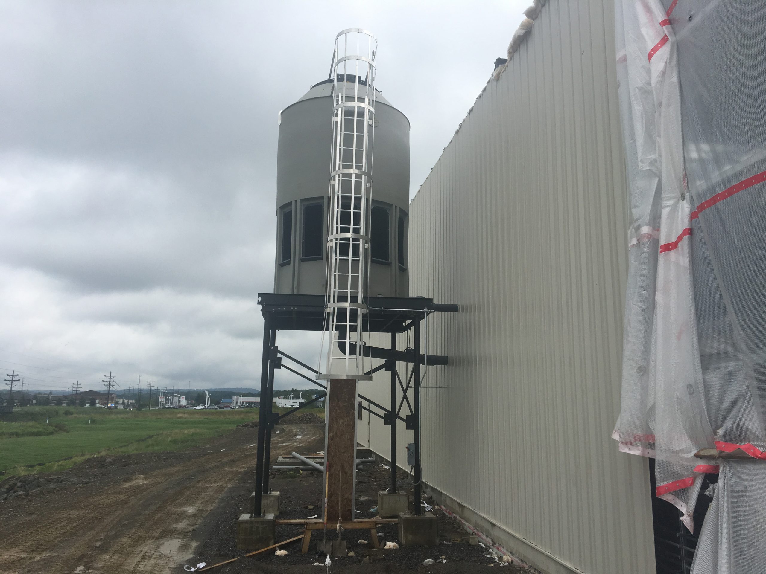

HDPE cooling towers have steadily gained ground in industrial applications because of their ability to solve many of the challenges that plague metal tower designs. For this plant, several key benefits drove the decision:
  • Corrosion-proof and chemically resistant: Unlike metal towers, HDPE is completely impervious to rust and corrosion. This resistance makes it ideal for facilities with fluctuating or challenging water chemistry, reducing both chemical costs and maintenance requirements.
  • Seamless, one-piece construction: Most metal towers are assembled on-site using many pieces, which creates seams that eventually become leakage points. HDPE towers are molded as a single, seamless piece, eliminating this risk entirely.
  • Simpler, lower-cost installation: Engineered plastic cooling towers are significantly lighter than metal, which means smaller cranes and less complex rigging. This makes them faster and more affordable to install.
Material Gains
Working with ProChemTech, the plant selected a Paragon model manufactured by Delta Cooling Towers, which has a maximum cooling capacity of up to 250 tons and comes with a 20-year warranty. ProChemTech supplied the complete package, including the tower, pumps, and central control panel that manages the entire system.
