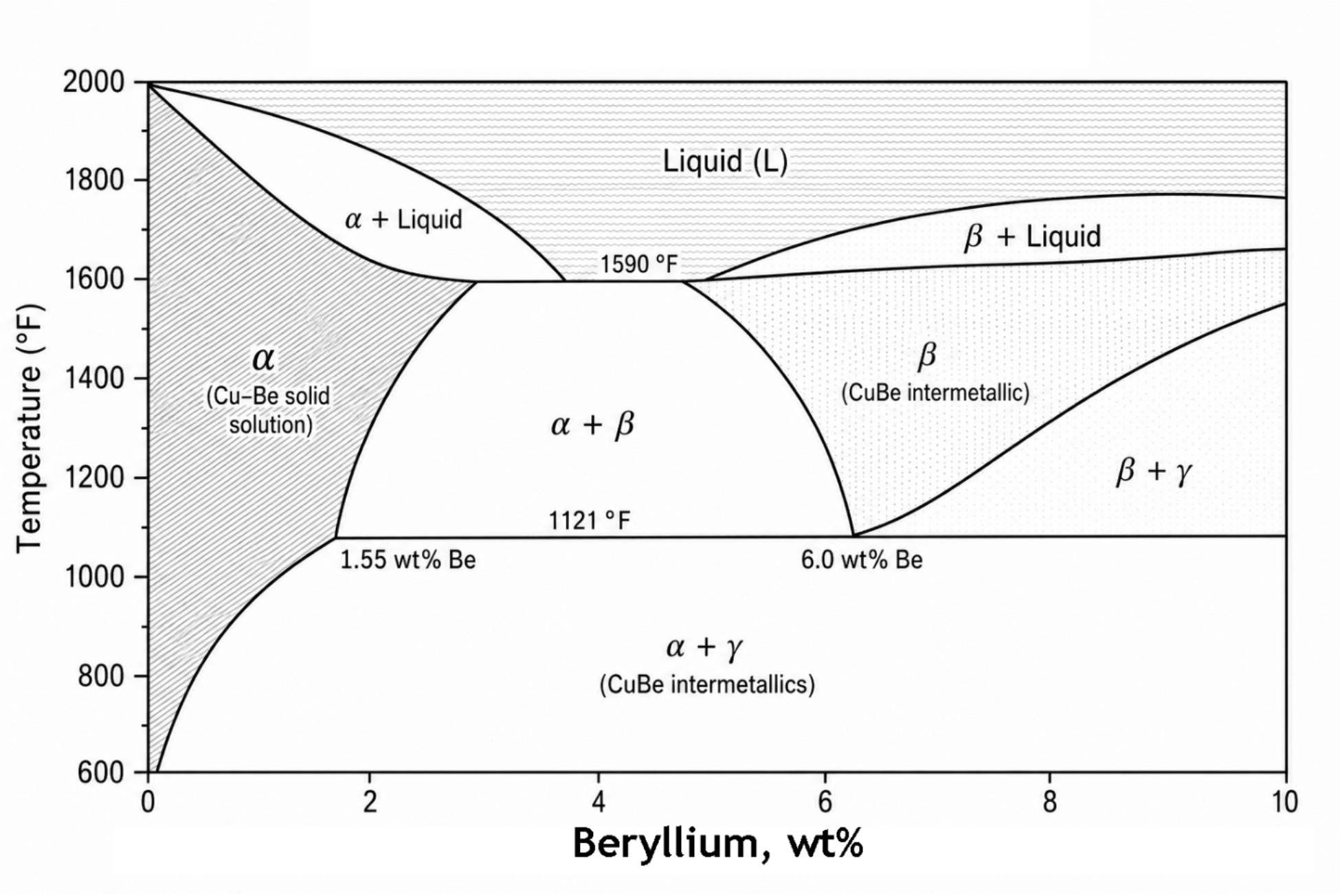

Figure 1: Copper-rich end of the Beryllium-copper phase diagram. At 1,590°F, beryllium has a solubility of about 2.7% in alpha. At room temperature, the maximum solubility is less than 0.2% [1].

In many ways, the Be-Cu system can be compared to the Al-Cu system for precipitation heat treatment. As in the Al-Cu alloy system, there is decreasing solubility of beryllium in the copper alpha (α) phase with decreasing temperature. Since there is decreasing solubility as temperature decreases, this satisfies the basic criteria for precipitation hardening. This is seen in the copper rich end of the Be-Cu phase diagram (Figure 1).
At Be concentrations encountered in typical Be-Cu alloys (1.8-2.0%) the precipitation sequence is made more difficult by the beta phase, in the alpha + beta phase field, converting to gamma. However, the essential aging sequence is unchanged.
Beryllium-copper alloys are solution heat treated at approximately 1,500°C (815°C) to bring all the alloying elements into solution. Upon rapid quenching (typically water or polymer), a supersaturated solid solution of Be-α copper results. There is a large thermodynamic driving force for decomposition during aging because of the large solubility gap. It is this large solubility gap that is one reason why Be-Cu alloys can achieve high strengths relative to other copper alloys.

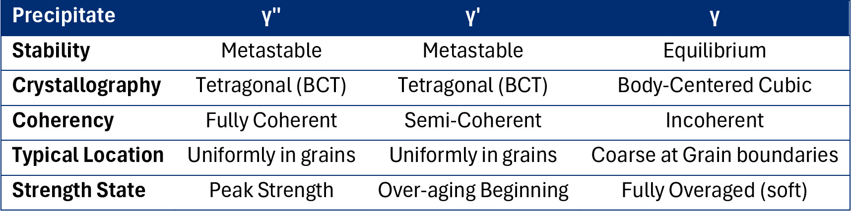

Initially, during aging, there is clustering of the Be atoms in the copper matrix. These very fine clusters form Guinier-Preston zones on {100} matrix planes[2] [3]. The GP zones act as precursors to later coherent precipitates that provide strengthening, and eventually the incoherent equilibrium precipitate.
The basic precipitation mechanism is supersaturated alpha-Cu after quench, GP clustering on {100}, metastable gamma double-prime, metastable gamma prime, then stable gamma equilibrium precipitate (Equation 1):
Equation 1
As in aluminum alloys, strengthening occurs before the formation of the equilibrium precipitate, and the onset of coarsening.
The gamma double-prime stage provides the largest amount of strengthening because it is extremely fine and coherent or nearly coherent with the face-centered cubic (FCC) α-Cu matrix. These γ” precipitates are extremely small and are observable only through the TEM. They are typically body-centered tetragonal in structure and usually appear as plates or disc-shaped precipitates.
The precipitates grow along the {100}α planes of the copper matrix. Coherency strains make dislocation motion difficult, so even a low volume fraction can produce a large increase in hardness and yield strength.
The gamma prime phase is a metastable semi-coherent phase that appears after gamma double-prime during aging. It occurs before the precipitation of the equilibrium gamma phase. The γ‘ phase has an ordered body-centered tetragonal (BCT) structure, which is a step closer to the equilibrium body-centered cubic (BCC) structure of the equilibrium precipitate.
The morphology of γ‘ is either later plate like precipitates, or acicular or needle shaped, compared to the disc-shaped γ“. Gamma prime is coherent on the {112}α or {112}α of the copper matrix [4]. While γ’ still contributes to the alloy’s strength, it typically corresponds to the onset of over-aging, as the γ‘ grows and consumes the γ” phase, the hardness begins to decrease.
The final equilibrium precipitate, CuBe is an ordered body-centered cubic (BCC) structure, and is an intermetallic, with a 1:1 ratio of copper to beryllium atoms. It is incoherent with the copper matrix.
Table1: Summary description of precipitates occurring in Be-Cu alloys [4].
A summary of the precipitates is provided in Table 1.
