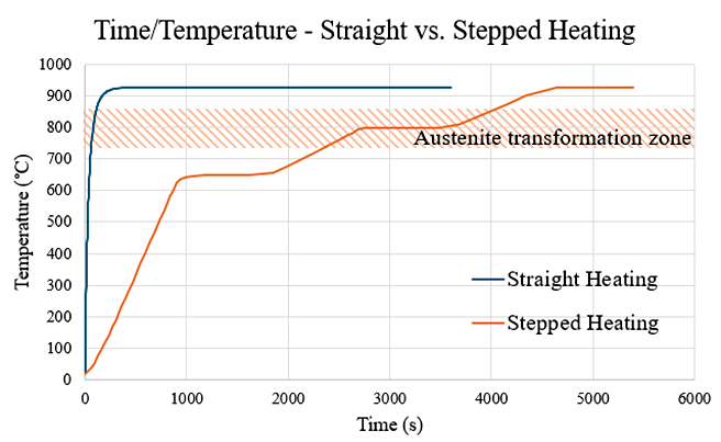

The study starts with a furnace heating model to predict distortion during heating. Two models were developed, with a straight-furnace heating and a stepped heating to compare the distortion from heating alone. The time/temperature history of a surface point, or node, from each of the models is shown in Figure 1. The straight heating model assumes the part is placed into a furnace preheated to 912°C. The stepped heating model assumes the part is heated to 650°C and is allowed to reach thermal equilibrium.
Figure 3: Time/Temperature plots for the HPGQ and DCGQ models.
The furnace is then heated to 800°C and held for another 15 minutes until finally heating to the 912°C holding temperature. The temperature holds help control the thermal gradient in the part before and during the transformation to austenite ensuring the phase transformation happens more uniformly throughout the part.

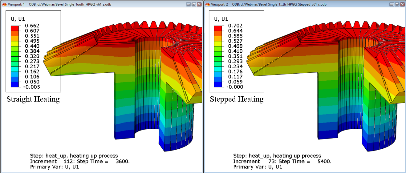

The results of the two heating models are shown in Figure 2. The contours show axial distortion, to capture the tooth-taper mode, and both models are at the end of heating while the part is uniformly at 912°C. At first glance, the stepped heating model, right, shows a slightly higher magnitude of axial distortion. However, each of the color divisions in the contour are almost perfectly horizontal, showing a uniform expansion from heating in the axial direction. In contrast, the straight heating contour, left, has a “wavier” appearance to the color divisions in the contour, showing non-uniform distortion from heating compared to the stepped heating model.

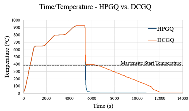

Following heating, two quench methods are modeled, one with a standard high-pressure gas quench (HPGQ) process and another with a DANTE Controlled Gas Quench (DCGQ) process. The DCGQ process is determined by modeling the quench with a hold just before the martensite transformation to achieve thermal equilibrium, and a design requirement of no greater than 10°C temperature gradient in the part during the martensite transformation. For the DCGQ process, the ambient temperature is controlled to maintain the thermal equilibrium in the part with a series of temperature holding steps. The time temperature plots for the surface node during the two quench models in Figure 3 illustrate the difference in quenching methods. Due to the complexity of the part geometry and the tight temperature gradient requirement, the quench holding steps appear to ramp the temperature down.

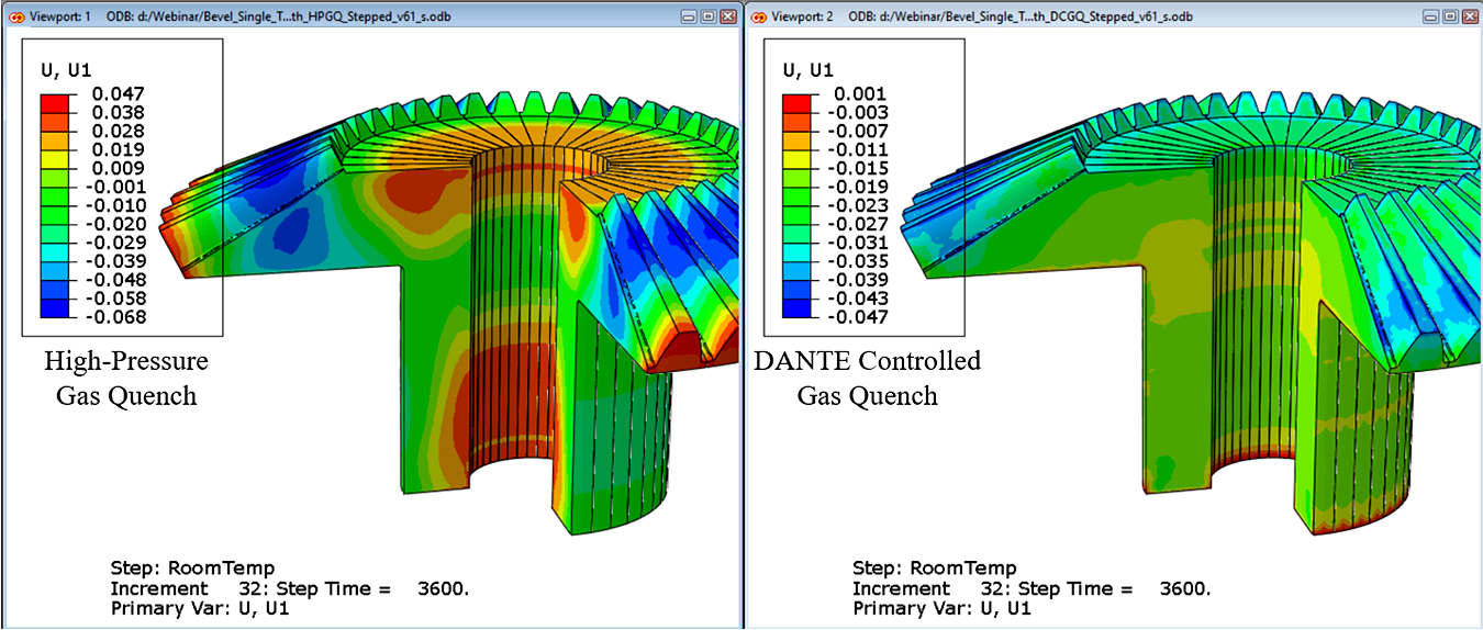

Figure 4 shows the stark contrast in axial distortion between the HPGQ and DCGQ models. The HPGQ model shows that the tip of the tooth curls up while the middle of the tooth dips down, contributing to an overall curl of about 115 µm. The bore of the gear also shows some nonuniform axial distortion. The DCGQ model shows an overall shrinkage in the part with the tooth tapering down about 47 µm near the tip. Because of the controlled heating and quenching, the distortion from the DCGQ process is more uniform than from the HPGQ process. If corrective machining were needed to bring the parts within spec, the HPGQ processed gear may need to remove material from the case nonuniformly, reducing the effectiveness of the case-hardening process.

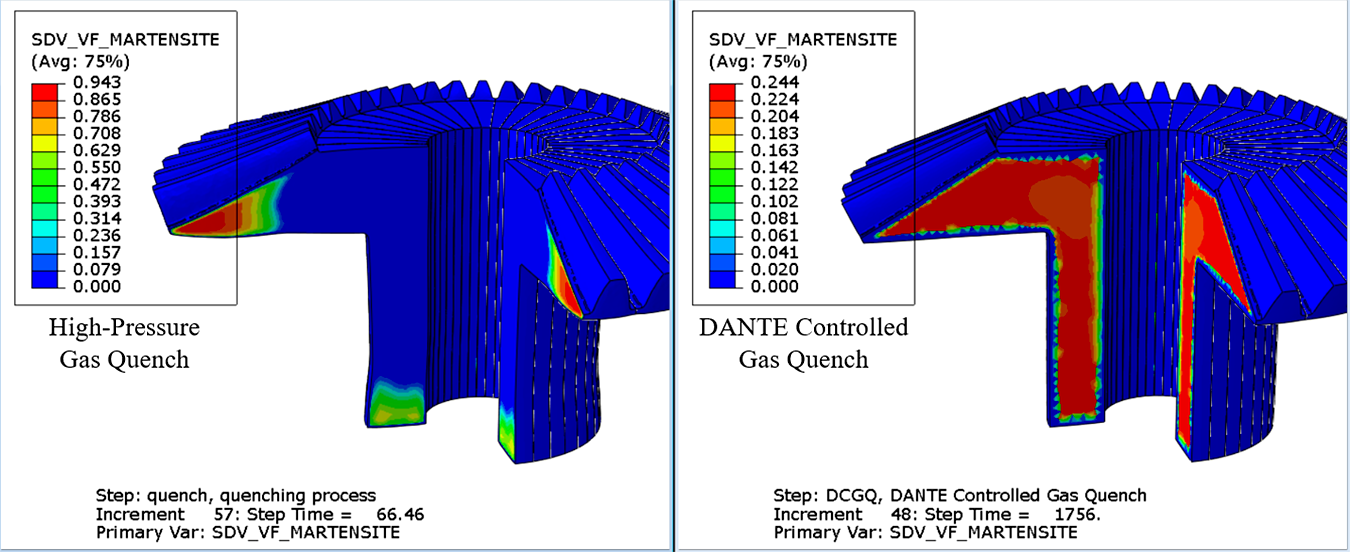

The mechanism behind the increased distortion shown in the HPGQ model can be seen in the in-process martensite contours, Figure 5. When martensite begins to form in the HPGQ model, a large thermal gradient is present in the part. This gradient causes the martensite to form first in the thinner cross sections of the part, such as the tips of the gear teeth, where the cooling is fastest.
Figure 5: In-process martensite contours for HPGQ and DCGQ processes.
The temperature is low enough to have a nearly complete martensite transformation, and the associated volume expansion bends the tip of the tooth upwards, causing the taper shown in the final distortion contour. The DCGQ model specifically aims to keep the thermal gradient to a minimum during the martensite transformation, so the transformation occurs more uniformly through the core of the gear, as shown in the right contour in Figure 5.
