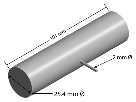

To investigate the fin effect, a simplified finite element model was developed. The geometry consists of a cylindrical specimen with a diameter of 25.4mm (1 inch) and a length of 101mm (4 inches). A thermocouple is attached at the mid-height of the cylinder along its axis, with the thermocouple wire modeled as a 2mm diameter (12 AWG) extension normal to the cylinder surface, as shown in Figure 1.
Figure 1: Schematic of the cylinder and fin geometry used in the study described in the article.
This configuration reflects a common industrial setup in which thermocouples are tack-welded or otherwise affixed to part surfaces during process characterization. The thermal process applied to this model includes a simple heating and quenching process. The specimen is first heated to 900°C under a convective boundary condition corresponding to an HTC of 75 W/m2·K over a period of 1.5 hours. Following this, the part is quenched in a 20°C ambient environment with an HTC of 5,000 W/m2·K for one hour. These conditions are representative of a general heat-treatment operation where large thermal gradients and rapid cooling rates are present.

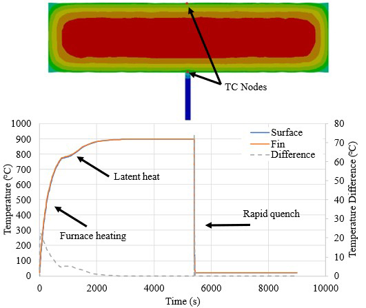

A transient-thermal finite element simulation is used to track temperature evolution throughout the part, with particular attention paid to two locations: the “far surface” (a point on the cylinder unaffected by the thermocouple wire) and the thermocouple attachment point. By comparing these locations, the influence of the thermocouple geometry on measured temperature can be directly assessed. Figure 2 shows an overview of the thermal process and cross-sectional contour of the geometry at about two seconds into the quenching process, with the two nodes highlighted where the time/temperature data was collected. Note the latent heat of phase transformation captured when the part begins to transform to the austenite phase.
Figure 2: Time/temperature history and part geometry used in the model described in the article.

The simulation results show the presence and significance of the fin heating/cooling effect. There exists a difference in recorded temperature during the modeled furnace heating process step, but the heat transfer from the part to the environment is slow enough to reduce the fin heating effect to about 20°C difference between the thermocouple measurement and the far surface.

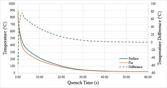

However, during the initial stages of the quench, the thermocouple location experiences accelerated cooling relative to the surrounding material, due to the increased surface area provided by the thermocouple wire, shown in Figure 3. At approximately 1.9 seconds into the quench, the maximum temperature difference between the thermocouple location and the far surface reaches nearly 75°C, at a time when the average part temperature is around 400°C, right around the martensite start temperature for the AISI 4120 steel modeled in this work.
Figure 3: Time/temperature and temperature difference during the quenching process.
At 20 seconds into the quench, when the part temperature has dropped to approximately 85°C, a temperature difference of about 14°C is still observed. By 30 seconds, this difference falls below 5°C, suggesting that the fin effect becomes less significant as the overall temperature gradient is reduced. While the fin cooling effect is most pronounced during the early stages of rapid cooling, its influence can extend into later stages and should not be neglected, particularly when high accuracy is required.
