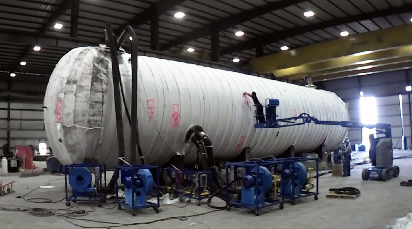

A GCC technician works the thermocouple grid on a large pressure vessel prior to the heat cycle. Thermocouples are attached directly to the vessel surface to ensure accurate surface temperature measurement throughout the PWHT cycle. (Courtesy: GCC)

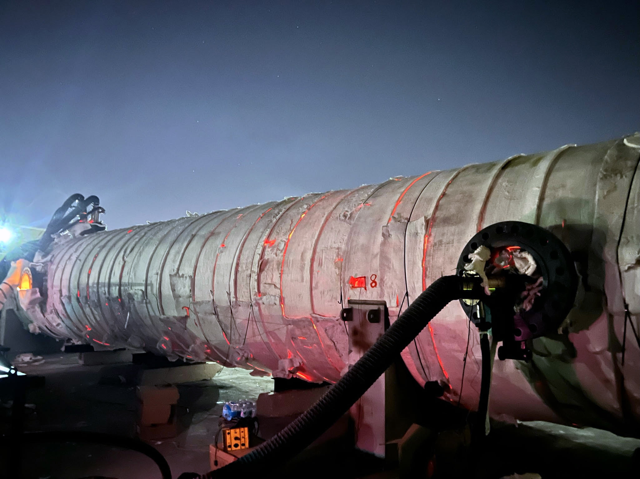

Figure 1: A large pressure vessel glows through the insulation wrap during an overnight PWHT cycle in the Permian Basin. GCC runs continuous temperature monitoring throughout the heat cycle. (Courtesy: GCC)
The execution plan becomes the controlling document for the heat cycle. Any major deviation during execution requires client and management approval before work continues.

GCC uses Type K thermocouples attached directly to the vessel surface using a capacitor discharge spot welder. This creates a true surface junction: The thermocouple wire is welded directly to the steel, making the vessel surface itself the measurement point. Methods that hold the thermocouple junction away from the surface through clips, banding wire, or welded nuts introduce measurement errors that can be significant under PWHT conditions.
Thermocouple placement follows a grid pattern across the vessel shell, with spacing not to exceed 15-foot intervals. Placement accounts for vessel geometry, nozzle locations, and any features — heavy forged nozzles, lifting lugs — that may behave differently from the main shell during heating. On complex jobs, those high-mass features get their own thermocouples and, where needed, supplemental electric resistance consoles to bring them to temperature in step with the rest of the vessel.
Thermocouple count scales with vessel size and complexity. A straightforward job might run 10 to 12 thermocouples. A vessel with heavy forged nozzles and multiple lifting lugs can require 24 or more.

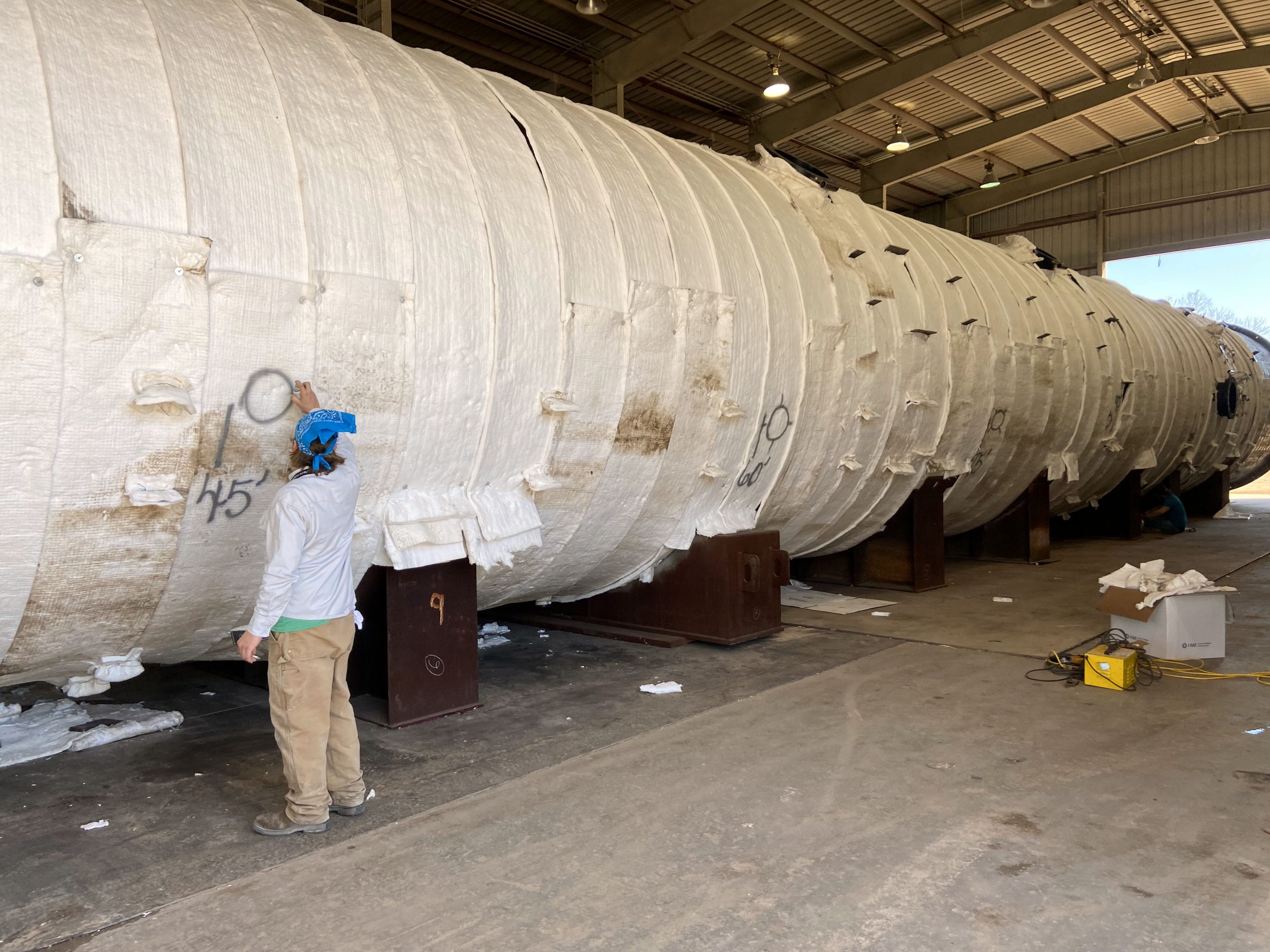

Insulation serves two functions in on-site PWHT: It reduces the BTU input required to reach and hold soak temperature, and it limits the temperature differential across the vessel surface during heating and cooling. Both matter for code compliance and metallurgical outcome.

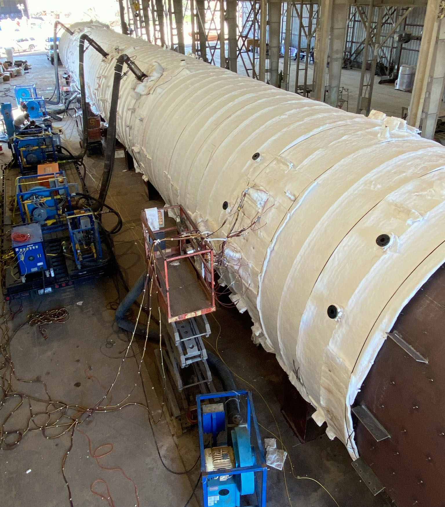

Figure 2: Seven high-velocity gas burners line the base of a 621,000-pound pressure vessel in Central Texas as insulation wrap nears completion. Gulf Coast Combustion documented the full PWHT cycle on this job via time lapse footage. (Courtesy: GCC)
GCC standard insulation is 1-inch, 8 lb/ft3 Kaowool ceramic fiber blanket applied in a single layer around the entire vessel surface with a minimum 3-inch overlap at all seams. The overlap accounts for thermal expansion of the vessel during the heat cycle and prevents gaps from opening as the steel grows. Insulation is secured using carbon steel banding straps and stud pins. All nozzles, attachments, and penetrations are individually insulated to prevent localized cold spots from pulling heat away from adjacent shell sections during soak.
Vessel supports require specific attention. Stationary structural supports cannot remain in contact with the vessel during PWHT. They create cold spots and restrict thermal growth. GCC uses temporary saddles on flat, smooth surfaces with high-temperature lithium grease between the saddle and the surface. The grease allows the vessel to grow and move freely as it expands during the heat cycle.

Figure 3: Elevated view of a large pressure vessel fully insulated and ready for firing. Gas train consoles, burner hoses, and thermocouple lead runs are visible along the full vessel length. (Courtesy: GCC)
