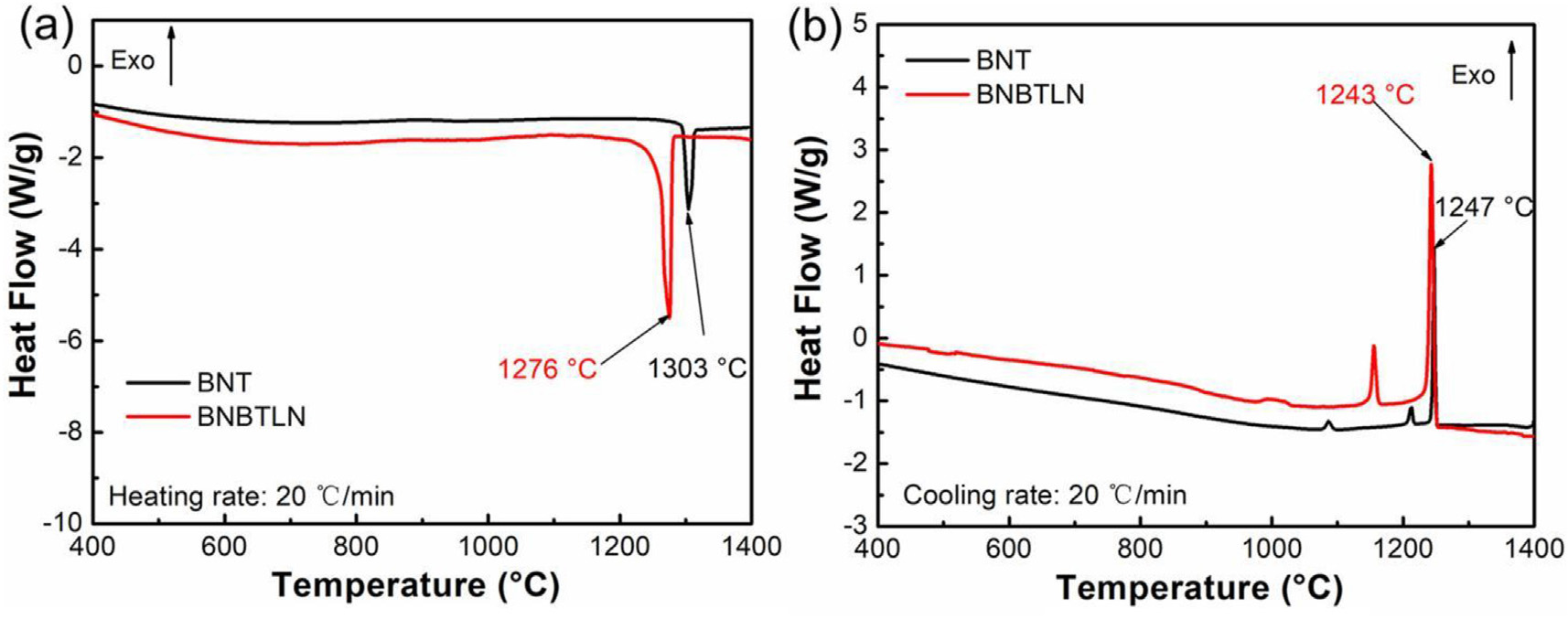

Figure 1: (a) Heating and (b) cooling DSC curves of BNT and BNBTLN ceramic powders.

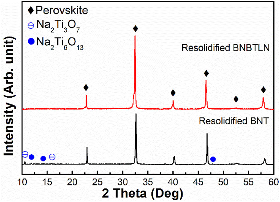

Figure 2: XRD patterns of resolidified BNT and BNBTLN.

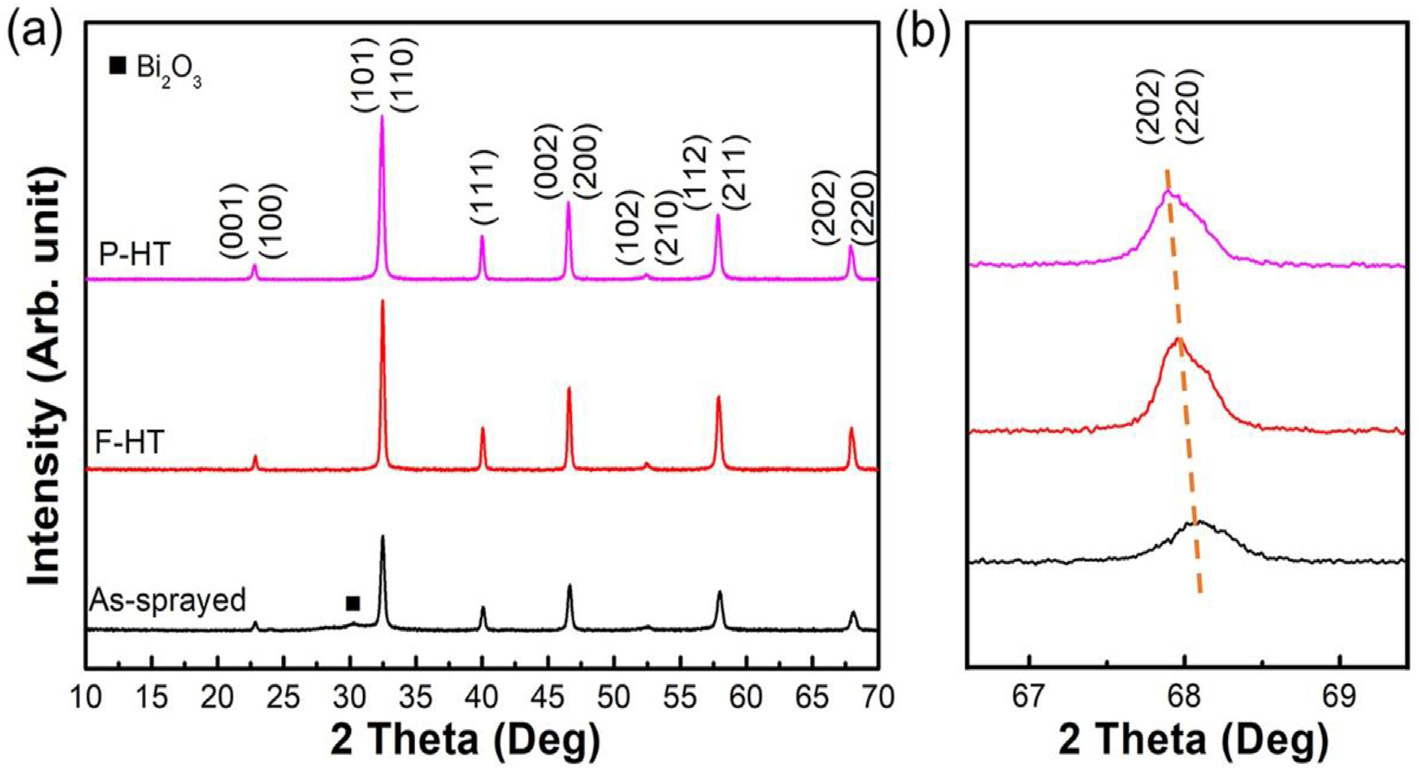

Figure 3: XRD patterns of thermal sprayed BNBTLN coatings before and after heat treatment.

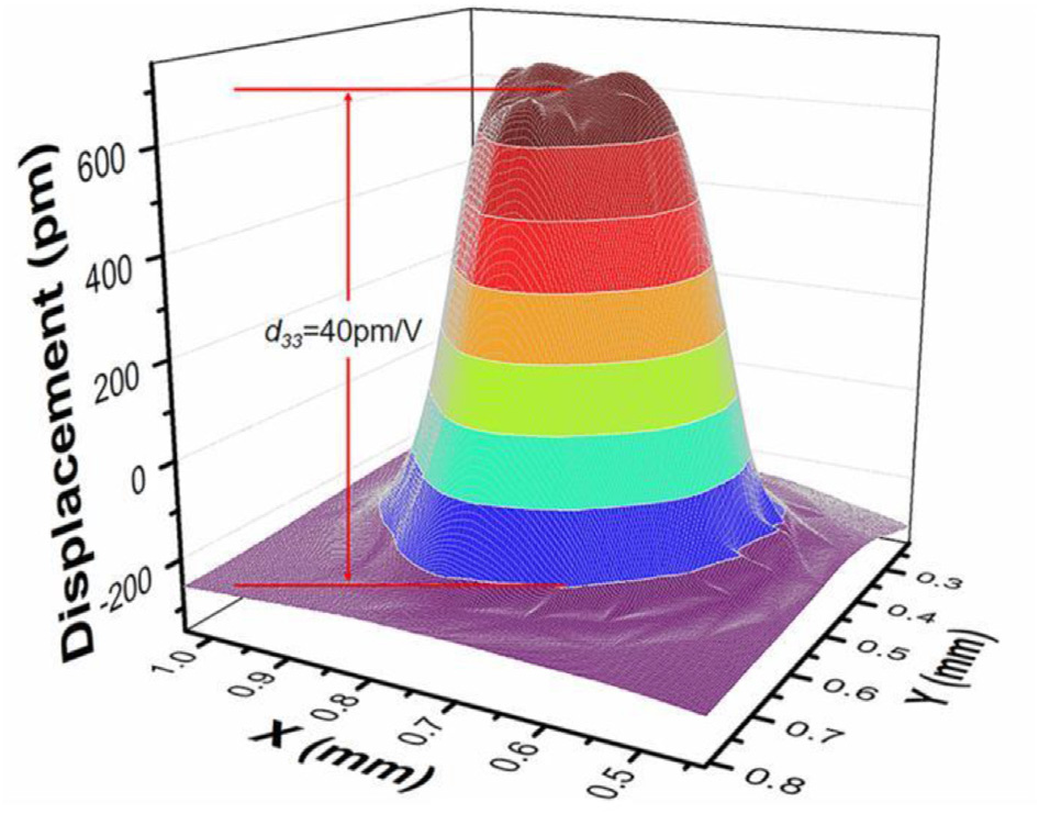

The piezoelectric coefficient (d33) was measured using a laser scanning vibrometer (OFV-5000, PolyTech GmbH, Waldbronn, Germany). BNBTLN bulk samples were also prepared for electrical properties testing as a control. The d33 of bulk ceramic was measured with a piezo-d33 m (ZJ-4B, Institute of Acoustics, Shanghai, China).

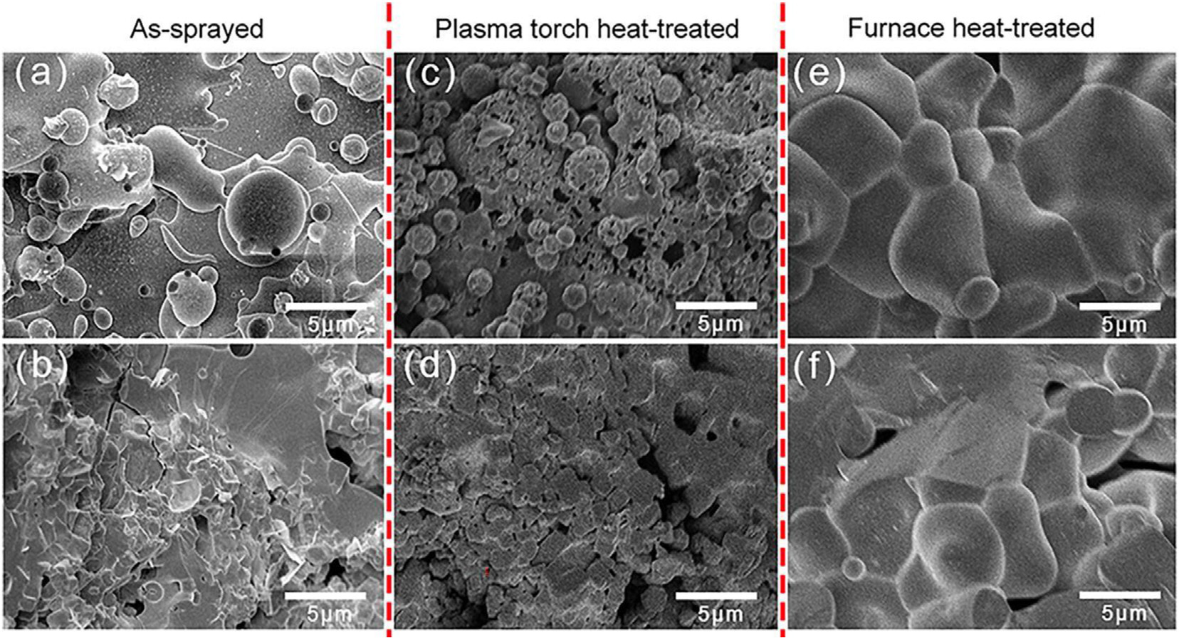

Figure 4: FESEM images of surface (a, c, e) and cross-section (b, d, f) for BNBTLN coating on 316L-TBC: (a) and (b) As-sprayed coating, (c) and (d) Plasma torch heat-treated coating, (e) and (f) Furnace heat-treated coating.

Since the melting-recrystallization process was involved in the thermal spray process, the melting and recrystallization behaviors of BNBTLN ceramic powder were studied in comparison with BNT by the DSC test shown in Figure 1 BNT was reported to be a congruent melting composition [32,33]. The DSC curve of BNT in Figure 1a exhibited a single sharp melting peak at 1,303°C, and BNBTLN showed a similar melting behavior with a lower melting point at 1,276°C. The lithium niobate dopant in the BNT-BT system was believed to contribute to the lowered melting point [34,35]. In the cooling DSC curve of BNT, there was one major sharp peak at 1,247°C, followed by two small peaks on the lower temperature side. BNBTLN had one major sharp peak at 1,243°C, followed by one small peak on the lower temperature side. XRD patterns of the resolidified BNT and BNBTLN were shown in Figure 2. Both exhibit major perovskite phase, which could correspond to the major peaks in cooling DSC curves. In addition, minor Bi-deficient Na2Ti3O7 and Na2Ti6O13 secondary phases were detected in the resolidified BNT due to the more serious volatile loss of Bi than that of Na.

The XRD patterns of thermal sprayed BNBTLN coatings are presented in Figure 3. The as-sprayed coating exhibited a tiny hump of the amorphous phase. After heat treatment, all the BNBTLN coatings showed a single phase of perovskite structure with significantly increased intensity of diffraction peaks compared to the as-sprayed coating, indicating the heat treatment by both furnaces and plasma torch effectively enhanced the crystallinity. Additionally, the diffraction peaks shift to smaller angles after F-HT and P-HT (shown in Figure 3b), indicating a larger lattice space. This phenomenon could potentially be attributed to the presence of tensile stress [36].
Figure 4 presents the FESEM images of the surface and cross-section for BNBTLN thermal sprayed coating before and after the heat treatments. As shown in Figure 4a, the surface of the as-sprayed coating consists of a mixture of spherical and irregularly-shaped particles, which is a typical morphology resulting from rapid cooling and solidification after melting. The morphology indicate that the crystallization was not fully completed from the cool melt in the as-deposited coating [37]. In addition, as presented in Figure 4b, it can be seen from the cross-section of the coating that the grains are uneven with irregular grain boundaries. After heat treatment, a significant increase in grain size and crystallinity was observed. As shown in Figure 4c, a large number of crystallized grains on the surface of the coating can be observed after P-HT. As presented in Figure 4d, the cross-section morphology of the coating after P-HT treatment is relatively dense with a more regular shape than the as-sprayed coating. Furthermore, the incompletely crystallized particles have also been recrystallized during the heat treatment, giving rise to the clear grain boundaries. Likewise, the morphology of the surface and cross-section recorded after F-HT is presented in Figure 4e and 4f, respectively. Due to the longer time and a more uniform heating process, the F-HT produced denser morphology and higher crystallinity than P-HT.

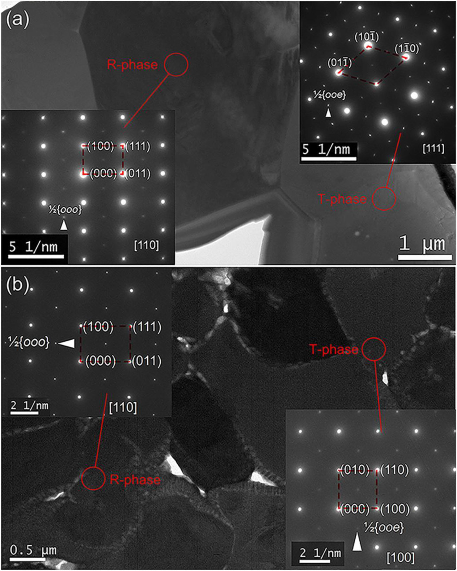

Figure 5: TEM image of BNBTLN coating: (a) F-HT, SAED patterns obtained from the [111] and [110] crystal axes, respectively, with ½{ooe} and ½{ooo} superlattice spots highlighted with white arrows. (b) P-HT, and SAED patterns were obtained from the [110] and [100] crystal axes, respectively, with ½{ooe} and ½{ooo} superlattice spots highlighted with white arrows.
The bright field TEM image in Figure 5a revealed more details of the BNBTLN coating after F-HT, with the selected area electron diffraction (SAED) patterns obtained along [111] and [110] zone axes showing the presence of 1/2{ooe} and 1/2{ooo} superlattice reflections, respectively. The in-phase (a0a0c+) tilting of oxygen octahedrons in the P4bm phase contributed to the presence of 1/2{ooe} superlattice reflections along [110] direction, indicating the perovskite phase had a tetragonal characteristic. The 1/2{ooo} superlattice spots along [110] indicated the antiphase (aaa) oxygen octahedral tilting in the R3c phase, which was not visible in P4mm and P4bm phases [38, 39, 40, 41]. These superlattice diffractions provided solid evidence for the coexistence of R-T phase in the same grain in thermal sprayed BNBTLN coatings after F-HT. The MPB of R-T phase was expected to enhance the subsequent electrical properties, similar to the effect observed in bulk ceramic.
Similarly, Figure 5b presents TEM images of BNBTLN coatings after P-HT, with SAED patterns obtained along [100] and [110] zone axes. The 1/2{ooe} superlattice diffractions in the SAED of [100] direction, in addition to the fundamental perovskite reflections, indicated a tetragonal characteristic of the perovskite phase. The alignment of the 1/2{ooo} superlattice spots along [110], revealed the presence of an R3c rhombohedral perovskite phase in the thermal sprayed BNBTLN coating. This indicated that the MPB of R-T phase also existed in the P-HT coating.
In addition, the measured reciprocal space vector |G(111)| and |G(110)| in R-phase and T-phase for F-HT were 4.43 nm-1 and 3.70 nm-1, respectively. The corresponding real space distances, calculated from the inverse of |GF(111)| and |GF(110)|, were dF(111) = 2.26 Å and dF(1  0) = 2.70 Å, respectively. For P-HT, the measured |GP(111)| and |GP(110)| in R-phase and T-phase were 4.39 nm-1 and 3.61 nm-1, respectively. The corresponding real space distances were dP(111) = 2.28 Å and dP(110) = 2.77 Å, respectively. The distances of dF(111) and dF(110) were greater than dP(111) and dP(110), respectively, indicating that the lattice parameter of P-HT is larger than that of F-HT, which is consistent with the XRD diffraction peaks being shifted.

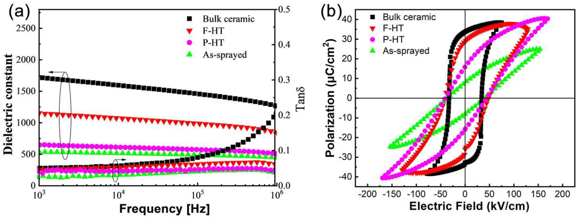

Figure 6: Thermal sprayed BNBTLN coatings: (a) dielectric constant and dielectric loss versus frequency, (b) polarization versus electric field at room temperature, at 10 Hz.

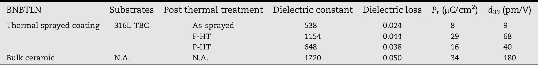

The dielectric and ferroelectric properties of the heat-treated coatings were subsequently investigated and compared to those of bulk ceramics. Figure 6a shows heat treatment significantly enhances the dielectric properties of thermal sprayed BNBTLN coatings, which is mainly attributed to the improved crystallinity and densification of the coating. As presented in Table 1, at the measurement frequency of 10 kHz and room temperature, the dielectric constants of F-HT and P-HT samples are 1,154 and 648, respectively, with the former being significantly higher than the latter, yet still lower than 1,720 of bulk ceramics.
The dielectric loss of the coating after heat treatment is lower compared with the as-sprayed coating. Compared with the as-sprayed coatings, the P-E loop of the BNBTLN ceramic coating after heat treatment shows the remnant polarization increased significantly with improved saturation. While both the F-HT and P-HT processes improved electrical properties of the as-sprayed coating, the F-HT processed coating still exhibited the best dielectric and ferroelectric properties.
Figure 7: Three-dimensional plotting of instantaneous vibration data with the dilatation of the P-HT BNBTLN coating excited by an electric sine wave of 20 V (amplitude) at 1 kHz, measured with LSV under substrate clamping condition.
After poling at room temperature under 55 kV/cm for 10 minutes, the effective piezoelectric coefficient d33 of the BNBTLN coatings was measured by the LSV method [42]. Figure 7 presents the displacement magnitude of BNBTLN coating after P-HT measured under the excitation of a sine wave of 10 V in amplitude at 1 kHz. Since the top (covered with the top electrode) of the 3D plotted data was uneven, the average value over the top area instead of the highest point was used to calculate the effective d33. The thermal sprayed BNBTLN coatings after P-HT had the effective piezoelectric coefficient d33 of 40 p.m./V. In addition, Table 1 also compares the d33 of the thermal sprayed coatings and the bulk ceramic of BNBTLN. The as-sprayed coating shows effective piezoelectric coefficient d33 of 9 p.m./V, which reached 68 p.m./V after F-HT. The d33 of BNBTLN bulk ceramic is 180 p.m./V, which is relatively high compared with the BNBTLN thermal sprayed coatings.
Table 1: Dielectric and piezoelectric properties of BNBTLN coatings measured at room temperature (1 kHz).

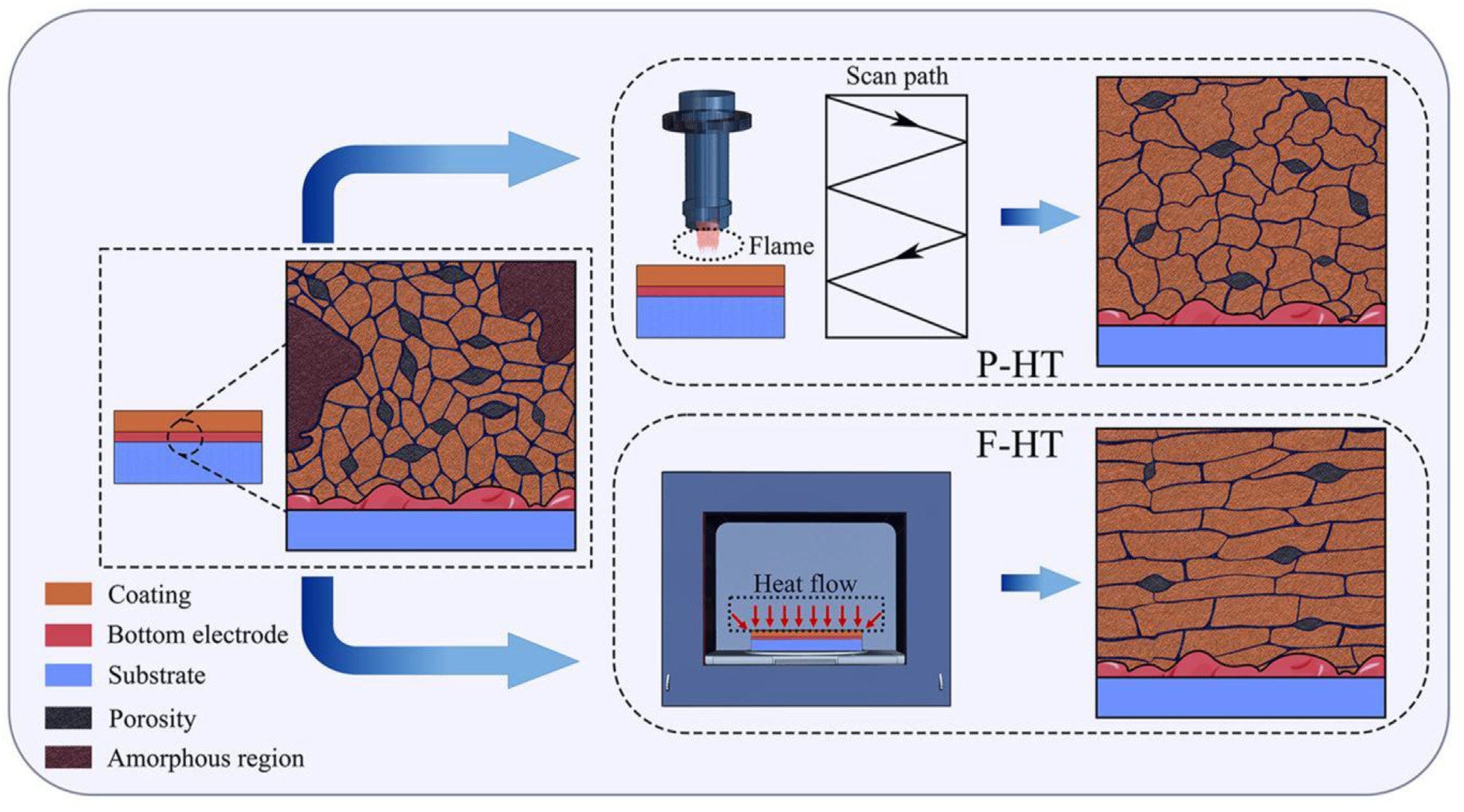

Figure 8 illustrates the process of F-HT and P-HT and the associated grain growth details. The as-sprayed coating exhibits the presence of amorphous regions and a significant number of porosities along with a relatively small grain size. In the conventional F-HT, the workpiece with the thermal sprayed coating is heated to a high temperature through slow heating in the furnace, with the temperature in the furnace relatively stable and the heat flow emanating from all directions.
Figure 8: Schematic diagram of two heat treatment methods and the corresponding growth process of crystal grains.
Prolonged heat flux leads to the gradual disappearance of the amorphous regions involved in the coatings, with the grain boundaries becoming increasingly distinct and the grain size becoming uniform, yet a small number of interlayer voids remained.
The P-HT uses a plasma torch as a heat source, which sprays a plasma flame of extremely high temperature directly onto the surface of the coating and scans the flame on the surface in a back-and-forth manner. At the high temperature of the plasma flame, the grains rapidly crystallize and grow. However, the heat from the plasma torch is directional with sharp interfaces and steep thermal gradients. The inhomogeneous heat source leads to irregular grain size and shape, which hinders the formation of regular layered grain morphology. The temperature change during P-HT of the sprayed coating along the scanning path was much faster, which may not favor formation of uniform nucleation and adequate grain growth. Although the density of the coating after P-HT is not as good as that of the coating after F-HT, the heat treatment time is greatly reduced, and the oxidation damage to the metal substrate is avoided, meanwhile, it is scalable for forming thermal sprayed piezoelectric ceramic coating in large engineering structures. These features are highly demanded for many practical applications, such as in ultrasonic structural health monitoring [43].
