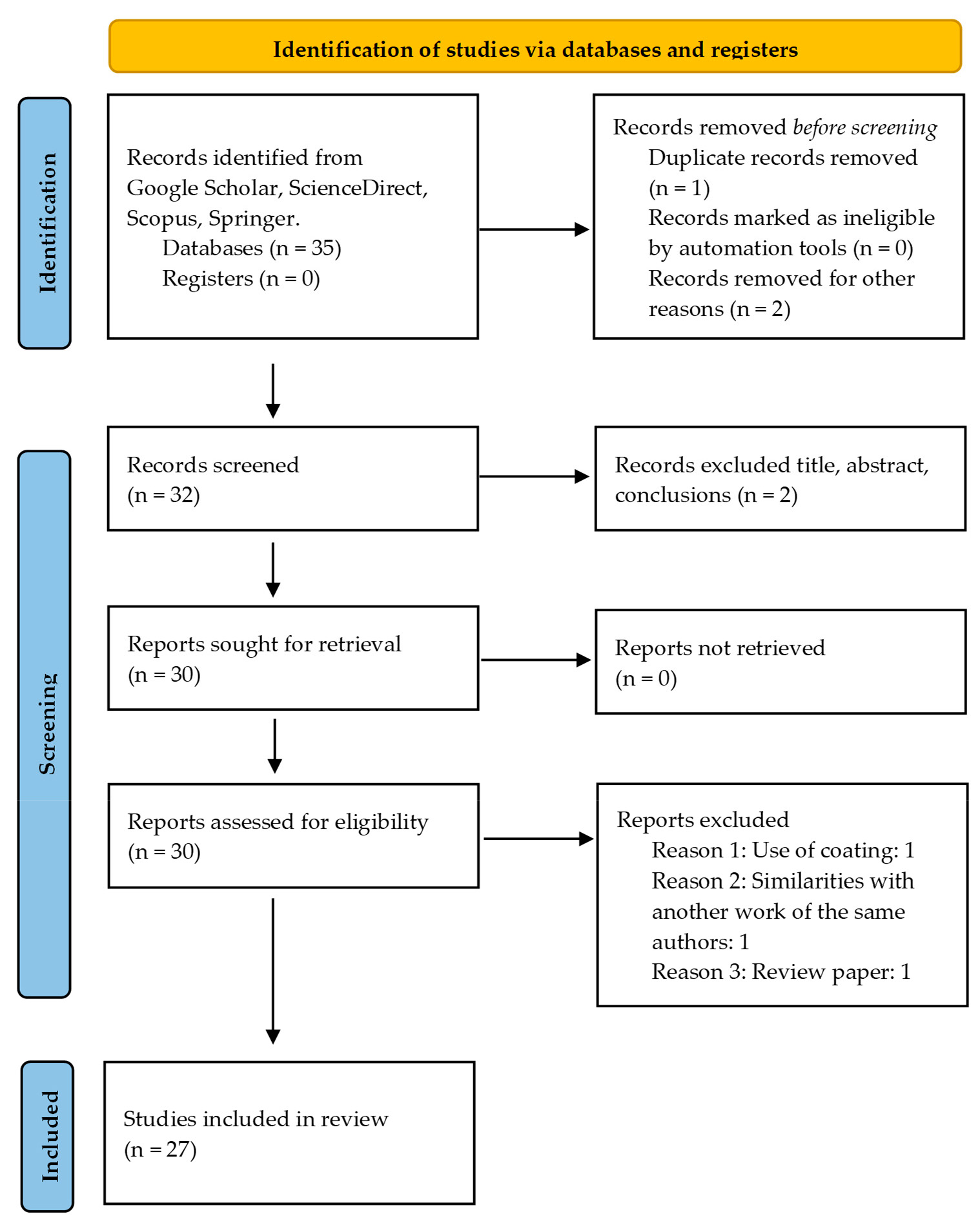

Figure 1: Flow chart according to PRISMA guidelines [24].

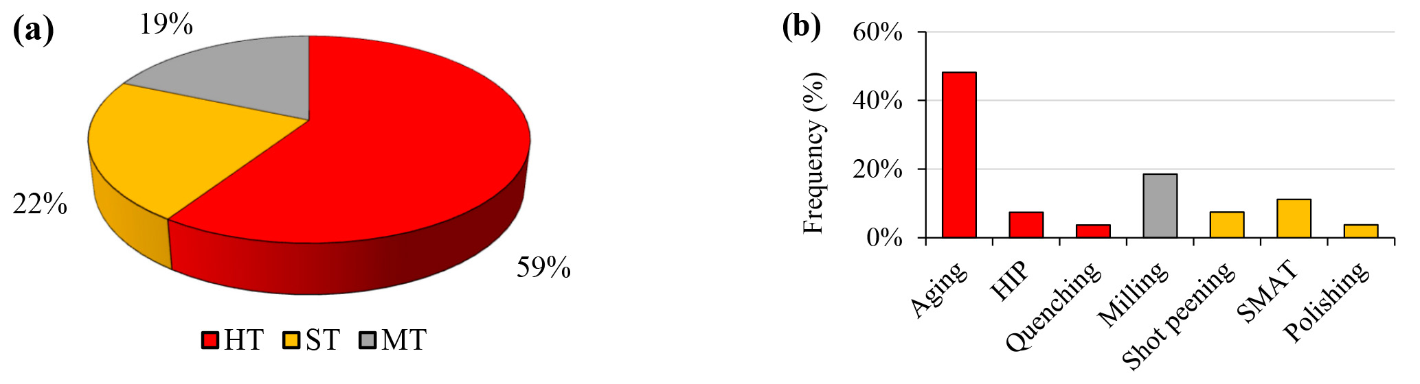

Figure 2: (a) Pie chart of the main post-treatment processes adopted. (b) Specific post-treatment processes mentioned in the analyzed papers. The colors of the bars are derived from the pie chart. HIP refers to hot isostatic pressing and SMAT refers to surface mechanical attrition treatment.

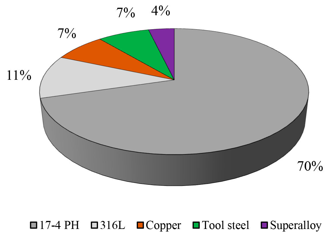

Figure 3: Materials under investigation for post-treatment processes on MEX/M.

According to the literature, MEX/M covers a large range of metal alloys from the most common stainless steels (e.g., AISI 316 L and 17-4 PH) [12,13] to tool steels [14], copper (Cu) and its alloys [15], aluminum alloys [16], titanium alloys [17], and superalloys [18]. This wide variety of materials available for MEX/M allows a range of different properties according to the specific application field. However, the multi-step nature of the technology can generate defects on the sintered parts, making them not directly suitable for the desired scope.

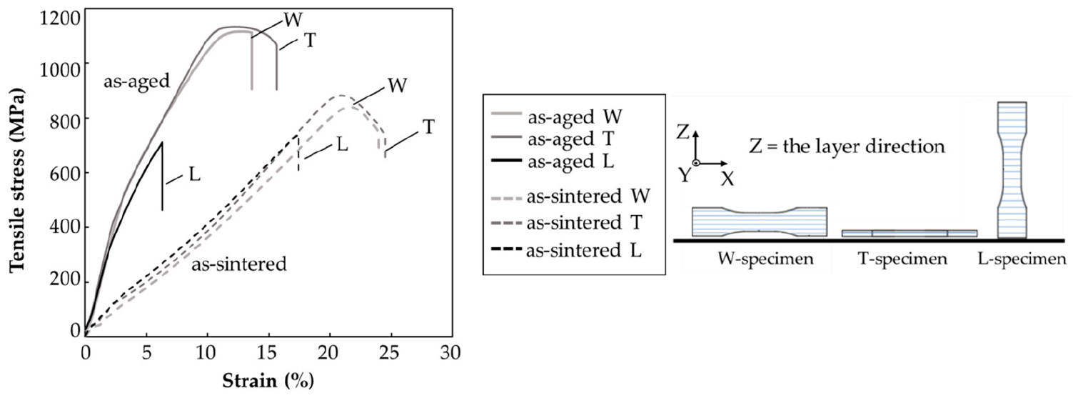

Figure 4: Tensile test curves in the as-sintered condition and the aged one for the different printing orientations. W = on-edge, T = flat, and L = upright. Adopted from [25].

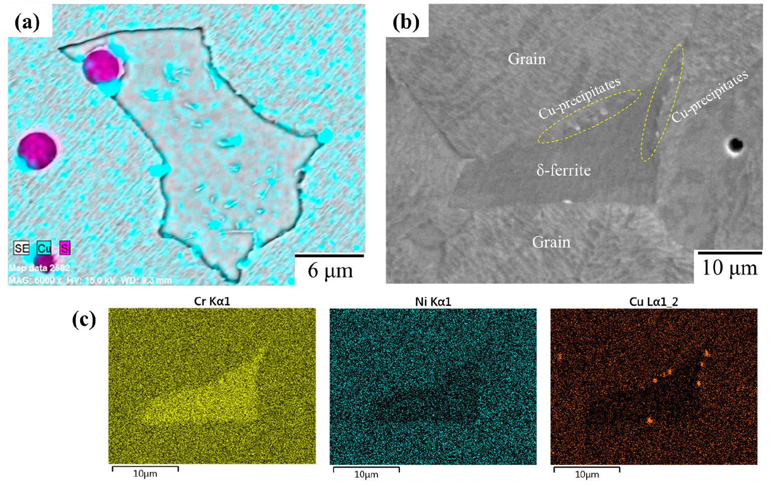

Figure 5: (a) Chemical mapping of copper and silicon on 17-4 PH that is H900-heat-treated [34]. (b) Image of microstructure of a 17-4 PH and (c) relative chemical maps [30].

Following the “Preferred Reporting Items for Systematic Reviews and Meta-Analyses” (PRISMA) guidelines, this review article employed a systematic search strategy as reported in [24]. Relevant studies on the MEX/M post-treatment processes on as-sintered parts from the last five years were considered. Indeed, from this analysis, articles based on the adoption of post-treatment processes on polymer parts produced through MEX and on green parts produced through MEX/M are considered unsuitable. As reported in the PRISMA flow chart (Figure 1), Scopus, Google Scholar, ScienceDirect, and Springer databases are used for the analysis.
Once enough papers were chosen, the selected papers were first analyzed and classified according to the main categories of post-treatments: HT, ST, and MT. Subsequently, the specific treatments applied were identified, as well as the outputs investigated. In detail, three main outputs, such as tensile properties, surface roughness, porosity, etc., were considered to evaluate the effects of the post-treatment processes. Figure 2a reports an overview of the main categories of post-treatment processes adopted in the analyzed papers. Figure 2b, instead, shows the specific techniques and their frequency.

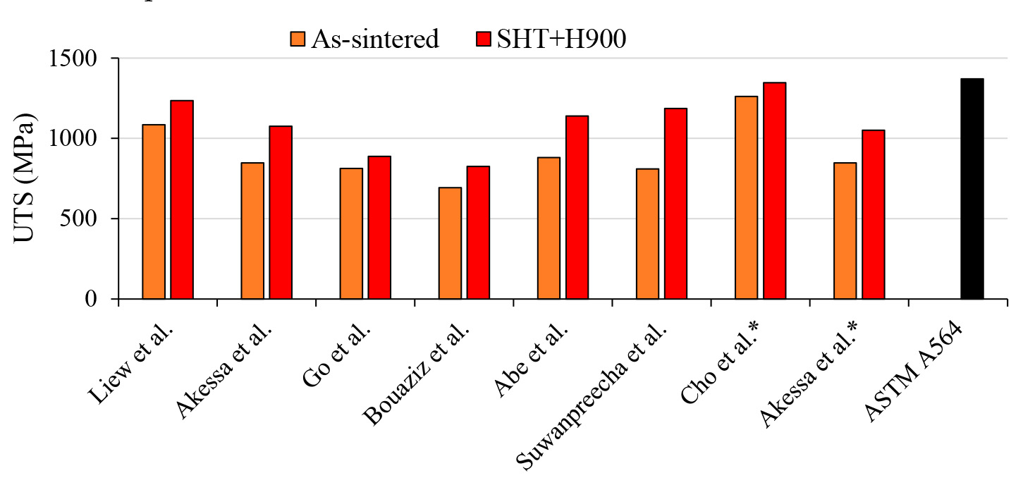

Figure 6: Comparison of UTS values after SHT + H900 for 17-4 PH stainless steel [13,21,26,27,28,29,31,35]. *refers to a cooling in water.

In detail, based on the current literature, the “aging” treatment covers ≈50% of the post-treatment processes adopted (see Figure 2b). Other heat treatments such as hot isostatic pressing (HIP) and quenching are less adopted. The predominance of aging is related to the availability of heat-treatable materials as feedstock for MEX/M, such as the precipitation-hardened martensitic stainless steel (e.g., 17.4 PH). Indeed, as reported in Figure 3, more than 50 percent of the works mentioning a post-treatment process refer to 17-4 PH stainless steel.

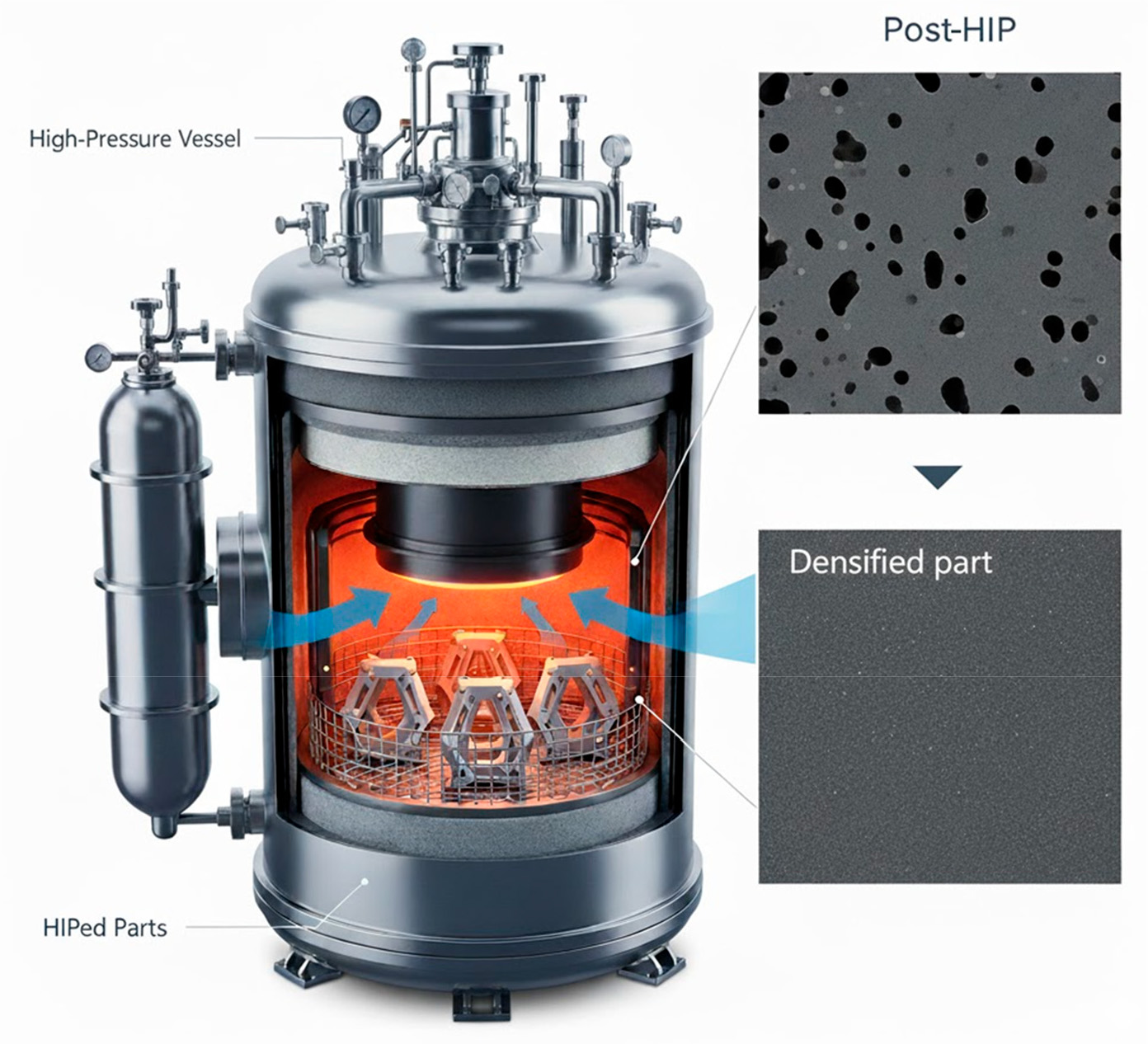

Figure 7: Illustration of a HIP process. *The image was created through an AI assistant tool.

Abe et al. [27] and Bouaziz et al. [28] applied aging on 17-4 PH parts. In both works, the authors considered the H900 treatment (482°C for 1 hour) with a prior solutioning treatment and compared the properties of the as-sintered parts and the aged parts in terms of tensile properties.
The H900 condition is named “peak hardening” condition because the highest values of tensile strength and hardness are reached. Indeed, according to the standard, the minimum tensile strength is 1,310 MPa, the minimum yield strength (YS) is 1,170 MPa, and minimum hardness is 40 HRC. Abe et al. [27] observed for different printing orientations (see Figure 4) an increase up to a maximum of 1,100 MPa of ultimate tensile strength (UTS) starting from a range of 840-880 MPa.
At the same time, as expected, the aged parts became more brittle, with a significant decrease in elongation. Bouaziz et al. [28], instead, using the proprietary system ADAM, observed an increase in UTS of 16 percent in the aged parts compared to the sintered ones. Furthermore, the surface roughness was evaluated. A slight increase in average roughness (Ra) from 4.1 µm to 4.6 µm was obtained, possibly due to the thin external oxide layer generated on the surface after the HT.

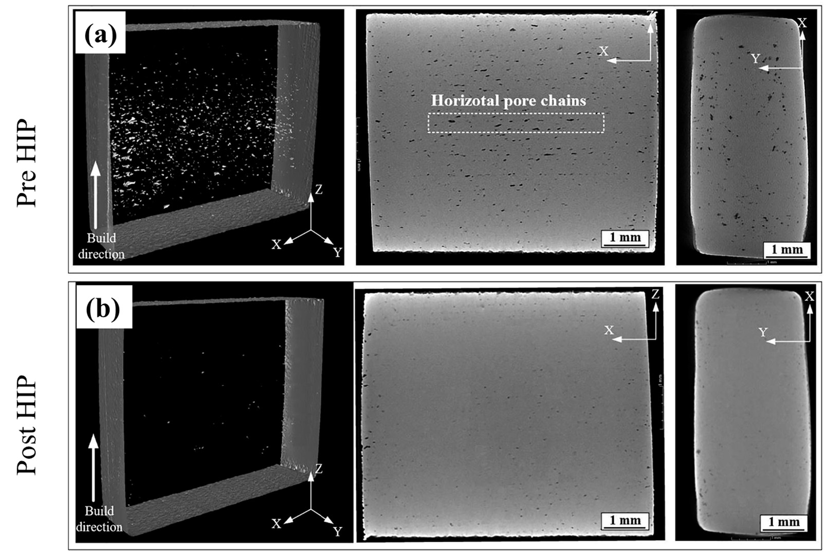

Figure 8: CT image of (a) as-sintered parts pre-HIP and (b) as-sintered parts post-HIP. Adopted from [34].

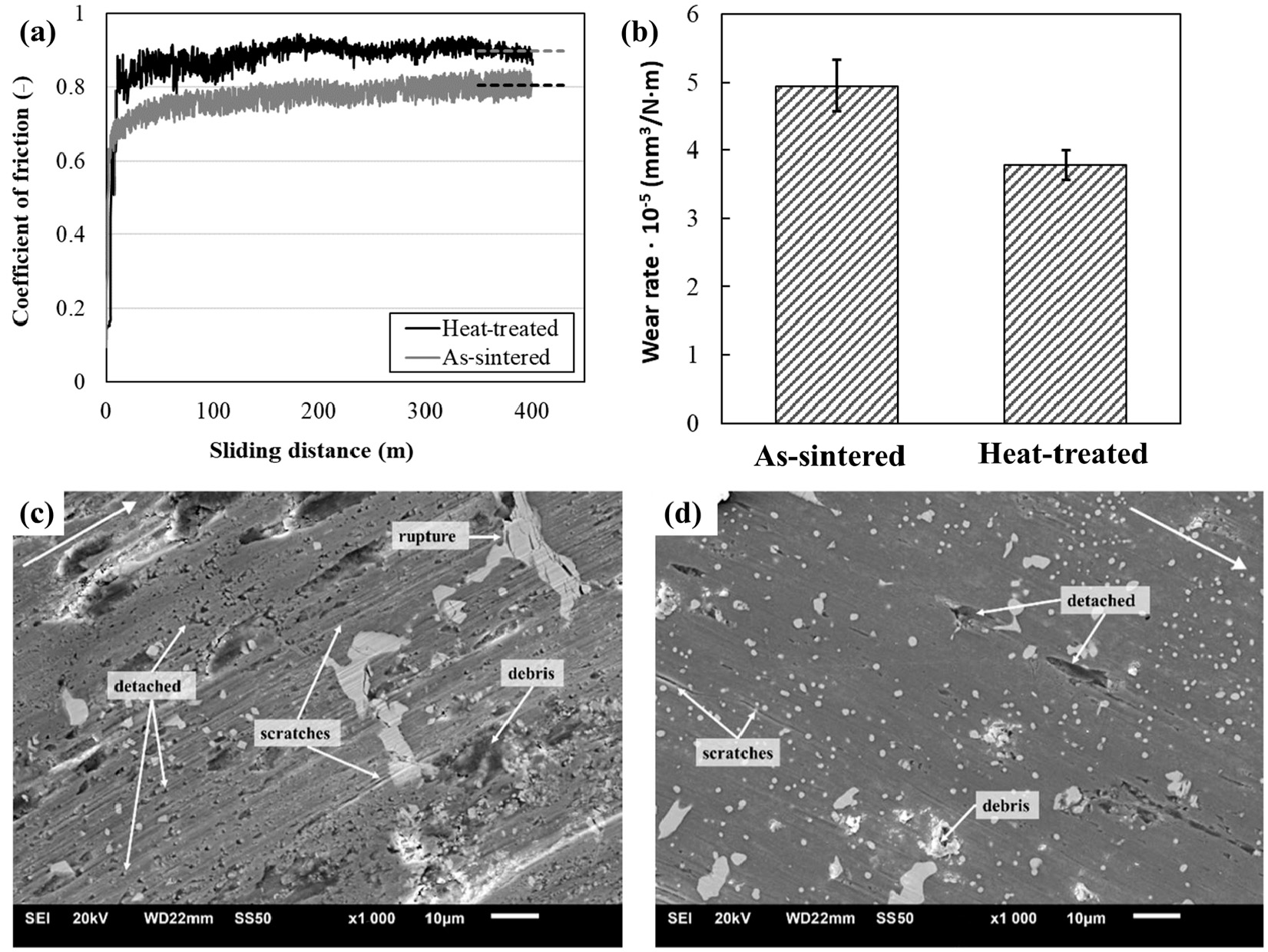

Figure 9: (a) Coefficient of friction (CoF) comparison, (b) wear-rate values for as-sintered and heat-treated M2 samples, (c) wear track on M2 as-sintered, and (d) wear track on heat-treated M2. Adopted from [35].

Liew et al. [31] derived, from the aging treatment (H900 and H1150), interesting results relating to UTS (1,235 MPa) after H900, and to an elongation of 10.9% (≈+203% higher than the as-sintered condition) after H1150. These significant variations, as is widely discussed in the literature, are due to the enrichment of copper (Cu) precipitates in the matrix [30,32,33]. In Figure 5a and 5b, the matrix of 17-4 PH parts with a significant enrichment in copper can be seen.
The tendency of Cu-precipitates to deposit on the grain boundaries emerged from the chemical mapping (see Figure 5b). However, when increasing the aging temperature and aging time, the Cu-precipitates tend to be coarse, favoring the increase in ductility. On the other hand, authors [31] found a notable result related to the pitting corrosion resistance that increased with the aging treatment, compared to the as-sintered condition. In detail, when overaged, the highest pitting potential (Epit) is achieved.

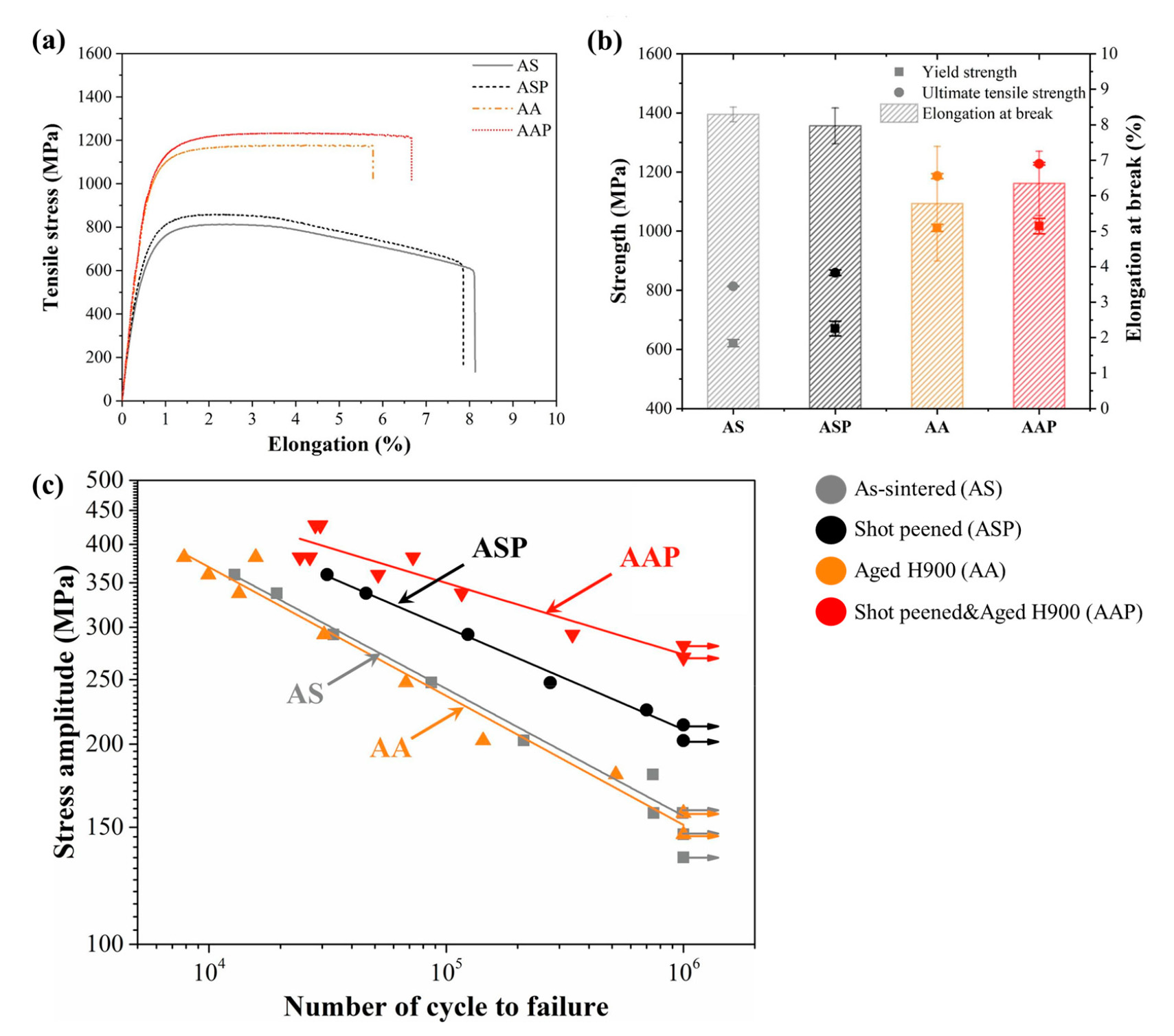

Figure 11: Results comparison of (a) tensile test curves, (b) tensile properties, and (c) fatigue test. Adopted from [13].
With the aim of making a comparison of the above mentioned results, Figure 6 reports the UTS achieved in the as-sintered on 17-4 PH parts after SHT + H900. Despite receiving the same post-treatment process procedure, notable differences were observed between the studies. Bouaziz et al. [28] reached the lowest UTS after SHT + H900 (825 MPa), despite Liew et al. [31] and Akessa et al. [29], using the same MEX/M technique (e.g., ADAM), reaching 1,235 MPa and 1,075 MPa, respectively.
In the same way, in the work of Go et al. [21], the differences between as-sintered and aged were minimal (≈9.3%). In this case, a different sintering procedure, due to the different feedstock, can alter the result of the aging process. Finally, as observed in [29], when water was used as cooling agent, a notable increase in strength was achieved due to the rapid cooling of the quenching and the arising of the martensite phase.

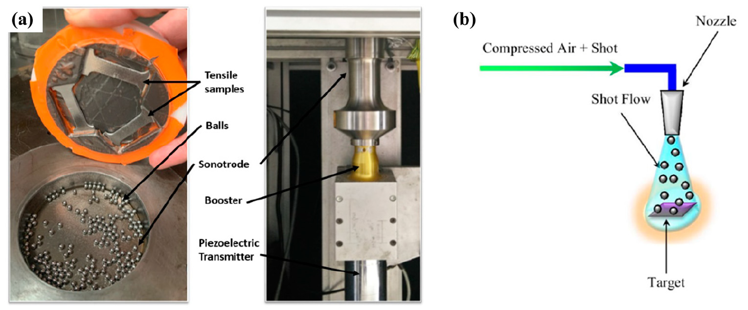

Figure 12: (a) Representation of SMAT [38] and (b) shot peening process [22].

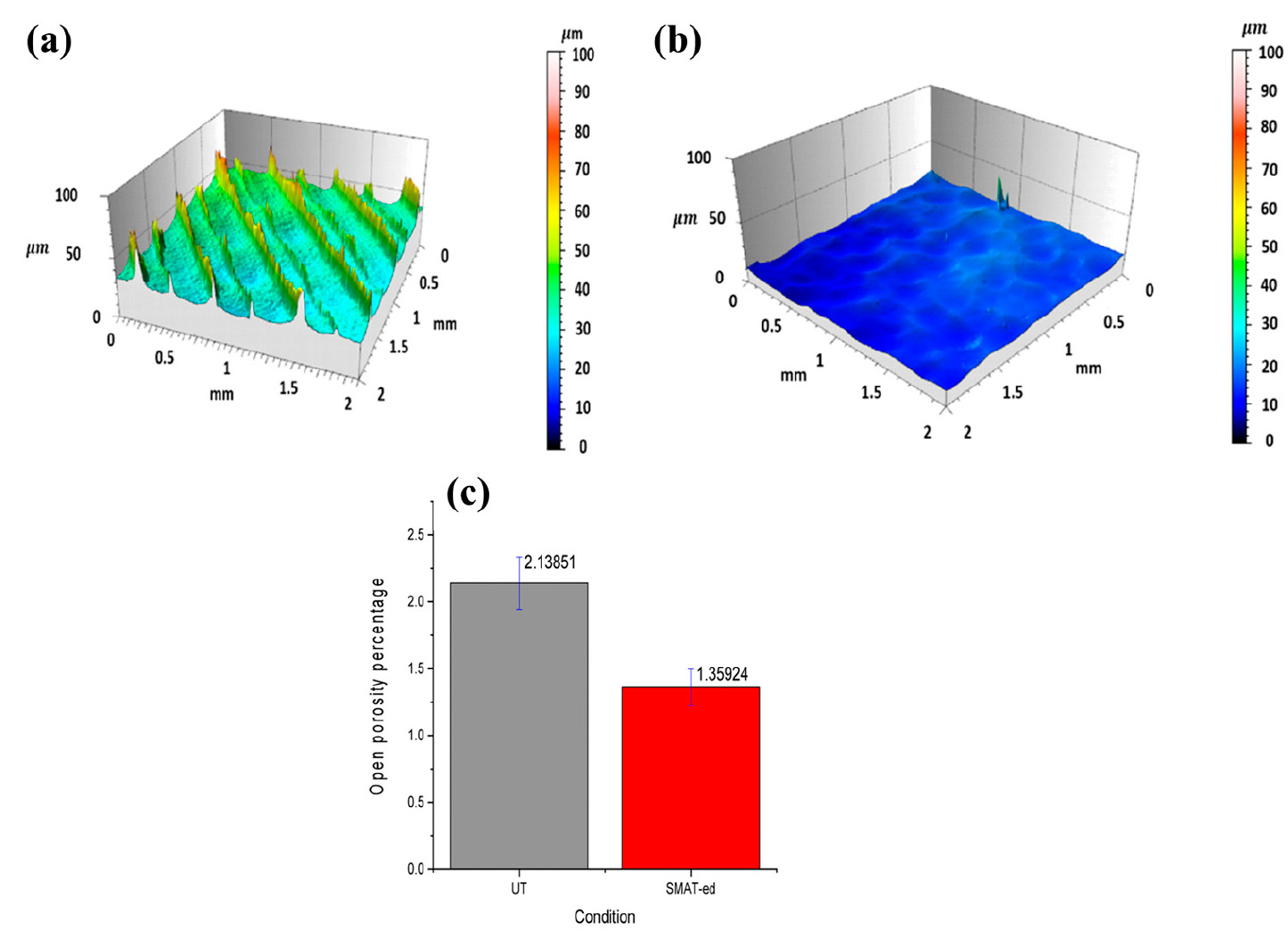

Figure 13: Three-dimensional profile of sample in (a) as-sintered condition and (b) SMAT condition. (c) Comparison between as-sintered and SMATed sample in terms of open porosity. Adopted from [40].

Hot isostatic pressing (HIP) is a well-known heat treatment fundamental to consolidating metal powder, increasing density, and reducing porosity [23]. Generally, the process involves placing the part in a high-pressure furnace and subjecting it to both high temperature and uniform pressure from an inert gas such as argon (see Figure 7).
HIP is a crucial process for AM metal parts thanks to its capability to reduce porosity occurring during the manufacturing process. In this context, HIP for sinter-based processes such as the MEX/M can have a pivotal role. Nevertheless, the literature reports few examples about the use of HIP on MEX/M parts. Wang et al. [36] applied HIP for the first time on 316 L parts fabricated via MEX. As expected, the most significant result was in terms of porosity. Indeed, the authors decreased the porosity from 7.5 percent in the as-sintered parts to 0.3 percent in the HIPed parts, as reported in Figure 8a and 8b, respectively. Therefore, the reduction in porosity suggested an improvement in the mechanical properties, such as the tensile ones. Indeed, the UTS increased from 412 MPa to 540 MPa (+31%).

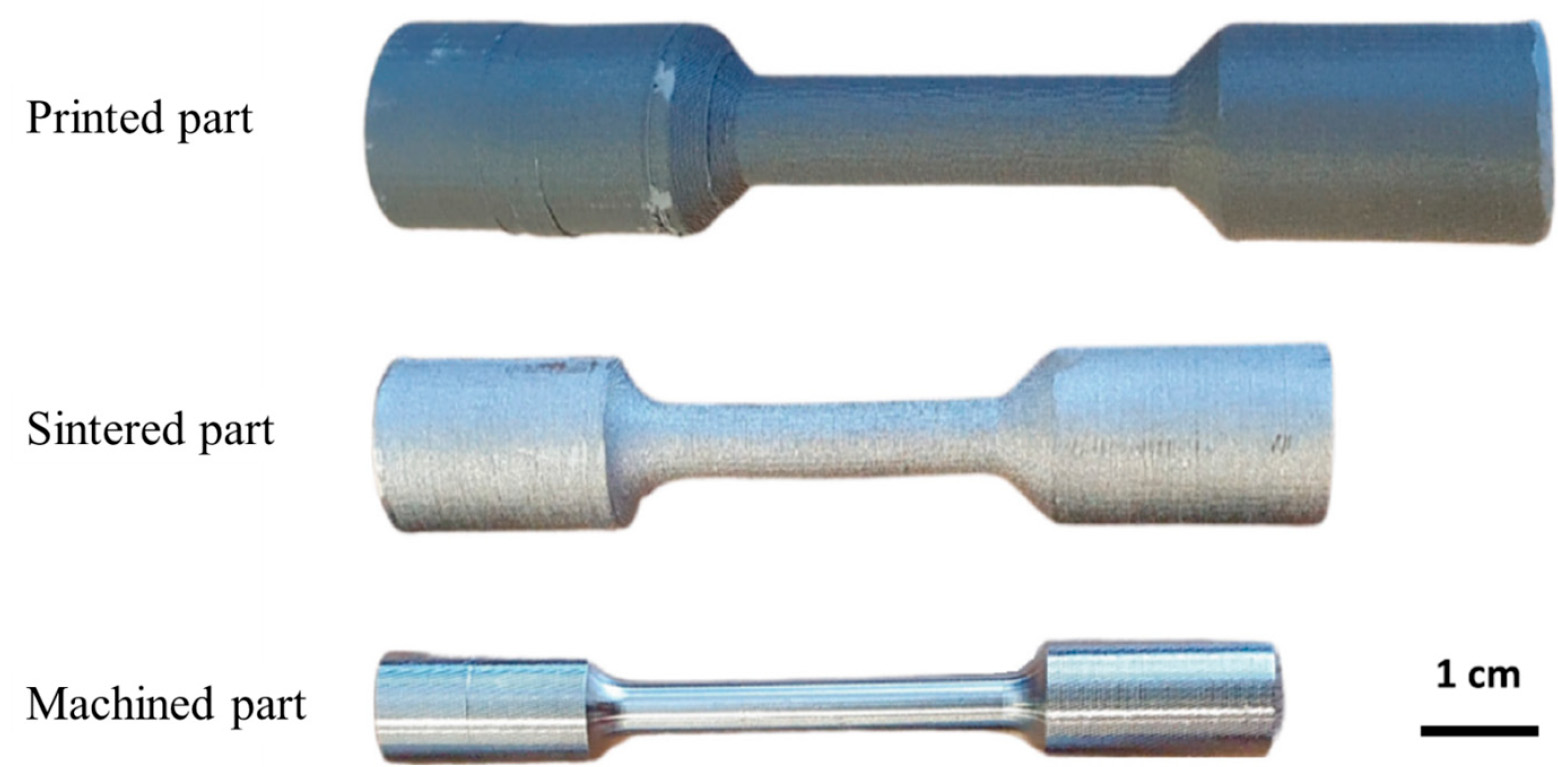

Figure 14: Fatigue test sample after printing, sintering, and machining. Adopted from [12].
Ajjarapu et al. [15] analyzed the effects of the HIP process on pure copper parts. As for the previous work, the HIPed parts achieved a density of 97.7 percent, leading to higher UTS (+10%), higher elongation (+40%) and a higher Young’s Modulus (+100%). Furthermore, the authors evaluated the intrinsic properties of copper such as the electrical conductivity, pre- and post-HIP. A dramatic increase in the electrical conductivity, close to 100 percent of IACS (International Annealing Copper Standard), was achieved thanks to the higher densification provided by the HIP process.
From Figure 2b, other heat treatments, such as quenching, have been less extensively investigated for metal parts fabricated via MEX. Generally, quenching is employed to increase the hardness of the metal through rapid cooling in water, oil, or gas. To reduce the brittleness introduced by quenching, a subsequent tempering step is often performed to enhance the toughness of the metal.
An example is reported by Naranjo et al. [37] on M2 tool steel produced through MEX technology. The authors heated MEX parts up to 1,180°C and performed oil quenching in the first step, followed by tempering at 525°C in a secondary step. They highlighted the benefits of heat-treating the parts, noting that the microstructure became more homogeneous, with a phase transformation from austenite to martensite and an enrichment of carbides, which resulted in increased hardness. Hardness in the as-sintered condition was ≈45 HRC and moved up to ≈62 HRC after the quenching and tempering cycles.

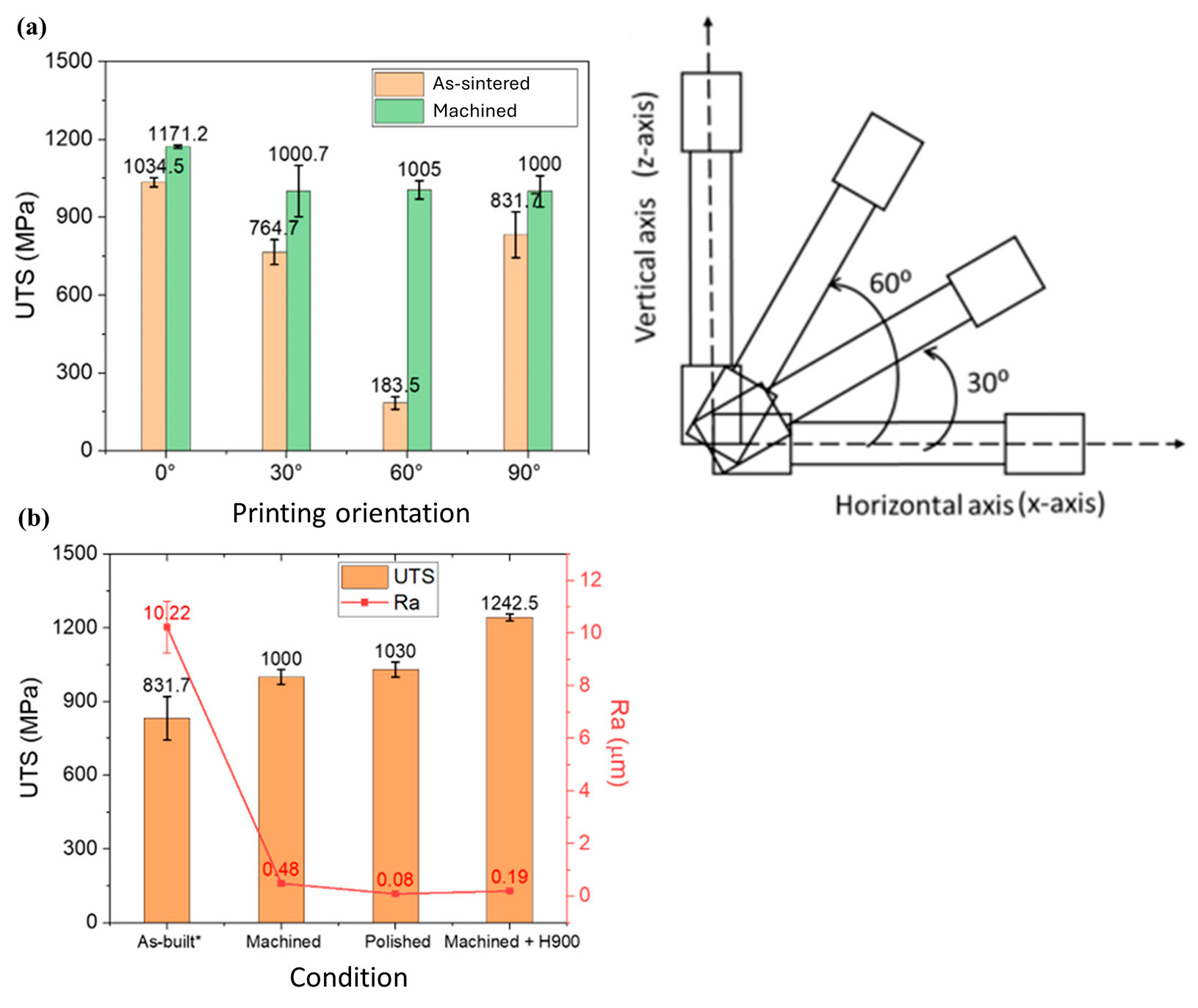

Figure 15: (a) Comparison of UTS values for the different printing orientations in as-sintered condition (orange bar) and machined condition (green one). (b) 90° printing orientation: UTS and Ra values for the different conditions. Adopted from [43].
Finally, the authors analyzed the tribological properties of the as-sintered and heat-treated parts. M2 tool steel, indeed, is often adopted in highly complex working conditions. The heat-treated parts showed better tribological properties than the as-sintered counterparts thanks to a higher hardness that generated a higher coefficient of friction (CoF) and a lower wear rate (see Figure 9a and 9b, respectively). The wear effects on the surfaces for an as-sintered sample (Figure 9c) and a heat-treated one (Figure 9d) are reported.

In Figure 2a, the papers related to the surface post-treatment are only 16 percent of the total, and when including machining technology as well, the total is lower than 40 percent. The modification of the surface properties of MEX/M parts is performed exclusively through mechanical treatments. In detail, it is requested that a tool (e.g., cutting tool, media, or granules) with determined characteristics, deforms, removes, or finishes the material surface (Figure 10).

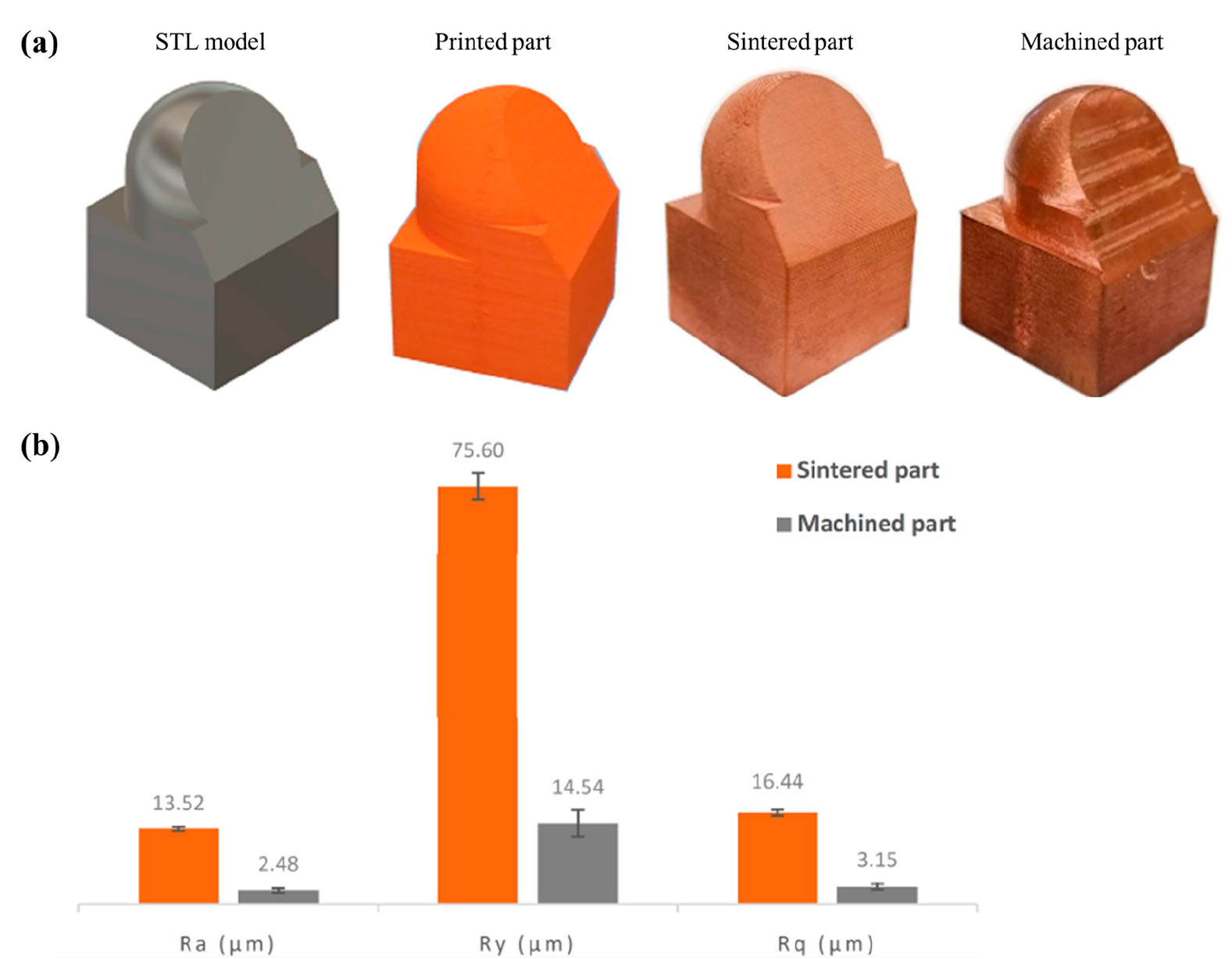

Figure 16: (a) Different stages of the methodology. (b) Roughness parameter comparison (as-sintered vs. machined). Adopted from [44].
Based on Figure 2b, shot peening, surface mechanical attrition treatment (SMAT), and polishing were the adopted processes. In this section, the machining is excluded from the discussion because it will be discussed more deeply in a dedicated section.

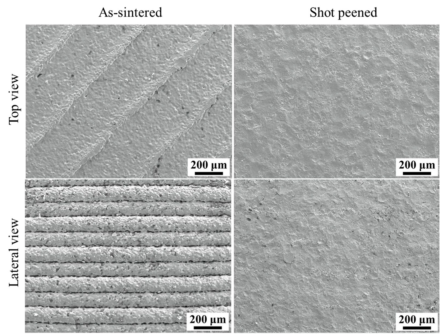

A significant contribution to this topic was proposed by Suwanpreecha et al. [13]. In their work, they showed how different post-treatment processes can affect MEX parts’ characteristics. In detail, the authors used a shot peening process on 17-4 PH samples and evaluated different outputs such as surface roughness, tensile properties, and fatigue strength. The comparison for the top surface and lateral surface between the as-sintered and shot-peened samples is reported in Figure 10. The shot peening process removed any potential characteristics of MEX parts.
Indeed, the typical layer-wise effect (lateral view) was completely removed, and the deposited strands were absent. In this context, the surface roughness (Ra) decreased dramatically from 6.60 ± 0.84 µm to 2.90 ± 0.14 µm on the top faces and from 15.80 ± 1.00 µm to 3.40 ± 0.30 µm on the lateral faces. Furthermore, the reduction in surface roughness allowed the sample to obtain a slight increase in tensile properties (+5.6% in UTS, +7.9% in YS) and significant improvement in fatigue strength (+46.2%).

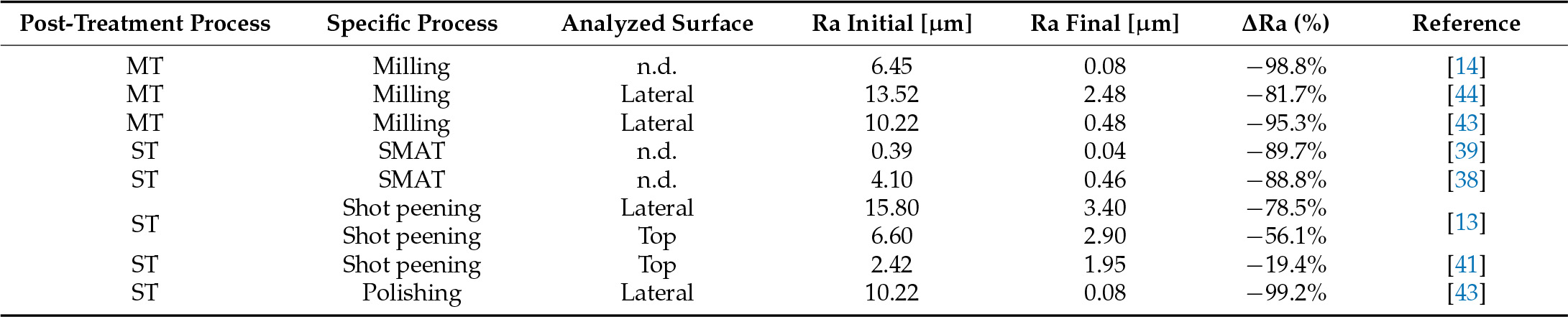

Table 1: Comparison of surface roughness values for different post-treatment processes.
However, the authors obtain the best UTS, YS values and fatigue properties when the samples were shot peened and aged as reported in Figure 11a-c. These findings suggest how a combination of two or more post-treatment processes can be the right way to overcome the defects of the parts and the technological limitations of MEX/M.
To improve the tensile properties and surface roughness of 17-4 PH parts, Chemkhi et al. [38] adopted the SMAT process, a variant of the shot peening process with a multitude of parameters. SMAT consists of the high-frequency vibration of spherical balls (see Figure 12a) that creates a nanocrystallized layer at the material surface. On the other hand, the shot peening process (see Figure 12b) is a cold-working process that uses a stream of small shots to affect the material’s surface. Chemkhi et al. [38], through SMAT, observed a notable increase in UTS from 500 MPa to 700 MPa (+40%), along with a remarkable reduction (≈90%) in the roughness measured on the top faces. The notable increase in the UTS appeared to be strictly related to the reduction in Ra and potential superficial defects that can generate crack initiation in the part.

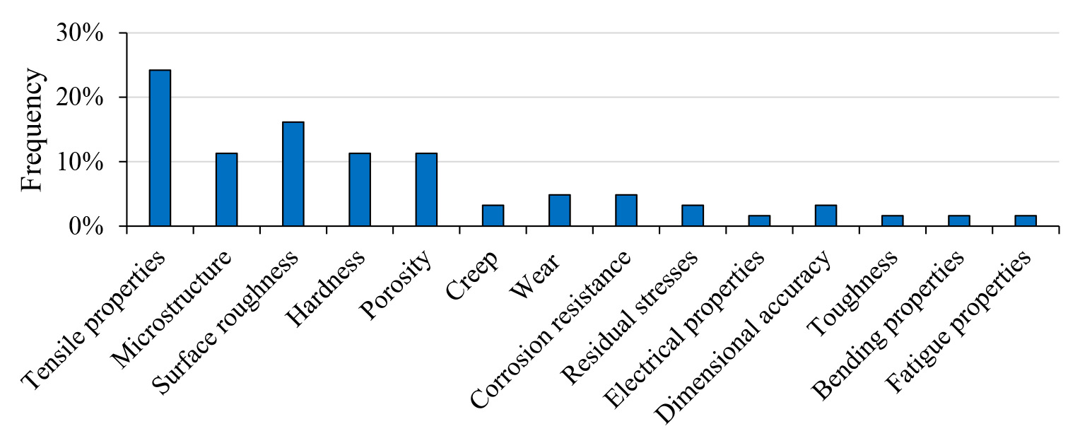

Figure 17: Analysis of the investigated properties based on the analyzed literature.
Indeed, the multiple shots that impact on the surface increase the hardness of the material, induce compressive residual stresses [22], and modify the grain size. All these characteristics typical of a surface mechanical treatment can enhance the mechanical response of the parts. Gong et al. [39], similarly, applied the SMAT technique on 17-4 PH samples and investigated its effects under mechanical loading. Firstly, the UTS tended not to vary; instead, the elongation of the SMATed samples reduced due to the hardening of the material (from ≈2.6% to ≈2.1%).
Significant results, instead, were observed in the surface porosity. Indeed, SMAT reduced the pore content on the surface, also known as “open porosity,” and their size in the initial stage under load (about 1.5 percent of strain). More than 1.5 percent of the strain, the pores closed through SMAT reopened, and no differences between the as-sintered and the SMATed ones are observed. Finally, a significant impact of the SMAT was observed in the deformation mechanism and crack propagation thanks to the reduction in superficial defects, pores, and surface roughness.
The SMAT process also appeared beneficial for the tribological and corrosion behavior of 17-4 PH parts. Indeed, the decrease in roughness (see Figure 13a, 13b) and the closing of the open porosities (Figure 13c) reduced the wear of the parts through abrasion and adhesion and at the same time avoided triggering of corrosion crevices. Naim et al. [40] indeed observed a reduced wear rate of the SMATed samples compared to the as-sintered ones. Furthermore, the corrosion properties, such as potential (Ecorrosion), current (Icorrosion), and localized potential (Elocalized) improved after SMAT.
As for the SMAT process, shot peening process parameters must be optimized to avoid undesired results. Hence, Suwanpreecha et al. [41] analyzed the effect of the shot peening time (5, 25, 50, and 75 minutes) on 316 L parts fabricated through BMD using hydroxyapatite as material media. After an initial decrease to 1.95 µm at 25 minutes, the Ra started to increase, becoming higher than the as-sintered condition at 75 minutes (2.57 µm vs. 2.42 µm). However, at the highest exposure time, the best results in terms of microhardness and tribological properties (coefficient of friction and wear rate) were obtained thanks to the induced work hardening mechanism of the post-treatment process.

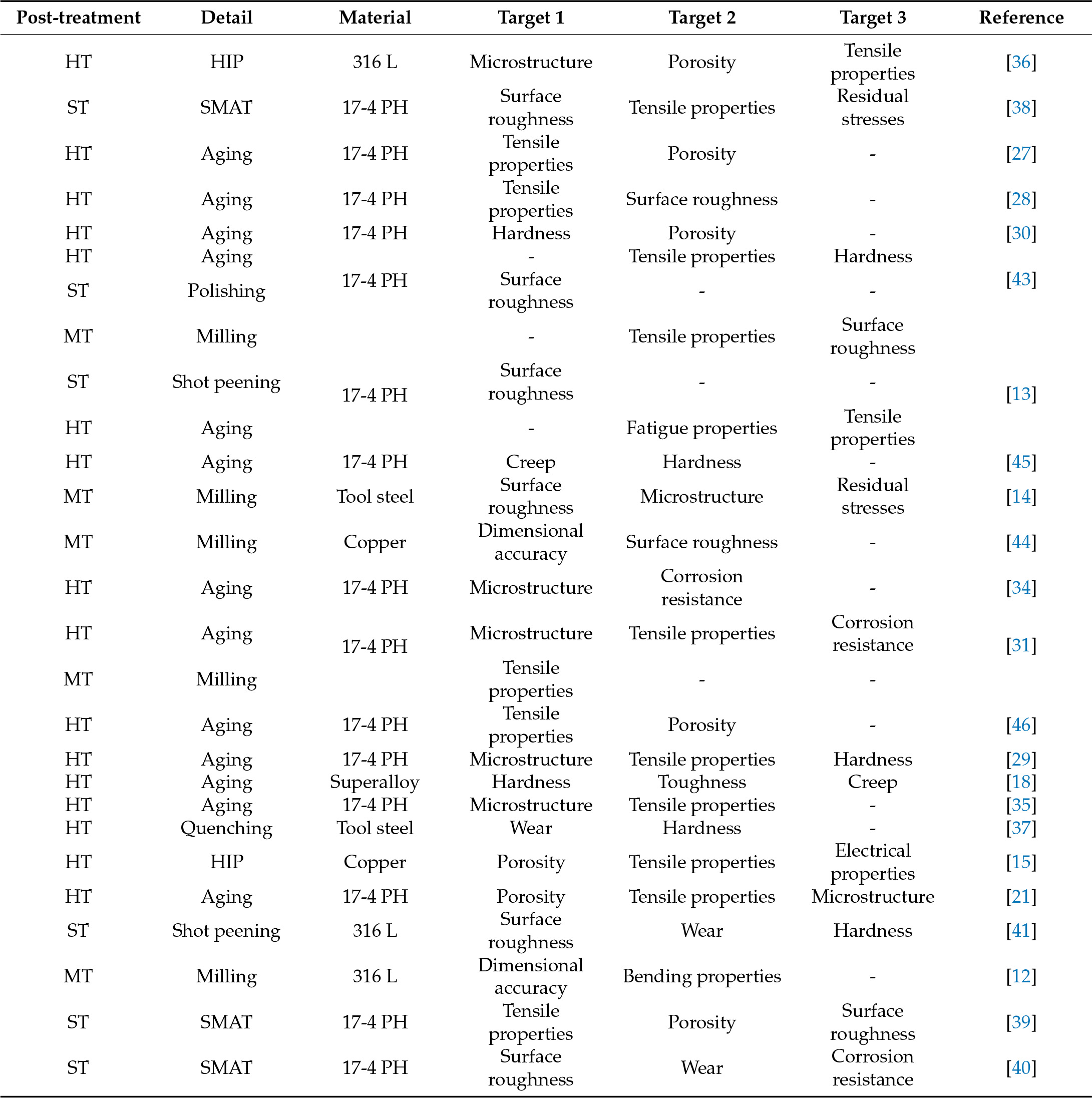

Table 2: Summary table of post-treatment process category and detail, material and main properties investigated for each author. HT (heat treatment), ST (surface treatment), MT (machine technology).

CNC machining was adopted by Tecelli et al. [43] and Jansa et al. [12] in their respective works. Jansa et al. [12] adopted the CNC machining for each sample test, as reported in Figure 14. In addition, the authors observed how the machining provided significant improvements in the elastic modulus of the samples tested under a bending test (about two times) and in the flexural stress, which was about 8 to 11 percent higher than in the as-sintered condition.
Tecelli et al. [43] observed how the machined test samples reduced the initial surface roughness along the printing orientation (the most critical one) from 10.22 µm to 0.48 µm and enhance the UTS along each printing orientation as reported in Figure 15a, 15b. However, the improvement in Ra and UTS appeared lower compared to the machined and polished samples (0.08 µm and 1,030 MPa, respectively), but higher if compared when the samples are machined and H900 aged. These results confirmed the observation in [13] that the combination of the post-treatment processes enhances the properties of the MEX/M parts.
With respect to the previous work, Monzón et al. [44] reported an interesting approach for the hybrid manufacturing of MEX/M Cu-parts. The aim of their study was to provide an analysis of dimensional characteristics and surface characteristics of different types of test artifacts realized through ADAM technology. These parts belong to the standard ASTM 52902:2019.
The process chain consisted of the printing, debinding, and sintering of the artifacts, subsequent analysis of the reduced dimensions after sintering due to the shrinkage, computation of the oversizing factors for machining process, and validation of the methodology. The results obtained allowed them to define the oversizing factors for a complex part in a hybrid manufacturing process chain (see Figure 16a). In Figure 16b, instead, the surface properties in terms of roughness (Ra, Ry, and Rq) were evaluated pre- and post-machining treatment, and an overall decrease ≈81% was obtained.

The comparison of the effects of surface roughness for the investigated post-treatment processes is reported in Table 1. The analyzed surface is considered due to the evident differences that MEX/M parts show between the lateral faces and the top face. When the authors did not specify the surface of analysis, “n.d.” is reported.
In summary, significant improvements were observed after each post-treatment process, with a final Ra value in the range of 0.08-2.48 µm after machining, 0.04-0.46 µm after SMAT and slightly higher after shot peening at 1.95-3.40 µm. Polishing, instead, allowed the achievement of a final Ra equal to 0.08 µm, with the highest percentage variation (ΔRa%) being equal to minus-99.2% with respect to the as-sintered condition. The ΔRa% was calculated as the percentage variation in Ra before the post-treatment process and after.

In this section, an overview of the analyzed and discussed papers is reported in Table 2. A representative graph of the main investigated properties is reported in Figure 17.
