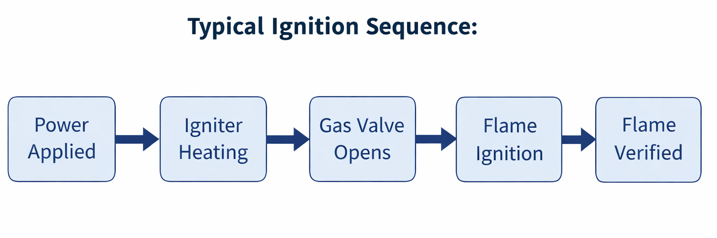

A hot surface igniter operates within a timed, self‑proving ignition sequence to help ensure safe, reliable burner light‑off. (Courtesy: Surface Igniter)
How a hot surface igniter works in a safety critical sequence
A hot surface igniter functions as part of a controlled ignition system rather than as a simple heating element. In many gas‑fired appliances, the ignition process follows a defined sequence: The igniter is energized first and allowed to heat before the gas valve opens. This approach ensures a reliable ignition source is already present when fuel is introduced.
Technical guidance on gas appliance design often describes these systems as “self‑proving.” Electrical current heats the igniter and, after a timed delay, signals the gas valve to open — a method widely used in ovens and other gas‑fired equipment. Manufacturer documentation typically reflects a similar sequence: purge, igniter energizing, gas release, and flame verification.
Because of this controlled sequence, hot surface ignition is considered safety‑critical. Ignition is not a chance event but a deliberate, timed process designed to minimize mis‑ignition and support reliable burner light‑off across repeated operating cycles.

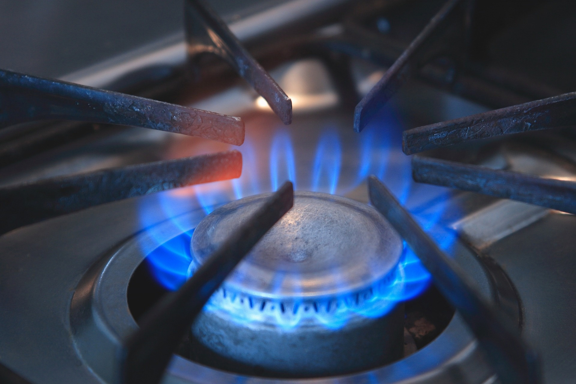

Durable hot surface igniters rely on sound design, consistent manufacturing, and proper handling to deliver reliable ignition over time. (Courtesy: Surface Igniter)

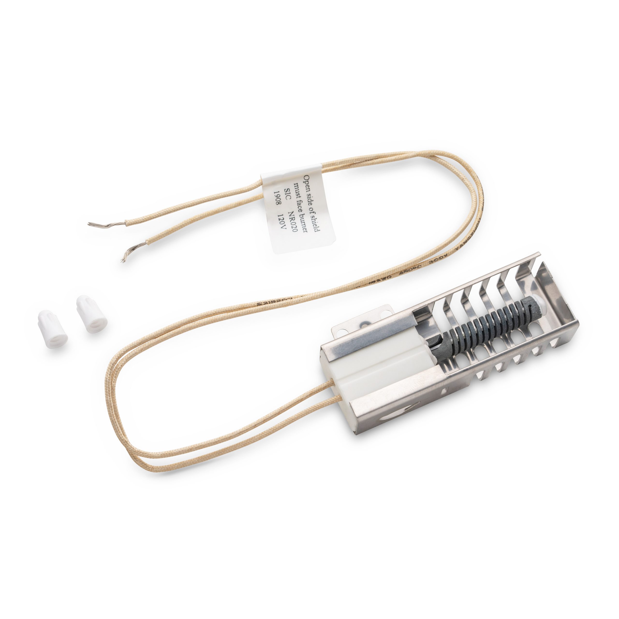

Durability in Practice: From Manufacturing Precision to Field Handling
Silicon carbide igniters can withstand high temperatures and repeated thermal cycling, but long‑term reliability depends on more than material properties alone. As a ceramic component, an igniter must be properly supported, mounted, and handled to perform as intended throughout its service life.
Service guidance consistently emphasizes handling the igniter by its ceramic base rather than the heating element itself, reducing the risk of microfractures during installation or maintenance.
These considerations extend upstream to design and manufacturing decisions. Mounting geometry, lead attachment, and mechanical support all influence how well the igniter withstands vibration, thermal stress, and handling once it leaves the factory. In real‑world service environments — where installation conditions are not always ideal — these details can significantly affect performance and longevity
Ignition reliability also depends on manufacturing consistency. Even with a well‑understood material, hot surface ignition systems require tightly controlled performance characteristics across large production volumes. Specifications commonly define acceptable ranges for parameters such as time‑to‑temperature behavior, room‑temperature resistance, and minimum operating temperatures. These controls allow engineers to design ignition sequences that behave predictably from unit to unit.
For appliance OEMs, this repeatability is essential. Systems must ignite reliably across thousands — or even millions — of appliances while supporting aftermarket replacement scenarios that require drop‑in compatibility and predictable performance.
Spiral silicon carbide hot surface igniters from Surface Igniter are engineered to match OEM electrical characteristics, supporting consistent ignition performance across gas appliances. (Courtesy: Surface Igniter)
