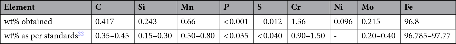

Spectroscopy analysis
Spectroscopy analysis, as shown in Table 1, was carried out to make sure the material composition of the procured AISI 4140 steel was as per AISI standards.

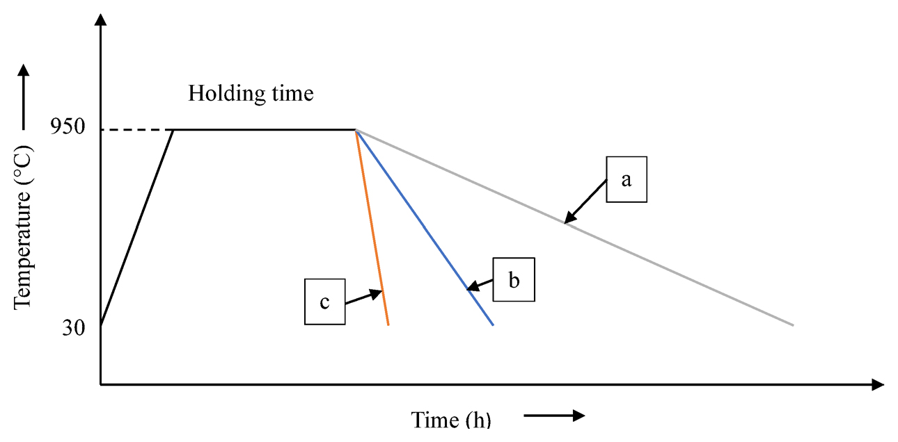

Heat treatment
Separate specimens were prepared for annealing, normalizing, and oil quenching heat treatments. The specimens are heated in a muffle furnace for austenitization heat-treatment temperatures and soaking time conditions as mentioned in Table 2. The heat treatment temperature and holding time values as shown in Table 2 were chosen based on literature review [4] and preliminary trials, wherein full austenitization and homogeneity was obtained.
Full factorial method was adopted to carry out the heat treatments by covering all the possible nine combination of temperatures and time values. After heating, the annealing specimens were furnace cooled, normalizing specimens were air cooled, and oil quenching specimens were quenched in SAE 40 engine oil. SAE 40 is a single-grade oil with high viscosity at elevated temperatures, kinematic viscosity of 14 to 16 mm2/s at 100°C, making it suitable for moderate quenching applications. It provides a slower cooling rate compared to water but faster than polymer-based or air cooling, helping to reduce distortion and cracking in medium-carbon steels. The cooling rate of three heat-treatment processes is represented graphically in temperature vs. time graph in the Figure 3.

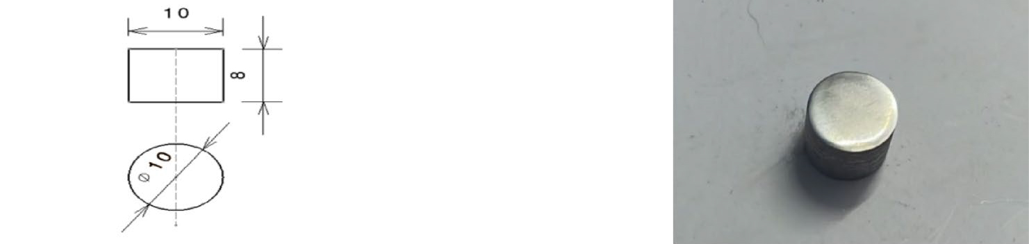

ASTM E384-2220 was used as the standard for carrying out Vickers microhardness tests for assessing the hardness of all the test samples.

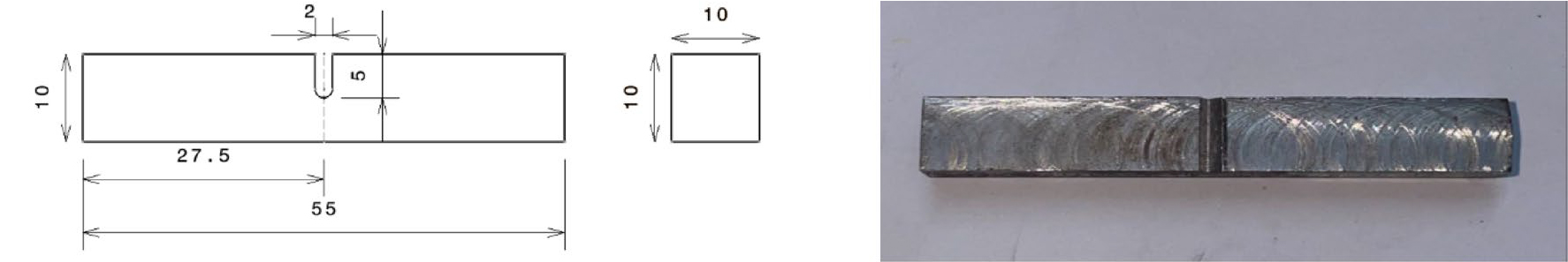

Charpy impact testing was carried out at the Advanced Composite Lab, Department of Aeronautical and Automobile Engineering, MIT, Manipal. Specimens were mounted in the testing machine, and a 300 J pendulum strike was applied. The energy absorbed during fracture was recorded to evaluate impact resistance. Testing followed ASTM E23 [21] guidelines. For microstructural analysis, EVO MA18 SEM with Oxford EDS X-act, available at the Central Research Facility, MIT Manipal, was used.

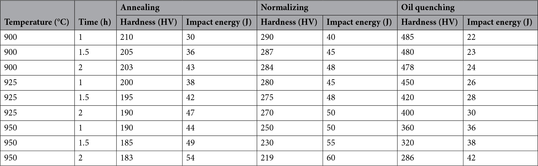

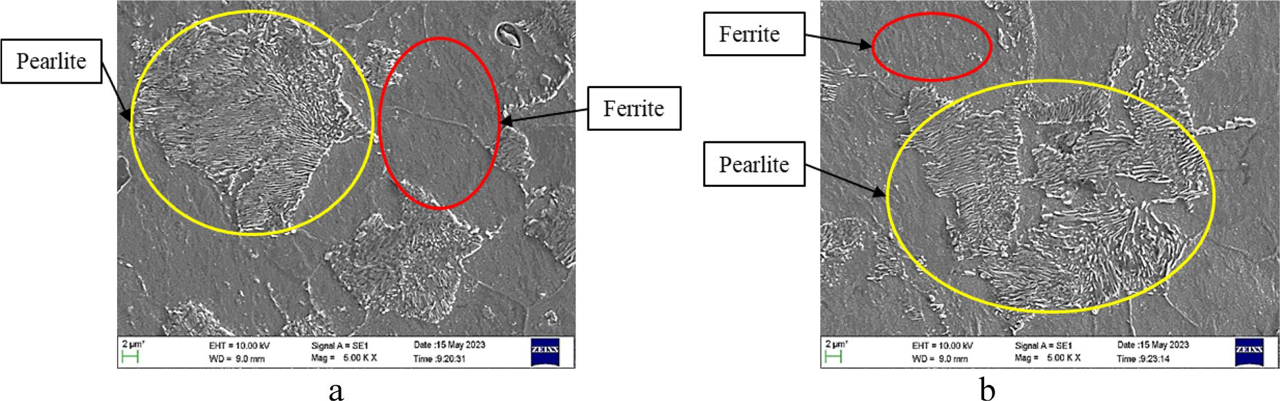

The effect of heat treatment (annealing, normalizing, and oil quenching) on the mechanical properties (hardness and impact energy) of the heat-treated samples for AISI 4140 are shown in Table 3. The results, based on the average of five trials, had a standard variation of less than 3%. The respective microstructure results for each heat treatment are as shown in Figures 4, 5, and 6.

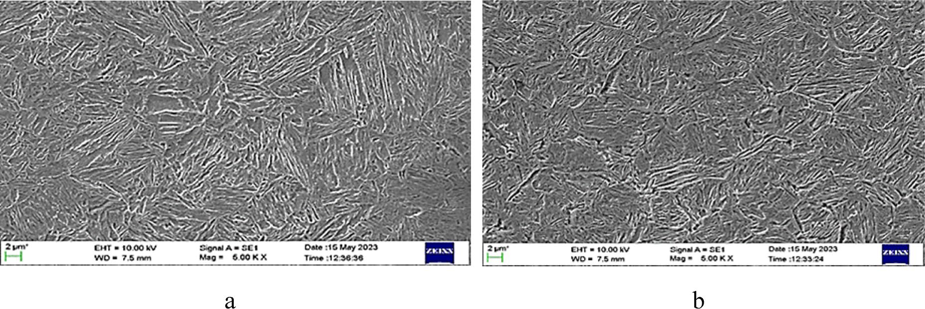

Based on data from Table 3 and analyzing the microstructure shown in Figure 4, it may be seen that hardness of AISI 4140 steel decreases, and impact energy increases with increase in annealing temperature and time. At 900°C (1-2 hours), hardness drops from 210 HV to 203 HV; impact energy rises from 30 J to 43 J due to reduced dislocations and wider pearlite spacing. At 925°C, hardness falls to 190 HV and impact energy reaches 47 J, with finer pearlite in ferrite matrix. At 950°C, steel softens rapidly (183 HV, 54 J), showing coarse pearlite and large ferrite grains. Increased interlamellar spacing drives softening and toughness.

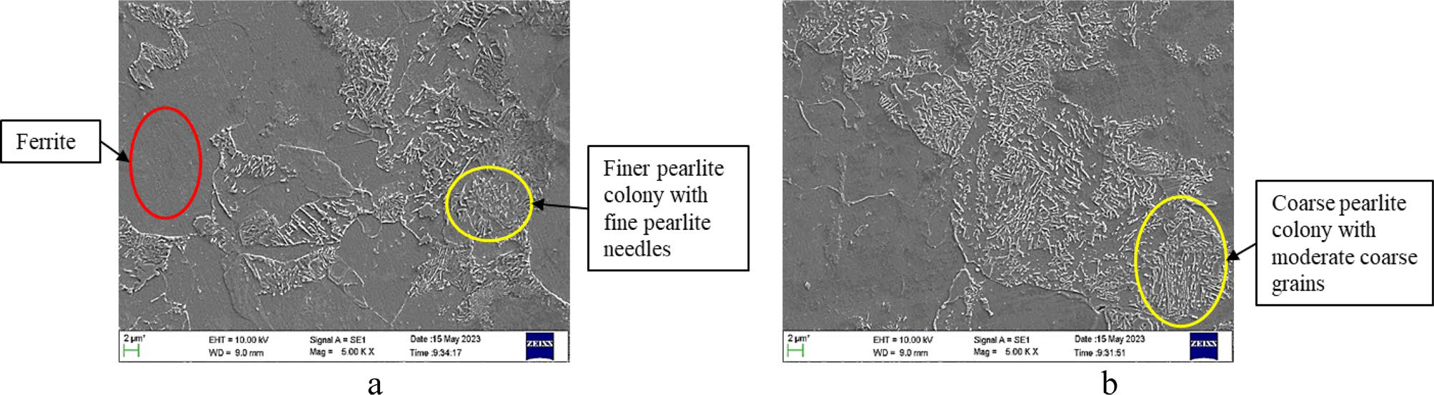

Normalizing for AISI 4140, as observed in Table 3; Figure 5, at increasing temperatures and times, lowers hardness and boosts impact energy. At 900°C (1-2 hours), hardness drops from 290 HV to 284 HV; impact energy rises from 40 J to 48 J due to fine pearlite-ferrite structure. At 925°C, hardness declines to 270 HV and impact energy reaches 50 J as microstructure becomes more uniform. At 950°C, grain growth and coarse pearlite reduce hardness to 219 HV while impact energy peaks at 60 J. Higher temperature and time soften the steel while increasing toughness.
When AISI 4140 was subject to oil quenching heat treatment, as seen in Table 3; Figure 6, it was observed that at 900°C (1-2 hours) martensitic structure was formed, giving high hardness (485 HV to 478 HV) and low toughness (22 J to 24 J). Longer soaking increases austenite grain size, producing coarser martensite and slightly reducing hardness while improving impact energy. Similar trends occur at 925°C and 950°C. Overall, higher temperature and time reduce hardness and increase toughness due to martensite coarsening.

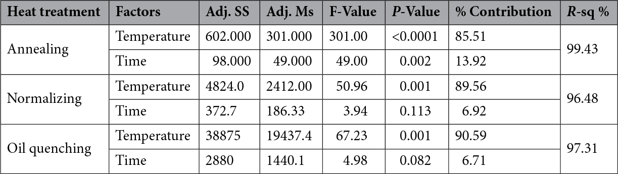

To assess the influence of heat-treatment parameters, such as temperature and time, on the mechanical properties of AISI 4140 steel, a two-way ANOVA was conducted at a 95% confidence level, using MINITAB 17 statistical analysis software.
Analysis of Variance (ANOVA) is a technique that evaluates statistical significance of factors and their interactions on measured responses by partitioning total variability into contributions from each source. This helps in identifying which parameters significantly influence the outcomes. The mechanical properties evaluated were Vickers microhardness and the Charpy impact energy. The percentage contributions of each factor were also calculated to understand their relative influence on the properties.

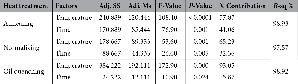

The results of ANOVA of hardness and impact energy for AISI 4140 are as shown in Tables 4 and 5 respectively.
The ANOVA results, as tabulated in Table 4 and 5, show that, for both hardness and impact energy, heat-treatment temperature is the greater influential factor.

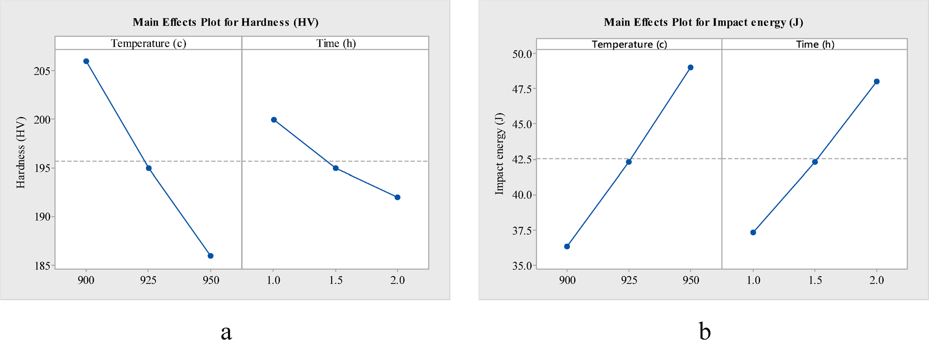

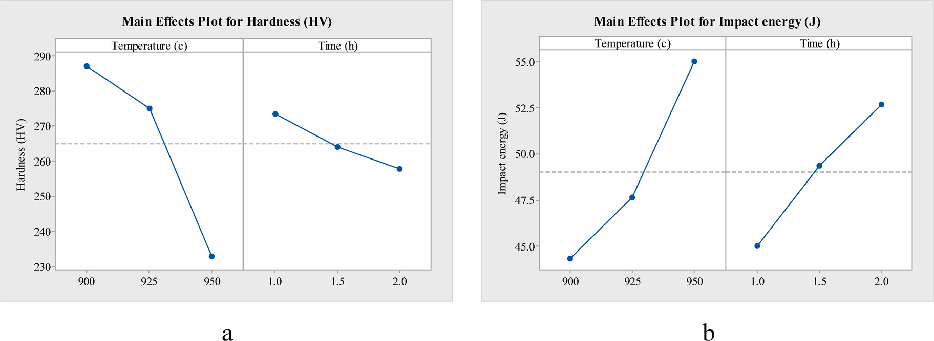

Temperature has nearly 85.5 % influence on the hardness of annealed specimens, 89.5 % on normalized, and 90.5 % on oil quenched specimens. For impact energy, temperature has nearly 57.87 % influence on annealed specimens, 65.2 % on normalized, and 93 % on oil quenched specimens. Even though the holding time also has some influence on hardness and impact energy, its influence is less compared to heat treatment temperature.

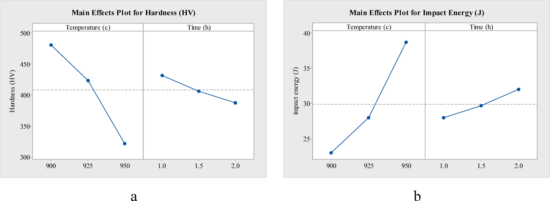

The main effect plots of hardness and impact energy w.r.t temperature and time, for annealing (Figure 7), normalizing (Figure 8), and oil quenching (Figure 9) of AISI 4140, depict a downward slope for hardness and an upward slope for impact energy. That is, as heat-treatment temperature (900 to 950°C) increases, there is nearly a 20 HV decrease in hardness for annealing, a 55 HV decrease in hardness for normalizing, and about 160 HV drop in hardness for oil quenching. Whereas with an increase in temperature, impact energy increases by 10 to 15 J in each case. Holding time also has a similar effect on hardness and impact energy for each heat treatment.

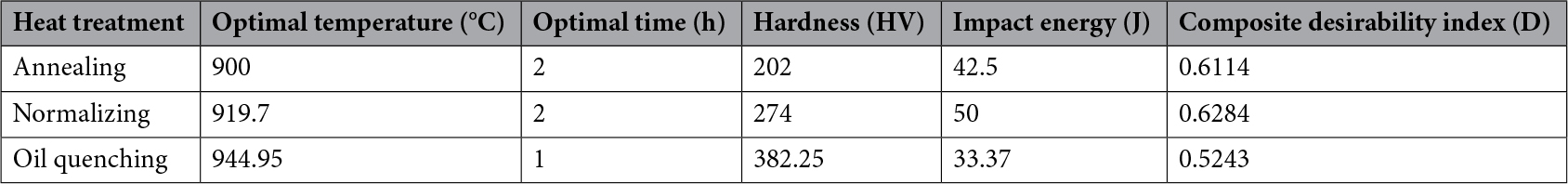

Multiple response optimization
Multiple response optimization was done to get the optimal temperature and time for the best combination of hardness and impact energy for each heat treatment. This method of optimization determines process settings that simultaneously satisfy desired targets for multiple responses. Based on optimization results obtained through response surface optimization analysis, with an aim to get superior combination of hardness and impact energy, following combination of parameters, as shown in Table 6, were found to be optimal.
For annealing at the optimal temperature and time of 900°C and 2 hours, the best combination of hardness (202 HV) and impact energy (42.5 J) was obtained. For normalizing, the optimized values were found to be 919.7°C and 2 hours, for a hardness and impact energy values of 274 HV and 50 J respectively. Similarly for oil quenching, at 944.95°C and 1 hour temperature and time, the best combination of hardness (382.25 HV) and impact energy (33.37 J) was obtained. The composite desirability indexes, as shown in Table 6, indicate a balance between the two competing objectives. While the values are not close to 1 (ideal desirability), they reflect a feasible compromise between maximizing both mechanical properties.

- The optimization results showed that a temperature of 900°C and holding time of 2 hours gave the best combination of hardness and impact energy for annealed specimens, 919.7°C and 2 hours for normalized specimens, and 944.95°C and 1 hour for oil quenched specimens.
