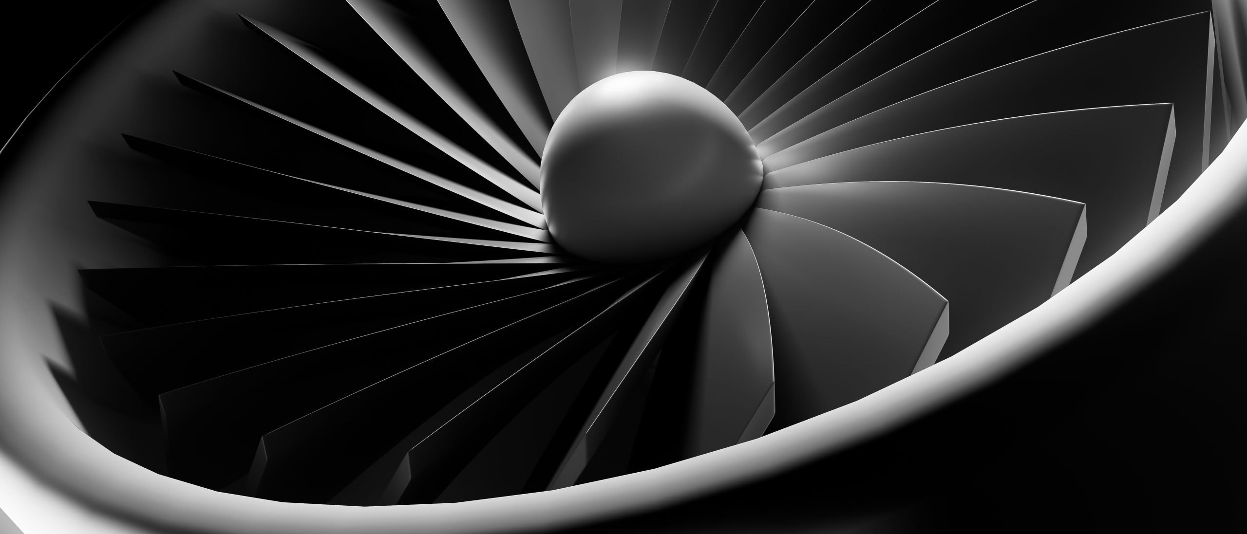

Nickel-based superalloys, often used in jet engines, are the largest class of superalloys due to excellent high-temperature strength and oxidation resistance. (Courtesy: Shutterstock)
