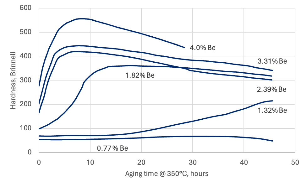

Figure 1: Precipitation-hardening curves of beryllium–copper binary alloys. As the percentage of beryllium increases, the aging time required to reach maximum hardness is shortened, and the maximum hardness is increased. These alloys were quenched from 1,470°F (800°C) and aged at 660°F (350°C) for the times shown [4].
Figure 1 shows the aging curves of some Be-Cu alloys containing 0.77-4.0% Be. Alloys with 0.77% Be do not harden because of artificial aging. However, if the Be content is raised to 1.32%, a significant hardness increase occurs after aging for 16+ hours. As the Be content is raised, the ultimate hardness is increased, at shorter aging times.
Looking at the supersaturated solid solution hardness, (t = 0), it can be observed that the hardness increases as the Be content is increased. This is because of solid solution hardening of the matrix. The face-centered cubic copper matrix must accommodate the smaller atomic radius of beryllium [7]. This results in strains in the matrix, increasing the hardness of the matrix.
At concentrations greater than approximately 2.7% Be, dispersion hardening occurs. This is due to undissolved β phase. The undissolved β phase is harder than the matrix, resulting in increased hardness.
This means that not only is the hardness of the alloy dependent on traditional artificial aging — strengthened through the precipitation of coherent and slightly incoherent precipitates — but also on solid hardening, and dispersion hardening.
