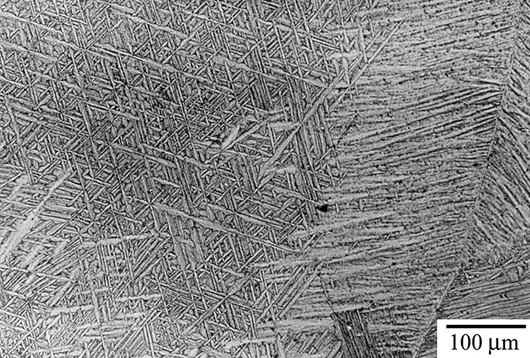

Figure 1: Ti-6Al-5Zr-0.5Mo-0.25Si heat treated to 1,050°C and slowly cooled to ambient temperature. Showing Widmanstätten α within prior β grains [1].

Alpha alloys only have three different microstructures. The first equiaxed alpha, which is the result of recrystallization after deformation and heating. The second microstructure is Widmanstätten alpha, which occurs as the alloy is cooled moderately slowly from above the β-transus (Figure 1). This is the familiar “basket-weave” pattern and microstructure. Lastly, there is martensitic alpha (α’) which forms upon rapid cooling from above the β-transus.
