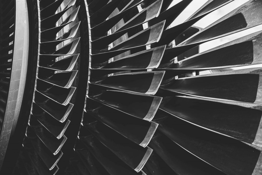

Nickel-based superalloys are the largest class of superalloys due to excellent high-temperature strength and oxidation resistance. They are most often used in the hottest sections of gas turbines, and include the turbine blades, vanes, and hubs. These are applications where the temperatures can approach 1,100°C.
The earliest superalloys were based on a composition of 80Ni-20Cr, with minor additions of titanium and aluminum [3]. These alloys worked because of the formation of fine γ’ precipitates. However, due to limitations in microscopy, this precipitation was not discovered until the 1940s [3].
Gamma prime (γ’) has the composition of Ni3(Al,Ti) and has an ordered FCC structure (LI2). This phase is an intermetallic, and is coherent with the matrix (γ), and provides needed ductility [4]. This precipitate appears as very fine spheres, or as the precipitates grow, the morphology changes from spheres to cubes or plates, depending on the size of the matrix/precipitate lattice mismatch [3].
Nickel-based superalloys are the largest class of superalloys due to excellent high-temperature strength and oxidation resistance. They are most often used in the hottest sections of gas turbines, and include the turbine blades, vanes, and hubs. (Courtesy: Shutterstock)
