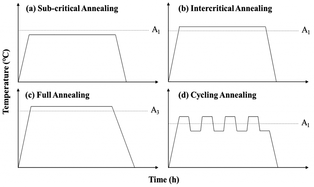

Figure 1: Schematic of various spheroidizing annealing patterns.
In particular, in the field of automotive drive components, forging and heat-treatment processes are being changed to improve material recovery and to reduce carbon emissions. Forging is the process of manufacturing automotive parts by applying heat and pressure to a metal to plastically deform it. Depending on the temperature, forging is categorized into hot forging and cold forging [5,6]. Hot forging heats the workpiece above its recrystallization temperature, resulting in excellent formability and productivity. However, its disadvantages include thermal cracking and poor dimensional accuracy and surface quality [7].
On the other hand, cold forging is a forging process that takes place at room temperature, so the dimensional accuracy of the alloy is very good. However, the material must be heat-treated before forging to remain ductile [8,9,10]. In particular, the cold-forging process is carried out after forming a ductile microstructure because many large deformations occur at room temperature during forging.
The heat-treatment patterns for optimizing cold-forging performance have been carried out in various ways, and the representative patterns are shown in Figure 1. The patterns (a) and (b) are primarily applied in the industry and involve heat treatment at temperatures near A1 for extended periods. In the case of (c), the material is heat-treated above the austenitizing (A3) temperature, and due to phase transformation during the cooling process, the hardness increases, resulting in reduced cold forging efficiency. Pattern (d) promotes spheroidization by repeatedly heating and cooling, cycling through temperatures just above and below A1. While this method accelerates spheroidization, it is not commonly adopted in the industry due to the difficulty in temperature control. Therefore, the spheroidizing annealing patterns (a) and (b) are mainly applied in industry, but the productivity efficiency of forged products is not optimal due to the prolonged heat treatment, and a large amount of carbon is emitted [9,11,12].

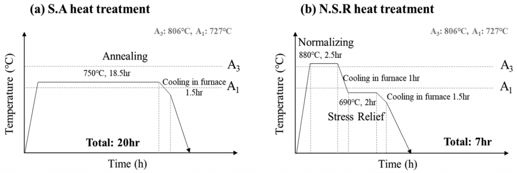

Figure 2: Schematic of heat treatments: (a) SA; (b) NSR.
Therefore, in this study, a new NSR heat-treatment pattern is proposed to effectively reduce the heat-treatment time while maintaining the same level of mechanical properties as the existing SA heat-treated materials, in order to secure productivity and contribute to environmental sustainability. NSR improves productivity by approximately 70 percent compared with the conventional SA heat treatment, which can significantly reduce manufacturing costs and carbon emissions. To confirm the effectiveness of an NSR heat treatment, SCr420 steel was selected as the test alloy, as it is widely used in automotive parts, and its microstructure analysis and mechanical properties were compared based on the used heat-treatment method [13].

2.2 Development of the NSR Heat Treatment
In industry, spheroidizing annealing to achieve ductility in materials is typically carried out near the A1 temperature for a considerable amount of time before cooling [9,11,12,15,16]. This heat treatment experiences difficulty securing productivity and emits a lot of CO2 gas, so it needs to be improved from a long-term perspective. In this study, we developed a new heat-treatment method (NSR) that can compensate for the shortcomings of spheroidizing annealing, and a schematic diagram of the heat treatment is shown in Figure 2.

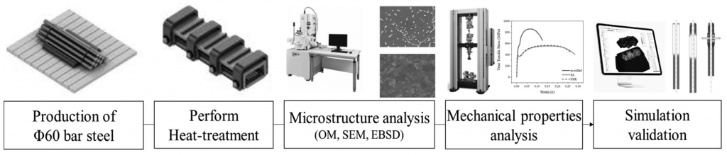

Figure 3: Schematic of the experiments and analysis.
NSR heat treatment is a heat-treatment method that applies a combination of normalizing and stress relief heat treatments, thus shortening the heat treatment time to 7 hours by controlling the heat-treatment temperature and cooling rate. In order to improve the strength and microstructure homogenization of the alloy, cooling is performed below the A1 temperature after maintaining the austenite region above the A3 temperature for a certain duration. The alloy is then heat-treated and annealed below the A1 temperature to minimize the residual stresses generated during the phase transformation from γ(austenite) to α(ferrite) + θ(cementite).
In this study, SA and NSR heat treatments were performed on SCr420 material with the composition shown in Table 1. The SCr420 material used in this study is Φ60 bar steel from Hyundai Steel (Incheon, Republic of Korea).

Experiments and analyses were conducted in the order shown in Figure 3. To analyze the microstructure of the experimental alloys before and after heat treatment, vertical cut surfaces of the Φ60 rolled bar and heat-treated material were mechanically polished with silicon carbide paper (#100~#2000) and diamond suspension at the 1 µm level and etched with a 3% solution of Nital. Microstructural analysis measurements were analyzed using OM (Olympus Gx51, Olympus, Center Valley, PA, USA) and SEM-EDS (JEOL, Tokyo, Japan, 7100F) microscopes. The ferrite fraction was measured according to ASTM E562 [17], and the remaining volume fractions, other than the measured ferrite fraction, were considered pearlite.

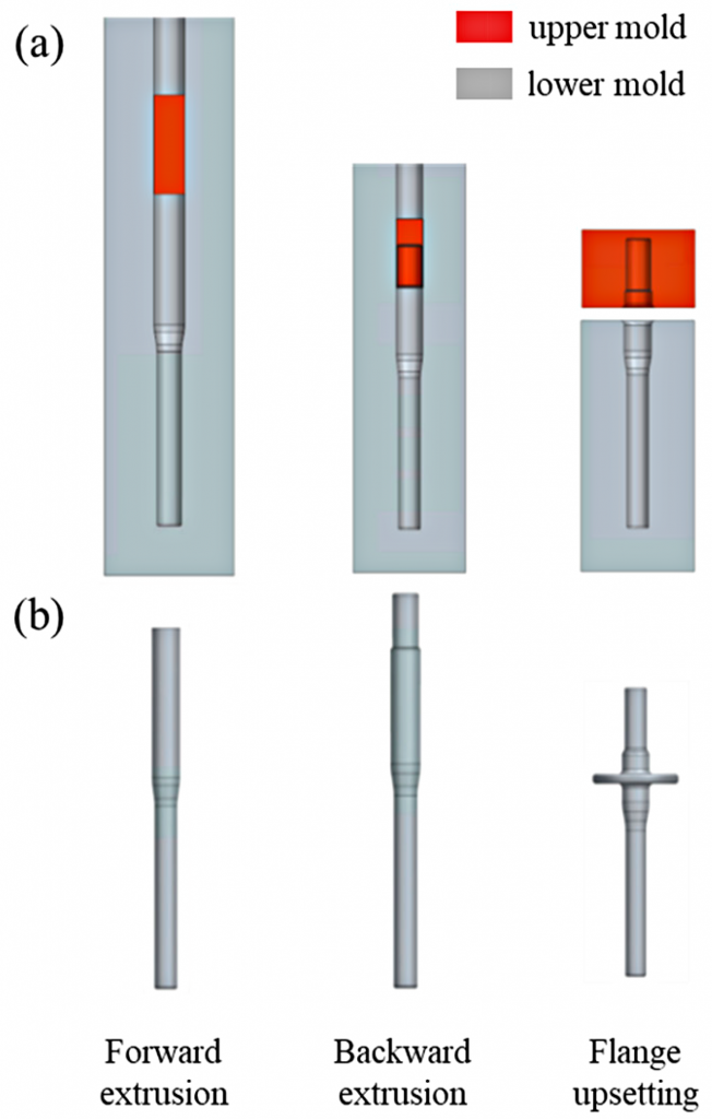

Figure 4: Finite element model of the three-stage process: (a) mold; (b) input shaft.

In order to validate the cold forging process of an NSR alloy, a commercial forging analysis was conducted on the input shaft, an automotive drive part. The input shaft cold forging process consists of three processes: forward extrusion, backward extrusion, and flange upsetting. The molds and models for each process are shown in Figure 4.
The finite element model of the input shaft was made of SCr420 Φ60 bar steel cut into 300 mm lengths, and the molds of each process were modeled at a 1:1 scale and meshed with Tetrahedral Brick Element. AFDEX, a commercial forging finite element analysis software, was then used to analyze formation during each process. The stress-strain curves from the cold forgeability evaluation of the SA and NSR alloys were based on the room temperature tensile test results. In addition, Young’s modulus, Poisson’s ratio, density, and the thermal expansion coefficient were calculated in JMatPro(Version 13), a thermodynamic simulation program, and are shown in Table 2.
Table 2: Properties of the experimental alloys.
To avoid direct friction between the mold and the workpiece during cold forging, a phosphate coating treatment was applied on the workpiece, the Coulomb friction coefficient between the forging mold and the workpiece was set at 0.1, and an elastic deformation analysis was performed [19].

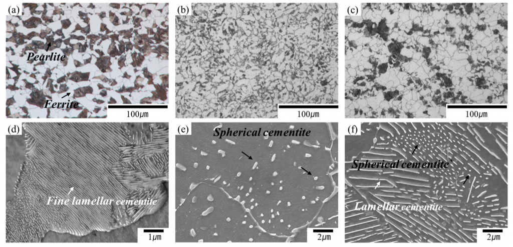

Figure 5 shows microstructure observations of the as-rolled and heat-treated steels. Figure 5a shows the microstructure of the as-rolled SCr420 steel, which has a mixed ferrite and pearlite microstructure. In addition, Figure 5d shows a micrograph of pearlite at 30,000 magnification, confirming the fine lamella structure of cementite.
The SA alloy exhibited a typical spherical cementite microstructure, as shown in Figure 5b,f [20]. As shown in the schematic diagram in Figure 6, SA heat treatment causes the lamella cementite in the pearlite to segment above the initial A1 temperature. Then, with prolonged heat treatment, some of the carbon dissolves and residual cementite remains. In the subsequent heat treatment and cooling stages, the undissolved residual cementite acts as a nucleation site for the growth of spherical cementite [21,22]. On the other hand, the microstructure of NSR heat-treated alloy involves a mix of lamellar and spherical cementite, as shown in Figure 5f because the cementite dissolved at A3 and above grows into spherical cementite as it cools to below the A1 temperature and the growth of cementite, when maintained at temperatures below A1, results in a mixed lamellar and spherical microstructure.
Figure 5: Microstructure measured by OM ((a) as-rolled, (b) SA, and (c) NSR alloys) and SEM ((d) as-rolled, (e) SA, and (f) NSR alloys).

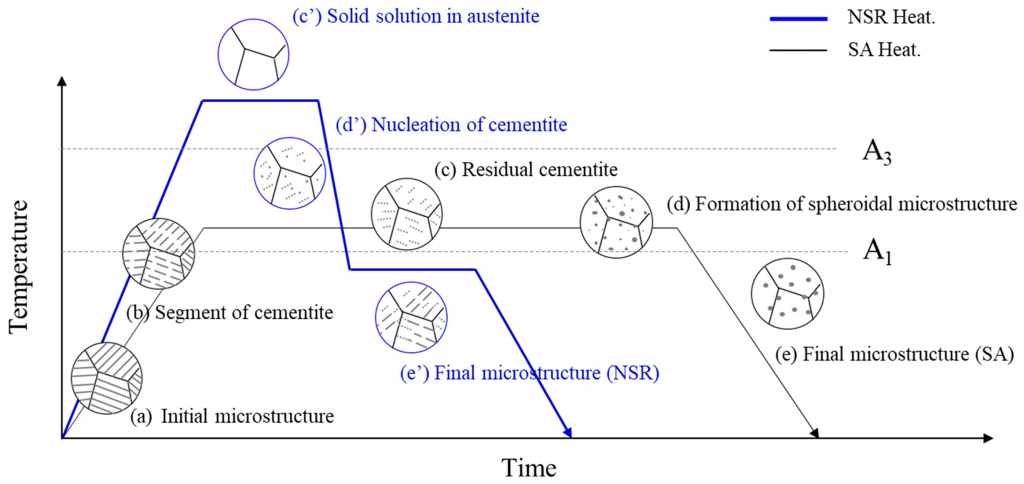

The ferrite fraction of the experimental alloys was measured based on the as-rolled and heat-treatment conditions. The ferrite fraction was measured to be 55% for the as-rolled condition, 80% for SA, and 74% for NSR. The main reason for the difference in ferrite fractions between the as-rolled and heat-treated methods is the cooling rate and start temperature.
Slower cooling rates increase the fraction of ferrite, while faster cooling rates increase the fraction of pearlite due to the shorter distance that the dissolved carbon atoms in the austenite can travel [22]. In other words, the accumulation of carbon at the austenite/ferrite interface makes the formation of pearlite at high temperatures easier and the interlamellar distance of cementite smaller. In general, the cooling rate of Φ60 bar steel after rolling is measured to be about 0.5~1°C/s for air cooling and about 0.1°C/s for furnace cooling. Therefore, the pearlite fraction of the as-rolled material with the fastest cooling rate is the highest.
Figure 6: Schematic of microstructure by heat treatment stage: (black line) SA; (blue line) NSR.
In addition, when the cooling start temperature is lower than A3, as in SA heat treatment, austenite and cementite coexist in the same region, so the shape of cementite is affected by the heat-treatment temperature [15,21]. Therefore, even if the cooling rate of SA alloy and NSR alloy is the same, at 0.1°C, their ferrite fractions are different. The tensile and compressive strengths of the SA and NSR alloys are shown in Figure 7 and Table 3, respectively.

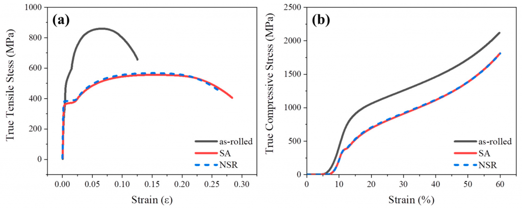

The tensile test results showed that the yield strength of the as-rolled material was 565 MPa, and the ultimate tensile strength was 842 MPa. In comparison, the yield strength of the SA alloy was 377 MPa, and the tensile strength was 556 MPa. Finally, the yield strength of the NSR alloy was measured at 382 MPa, and the tensile strength was 567 MPa.
In addition, the compressive strength of the as-rolled material at 60% cross-sectional area compression was measured to be 2,119 MPa, while the compressive strengths of the SA and NSR heat-treated alloys were 1,810 MPa and 1,815 MPa, respectively. Despite the different heat-treatment methods, their tensile and compressive properties were found to be similar.
Figure 7: Results of the mechanical properties at room temperature: (a) tensile and (b) compressive stress–strain curves.
Table 3: Mechanical properties of the experimental alloys.

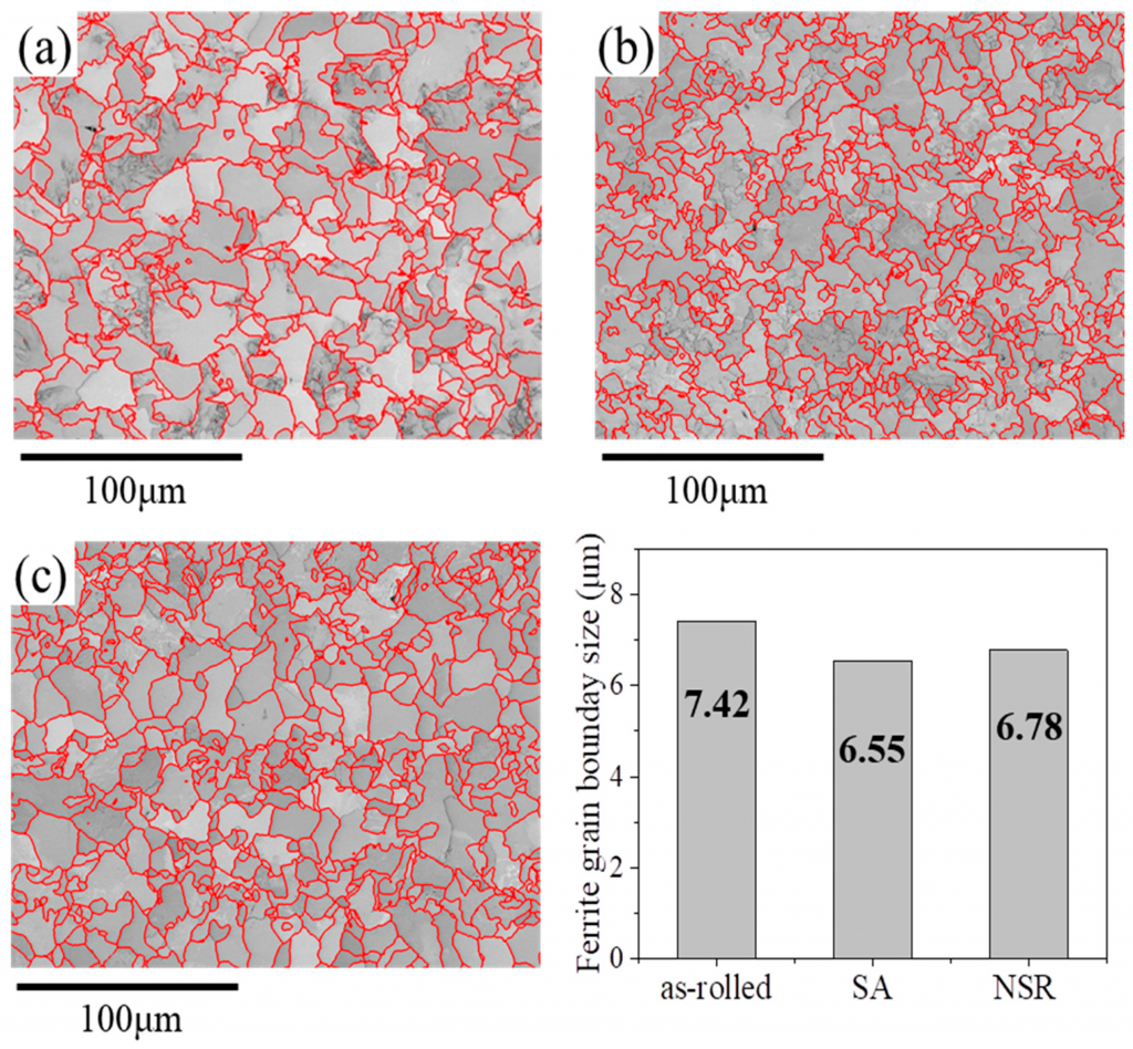

The Sr of the experimental alloys was calculated using Equation 1 to obtain the average true spacing of cementite, and Tr was calculated based on Equation 5. Sr was measured to be 0.12 µm for the as-rolled material, 3.6 µm for the SA alloy, and 1.3 µm for the NSR alloy. Tr was measured to be 0.01 µm for the as-rolled material, 0.43 µm for the SA alloy, and 0.19 µm for the NSR alloy.
Figure 8: Analysis of the grain boundary size of experimental alloys via an EBSD: (a) as-rolled, (b) SA, and (c) NSR alloys.
Average grain size has a significant influence on the strength of metallic materials because high-angle grain boundaries (HAGBs) inhibit the movement of dislocations [28,29]; da is the result of using an EBSD, and the average HAGB sizes were measured as 7.42 µm for the as-rolled material, 6.55 µm for the SA alloy, and 6.75 µm for the NSR alloy, as shown in Figure 8.
The strength of Δσm, based on grain size and the cementite parameters, was measured to be 293 MPa for the as-rolled material, 167 MPa for the SA alloy, and 185 MPa for the NSR alloy.

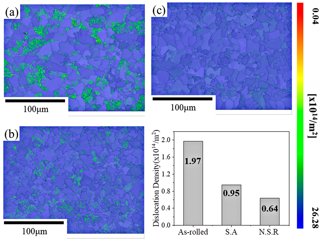

The dislocation density of the experimental alloys was measured using Geometrically Necessary Dislocation (GND) density maps, as shown in Figure 9, and the dislocation densities were measured as follows: as-rolled material, 1.97 1,014 cm2; SA alloy, 0.95 1,014 cm2; and NSR alloy, 0.64 1014 cm2. Δσdis was calculated to be 107 MPa for the as-rolled material, 74 MPa for the SA alloy, and 61 MPa for the NSR alloy.
Figure 9: EBSD GND distribution maps: (a) as-rolled, (b) SA, and (c) NSR alloys.

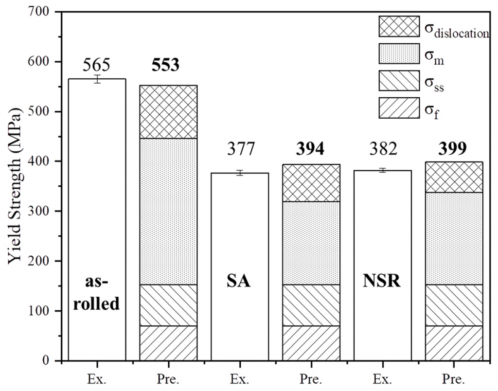

The sums of the predicted and experimentally measured values for each strengthening mechanism are shown in Figure 10.
The yield strength was predicted based on the parameters of the heat-treatment process, and the predicted total strength was measured to be 553 MPa for the as-rolled material, 394 MPa for the SA alloy, and 399 MPa for the NSR alloy. These values are similar to the experimentally measured values, with a deviation of about Δ17 MPa. The difference between the measured and predicted yield strengths for the SA and NSR alloys was the same, at Δ5 MPa, indicating that the predicted values for each parameter affecting the yield strength were calculated correctly.
Figure 10. Comparison of the contributions of each strengthening mechanism with the as-rolled, SA, and NSR alloys (Ex: experimental, Pre: predicted).
The difference in strength between the SA and NSR alloys was Δ18 MPa, depending on the microstructure variables. However, the reason that the NSR alloys exhibit similar strengths to the SA materials is due to the reduction in dislocation density. Compared with the as-rolled material, the dislocation density of the SA and NSR alloys was reduced by 52% and 68%, respectively. This resulted in a 13 MPa reduction in the dislocation-induced strengthening effect of the NSR alloy compared with that of the SA alloy.
In general, when steel passes through the A1 eutectoid temperature, a phase transformation dislocation is formed during the γ (austenite) α (ferrite) + θ (cementite) phase transformation.
In the case of the SA alloy, as shown in Figure 2a, heat treatment above the A1 temperature results in the formation of austenite and spherical cementite, and the dislocations disappear. However, dislocations are generated by the newly grown pearlite during cooling [15,21]. On the other hand, in the case of the NSR alloy, stress relief heat treatment is performed below the A1 temperature after the phase transformation is completed, so the dislocation strengthening effect is reduced as the dislocations disappear.

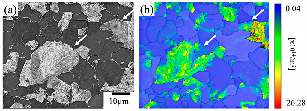

Figure 11: Microstructure of the as-rolled material: (a) SEM image; (b) GND map.
Figure 11 shows the microstructure and GND density of the as-rolled material at a high magnification. The dislocation density is low in the ferrite region but high in the pearlite region. These results demonstrate that dislocations form as a result of phase transformation.

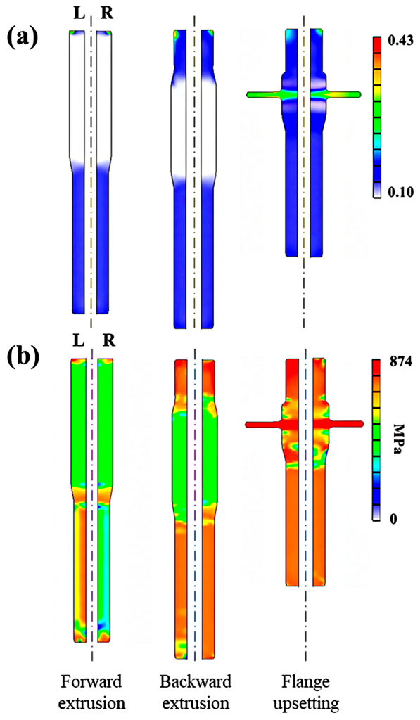

The purpose of the effective strain and stress analysis was to compare the influence of the mold during the continuous production of automotive parts based on the heat-treatment method. Figure 12 shows the results of analyzing the cold-forging process of the input shaft using the mechanical properties of the experimental alloys when the SA and NSR heat treatments are applied, which include (a) effective strain and (b) effective stress. Both the SA and NSR alloys exhibited similar strain rates in the flange upsetting process with the highest compression ratio.
Figure 12: Finite element results from cold forging (left) the SA and (right) NSR alloys: (a) effective strain; (b) effective stress.
In addition, the maximum effective stress at the flange was 874 MPa for both the SA and NSR alloys, with no significant difference observed in the extrusion process. Therefore, the maximum stress of the NSR alloy during the forging process was confirmed to be similar to that of the SA alloy.
The similarity in effective stress and effective strain, despite the differences in the microstructures of SA and NSR, can be explained as follows: when NSR is applied to the SCr420 steel grade, the heat-treatment time is reduced compared to SA, yet it demonstrates similar tensile and compressive strengths. In other words, the mechanical properties in both the yield and plastic deformation regions are similar for both SA and NSR, which is why the cold-forging finite element analysis results are also comparable. The similarity in mechanical properties is attributed to the 32% lower dislocation density in NSR compared to SA, as confirmed by the Hall–Petch equation in Section 3.2.
Based on these results, the application of the NSR heat-treatment method in the automotive industry is expected to exhibit cold forging properties similar to those found with the SA heat treatment.
