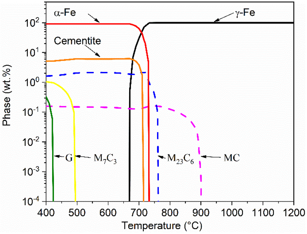

Table 1 lists the chemical compositions of the 5CrNiMoV die steel, which was taken from an as-forged billet.
Phase transformation temperatures of the 5CrNiMoV steel were investigated using differential scanning calorimetry (DSC) measurements (STA 449F3 Jupiter). During the measurement, the specimen was heated from 25°C to 1,100°C at a rate of 10°C/s, and the heat flow rate to the specimen was monitored. In addition, a quenching and deformation dilatometer (DIL 805, TA instruments, New Castle, Delaware) was used to carry out the thermal expansion tests of the steel. The specimens used for the thermal expansion test are 10 mm in height and 4 mm in diameter. During the test, the specimens were heated to 950°C, 1,050°C, and 1,100°C, respectively, at a heating rate of 10°C/s, kept for 5 min, and then cooled at a linear rate of 50°C/s. The results of the dilatometer tests show that the Ms temperature is 240°C and the Mf is lower than room temperature.

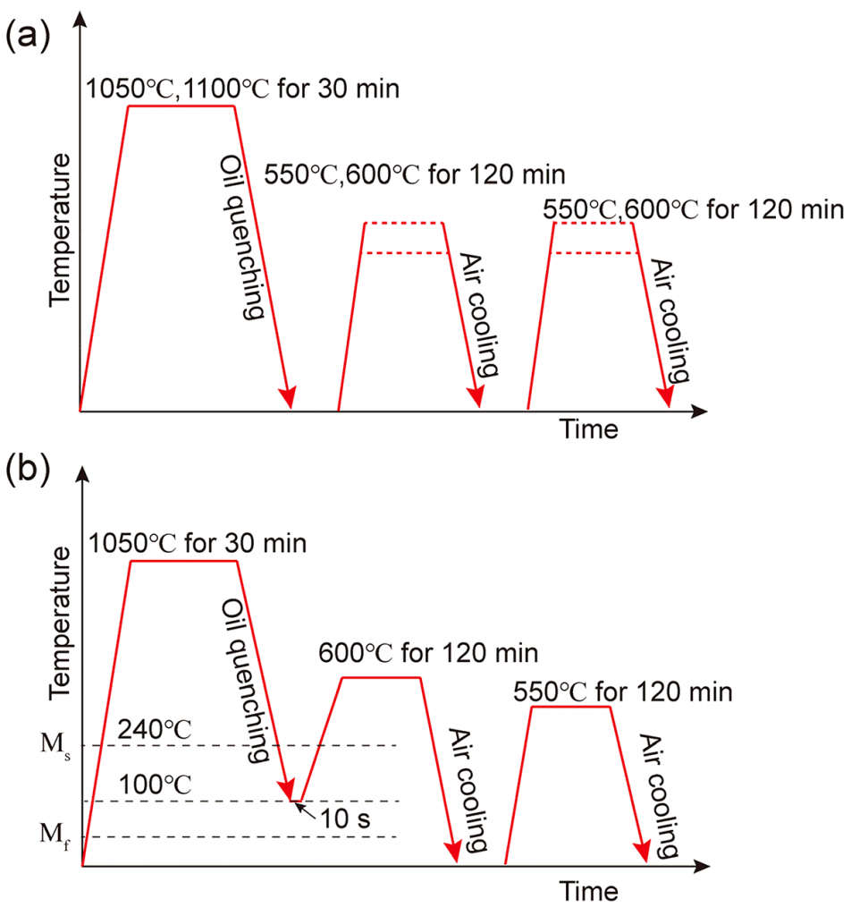

Firstly, the specimens were heated to either 1,050°C or 1,100°C and held at these temperatures for 30 min. Subsequently, they were quenched in oil, as shown in Figure 1a. After the quenching process, the specimens underwent pre-tempering and tempering treatments. In the pre-tempering stage, the specimen was reheated to a temperature of either 550 or 600°C and held for 120 min, followed by air cooling. Subsequently, the specimen was reheated to a temperature that was equal to or lower than the pre-tempering temperature (550 or 600°C). Then, an intercritical quenching method was proposed to produce a mixed structure of pearlite and martensite in the 5CrNiMoV steel. This method involves quenching the specimen after isothermal holding at 1,050°C for 30 min. The quenching process was performed by rapidly immersing the specimen into a quenching oil at a temperature of about 100°C for a duration of 10 s. Subsequently, the intercritically quenched specimen underwent pre-tempering and tempering treatments, as shown in Figure 1b.
Additionally, the strength of 5CrNiMoV steel is influenced by precipitation strengthening, which is caused by the formation of secondary carbides. To determine the appropriate tempering conditions, the researchers referred to the equilibrium phase diagram of the 5CrNiMoV steel, as depicted in Figure 2. It was observed that, due to the low silicon content, the formation of cementite is more favorable compared to other carbides [14]. However, in terms of contributing to the strength of the die steel, the carbides MC and M23C6 play a more significant role than cementite. Based on the information provided in Figure 2, it was found that the carbides M23C6 and MC remain stable within the temperature range of 550°C to 650°C. Therefore, for this research, the tempering temperature was selected from a range of 550°C to 600°C.

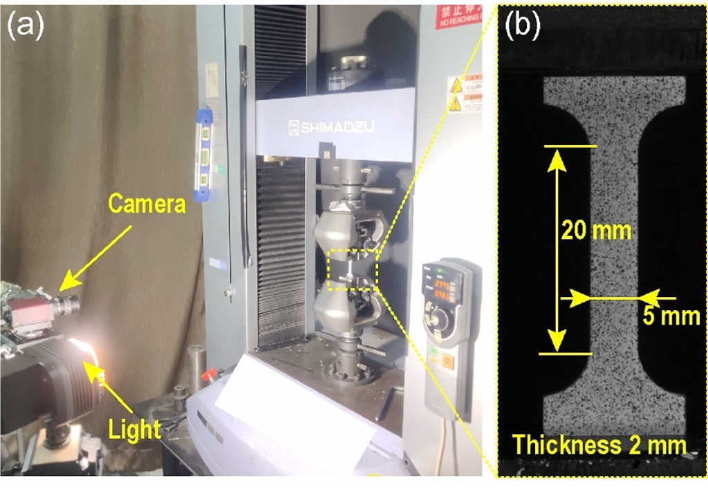

The experimental setup for the tensile tests and the dimensions of the tensile specimens are shown in Figure 3. Two tensile specimens were prepared for each heat-treated sample. The tensile tests were conducted at room temperature using a material testing machine (Shimadzu AGX-V) with a loading rate of 0.005 mm/s. To accurately measure the strain of the tensile specimen, the digital image correlation method was employed [15]. The resolution of the camera was 300 × 1000 = 300,000 pixels. The hardness of the quenched specimens was tested using a Rockwell hardness tester (HRS-150).

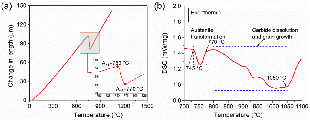

As shown in Figure 4a, the transformation temperatures of Ac1 (750°C) and Ac3 (770°C) of the 5CrNiMoV steel were determined according to the heating dilatation curve. The DSC curve, shown in Figure 4b, exhibits two endothermic valleys. Previous studies have reported the transformation of ferrite to austenite, carbide dissolution, and grain growth are all endothermic processes [16,17]. Therefore, the first endothermic valley in the DSC curve corresponds to the austenite transformation, while the second one corresponds to the grain growth and dissolution of carbides.
It is worth noting the DSC curve does not exhibit an exothermic reaction until the temperature reaches approximately 1,050°C. This suggests the complete dissolution of carbides only occurs when the temperature reaches 1,050°C.

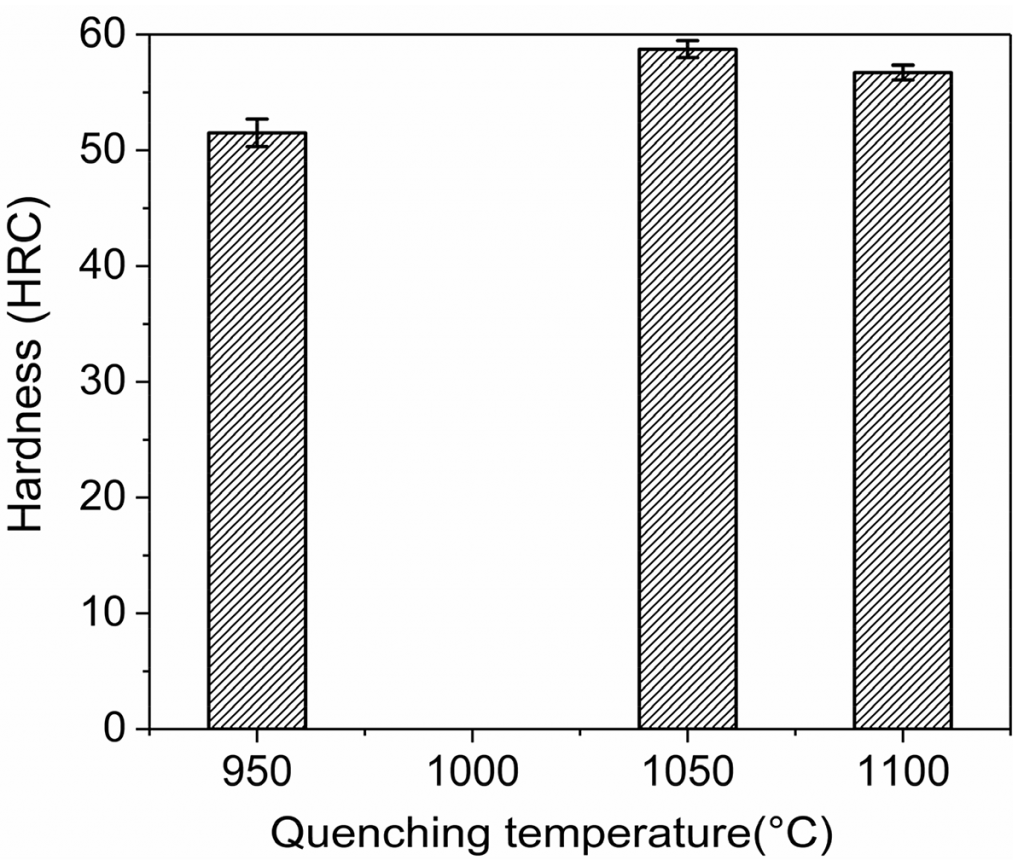

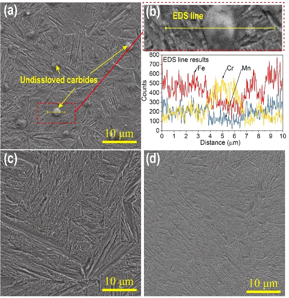

Figure 5 displays the martensite of specimens quenched at various temperatures. As illustrated in Figure 5a, undissolved particles can be observed on the martensite matrix of the specimen quenched at 950°C, as indicated by the yellow arrows. To further investigate these particles, the chemical element variations along the line crossing them were characterized using EDS, as shown in Figure 5b. The results reveal the undissolved particle is a chromium (Cr)-rich carbide. In contrast, no such undissolved particles are observed in Figure 5c,d for specimens quenched at 1,050°C and 1,100°C, respectively.
The presence of undissolved Cr-rich carbide reduces the chromium content in the matrix structure, leading to an inhomogeneous microstructure. This inhomogeneity is detrimental to the strength of steel. As depicted in Figure 6, the specimen quenched at 950°C exhibits the lowest hardness, measuring at (52 ± 1) HRC. This decrease in hardness is attributed to the undissolved carbides (Figure 5a), which reduce the alloying elements within the quenching martensite, consequently resulting in a decrease in martensitic hardness. Upon quenching at 1,050°C, the martensitic hardness reaches its peak, measuring at (59 ± 1) HRC.
However, when quenched at 1,100°C, the hardness declines to (57 ± 1) HRC. This reduction in hardness is associated with excessive quenching temperature, which leads to the coarsening of prior austenite grains and subsequently decreases the hardness of the specimen. The results indicate the presence of undissolved Cr-rich carbides in specimens quenched at lower temperatures results in an inhomogeneous microstructure and a decrease in hardness. Conversely, excessive quenching temperature causes prior austenite grain coarsening and a subsequent decline in hardness. Therefore, a quenching temperature of 1,050°C is considered reasonable for 5CrNiMoV steel.

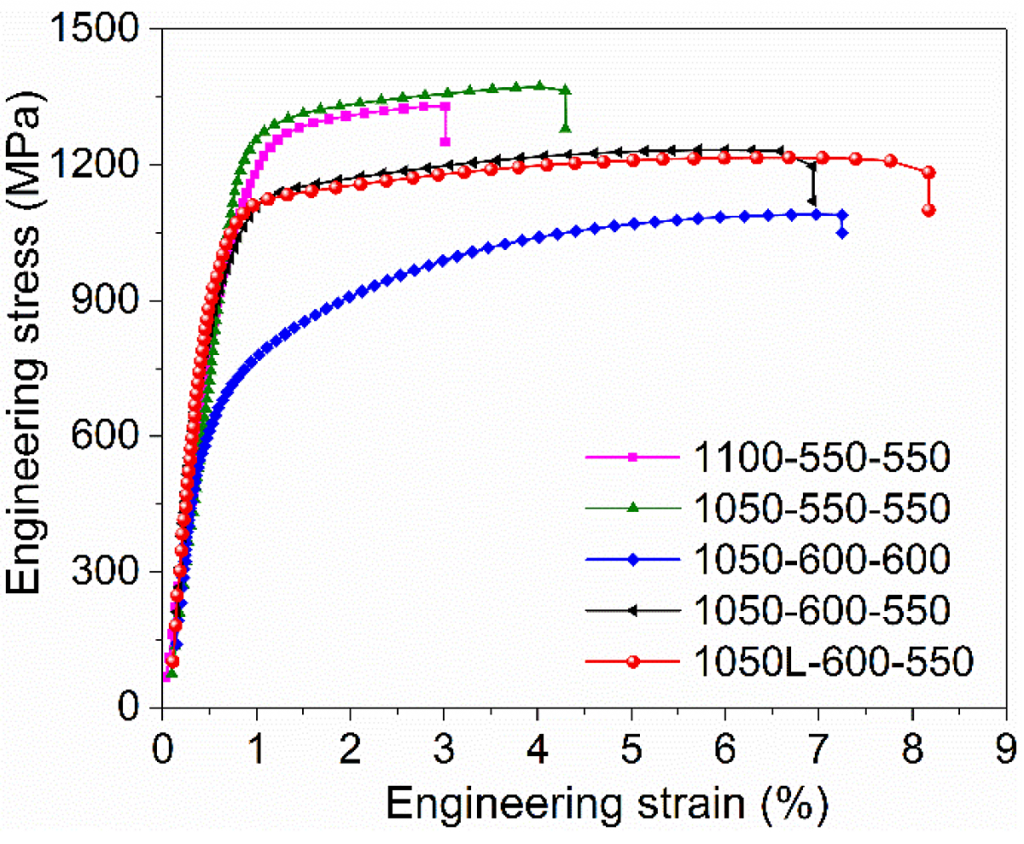

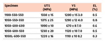

The engineering stress — strain curves of the heat-treated specimens are depicted in Figure 7. Furthermore, the ultimate tensile strength (UTS), yield strength (YS), and elongation to rupture (EL) of various specimens are provided in Table 2. The numbers in the legend denote the conditions of heat treatment. For instance, 1050-550-550 signifies that the quenching, pre-tempering, and tempering temperatures are 1,050°C, 550°C, and 550°C, respectively. Moreover, 1050L-600-550 indicates the implementation of intercritical quenching, where the specimen was intercritically quenched at 1,050°C, followed by pre-tempering at 600°C and tempering at 550°C.
Specimen (S) 1050-550-550 demonstrates superior strength and ductility compared to S1100-550-550. It is observed that, with an increase in quenching temperature, the UTS and YS decline from 1,375 MPa to 1,330 MPa and 1,290 MPa to 1,200 MPa, respectively. Simultaneously, the EL decreases from 4.0% to 3.0%. This can be attributed to two factors. Firstly, the PAGS and martensite block size augment with an increase in quenching temperature, thereby diminishing the YS of the quenched steel as per the Hall–Petch relation [18]. Secondly, the coarsened grains of the prior austenite and martensite blocks are susceptible to initiating micro-cracks during tensile tests, leading to intergranular fracture, and consequently reducing the EL [19,20].
Upon comparing S1050-550-550 and S1050-600-600, it is evident that, as the pre-tempering and tempering temperatures increase, the EL also increases. Concurrently, the UTS and YS decreased significantly. This is linked to the aggregation and coarsening of the secondary carbides and decomposition of the tempered martensite induced by elevated tempering temperatures. Despite S1050-600-600 possessing high EL, the low YS severely hampers the application of the 5CrNiMoV steel.
Tempering is an effective method to modify precipitation behavior for enhancing the mechanical properties of die steels. By modulating the tempering conditions, S1050-600-550 exhibits exceptional mechanical properties, with an UTS of 1230 MPa, YS of 1120 MPa, and EL of 7.0%. Additionally, based on the aforementioned optimized parameters, the EL is further ameliorated with intercritical quenching. As delineated in Table 2, S1050L-600-550 boasts the highest EL of 8.2%, with an UTS of 1220 MPa and YS of 1110 MPa, showing better mechanical properties and can meet diverse engineering requirements.

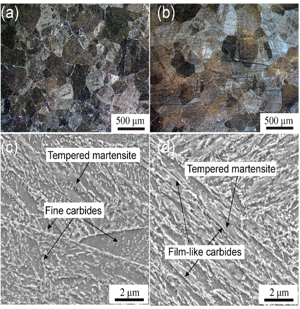

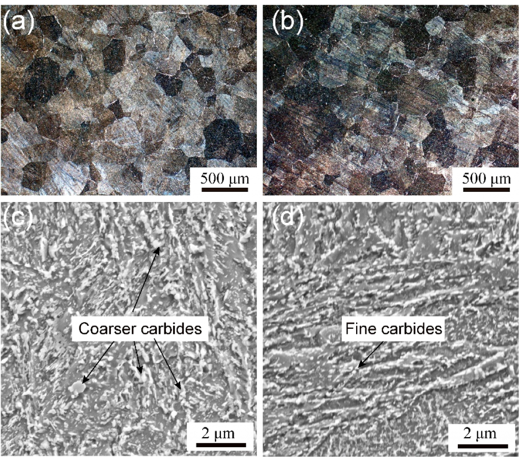

Figure 8 illustrates the OM and SEM micrographs of S1100-550-550 and S1050-550-550, which have been quenched at varying temperatures. The microstructure is comprised of ferrite, tempered martensite, and secondary carbides. As shown in Figure 8a,b, a small amount of ferrite is distributed along the austenite grain boundaries, which is an important reference substance to measure the PAGS. Post-measurement, the PAGS of the specimens quenched at 1,050°C and 1,100°C are (156 ± 8) µm and (188 ± 16) µm, respectively. The migration ability of grain boundaries is enhanced at higher temperatures, thereby promoting grain growth. Consequently, the PAGS of S1100-550-550 is larger than that of S1050-550-550. During tempering, grain boundaries become the preferred nucleation sites for carbide precipitation [20]. Figure 8c,d reveals the tempered martensite is composed of martensitic lath and secondary carbides. The secondary carbide size of S1050-550-550 is small (Figure 8c). Figure 8d demonstrates that, with the rise in quenching temperature, the lath structure becomes more distinct due to the PAGS increase. Film-like carbides precipitate along the lath boundaries, forming numerous hard boundaries between the tempered martensite laths. Given the hardness of the tempered martensite matrix is inferior to that of secondary carbides, the stress concentration at the lath boundaries intensifies during tensile deformation [21]. It causes micro-cracks to form and propagate along the lath boundaries, resulting in the swift fracture of S1100-550-550. Hence, the EL of S1100-550-550 is exceedingly low.
Figure 9 presents OM and SEM micrographs of S1050-600-600 and S1050-600-550, which have been tempered at different temperatures. Owing to the identical quenching temperatures, the average diameters of PAGBs of S1050-600-600 and S1050-600-550 are closely similar: (161 ± 10) µm and (165 ± 7) µm, respectively (Figure 9a,b). However, the morphology and average size of the secondary carbides vary with the tempering temperature. Figure 9c shows when both the pre-tempering and tempering temperatures are 600°C, the secondary carbides noticeably aggregated and coarse. Additionally, the decomposition of tempered martensite laths is also clearly observed. These factors contribute to a decline in the YS of S1050-600-600, which is 670 MPa. Figure 9d indicates that, with a reduction in tempering temperature, the secondary carbide size significantly decreases. Furthermore, secondary carbides are observed not only along lath boundaries but also within martensitic laths. This suggests pre-tempering at 600°C promotes the precipitation nucleation of carbides. Subsequent tempering at 550°C not only continues to promote precipitation, but also inhibits the coarsening of the carbides. Therefore, S1050-600-550 exhibits a favorable combination of ductility and strength (Figure 7).

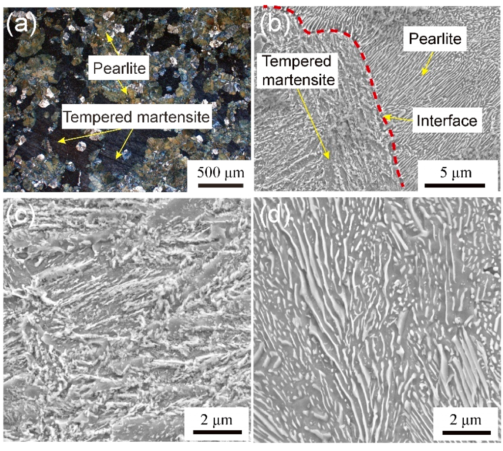

Figure 10 displays OM and SEM micrographs of S1050L-600-550, which underwent intercritical quenching at 1,050°C, pre-tempering at 600°C, and subsequent tempering at 550°C. Figure 10a reveals the microstructure of S1050L-600-500 consists of tempered martensite and pearlite. Due to intercritical quenching, only a portion of austenite is transformed into martensite, while the remainder is converted into pearlite during the subsequent tempering process. Figure 10b illustrates the interface of the tempered martensite and pearlite. The detailed structures of the tempered martensite and pearlite are shown in Figure 10c,d.

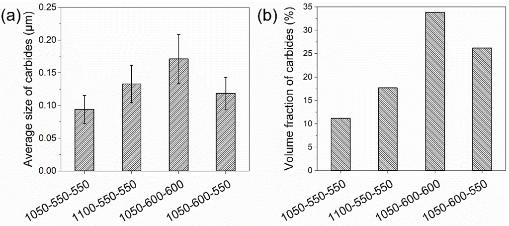

Figure 11 aims to quantitatively analyze the secondary carbides in 5CrNiMoV steel by counting the volume fraction and average size. As indicated in Figure 11a,b, S1050-600-550 achieves not only a high-volume fraction (26%) of the precipitated carbides, but also suppresses carbide coarsening ((0.12 ± 0.03) µm). Regarding other specimens, S1050-550-550 has the smallest average size of the secondary carbides, which is (0.09 ± 0.02) µm. However, the lower tempering temperature is not conducive to carbide precipitation. Thus, in S1050-550-550, the volume fraction of the secondary carbides is merely 11%. In S1100-550-550, the precipitation of a large number of strip-like carbides leads to an increase in both the average size and volume fraction of the secondary carbides. In S1050-600-600, the coarsened secondary carbides are caused by a higher tempering temperature, which is detrimental to the mechanical properties of die steel and should be avoided.

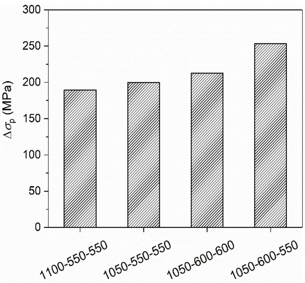

Due to the interaction of carbides and dislocations, precipitation strengthening is mainly related to the average size and volume fraction of the secondary carbides, which are important strengthening mechanisms of die steels [22]. According to the Ashby-Orowan model, the contribution to the YS (Δσp) of the secondary carbides is proportional to the 1/2 power of the volume fraction (fp) and inversely proportional to the average size (dp) of the secondary carbides [23]. It indicates that fine precipitates with fine grain size and high-volume fraction are beneficial for improving the contribution of precipitation strengthening to the YS of the 5CrNiMoV steel. The calculation formula of precipitation strengthening according to the Ashby-Orowan model is written in Equation 1 [23,24]:
where Δσp is the contribution of YS caused by precipitation strengthening, G is the shear modulus of 5CrNiMoV steel (80.26 GPa), fp is the volume fraction of the precipitated carbides, dp is the average size of the precipitated carbides, and b is the Burgers vector.
Based on the information provided in Figure 11 regarding the volume fraction and average size of the secondary carbides, we have calculated the contribution of precipitation strengthening to the YS of different heat-treated specimens. Figure 12 illustrates the contribution of precipitation strengthening to YS ranges from 190 MPa to 255 MPa. Among the specimens, S1050-600-550 exhibits the highest precipitation strengthening contribution, reaching 255 MPa. This finding is consistent with the observations made on the microstructure. Specimen 1050-600-550 possesses a higher volume fraction of secondary carbides and has a relatively fine carbide size, which results in a favorable combination of strength and ductility.

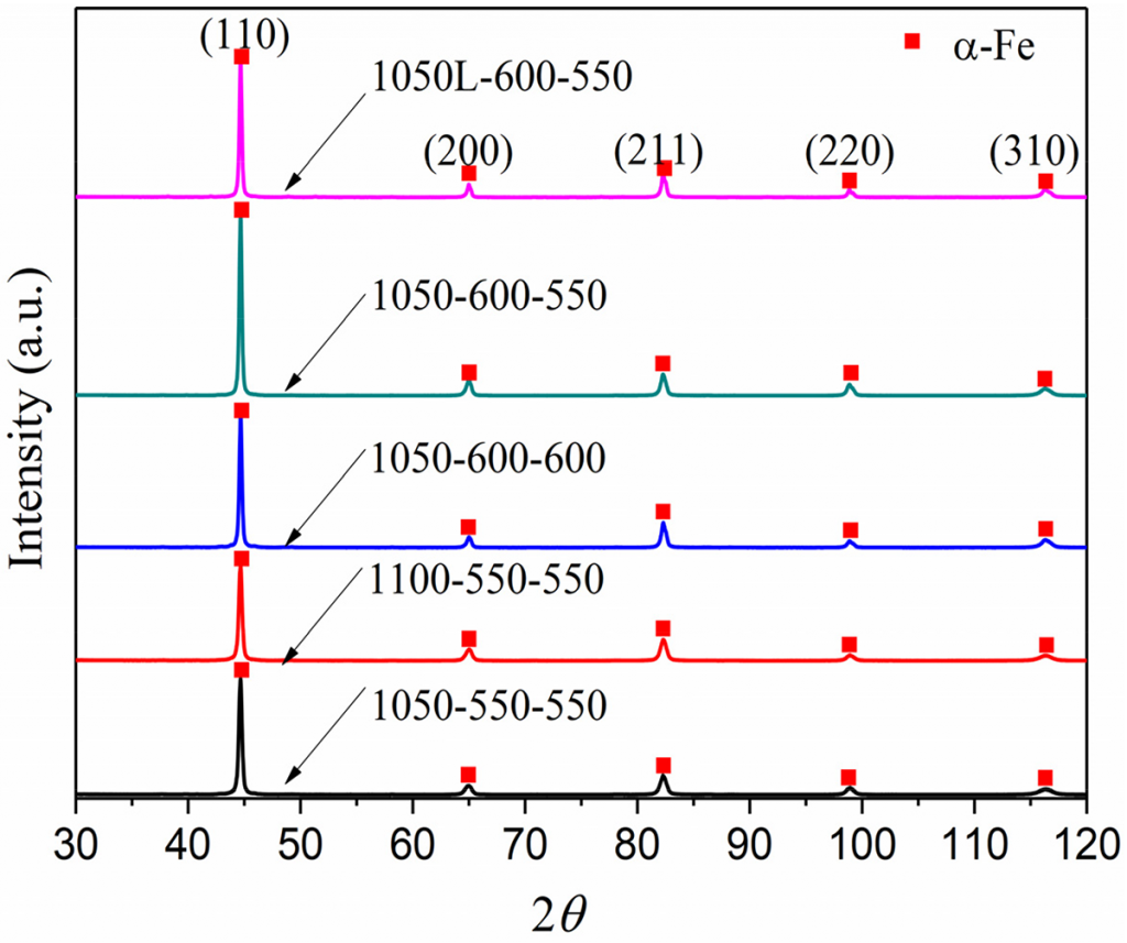

Figure 13 shows the XRD pattern of the heat-treated specimens. The results show all the specimens are primarily composed of ferrite and martensite phases, and no obvious residual austenite peak is detected in the diffraction pattern.

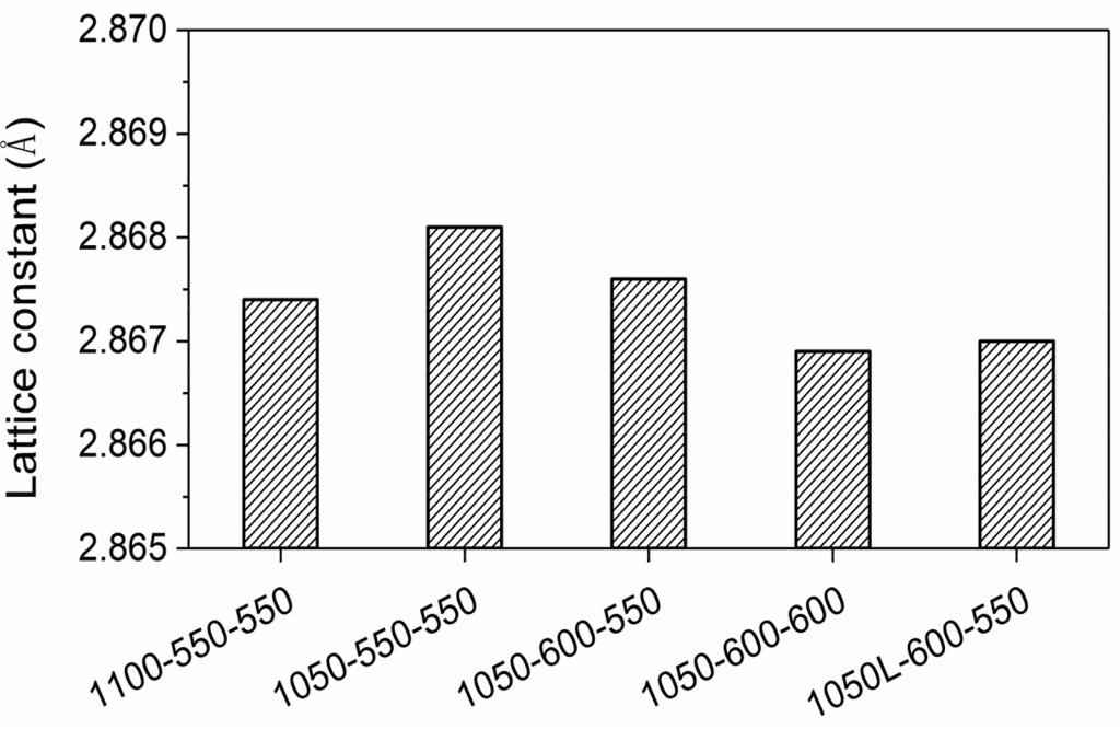

As shown in Figure 14, the average values of the lattice constant for the heat-treated specimens range from 2.8669 to 2.8681Å. Notably, the lattice constant value exhibits an inverse relationship with the volume fraction of the secondary carbides. This observation is consistent with the information presented in Figure 11b and Figure 14, where it is evident a higher volume fraction of secondary carbides corresponds to a smaller lattice constant.
The increase in the volume fraction of secondary carbides with a decrease in the lattice constant can be attributed to the reduction in the content of solid solution alloying elements within the α-Fe matrix. As the volume fraction of secondary carbides increases, the amount of solid solution alloying elements decreases, leading to a reduction in lattice distortion. Consequently, the lattice constant decreases accordingly. In the case of S1050L-600-550, it undergoes intercritical quenching and tempering treatment, resulting in the formation of microstructures consisting of tempered martensite and pearlite. This specific heat-treatment process promotes the precipitation of a significant number of carbides, leading to a smaller lattice constant.

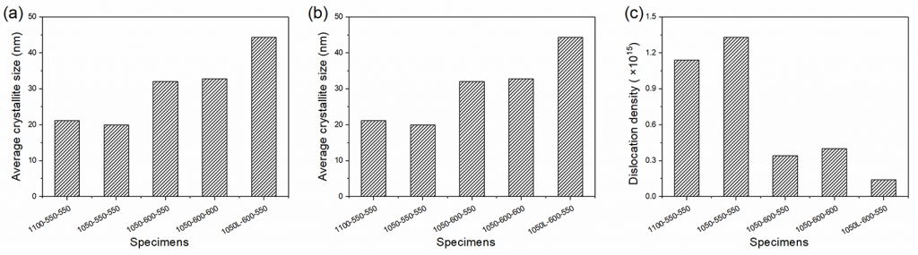

After obtaining the lattice constant, the average crystallite size is calculated using the Debye–Scherrer equation seen in Equation 4 [26].
where θ is the Bragg angle, λ (0.154 nm) is the X-ray wavelength, β is the full width at half maximum (FWHM), and K is a constant equal to 0.89.
In addition, the lattice strain (ε) is determined according to the Williamson-Hall method [26,27]. Therefore, according to the results average crystallite size and lattice strain, the dislocation density is calculated using the Equation 5 [28,29,30,31].
where ρ is the dislocation density, b is the Burgers vector — which for BCC metals, b =(√3/2)a — and a is the lattice constant as shown in Figure 14.
Figure 15 enumerates the computed values of the crystallite size, lattice strain, and dislocation density for all heat-treated specimens. The findings suggest these parameters are significantly influenced by the pre-tempering temperature rather than the quenching temperatures. As shown in Figure 15a, the crystallite size increases with an increase in the pre-tempering temperature, while the lattice strain decreases. This reduction in lattice strain subsequently leads to a decrease in the dislocation density within the martensite matrix (Figure 15b,c). Furthermore, there is a negligible difference in the lattice strain, crystallite size, and dislocation density between S1050-600-550 and S1050-600-600. This observation demonstrates these parameters are predominantly influenced by the pre-tempering temperature.
As shown in Figure 11b and Figure 15, a higher pre-tempering temperature promotes the precipitation of carbides, thereby diminishing the lattice strain and dislocation density of the matrix, which is beneficial for enhancing the ductility of the 5CrNiMoV steel. Additionally, tempering following the pre-tempering process further enhances the precipitation of carbides. To prevent coarsening of the precipitated carbides, it is necessary to lower the tempering temperature. Consequently, in S1050-600-550, the higher volume fraction and finer size of secondary carbides (Figure 11) contribute to an increase in precipitation strengthening, leading to a relatively high YS. Moreover, the reduction in lattice strain and dislocation density also enhances the ductility of the specimen. Regarding S1050L-600-550, the primary microstructures present are tempered martensite and pearlite. Consequently, the values listed for the parameters in Figure 15 for S1050L-600-550 represent a combination of the characteristics exhibited by these two structures.
(c,d) S1050-550-550.

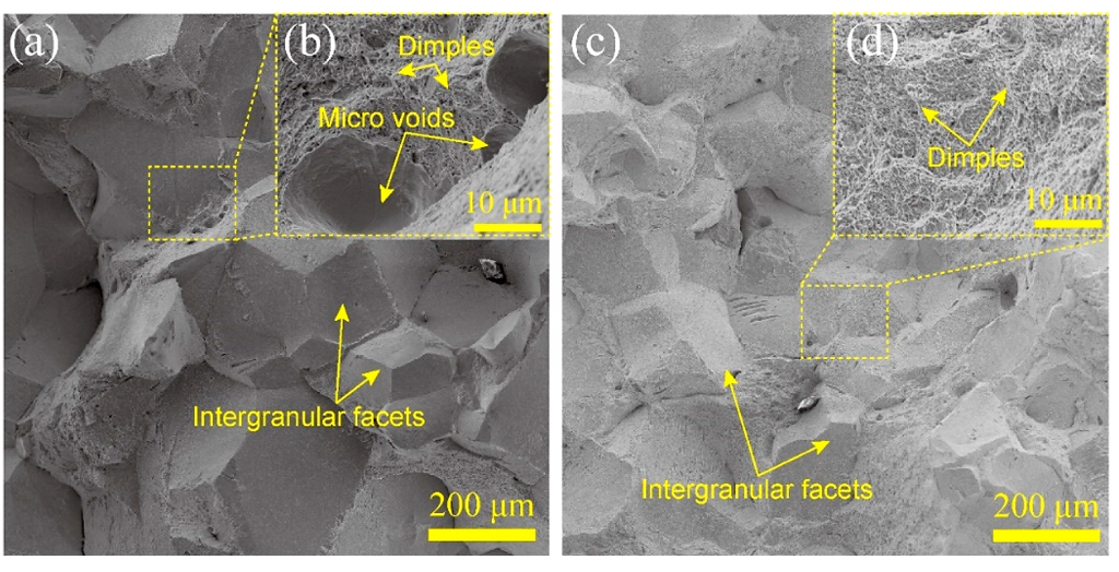

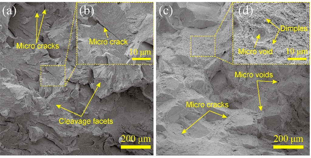

Figure 16 illustrates the tensile fracture morphologies of S1100-550-550 and S1050-550-550. As shown in Figure 16a and its detailed view in Figure 16b, the fractography of S1100-550-550 exhibits a brittle fracture model. As denoted by the yellow arrows, numerous micro-cracks are present on the cleavage facets, which contribute to crack propagation and fracture during tensile deformation [32,33,34]. Figure 16c,d reveals that, in addition to the intergranular fracture facets, local plastic deformation zones exist on the fracture surface. Consequently, there is a slight increase in the EL of S1050-550-550.
(c,d) S1050-600-550.
Figure 17 presents the fracture morphologies of S1050-600-600 and S1050-600-550, characterized by a combination of ductile and brittle fractures. The fracture surfaces exhibit a multitude of intergranular facets, suggesting brittle fracture is the predominant fracture model. However, as demonstrated in Figure 17a,c and their magnified views in Figure 17b,d, numerous fine dimples are visible, indicative of ductile fracture [34]. Therefore, S1050-600-600 and S1050-600-550 exhibit better ductility than S1050-550-550.

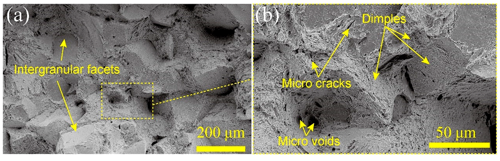

Figure 18 displays the fracture morphology of S1050L-600-550, comprised of dimples, cleavage facets, and micro-cracks, and demonstrating a ductile-brittle mixed mode [32,35]. Furthermore, a notable increase in the number of dimples in Figure 18a compared to Figure 17a,c suggests a growing proportion of ductile fracture in S1050L-600-550. Additionally, as shown in Figure 18b, many deep dimples are formed by the pearlite during tensile deformation, which subsequently delays crack propagation and enhances the EL of the specimen. Therefore, S1050L-600-550 exhibits a relatively high EL.
