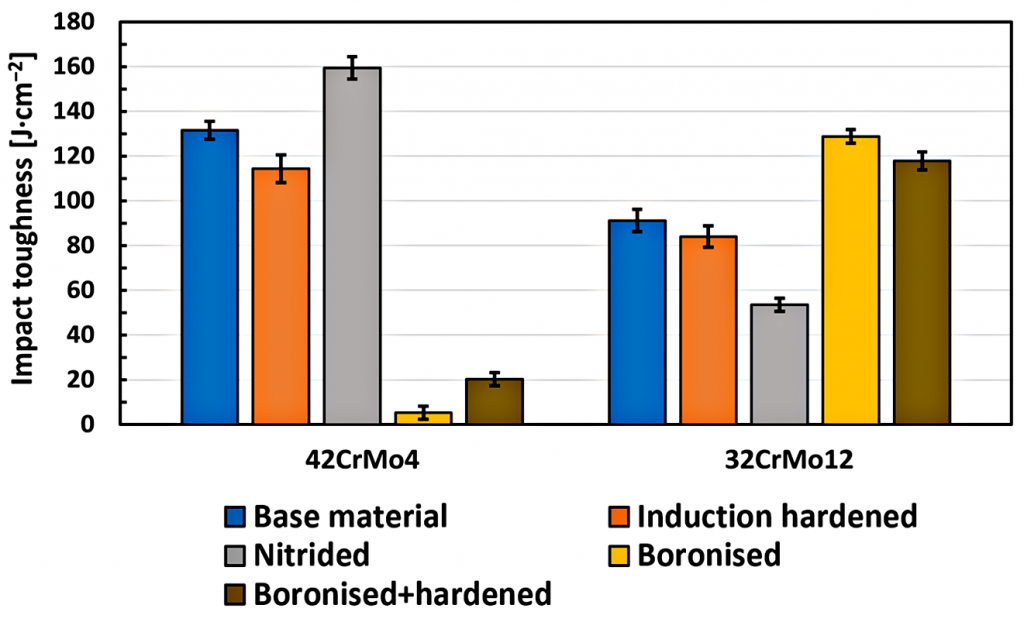

3.2 Impact Toughness Test
Impact toughness tests were performed using a Charpy pendulum with a nominal impact energy of 300 J and a striker with a 2 mm tip radius. The testing temperature was maintained at 22 ± 2°C. The absorbed energy was measured for both U-notched conventional steel specimens and smooth PM Fe-Cu-C specimens. The data were then converted into deformation work consumed per unit area of fracture (impact toughness in J/cm2) by dividing the absorbed energy by the actual cross-sectional area of the specimen. U-notches with a depth of 2 mm were introduced into the conventional steel specimens before heat treatment. The cross-section for these specimens was calculated according to a more precise, older version of the STN EN ISO 148-1 to account for the notch. Specimens of PM Fe-Cu-C steels were tested without notches.
Three Charpy pendulum tests were conducted on each specimen group, and the average impact toughness values with standard deviations are shown in Figure 2 and Figure 3.
Nitriding is frequently used as an optional heat-treatment process for conventional 42CrMo12 steel. As can be seen in Figure 2, nitriding can significantly increase the impact toughness of 42CrMo12 steel. An increase in the impact toughness after nitriding is generally attributed to the positive influence of molybdenum.
On the other hand, it is evident that using nitriding can also cause a significant decrease in the impact toughness of other conventional and PM steels. In this study, the impact toughness of 32CrMo12 steel decreased by half after nitriding. Furthermore, the impact toughness of PM Fe-Cu-C steels was reduced by as much as one third following nitriding.
During nitriding and boronizing, the surface layers of steel are saturated with interstitial atoms of nitrogen and boron. The diffusion processes occurring during nitriding and boronizing are analogous, but they are also very different due to the distinct structural changes induced in the processed steel, which makes comparing nitriding and boronizing very difficult. Conventional steels are typically nitrided in the quenched and tempered (Q&T) condition. The industrial nitriding of Q&T steels is typically performed within a process-dependent temperature range of 350-600°C, which is preferably between 550 and 580°C. Higher process temperatures facilitate deeper nitrogen penetration within the material for a given treatment time. However, higher temperatures and prolonged holding times also promote microstructural changes within the Q&T steel substrate, leading to a reduction in its hardness.
The nitriding of steels generally occurs below the high-temperature tempering range (350-700°C), preventing solid-state phase transformations such as the transformation of ferrite, pearlite, or martensite to austenite. Only the transformation of martensite to sorbite may occur. In contrast, boronizing typically occurs above the transformation temperature, leading to the saturation of the steel surface with boron within the austenitic phase. These solid-state phase transformations result in significant microstructural changes within the steels during boronizing.
These microstructural changes significantly affect the mechanical properties of the boronized steels. Therefore, to restore the original sorbitic microstructure of the Q&T steel, re-hardening (quenching and tempering) after boronizing is necessary. However, some negative effects, such as grain coarsening during prolong austenitizing at high temperatures and detrimental changes in segregation, are irreversible. These effects, along with other diffusion-related changes within the solid solution of the metal matrix, contribute to significant embrittlement. In the case of 42CrMo steel, extensive negative microstructural changes occurred during boriding, leading to complete embrittlement. The irreversible nature of these changes in 2CrMo steel is so pronounced that even re-austenitization followed by rapid cooling failed to restore its impact toughness to more than one fifth of its original level before boronizing.
Contrary, in 32CrMo12 steel, nitriding resulted in a decrease in the impact toughness. This is likely attributed to the use of a slightly elevated nitriding temperature (approximately 5°C above the recommended range) for all experimental steels. However, unexpectedly, boronizing led to a significant increase in the impact toughness of 32CrMo12 steel.

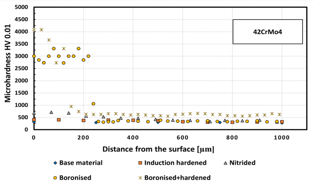

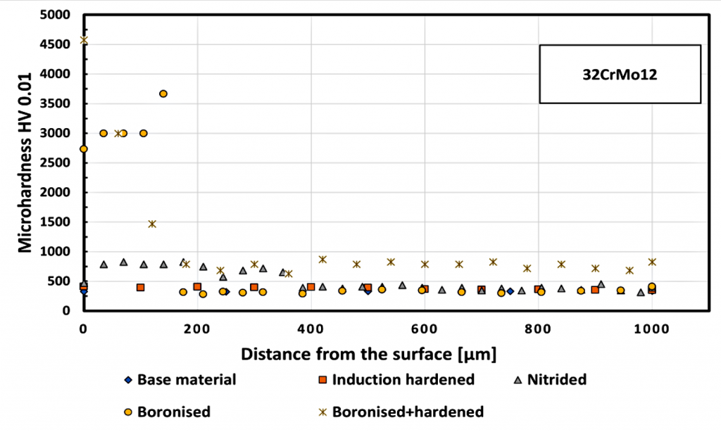

Microhardness measurements were performed on the cross-sections of the surface-hardened specimens using the Vickers method (HV 0.01). Prior to testing, specimens were prepared following standard metallographic procedures. This involved sectioning, mounting in a hard compression powder using a press, and subsequent mechanical grinding and polishing. An electrically conductive polishing powder was used to enable subsequent analysis using techniques such as energy-dispersive X-ray spectroscopy (EDX) in an electron microscope. After preparation, microhardness measurements were gained using an automated microhardness tester under an applied test force of 0.01 kgf (0.098 N).
Regarding the influence of surface-hardening technology on the achieved hardness and layer thickness, the measured hardness after the induction hardening and nitriding of 42CrMo4 and 32CrMo12 steels correspond to the typical values observed in industrial practice.
After the boronizing of 42CrMo4 and 32CrMo12 steels, the measured hardness increased more than four times compared to the values achieved after nitridation; see Figure 4 and Figure 5. This study successfully produced a compact, extremely hard boride surface layer on these steels. This layer exhibited excellent adhesion to the substrate and significantly exceeded the hardness and thickness of boronized layers reported by other authors [13]. The boride layer demonstrated a sharp boundary, and the diffusion zone was extremely narrow.
As a result, the hardness decreased sharply from the maximum value at the surface to the substrate hardness within approximately 200 µm. Unlike the nitride layer, which exhibits a wide transition diffusion zone characterized by a gradual hardness decrease, the extremely narrow transition diffusion zone of the boronized layer cannot be accurately identified using conventional microhardness testing. For detailed mapping of this transition zone, techniques such as nanoindentation should be used.
Re-hardening after boronizing increased the hardness of the bulk material and within the transition diffusion zone while slightly decreasing the hardness of the boride layer itself. It can be seen that re-hardening slightly increased the thickness of the boronized layer at the expense of a minor reduction in microhardness.

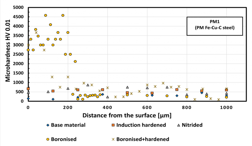

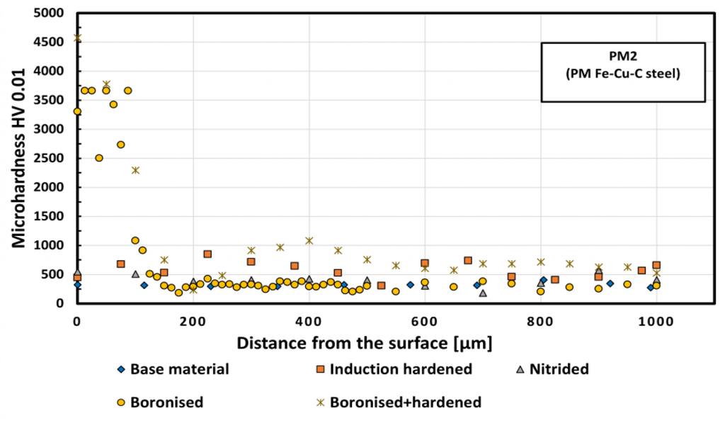

Surface hardening brought similar results for PM Fe-Cu-C steels. As can be seen in Figure 6 and Figure 7, induction hardening proved to be a highly suitable technology for these materials. Nitriding, however, demonstrated the least effectiveness among the applied methods. The most favorable results were obtained with boronizing either alone or followed by re-hardening.

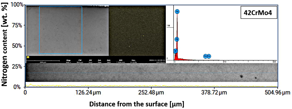

Figure 8b illustrates the nitride layer and the sorbitic microstructure of nitrided 42CrMo4 steel. The visible thickness of the nitride layer is approximately 100 µm, while microhardness testing indicates a diffusion layer depth of approximately 350 µm. Beyond this depth, the hardness decreases due to the declining nitrogen content, as confirmed by EDX analysis (Figure 9). The substrate microstructure exhibited a finer grain size due to the transformation of coarse martensitic plates into fine sorbite during the prolonged exposure to the nitriding temperature, which is close to the high-temperature tempering temperature range for this steel.

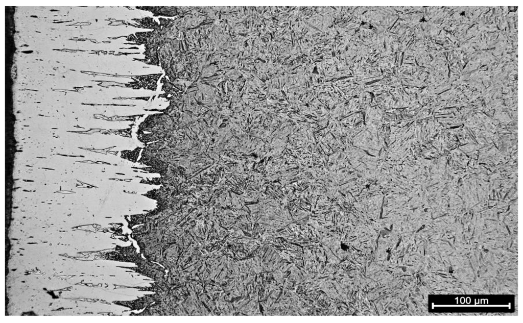

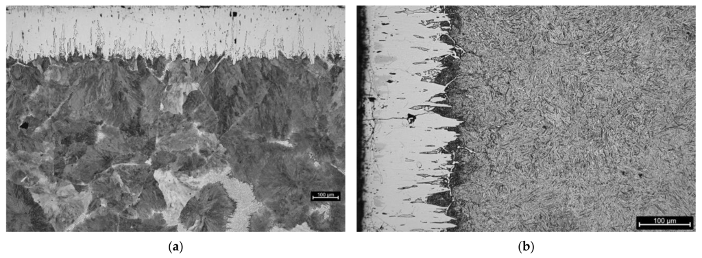

Figure 10a depicts a detail of the sharply defined, white boride layer (approximately 150 µm thick) on the surface and reveals unfavorable microstructural changes within the diffusion zone of the boronized 42CrMo4 steel. The prolonged exposure to the high boronizing temperature resulted in the transformation of the sorbitic microstructure to austenite, which subsequently transformed into a relatively coarse pearlitic microstructure during slow cooling. This pearlitic microstructure is primarily confined to the transition diffusion zone immediately beneath the white boride layer, where boron has been substituted for carbon. Within this narrow transition zone, a tendency toward the formation of a boride network along grain boundaries is also evident. As shown in Figure 10b, the bulk of the substrate exhibits a pearlitic–ferritic microstructure, which is characteristic of this hypoeutectic steel in the annealed condition.

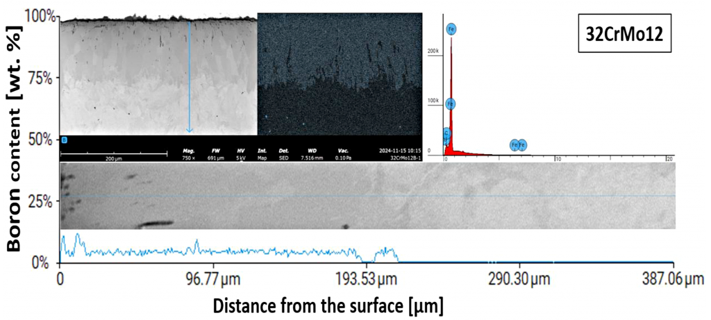

EDX analysis (Figure 11) confirmed the sharp interface observed between the boride layer and the substrate during metallographic examination. Figure 12 illustrates the boronized layer of 42CrMo4 steel after re-hardening. Re-hardening, conducted uniformly at identical process parameters for all re-treated specimens in a vacuum furnace followed by oil quenching in an argon atmosphere, resulted in significant microstructural changes. The microstructure within the transition diffusion zone and the bulk material transformed completely to a sorbitic structure. Notably, the sharply defined white boride layer on the surface remained unaffected by the re-hardening process. However, within the narrow transition diffusion zone, a boride network formed along the grain boundaries.

Figure 15a illustrates the microstructure of boronized 32CrMo12 steel. Similar to boronized 42CrMo4 steel, a sharply defined white boride layer of approximately the same thickness is observed on the surface. The prolonged exposure to the high boronizing temperature resulted in the formation of a pearlitic microstructure, which is consistent with the phase transformations observed in 42CrMo4 steel. The primary distinction lies in the fully pearlitic microstructure within the bulk of the substrate, which is attributable to the higher chromium and nickel content of 32CrMo12 steel. The thickness of the white boride layer varies between 150 and 200 µm, and the transition diffusion zone remains narrow.

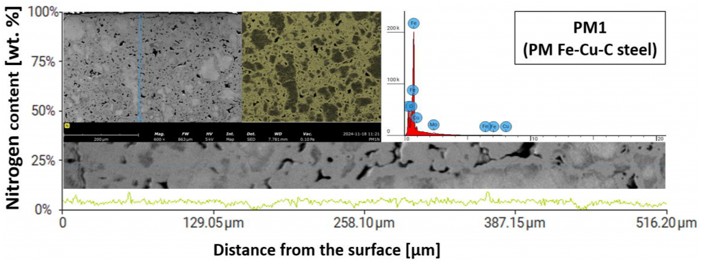

Figure 18a reveals the microstructure of nitriding PM1 steel. A prominent feature is the surface layer, which is enriched with nitrogen to a depth of 1.5 mm. This is followed by a transition zone extending up to 2.5 mm. Within this zone, nitrogen diffused into the sintered steel, notably using the existing pores to penetrate and envelop individual grains. A noteworthy observation is the presence of nitrogen supersaturation throughout the entire cross-section of the material. Beyond this, no other significant microstructural changes were observed in the nitriding PM1 steel.
High nitrogen supersaturation was also confirmed by EDX analysis (Figure 19).

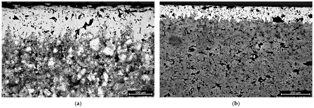

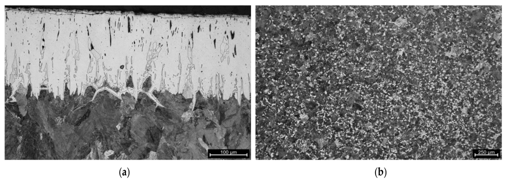

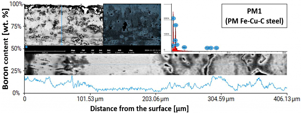

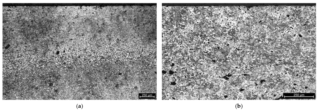

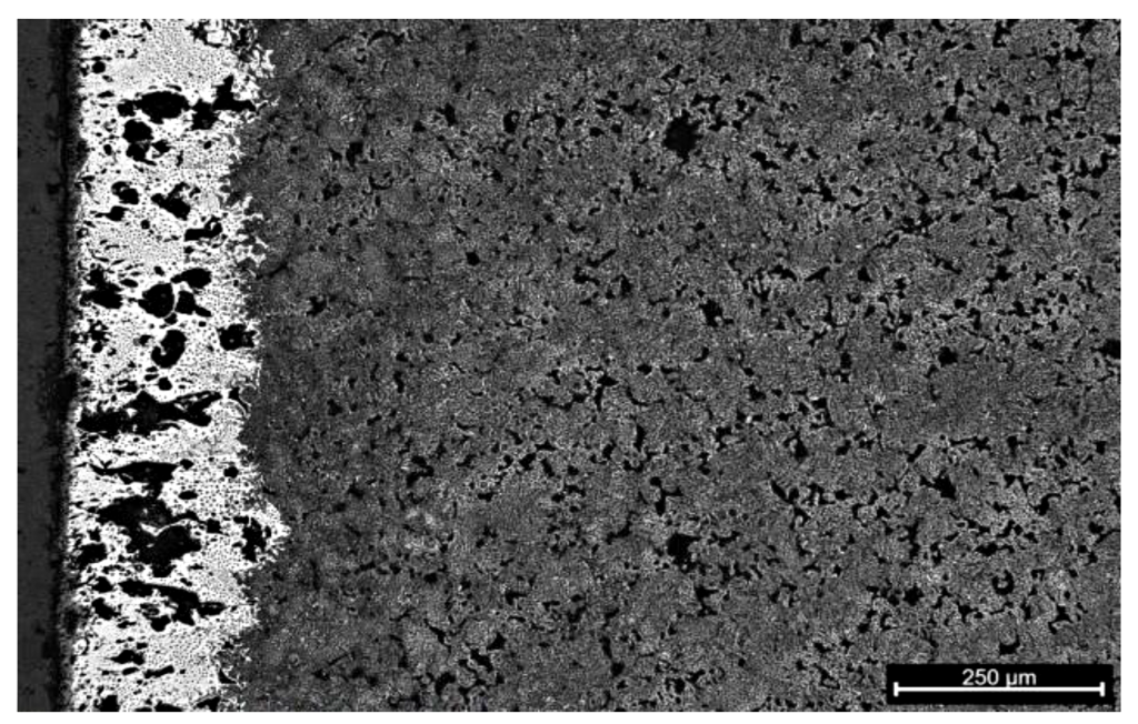

Figure 18b presents the microstructure of PM1 steel following boronizing without subsequent re-hardening. The boride layer exhibits a thickness ranging from approximately 250 µm at the center of the edge to 300-450 µm at the corners of the specimen. Microstructural analysis revealed the presence of a single predominant boride phase within this layer. Based on the measured layer hardness, this phase was tentatively identified as FeB. A high density of pores was observed within the boride layer. Furthermore, a distinct transition zone was evident within the layer, which was characterized by a gradual change from the upper, white, and harder FeB phase to a lower, softer, gray phase.Boride-like formations were observed extending beyond the defined diffused layer. EDX analysis (Figure 20) confirmed that diffusion occurred deeper into the material primarily through the existing pores.

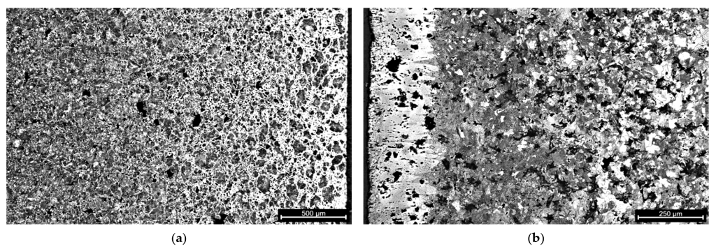

Figure 21 illustrates the microstructure of boronized PM1 steel following re-hardening. It is hypothesized that entrapped gas within the bulk material migrated toward the boride layer during the re-hardening process, contributing to an increase in porosity within the boride layer (Figure 18b). The higher porosity observed in PM1 steel compared to PM2 steel was reflected in the mechanical test results. Specifically, an increase in the coefficient of friction, a slight decrease in impact toughness, and an increased scatter in the measured hardness values of the boronized layer were observed in PM1 steel.

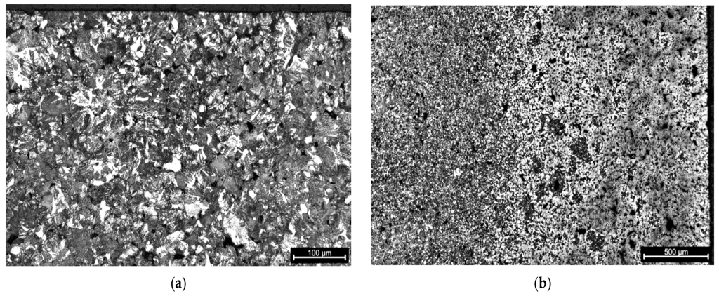

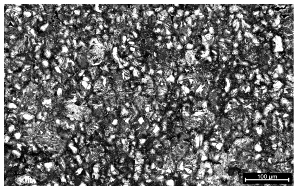

Figure 22 illustrates the base microstructure of PM2 steel. Compared to PM1 steel, distinct differences are observed in the microstructure, including variations in the character and distribution of pores. The twice higher copper content in PM2 steel, acting as a binder for the steel powder, resulted in a significant reduction in the porosity.

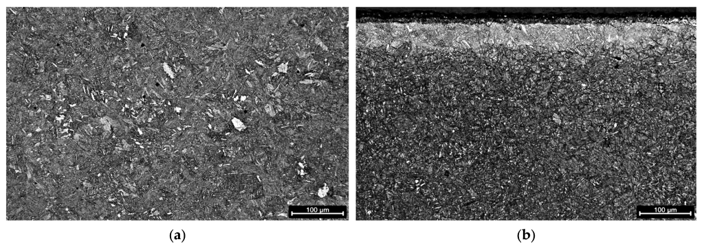

Figure 23a depicts the microstructure of induction-hardened PM2 steel. The observed width of the hardened layer and the transition zone closely resemble those observed in PM1 steel, indicating minimal discernible differences between the two materials in response to this surface-hardening treatment.

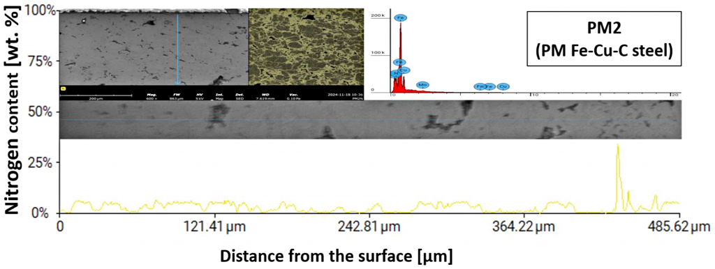

Figure 23b presents the microstructure of nitrided PM2 steel. Notably, EDX analysis (Figure 24) revealed that nitrogen diffusion penetrated the entire cross-section of PM2 steel.
Figure 25a presents the microstructure of boronized PM2 steel. The boride layer exhibits a thickness ranging from 160 µm to 200 µm. Notably, this layer displays a higher degree of porosity compared to that observed in PM1 steel. Furthermore, the transition diffusion zone remains narrow, which is similar to that observed in PM1 steel.
Figure 25b presents the microstructure of boronized PM2 steel following re-hardening. The porosity within the boride layer and its overall thickness (ranging from 180 µm to 200 µm) remained largely unchanged after the re-hardening process. A notable observation is the appearance of small cracks within the boride layer after re-hardening, which are similar to those observed in boronized 32CrMo12 steel. This suggests a potential need for optimization of the re-hardening parameters for PM2 steel to lower the formation of these cracks. The boride layer in PM2 steel exhibits a sharp boundary, which is similar to that observed in conventional steel. Minimal boride-like formations were observed beyond the defined diffusion zone. EDX analysis (Figure 26) revealed that boron diffusion extended to a depth of approximately 150 µm within the material.
