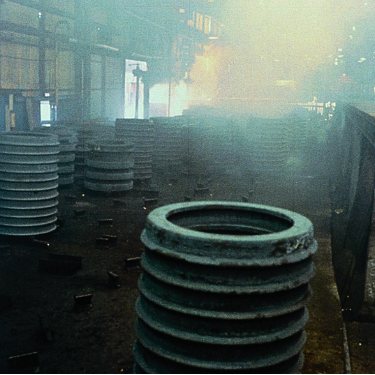

Figure 1: Smoke and fumes found in a typical heat-treating shop [2].

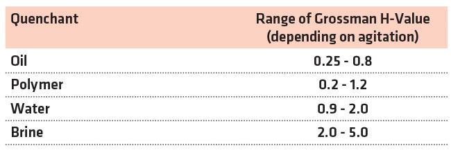

There are three primary driving forces for the application of polymer quenchants in the heat-treating shop: reduction of fire hazards, environmental concerns, and cost. Water-based quenchants significantly reduce the risk of fire. Environmental concerns, such as disposal and regulations concerning volatile organic compounds (VOC) are reduced due to the use of water and the low volatility of polymer quenchants. The ability of polymer quenchants to be concentrated by reducing water content significantly reduces the disposal costs.
Table 1: Typical quench severity achievable with various quenchants.
While the cost of polymers per gallon is high compared to oil, polymer quenchants are diluted with water, which drastically reduces their in-tank costs. As an example, a manufacturer had planned to fill his 50,000-gallon open quench tank with moderate speed oil. Filling this tank would cost more than $350,000. An appropriate choice of polymer quenchant at a concentration (15%) that would yield an equivalent quench rate achieved an in-tank cost savings of $175,000. The benefits of reduced fire risk (and lower attendant fire insurance premiums), environmental concerns, and cost have resulted in a much larger market share for polymer quenchants in the past 40 years.

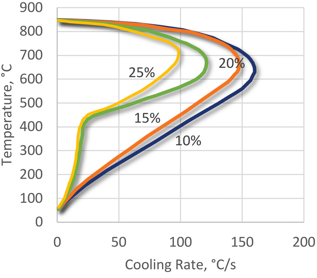

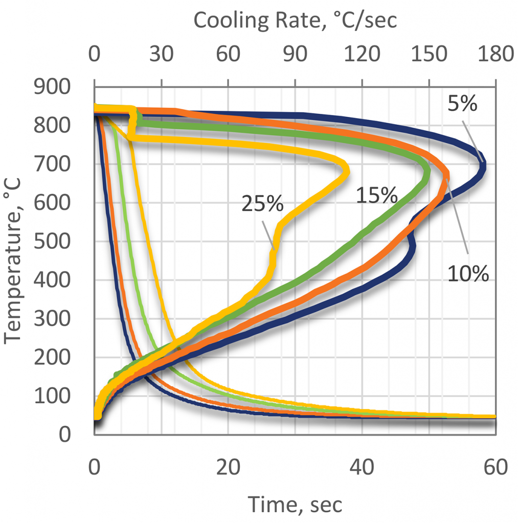

As the concentration of the polymer is increased, the effective quench rate is reduced. As the concentration is increased, a limit will be reached where additional additions of polymer will not significantly reduce the cooling rate. This concentration is dependent on the molecular weight of the polymer, and the type of polymer chosen.

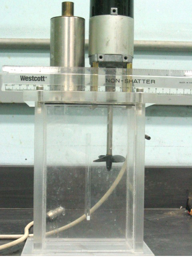

Figure 2: Tensi apparatus for testing polymer quenchants, as described in ASTM D6482 [1].

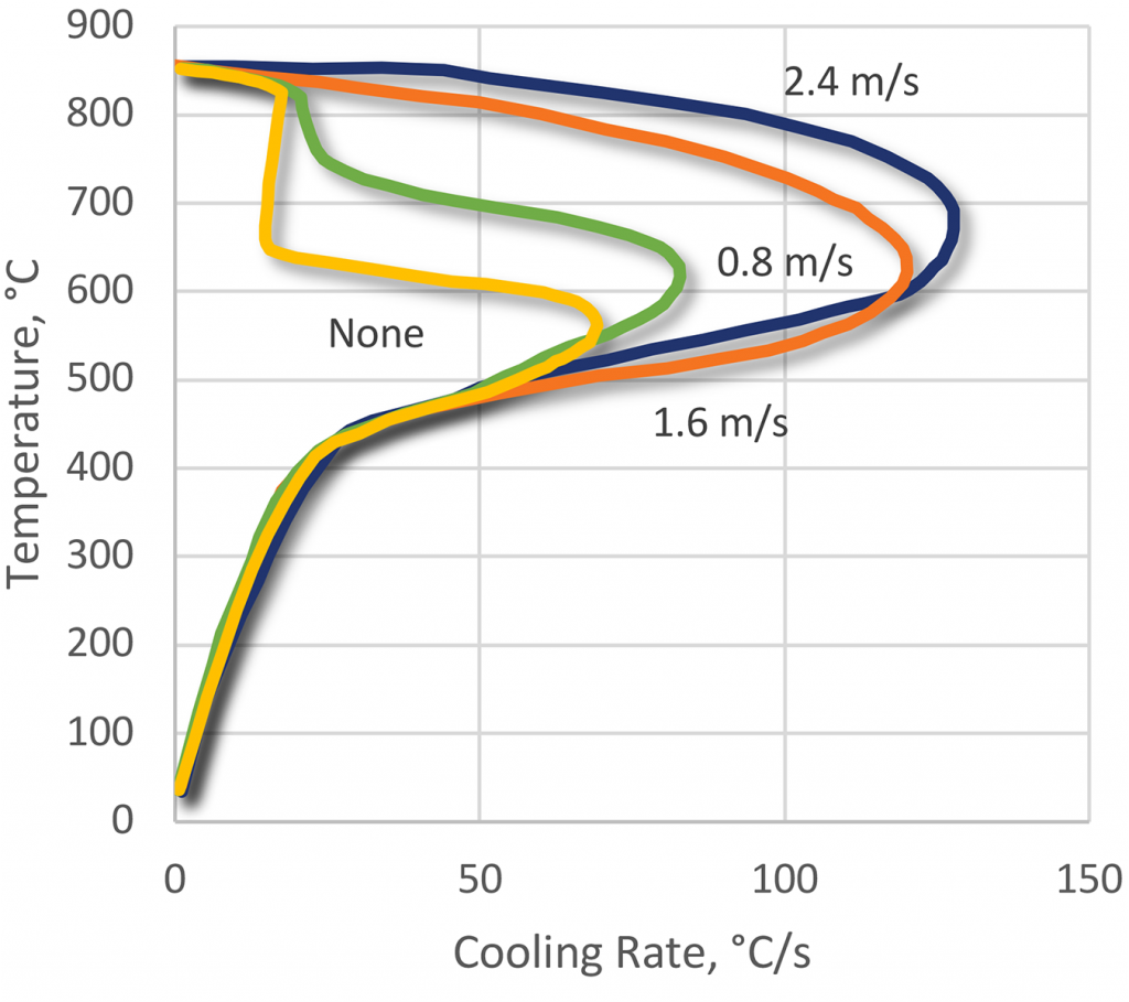

Polymer quenchants tend to be more sensitive to agitation than mineral oils. Increasing the agitation increases the cooling rate and reduces the polymer film thickness. However, decreasing the agitation can produce non-uniform quenching because of non-uniform film thickness. It also limits the transport of polymer to the part surface. As in every quenching operation, the magnitude and uniformity of agitation is extremely important. Racking of parts is also more critical in polymer quenchants than mineral oil because of the strong effects of temperature. Agitation tends to minimize these thermal gradients within the quenchant.
Because of the sensitivity of polymer quenchants to agitation, cooling curves of these quenchants are performed using agitation. They are not tested without agitation like oil quenchants or water. Specialized agitation devices are used, such as the Tensi agitation system (Figure 2) as described by ASTM D6482 [1].

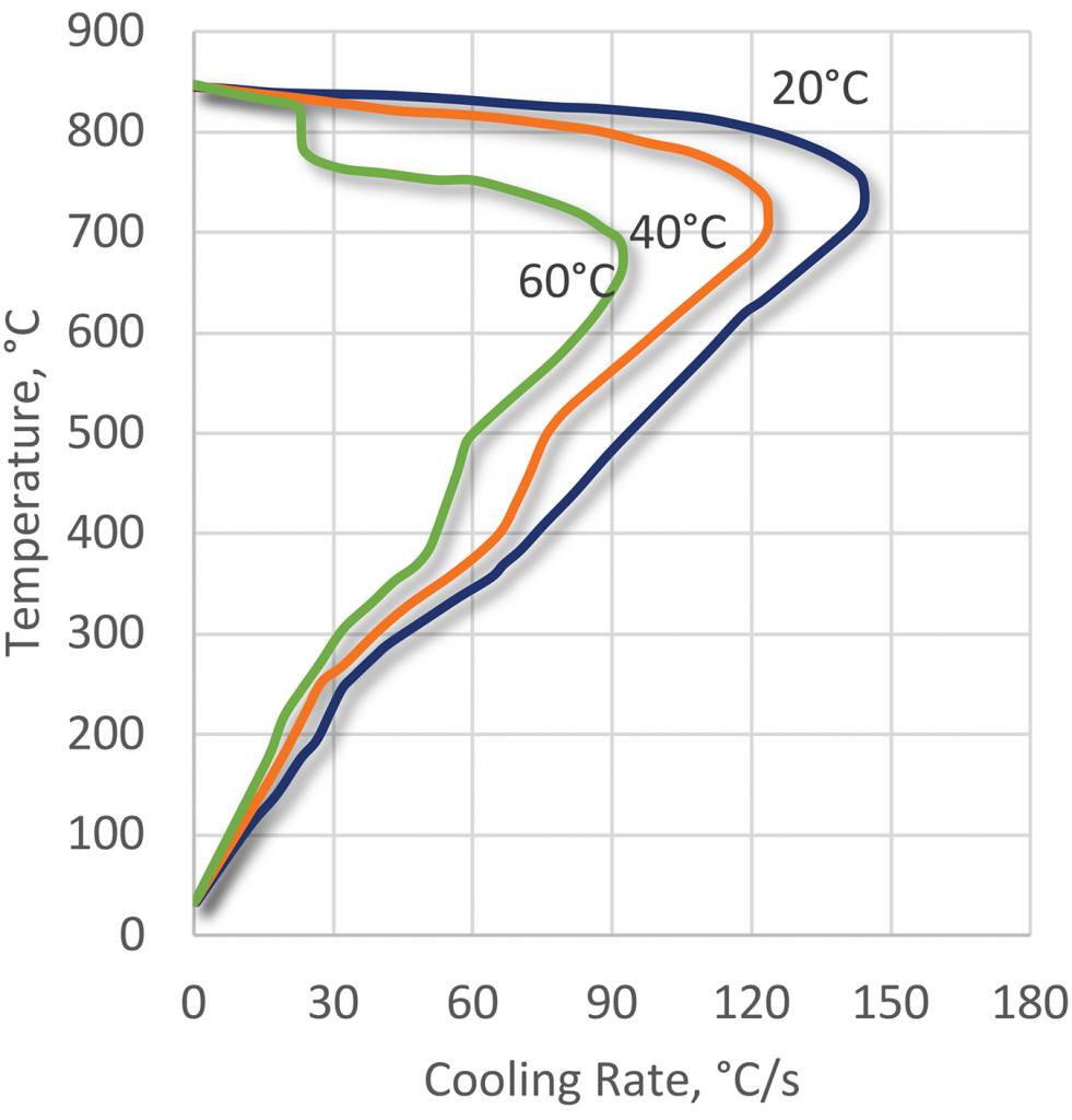

The effective quench rate of polymer solutions is affected by temperature. As temperature increases, the quench rate is reduced. Increasing temperature also increases the oxidation and reduces thermal stability of the polymer, effectively shortening the life of the polymer. The amount of degradation is dependent on the amount of polymer present used, and the application temperature. Depending on the polymer used, there is also a limit on the bulk quench temperature of the quenchant, as some quenchants will tend to separate or precipitate from solution. In general, the typical operating temperature range of polymer quenchants is 20-45°C.

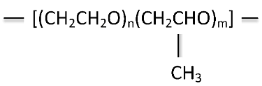

Figure 3: Chemical structure of polyalkylene glycol.
There are four predominant types of polymer quenchants in use today: polyalkylene glycol (PAG), polyethyl oxazoline (PEOX), polyvinyl pyrrolidone (PVP), and sodium polyacrylate (ACR).
1 Polyalkylene glycol quenchants
Polyalkylene glycol (PAG) quenchants are the most-used polymer quenchants in the heat-treating market today. Polyalkylene glycols (PAG), or polyalkylene glycol ethers, were first introduced as quenchants in the early 1970s. PAG quenchants are an example of a copolymer. This quenchant is derived from two monomeric units, ethylene oxide and propylene oxide, to form polyalkylene glycol (Figure 3).

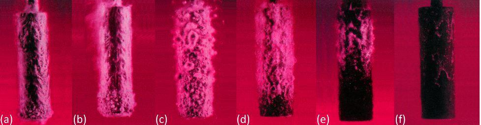

Figure 4: The quench sequence in a typical polymer quenchant: (a) immediately after quenching, a thick polymer film precipitates on the surface of the part; (b) after 15 seconds, the film becomes active; (c) after 25 seconds, the film ruptures over the entire surface; (d) after 35 seconds, boiling ceases and convection begins; (e) after 60 seconds, the polymer starts to re-dissolve back into solution, and (f) after 75 seconds, the polymer has practically re-dissolved back into solution and heat removal is completely by convection.

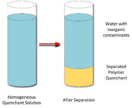

However, the selected PAG molecules exhibit the unique behavior of inverse solubility in water, that is, water insolubility at elevated temperatures. This phenomenon provides a unique mechanism for quenching by surrounding the metal piece with a polymer-rich layer that serves to govern the rate of heat extraction into the surrounding aqueous solution. As the metal part approaches the quenchant temperature, the PAG polymer coating dissolves to again provide a uniform concentration in the quenchant bath. In PAG quenchants, this occurs in the temperature range of 60-85°C depending on the specific polymer. See Figure 4.
This mechanism of inverse solubility is limited to two polymer quenchant classes: PAG and PEOX. In these systems, as the temperature of the solution is raised, the thermal energy of the system becomes greater than the energy of the hydrogen-bond interactions with water. When this occurs, a two-phase system develops, with one layer being water-rich and the other a polymer-rich layer (Figure 5). This is not a clean separation as both phases have some of the other components. The temperature at which this separation occurs is called the cloud point. In PAG quenchants, the ratio of the monomers used to produce PAG quenchants control the cloud point. In this case, the cloud temperature decreases as the propylene oxide monomer proportion increases.
Figure 5: Separation of water and PAG polymer when heating above the cloud point. This phenomenon can be used to recover polymer from quenchant solutions [3].
While thermal separation can be used to recover the polymer, the water-soluble corrosion inhibitors will report to the water phase. Once the polymer solution is reconstituted with water, additions of corrosion inhibitors must be added to the solution to maintain proper corrosion inhibition.

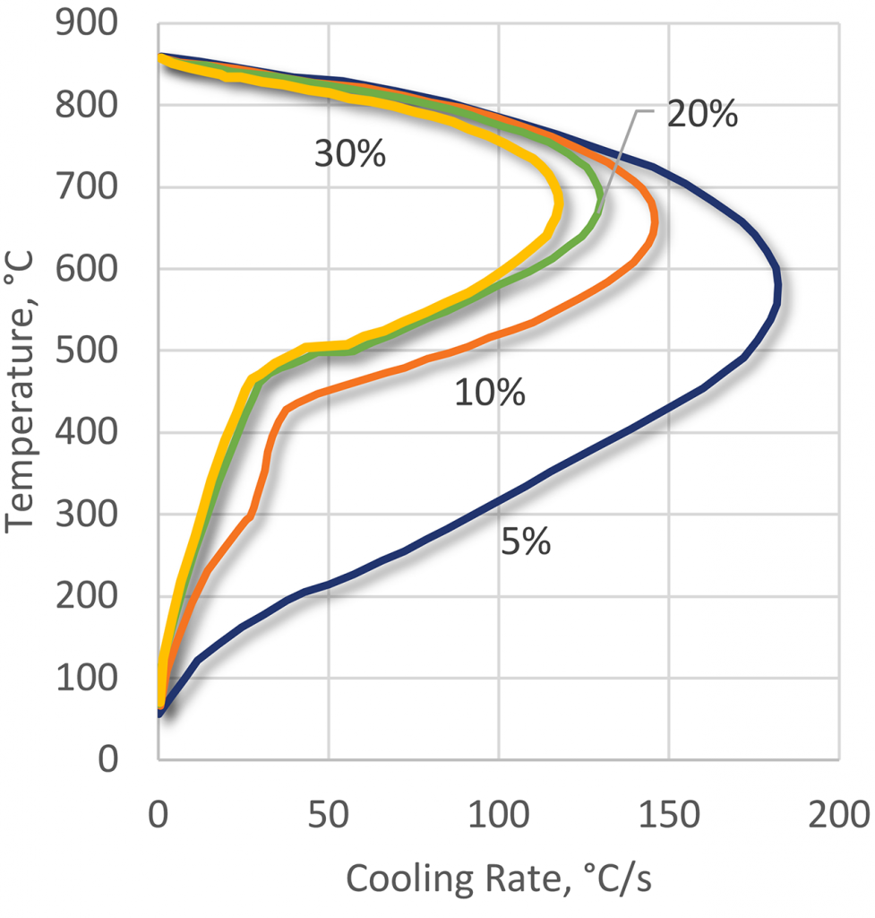

Effect of Concentration, Temperature, and Agitation
As concentration is increased, the overall rate of quenching decreases (Figure 6). This is due to the increasing thickness of the polymer film as the concentration increases.
Different PAG quenchants will exhibit different cooling curves, as it is dependent on the molecular weight of the polymer. As the molecular weight increases, the cooling rate decreases.
Figure 6: Effect of concentration of a PAG on the relative cooling curve.

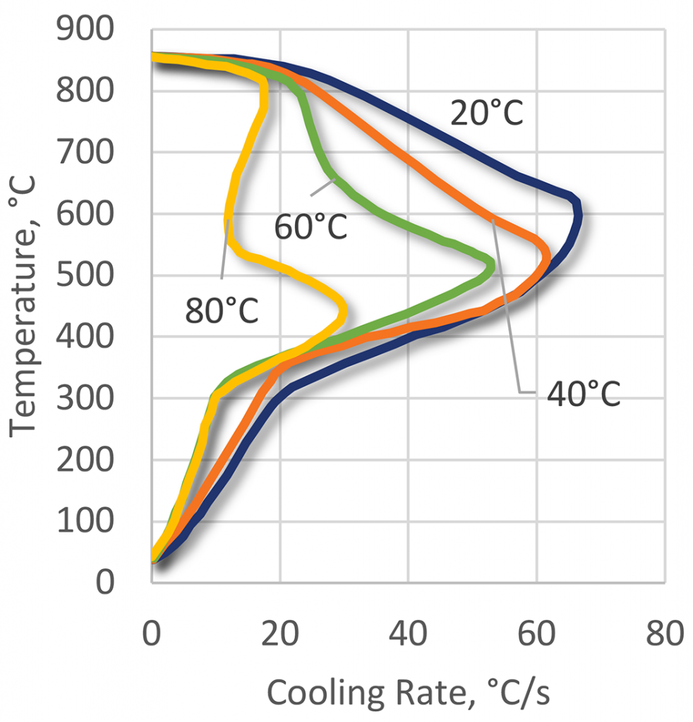

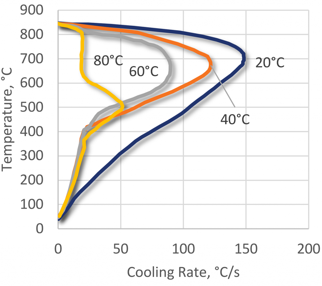

Just as water exhibits a loss in quenching power as temperature is raised, so do PAG quenchants. As the temperature is increased, the quenching power of PAG quenchants decreases (Figure 7). In general, PAG quenchants are limited in bulk temperature rise to less than 25°C less than their cloud point. If the bulk temperature exceeds the cloud-point temperature, then separation of the polymer could occur. If parts are extracted at temperatures above the cloud point, then excessive drag-out of the polymer would occur.
Agitation is always recommended for PAG polymer quenchants (or any other polymer quenchant). In general, low to moderate agitation is essential (a) to ensure that adequate replenishment of polymer occurs at the hot metal surface and (b) to provide uniform heat transfer from the hot part to the surrounding reservoir of cooler quenchant. Vigorous agitation may be essential for achieving a rapid rate of cooling (for example, with a low hardenability steel) to avoid undesired transformation.
Figure 7: Effect of temperature on the cooling rate of a PAG polymer at 20% concentration.

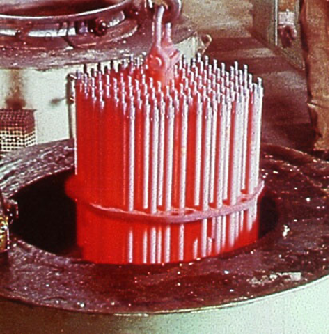

Immersion quenching of steel components
The primary reason for consideration of PAG quenchants for steel quenching is the elimination of the smoke, fume, and fire hazards associated with quenching oils, although the benefits of flexibility of quenching speed and improved process economics are also important.
PAG quenchants are suitable for a wide range of steels, including plain carbon steels, boron steels, spring steels, general engineering steels, martensitic stainless steels, low- and medium-alloy carburizing steels, and higher-alloy steels of heavier section thickness.
Components that can be processed range from very small parts with section size as small as 1 mm (such as needles, circlips, screws, and fasteners) up to large shafts and forgings weighing 10 tons or more.
Between these extremes, a very wide range of components including bolts, bearings, crankshafts, springs, steel bars and coils, high-pressure gas cylinders, general forgings, and agricultural and automotive parts have been successfully quenched into PAGs.

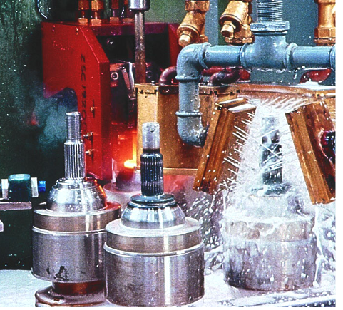

Figure 8: Induction hardening of an automotive constant velocity joint using a PAG at 7%.
Induction hardening applications of PAG quenchants

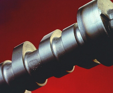

PAG quenchants are used widely for the quenching of components after induction or flame hardening as an alternative to water, soluble oil, or mineral oil. They are generally used at concentrations of 5-15 percent to eliminate spotty hardening associated with water quenching, to control distortion, and to provide corrosion protection to the induction hardening equipment.
Typical applications include the quenching of gears, crankshafts, camshafts, drive shafts, bearing rings, tubes, and bars (Figure 8 and Figure 9).

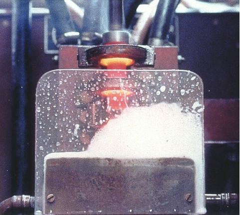

Figure 9: Induction hardening of an automotive camshaft using a PAG at 5%.
Typically, these quenchants are governed by AMS 3025 [4], and are either Type I or Type II quenchants. Type I quenchants are single polyalkylene glycol polymers, while Type II quenchants are multiple molecular weight polyalkylene glycol polymers. Each offers different benefits. Because of the higher molecular weight of the Type II PAG quenchants, lower concentrations can be used.
The controlled uniform quenching characteristics of PAGs can significantly reduce or even eliminate the distortion often associated with water quenching without impairing mechanical properties or corrosion resistance. This is particularly important with thin-section sheet aluminum airframe components in the aerospace industry and complex castings and forgings, which are often quenched into boiling water or mineral oil to minimize distortion. [5]

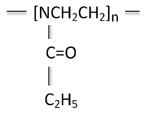

Polyethyl oxazoline-based products represent the second generation of polymer quenchants. Developed as part of a continuing program of product innovation and improvement, PEO technology is now covered by worldwide patents.
Polyethyl oxazoline (PEOX) is synthesized from the polymerization of ethyl oxazoline (Figure 10).

PEO chemistry is highly efficient in modifying quenching characteristics, and required properties are obtained at low polymer concentrations. This results in less drag-out than with other types of polymers and consequently great economy in use. Any polymer remaining on the surface dries to a hard, tack-free film, ensuring freedom from sticky residues.
Figure 12: Induction-hardened camshaft quenched with PEOX polymer quenchant showing freedom from sticky deposits.

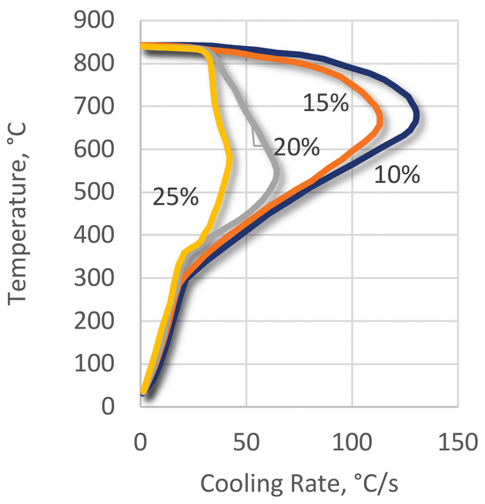

Quenching Characteristics of PEOX Quenchants
PEO-based quenchants exhibit inverse solubility at a temperature of 60-65°C. Hence, the quenching mechanism is very similar to that of the polyalkylene glycol-based products. Like all other types of polymer quenchants, the quenching characteristics are dependent upon polymer concentration, bath temperature, and degree of agitation.
PEO polymers can be used over a wide range of concentrations from 5-25 percent (Figure 11) depending upon the application. PEO products have the least stable vapor phase of all the polymer quenchants and this is particularly important during induction hardening and in the quenching of low hardenability steels.
Also, the very low cooling rate in the convection phase, where, at concentrations of 15-25 percent, the quenching speed is almost identical to that of quenching oil. This extends the range of applications to critical high-alloy steels.

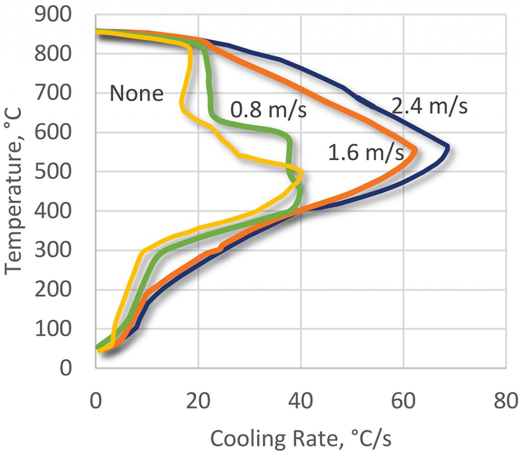

As with all polymer quenchants, the cooling effect is dependent upon the degree of agitation. However, the vapor stage with PEOX products is easily broken down and disappears completely with turbulent agitation. This is particularly important in the quenching of low hardenability materials.
As the agitation rate increases, the maximum cooling rate is increased, as with the temperature of maximum cooling.

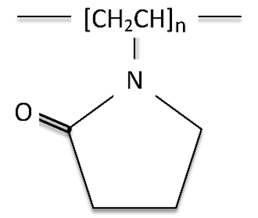

3 Polyvinyl Pyrrolidone (PVP)
Polyvinyl pyrrolidone (PVP) is derived from the polymerization of N-vinyl-2-pyrrolidone [6] (Figure 14). Polyvinyl pyrrolidone is a water-soluble polymer characterized by its unusual physical and colloidal properties and by its physiological inertness [7] [8].
Polyvinyl pyrrolidone has been available in the United States as a white, free-flowing powder manufactured in multiple grades ranging from low to high molecular weight.

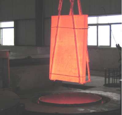

Figure 18: Large AISI 420 stainless steel weighing 500 kg quenched into 18 per-cent PVP with resulting hardness of HRC 54-56.
Quenching Characteristics of PVP
As with other polymer-type quenchants, concentration, bath temperature, and agitation all play a role in establishing the cooling characteristics. By comparison, the quenching rates tend to be faster during the stable film and nucleate and boiling stages but are slower during the convection stage. Because PVP does not have inverse solubility in water, only very small amounts of polymer film are retained on quenched parts at quenching temperatures from 30°C (85°F) to near boiling. Thus, a broader working range of temperatures for quenching can be employed.
The effect of concentration is shown in Figure 15. PVP-based polymers are generally used at concentrations of 10 to 25 percent where the quenching characteristics are very similar to quenching oils.
Figure 19: P20 die steel weighing 7,227 kg (360mm x 1,600 mm x 1,600mm) quenched into 22 percent PVP.
At higher concentrations, the cooling rate at 300°C is substantially reduced. This makes the quenchant extremely suitable for high hardenability forgings or other crack-prone components. The fast maximum cooling rate at lower concentrations makes it effective in hardening low hardenability parts, while minimizing the formation of non-martensitic transformation products (NMTP).

As with other polymer quenchants, the overall heat extraction increases as the agitation is increased. The vapor phase of PVP quenchants are less stable than other quenchants. However, it is still important to maintain good agitation. (Figure 17)

Figure 23: Effect of agitation on the cooling curves of a 20% ACR quenchant. Temperature was 40°C.

The quenching characteristics of ACR solutions are sensitive to agitation as shown in Figure 23. Under static conditions, ACR solutions exhibit a pronounced vapor phase. As the severity of agitation increases, the vapor phase is shortened, and there is a significant increase in maximum cooling rate. As with other polymer quenchants, agitation is important to achieve uniform quenching. Generally, a high degree of agitation is recommended for hardening operations because of the persistent vapor phase.
