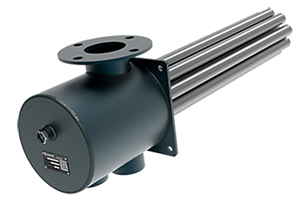

The Algas-SDI Phoenix Tube Heat with the multi tube Recupe Heat exhaust recuperator. (Courtesy: Algas-SDI)
Algas-SDI has introduced the Phoenix RH multi-tube recuperator, designed for reliable performance and maximum fuel savings. The Phoenix Tube Heat (TH) is designed to fire into radiant and immersion tubes with the option to incorporate the multi-tube Recupe Heat (RH) exhaust recuperator for improved efficiency.
The industry proven TH burner nozzle design creates a spiraling flame that scrubs the inside of the fire tubes, resulting in increased heat transfer and enhanced temperature uniformity ensuring the longest tube life.
With the adjustable flame length and multi-fuel capabilities, the TH burner is ideal for any tube firing application, handling ambient or pre-heated combustion air for straight, U, and W-type tube designs.
If a process demands the highest level of system efficiency, the RH recuperator will provide the max preheated combustion air into the TH burner. By recouping energy losses at the exhaust, a system can be tuned to maximize fuel savings of up to 30 percent or greater.
Features and benefits:
Uniform tube temperature: Ensures uniform product heating.
Clean combustion: No soot with low NOx and low CO emissions.
High efficiency: Operates with low excess air and pre-heated combustion air temperatures up to 1,000°F.
Reliable ignition: Consistent performance across a wide range of firing rates.
Multi-fuel capabilities: Can be fired on natural gas or propane without changing internals.
