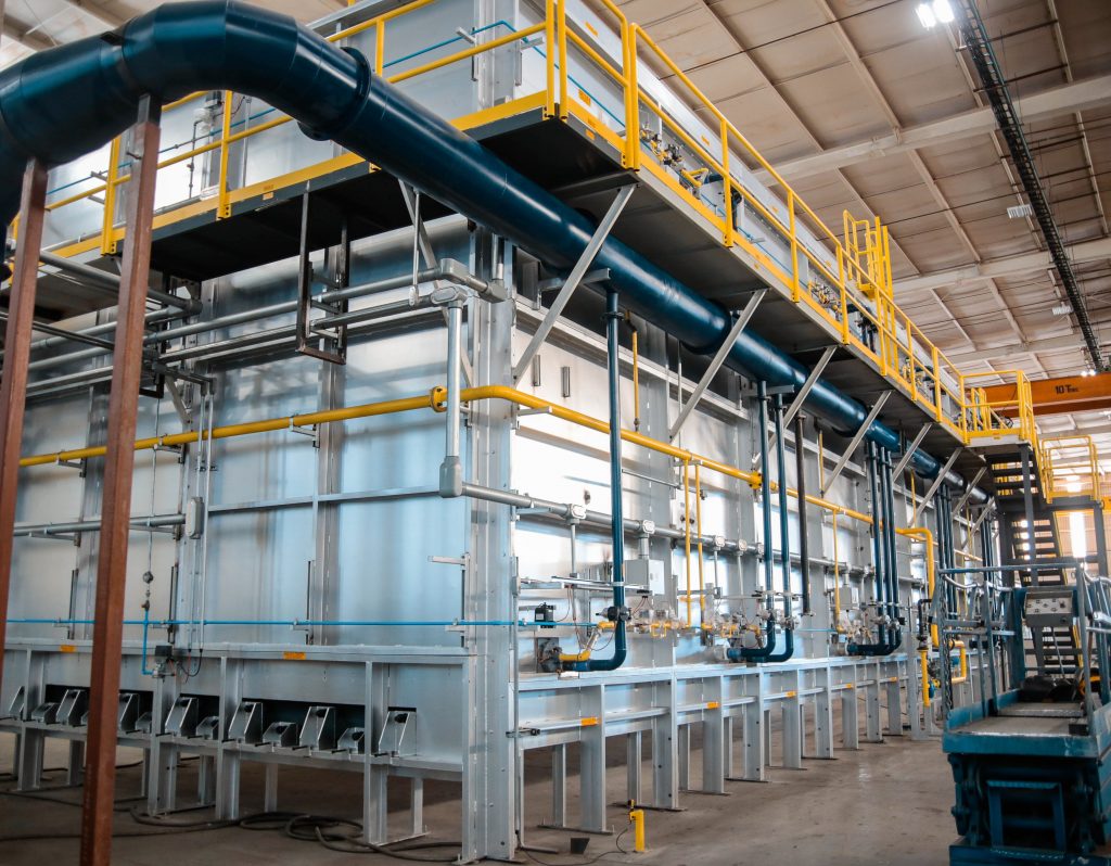

Nutec Bickley has received an order for a gas-fired car bottom furnace. The furnace will have working dimensions of 12 feet wide by 35 feet long by 14 feet, 6 inches high, and be able to accommodate substantial loads — up to 150,000 pounds per cycle. (Courtesy: Nutec Bickley)
