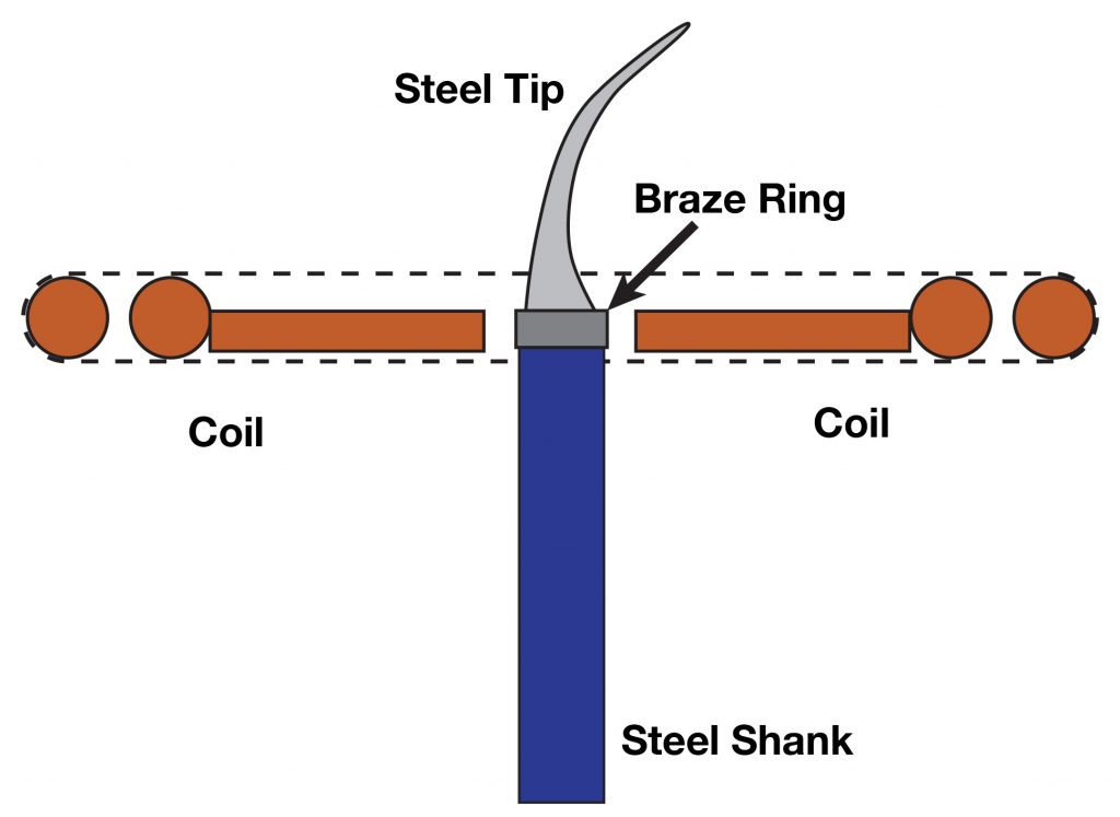

- Brazing: Brazing is a joining process that uses a molten filler metal to join two pieces of metal together. This happens to be a very popular induction application, as it is a very effective way to braze metal. Induction quickly heats the filler metal to its melting point, and a strong and durable brazed joint is regularly achieved. Brazing dental tools is one example of a brazing application in this segment.

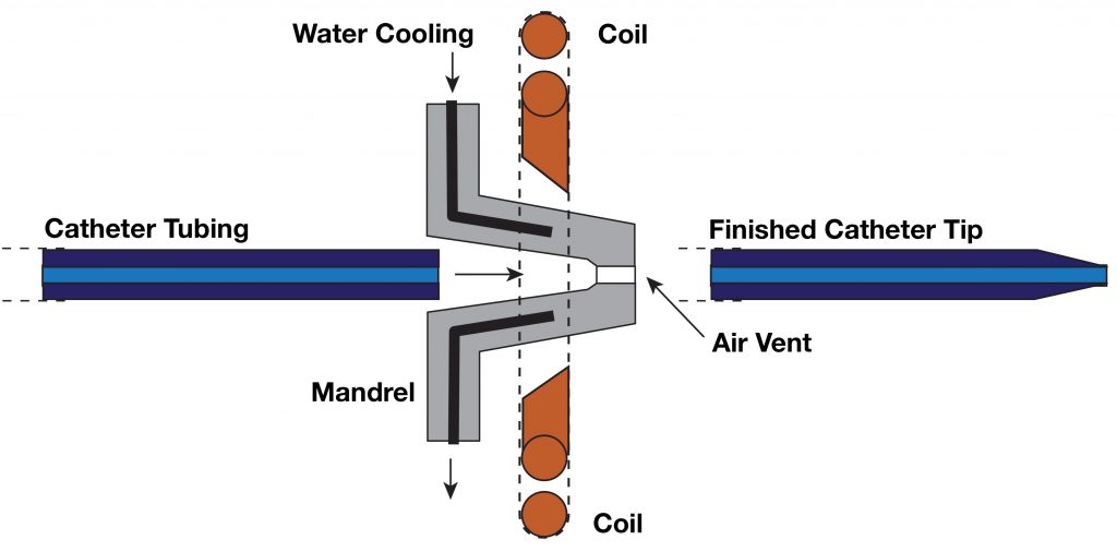

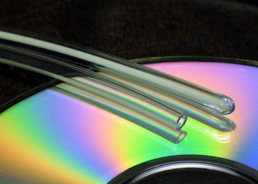

- Catheter tipping: Forming the tips of small catheters is commonly done with induction heating. Induction is conducive to increased production while meeting tight tolerances that are required by this application.

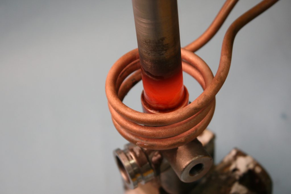

Brazing Stainless Steel
An integrator working for a medical manufacturing company needed to braze stainless steel parts. The target temperature for the brazing application was 1,400°F (760°C) with a target heating time of 20-40 seconds. An Ambrell EASYHEAT 2 kW induction heating system set to 336 kHz was used to heat the joint area to brazing temperature. A custom designed multiple turn helical coil was used for the application. A higher power system would reduce the heating time if required.
