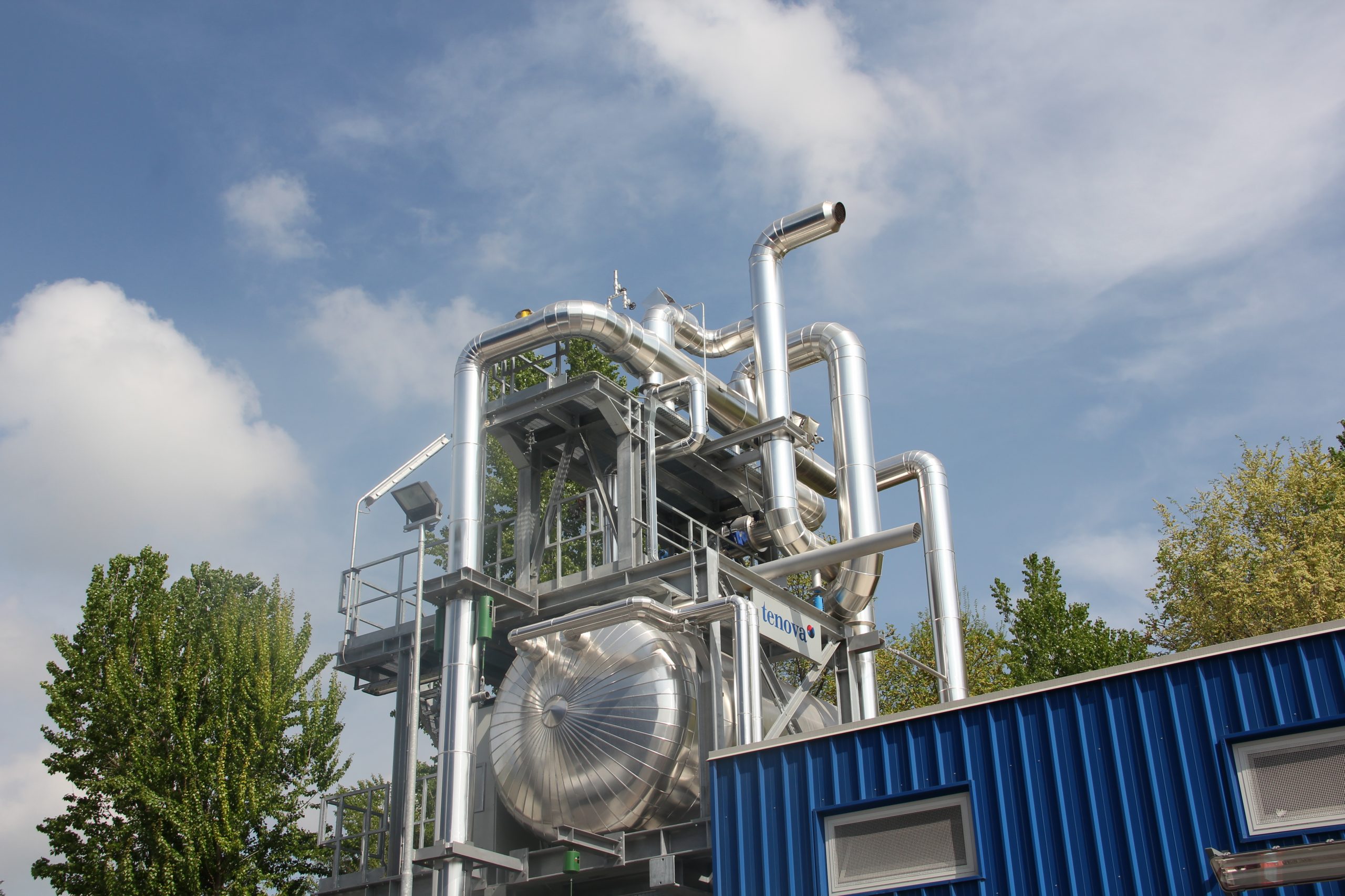

Five of Tenova’s innovative techniques are included on the INCITE platform for clean EU technologies, underscoring Tenova’s role as key enabler of a sustainable and circular EU economy. (Courtesy: Tenova)

iRecovery® is one of the leading technologies for recovering and reusing the thermal energy of off-gases directly within the EAF melting process energy that is typically lost through steam generation. The saturated steam acts as an energy carrier for internal use, electricity generation, and district heating. The integration of the heat leap system, a high- performance heat pump, further enhances energy recovery by using low-temperature heat from the EAF cooling water to supply district heating networks.
