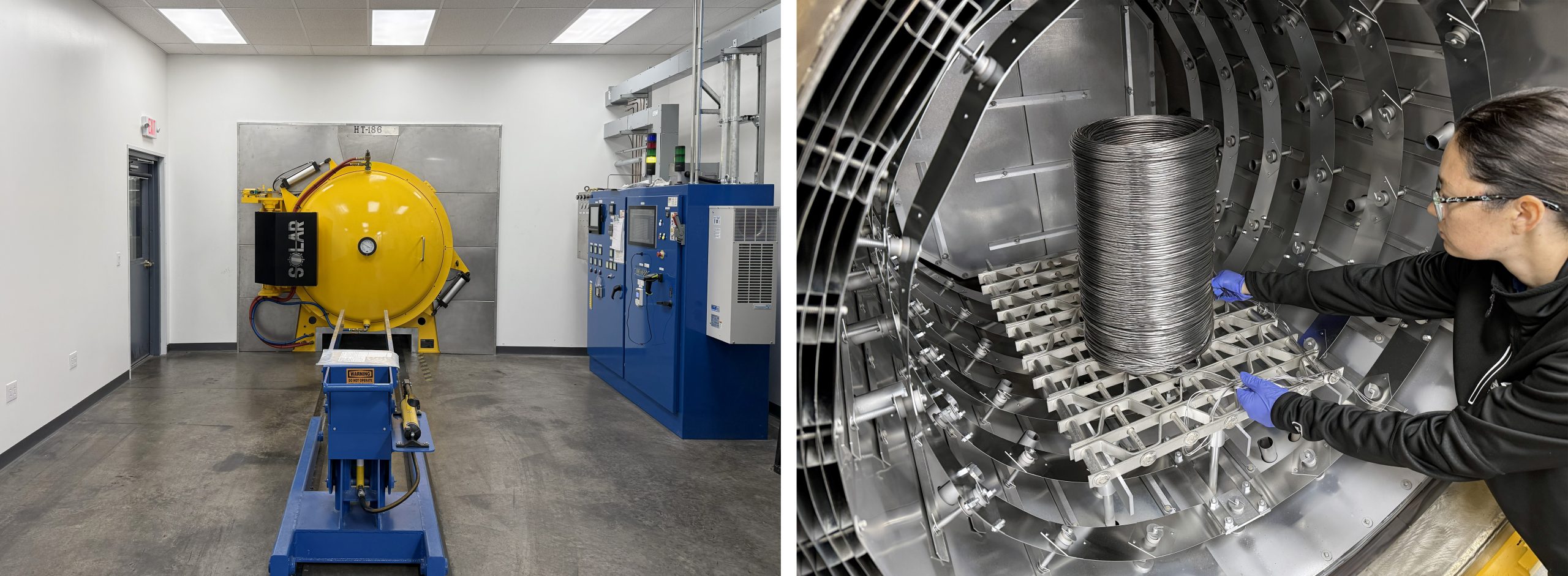

Solar Atmospheres has increased capacity with an additional all-metal hot zone furnace.
This installation marks the second all-metal hot zone vacuum furnace added to the climate-controlled processing area at Solar Atmospheres’ Hermitage, Pennsylvania, facility. The new system significantly expands the company’s capacity to heat treat highly sensitive materials such as precipitation-hardened stainless steels, nickel-chrome-based superalloys, titanium, and niobium.
The addition of an all-metal hot zone furnace at Solar Atmosphere’s climate-controlled facility in Hermitage, Pennsylvania, expands capacity to heat treat highly sensitive materials. (Courtesy: Solar Atmospheres)
Engineered for precision and performance, the furnace incorporates strategically placed isolation valves, an oversized main valve, a high-capacity diffusion pump, and a polished stainless-steel chamber. Together, these features create an ultra-clean processing environment that meets the stringent demands of the aerospace and medical industries. Capable of achieving vacuum levels below 5 x 10⁻⁶ Torr, the system ensures bright, contamination-free results.
“The all-metal vacuum furnace plays a critical role in delivering the purest possible processing environment,” said Michael Johnson, sales director at Solar Atmospheres of Western Pennsylvania.“This level of cleanliness and control results in pristine end products that meet the most demanding industry standards. We’re proud to partner with the engineers at Solar Manufacturing to bring this advanced technology to fruition.”
