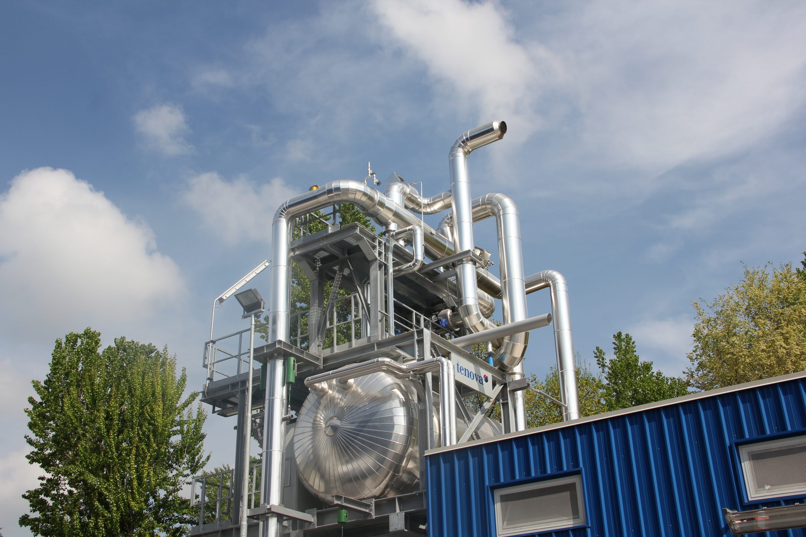

Five of Tenova’s innovative techniques are included on the INCITE platform for clean EU technologies,underscoring Tenova’s role as key enabler of a sustainable and circular EU economy. (Courtesy: Tenova)
