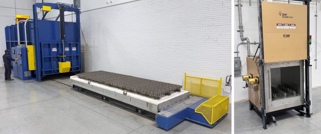

Solar Atmospheres of Michigan Inc.’s addition of new, advanced air tempering and cryogenic equipment to its Chesterfield facility marks a significant step forward in expanding the company’s processing capabilities and enhancing customer support across various industries. (Courtesy: Solar Atmospheres of Michigan)
The new equipment includes a 6’6” wide × 4’ high × 14’ long car-bottom air furnace, designed and manufactured by Heat Treat Equipment Inc. With a robust weight capacity of 30,000 pounds and temperature uniformity within ±10°F from 300°F to 1,400°F, this unit is ideal for processing large, heavy components that require precise temperature control. Also joining the lineup is a DMP “Cryo/Temper Systems” unit, offering a 42” wide × 60” deep × 36” high hot/cold zone. This system achieves temperature uniformity within ±10°F across a critical range of -300°F to 1,200°F, supporting both cryogenic treatment and high-temperature tempering in one integrated solution.
