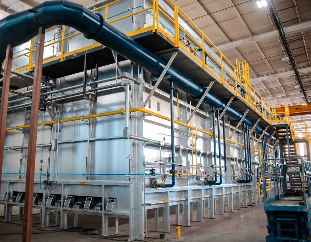

Nutec Bickley has received an order for a gas-fired car bottom furnace. The furnace will have working dimensions of 12 feet wide by 35 feet long by 14 feet, 6 inches high, and be able to accommodate substantial loads — up to 150,000 pounds per cycle. (Courtesy: Nutec Bickley)
The working dimensions of the furnace are 12 feet (3.66m) wide by 35 feet (10.67m) long by 14feet, 6 inches (4.42m) high, and it is able to accommodate substantial loads up to 150,000pounds (68,000kg) per cycle. Normal operational temperatures range between 300°F (150°C) and 1,650°F (900°C), with a maximum of 2,000°F (1,095°C). With burners firing above and below the load, there are 11 automatic control zones (five top, six bottom).
