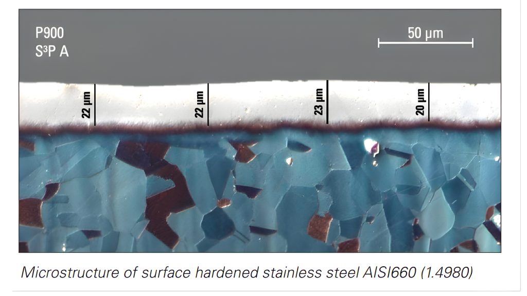

ADM is a low-temperature, diffusion-based surface-hardening process that significantly improves the surface hardness of stainless-steel components. Performed below 500°C, it helps maintain the corrosion resistance that makes stainless steel the material of choice for many demanding applications, while improving surface hardness and tribological performance.
Unlike coatings and plating, ADM does not create a separate layer on the surface of the component. Instead, it forms a hardened diffusion zone within the material itself, meaning there is no risk of cracking, chipping, or delamination in service. The process is also designed to preserve dimensional stability, enabling treatment of finished components without affecting part geometry or tolerances.
