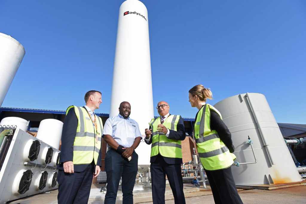

BodyCote MP Baggy Shanker, second from right, tours the Bodycote Derby zero emissions plant. (Courtesy: BodyCote)

Supporting the UK Government’s Industrial Decarbonization Strategy, Bodycote’s transition to zero emissions is achieved through investment in industrial heat electrification, energy-efficiency and renewable energy sourcing. A new closedcircuit adiabatic cooling system was recently introduced at the Derby plant, which is located alongside the Rolls Royce site. Replacing evaporative cooling towers, this innovative installation provides electricity consumption savings (as well as peak electrical load and associated carbon emissions) of 73 percent as well as a reduction in water use of more than 85 percent, while also avoiding the need for chemical dosing and cleaning.
