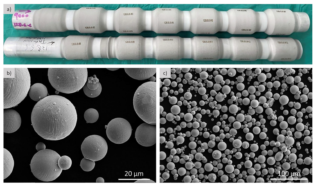

CS additive manufacturing (CSAM) processes are carried out with the TKF-9000 cold spray equipment manufactured by Titomic. CS is performed onto aluminum tubes with a diameter of 50 mm and length of 150 mm as shown in Figure 1. The final part diameter is 80 mm. The manufacturing strategy involves using a zig-zag toolpath, where the cylindrical part rotates while the CS robot traversed back and forth in a zigzag pattern, first from A to B, then from B to A, with A and B representing opposite ends of the part. A total of 80 passes are made to complete the sample. Inconel 718 powder is sourced from Tekna company. The average powder particle diameter is 17.86 µm, with a particle size distribution of D10 = 7.08 µm, D50 = 15.80 µm, and D90 = 36.18 µm. The SEM micrograph of the Inconel 718 powder is shown in Figure 1, illustrating that the particles exhibit high sphericity, with a notable presence of satellite particles measuring less than 3 µm in diameter. CS process parameters include:
- Propelling gas: Nitrogen (N2).
- Gas pressure: 5 MPa.
- Gas temperature: 950°C.
- Nozzle standoff distance: 30 mm.
- Carrier gas flow rate: 200 SLM.
- Stepover spacing: 2 mm.
- Surface speed: 500 mm/sec.

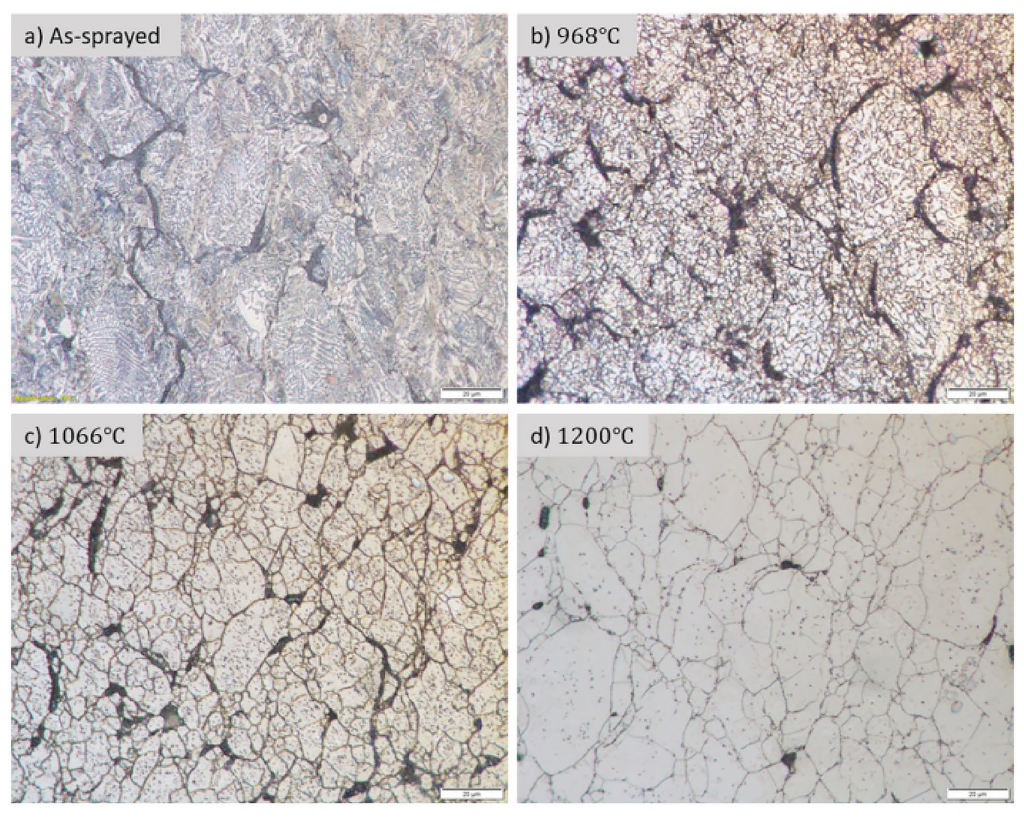

The grain size and porosity measurements are carried out using optical images taken with a Olympus BX53M optical microscope from 20 different locations following ASTM E112-12 and ASTM E2109-01 standards. These measurements are then averaged and reported. For porosity measurement, voids are marked with a different color and porosity and calculated by an image analysis based on the area percentage of voids. Additionally, porosity uniformity in both the transverse and longitudinal directions relative to the cold spray gun scanning direction is checked, and no significant variations are observed, confirming the uniformity of porosity throughout the samples. Cold-sprayed Inconel 718 is further characterized for grain morphology and phase distributions. In order to evaluate and compare these characteristics in detail, a scanning electron microscopy (SEM) is conducted by a Thermo Fisher Scientific Quanta 650 field emission gun scanning electron microscope (FEG-SEM). Grain structure, secondary phases, and porosities are examined by SEM after etching with oxalic acid for 15 seconds.

The microstructures of samples in as-sprayed condition and after HT at temperatures of 968°C, 1,066°C, and 1,200°C following CSAM are shown in Figure 2. In as-sprayed condition, samples exhibit a dendrite structure, a distinctive structure of crystals as metals solidifies, as shown in Figure 2. The dendrite structure is typically formed during the manufacturing of powder (e.g. [31,34]) and preserved after CS. The particle boundaries that form during the CS process are visible, indicating particles are not fully bonded and the parts show brittle behavior in this condition as demonstrated extensively in the literature. Additionally, voids typically remain in the triple junctions where multiple particles contact one another. The porosity is measured to be 2.49% in as-sprayed condition in agreement with the published data [11,30,33] for cold-sprayed Inconel 718. Significant reduction in porosity and further bonding of the material is achieved with the HT process. During the HT process, solid-state diffusion occurs between the particles, similar to the sintering mechanism. This diffusion facilitates the transformation of the dendritic structure into newly recrystallized grains, which effectively reduces the porosity. The porosity is reduced up to 1.59% as shown in Table 1 with HT at 1,200°C. Recrystallization occurs after HT at all three temperatures, with new grain sizes observed to be at 1-2µm after 968°C, 5-10µm after 1,066°C and 15-20µm after 1,200°C.

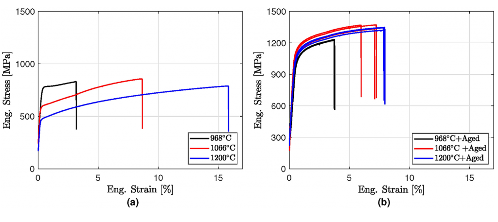

The results of tensile testing for the heat-treated samples are illustrated in Figure 3. It is clear from the data that the ductility of the samples increased proportionally with the rise in heat-treatment temperature peaking at about 16%, accompanied by a decrease in yield stress. However, despite these variations, the ultimate strength of the components remains relatively consistent, typically hovering around 800 MPa. In Figure 3, test results after aging treatment is demonstrated. Experiments are repeated three times for each HT. All specimens reached a similar level of yield stress and hardening capacity, with those heat-treated at 968°C being the least strong and ductile. The level of porosity before the aging treatment has a direct impact on ductility, with specimens heat-treated at 1,200°C achieving the highest ductility, exhibiting 8% elongation at fracture.

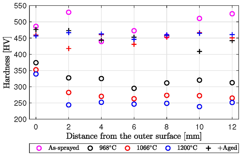

Hardness measurement results are depicted in Figure 4 through the thickness of the CS deposit. Values are found to be between 450-550 HV for CS sample in as-sprayed condition. After HT, hardness reduced below 350 HV except at the outer surface. As the HT temperature increased, the hardness values are further decreased with more homogeneous distribution through the thickness, indicating an inhomogeneous microstructure of the material in as-sprayed state. After the aging treatment, hardness of the samples reached about 450 HV for all three HT temperatures.

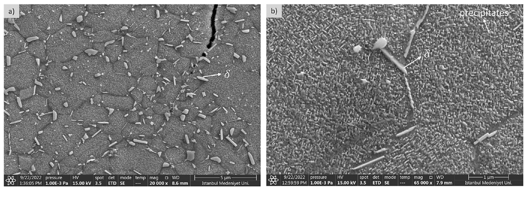

A further analysis of microstructure, phases, and their distribution are conducted by SEM for the heat treated at 1,200°C and aged sample. Figure 5 shows micrographs at 20K and 60K magnifications. Gamma prime (γ′) precipitates are formed in the grain interiors and delta phases are formed at the grain boundaries after the aging process. Similar precipitate morphology can be observed with Inconel 718 alloy produced by conventional methods. Furthermore, gamma double prime (γ²) precipitates with plate-like structures and 60-70 nm in size are formed. A not fully bonded interface can be observed in the SEM image as well.

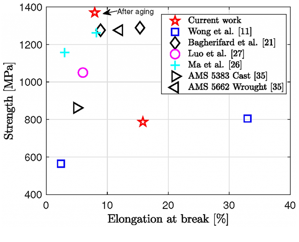

Figure 6 compares the strength and ductility outcomes of cold-sprayed Inconel 718 samples from current research with results available in the literature. The data from this work focuses on the sample heat-treated at 1,200°C, both before and after the aging procedure. Notably, this sample shows the highest strength among all compared examples, with a significant amount of elongation prior to fracture. Furthermore, to the best of the authors’ knowledge, this study is the first to report tensile testing results for conventionally aged cold-sprayed Inconel 718. Two literature examples [26,27] represent furnace-cooled samples, which exhibit a microstructural change and small σ precipitates to form resembling a short aging process27. It is important to note the process parameters and heat treatment (HT) conditions vary noticeably among the samples in Figure 6. An outlier in ductility is observed for a sample heat-treated at 1250°C for 1 hour [11], highlighting the potential for optimizing HT conditions to significantly enhance the mechanical properties of cold-sprayed Inconel 718 parts. This agrees with the current findings and emphasizes the opportunity for further improvement in both ductility and strength through precise fine-tuning of HT parameters.
