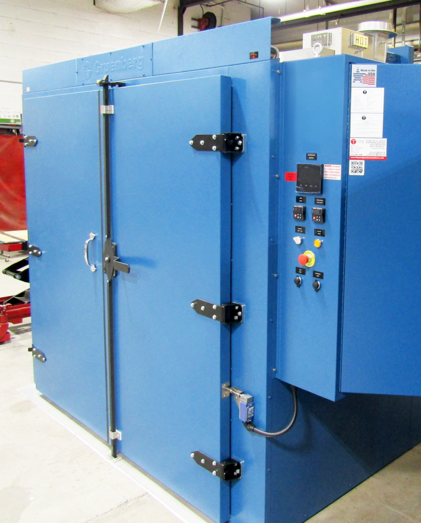

Gruenberg®, a leading industrial oven and sterilizer manufacturer, announced the shipment of two truck-in ovens to the automotive industry. The ovens will dry water off billets and are designed for efficiency and performance.
The drying ovens feature maximum temperature ratings of 450°F, interior dimensions of 68” W x 48” D x 72” H, and the sufficient capability to dry 2,000 pounds of product per load. The interior chambers are constructed with non-continuous interconnecting struts between the inner and outer walls to minimize heat transfer and keep the exteriors as cool as possible.
The ovens also include 3/16” thick plate floors with beveled front edges to ensure smooth transitions for loading trucks or pallet jacks.
Ipsen’s Service HUBs offer personalized, reliable support by assigning familiar technicians who develop in-depth familiarity with each customer’s equipment and processes. (Courtesy: Ipsen)
The truck-in ovens use high-volume compound horizontal airflow systems to ensure uniform heating. This creates a consistent horizontal airflow across the product, with air recirculating back to the fan for reheating. Temperature control of the ovens is managed by a Watlow F4T controller which offers a user-friendly, programmable touch screen with Ethernet communication and data-logging capabilities, ideal for demanding ramp-and-soak processing needs.
Both ovens are equipped with multiple safety features to ensure secure operation. Watlow high-limit controllers are installed to de-energize the heating systems if the process temperature exceeds the preset limit. Airflow switches are installed within the circulation and exhaust systems to deactivate the heater circuits in the event of airflow system failure, preventing potential hazards and maintaining safe operation conditions. Additionally, safety door switches on each oven deactivate the heating and circulation systems when the doors are opened, preventing the release of hot air during operation.
“These Gruenberg truck-in ovens are engineered for efficiency and performance,” said Jason Cillo, Gruenberg sales director. “Our innovative construction minimizes heat transfer with features like non-continuous struts and high-performance insulation, while the compound horizontal airflow system is designed to effectively dry large loads. This design maximizes production rates, energy efficiency, and reliable performance for demanding applications.”
Unique features of these Gruenberg truck-in ovens include:
  • Plate floor with beveled edge for ease of loading.
  • Watlow F4T controller with datalogging and Ethernet communications.
  • High limit controller to safeguard against overheating.
  • Safety door switch to prevent process interruption.
