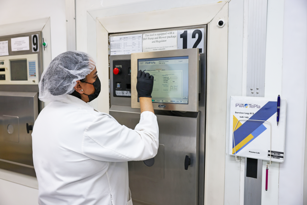

Toll Processing: Plasma Treatments
In manufacturing, plasma treatments are often used to solve problems that cannot be resolved by other methods. Whether attempting to improve adhesion of dissimilar materials, depositing coatings, cleaning surfaces, applying a protective coating that repels water for example or biological fluids, or enhancing surface wettability or functional coating, plasma treatments often add significant value to products.
Nafis said one of the most common applications for toll processing includes plasma treatments to improve the bonding of chemical adhesives, coatings, and inks to parts.
Adhesion promotion can be achieved by increasing the surface free energy through several mechanisms, including precision cleaning, chemically or physically modifying the surface, increasing surface area by roughening and primer coatings. Materials that can benefit from this process include metal to plastic, silicon to glass, polymer-to-polymer interfaces, biological content to microtiter plates, and even non-stick materials such as PTFE.
The net effect is a tremendous improvement in bonding. In some cases, up to 50 times bond strength improvement can be achieved.
Due to the wide range of materials, chemistries, and application-specific requirements, a significant portion of PVA TePla’s toll processing work involves developing customized processes for each customer.
“Even when multiple customers request a hydrophilic surface (one that attracts water, allowing it to spread rather than bead up), the underlying process cannot be assumed to be identical,” Nafis said. “A hydrophilic coating that works well on PEEK may not perform the same on PTFE or a polymer due to the distinct surface chemistry of each material. Each material responds differently to plasma, and variations in substrate material, surface energy, and other factors require a customized process to achieve consistent, reliable results.”
When needed, equipment can be tailored to meet specific customer requirements, making custom modifications to tools, hardware, or system configurations to support specialized applications and performance objectives.
Once the process is fully developed, all parameters are standardized and tightly controlled. The recipe is locked, and a formal standard operating procedure (SOP) is established to ensure repeatability and consistency.
“While (plasma treatment) tools may come with a standard recipe, we treat that as a starting point,” Nafis said. “Our team brings significant expertise in customizing processes to meet the unique needs of each application.”

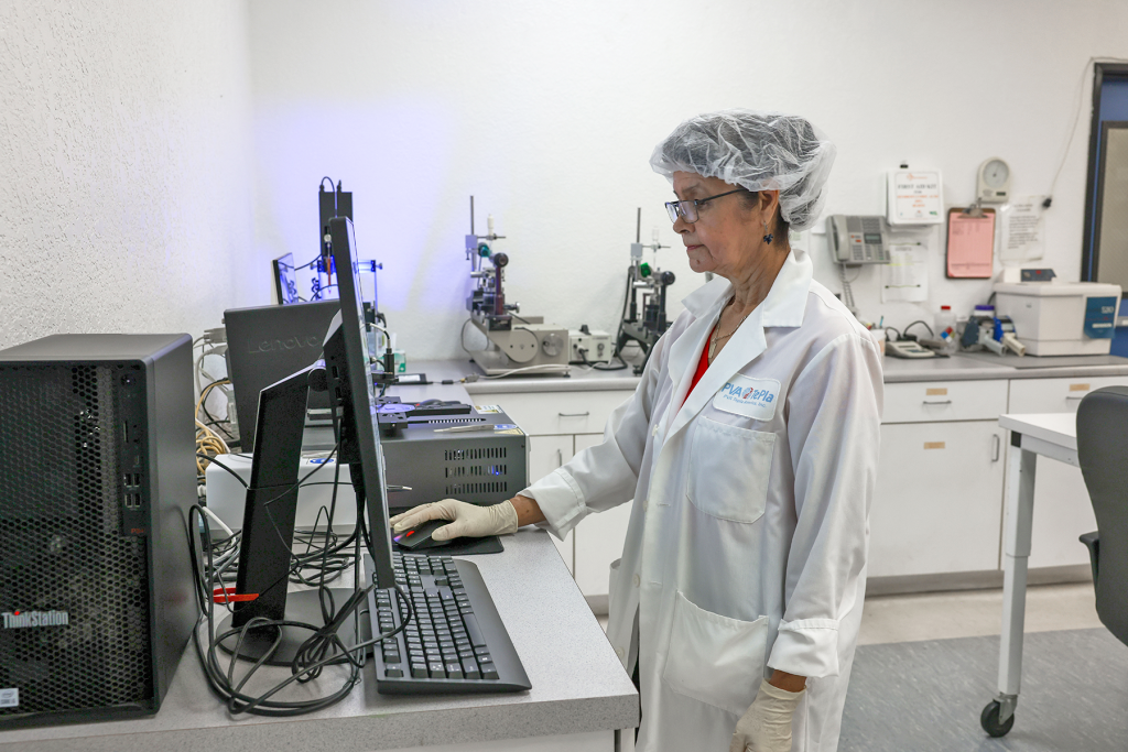

Whether for plasma treatments or diffusion bonding, PVA TePla supports a wide range of customer engagement models. According to Nafis, some clients send large batches of parts once or twice a year, while others may submit only a few parts on an occasional basis. In contrast, regular customers operate on a consistent monthly schedule, often reserving tool time in advance and providing a three-month rolling forecast. This approach ensures sufficient capacity and alignment with their ongoing production requirements.
Turnaround times depend on part volume and processing requirements. With nine dedicated plasma system lines, PVA TePla can run up to three distinct jobs in parallel, significantly improving throughput and minimizing lead times. For projects with tight deadlines, expedited services are available at an additional cost.
At PVA TePla, process development schedules depend on the complexity of the application. Straightforward, well-defined requirements can often be addressed within days. More complex projects that involve testing protocols, validation steps, or equipment customization can take several weeks or even months to finalize.
