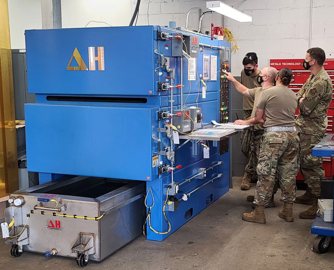

Delta H® Technologies heat-treat system deliveries are scheduled over the next year to provide the USAF with cutting-edge heat-treating capabilities for aviation-grade metals. (Courtesy: Delta H® Technologies)
The order includes 13 Model DCAHT®-181248-1200/500-MIL units and 25 Defender Series Model DEF-DC-RH-242436/1200-CH-242436/1200 units. Deliveries are scheduled over the next year to provide the USAF with cutting-edge heat-treating capabilities for aviation-grade metals ensuring compliance with AMS2750H and NAVAIR TO 1-1A-9 standards.

DCAHT model features:
  • Dual convection-heated chambers with certified TUS work volume 18” W × 12” H × 48” L (Class 1 uniformity).
  • Lower chamber operates to 1,200°F for aluminum solution heat treating with roll-away quench tank.
  • Upper chamber operates to 500°F for aluminum aging.
Defender Series model features:
  • Dual TUS-certified work volumes 24” W × 24” H × 36” L.
  • Convection chamber operates 200°F–1,200°F (Class 1 uniformity) with rapid cooling from 1,000°F to <200°F in under 30 minutes, enabling complete solution heat treating, annealing, and aging (T6).
  • Radiant chamber operates 1,000°F–2,000°F (Class 3 uniformity) with inert gas atmosphere capability.
