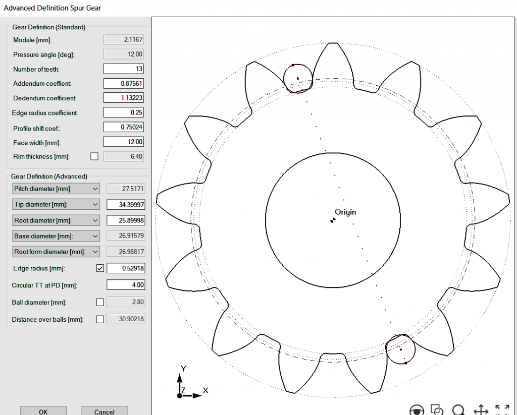

Figure 1: Pre-heat-treatment gear geometry developed in IGD.

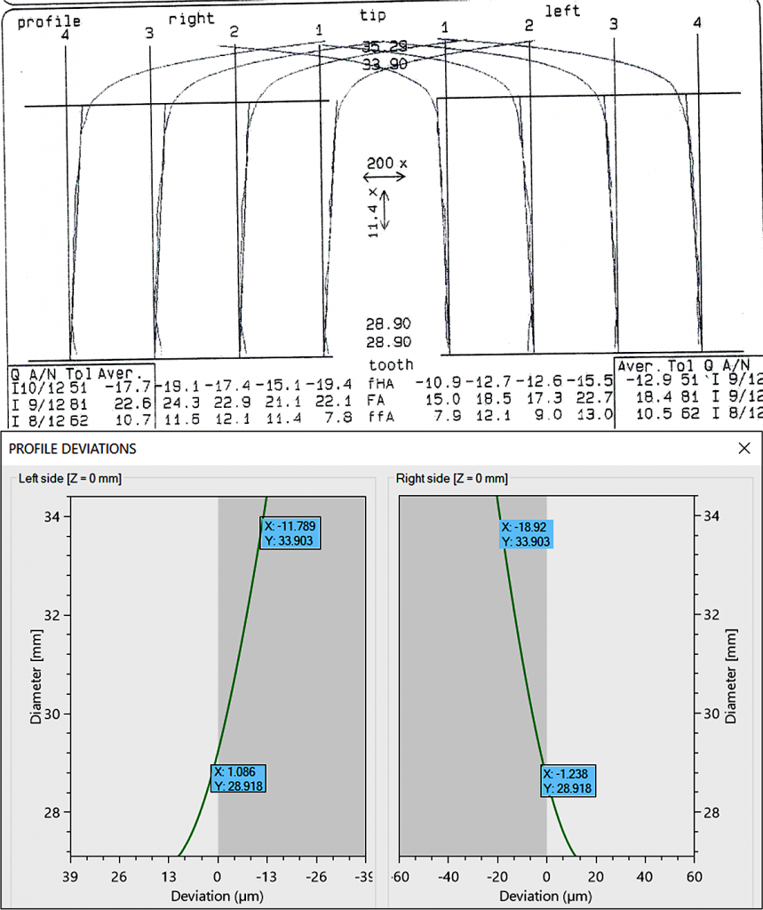

Figure 2: Measured slope profile deviations and deviations defined with IGD.

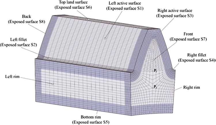

Figure 3: Developed mesh for the finite element model.

The heat-treatment process steps include gas carburizing, austenitizing, transferring to quench tank, oil quenching, and tempering. Using IGD, the pre-heat-treatment geometry is built from standard parameters such as number of teeth, diametral pitch, and base, form, and root base diameters, shown in Figure 1.

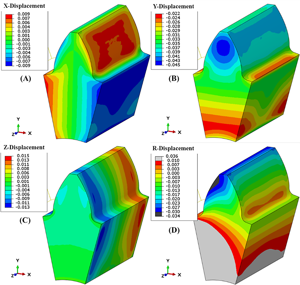

Figure 4: Distortion results for the heat-treatment model in the X direction (a), Y direction (b), Z direction (c), and cylindrical coordinates for the flank radius (d).
Variations in the tooth surface that influence gear noise and transmission error were also measured on four teeth and input into the pre-heat-treatment model. Figure 2 shows the measured profile deviations (fHA) with the IGD profile definitions defined; the right flank averaged 17.7 µm and the left 12.9 µm, with about a 5 µm range on each side.
IGD enables users to define these deviations directly over the gear profile, which is challenging to perform directly in most CAD platforms. Incorporating these small geometric variations before simulation ensures that the virtual twin accurately reflects real manufacturing conditions. With the gear parameters and slope definitions defined, the FEA mesh is developed for the heat-treatment model. Figure 3 illustrates IGD’s mesh setup interface, where the user defines elements across the face width and tooth profile. The generated mesh and exposed surfaces are exported into an ABAQUS input format, forming the finite element model used by DANTE for thermal–mechanical simulation. The mesh in the heat-treatment model was developed with finer elements near the part surface to capture the steep thermal, chemical, and phase transformation gradients present in the heat-treatment process. The developed geometry is brought into ABAQUS and the material properties and boundary conditions, thermal and chemical, are applied for the DANTE heat-treatment model.

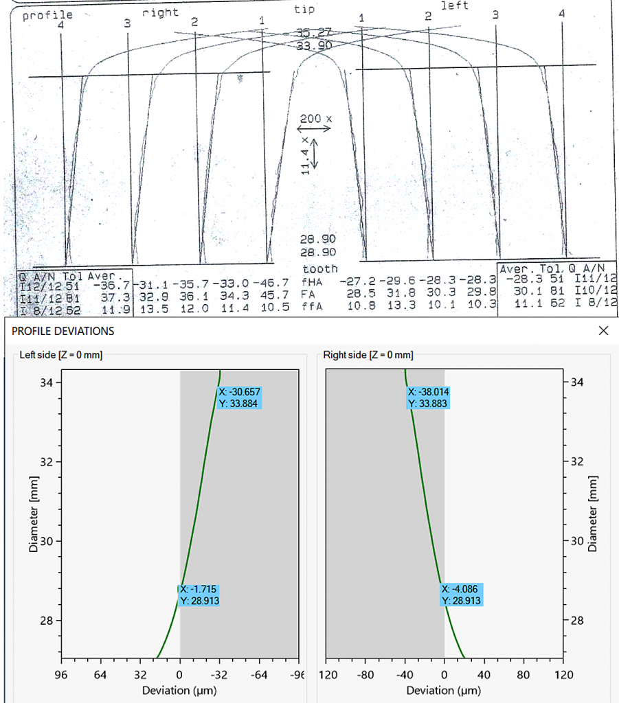

Figure 5: Measured slope profile deviations and predicted deviations measured with IGD, after heat treatment.

The DANTE model predicts several common heat-treatment results including hardness, carbon profile, phase composition, residual stress, and distortion. While hardness and stress predictions align naturally with laboratory data, distortion has been harder to validate in the same manner as a CMM would measure. The method of integrating IGD and DANTE allows the 3D displacement results to be directly compared to the measurable inspection data. Figure 4 shows DANTE’s displacement predictions along the X (a), Y (b), and Z (c) axes, while Figure 4 (d) transforms these into radial coordinates. The nodes on the flank surface can be directly plotted for comparison of the flank deviations, but this would need to be automated on a case-by-case basis, which is time/cost prohibitive.
Using IGD’s built-in profile deviation tool, the post-heat-treatment model is read in, and the slope profile deviations are compared to the physical measurements, Figure 5. The simulation results agree well with the measured data:
Measured (after hardening):
  • Right flank: 36.7 µm average (range ≈ 15 µm)
  • Left flank: 28.3 µm average (range ≈ 3 µm)
  • Predicted (simulation):
  • Right flank: 33.9 µm
  • Left flank: 28.9 µm
The virtual inspection successfully captured the direction and magnitude of distortion within experimental scatter, demonstrating the potential for quantitative process verification entirely within the virtual domain.
