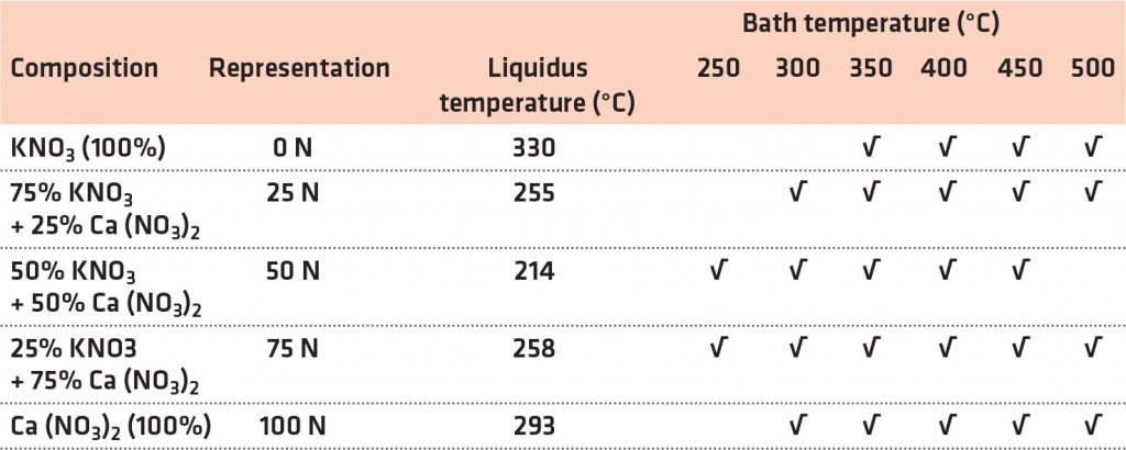

The influence of the bath temperature and composition on the cooling performance of Ca (NO3)2-KNO3 is investigated using AISI 4140 and Inconel quench probes.
Molten salts are highly effective as a quenching medium for austempering and martempering processes, enabling precise control of cooling rates to achieve the desired microstructures and mechanical characteristics in steel components. One such promising molten salt is a multicomponent Ca (NO3)2-KNO3 molten salt. The current work explores the cooling severity of molten Ca (NO3)2-KNO3 mixtures, which are commonly used for such purposes. The said mixture, with varying concentrations and bath temperatures, was used for quenching the Inconel probe with thermocouples. The temperature data extracted was used to determine the transient heat flux developed at the metal-quenchant interface. A set of critical points were assessed against the peak heat extraction rates. Additionally, the fluctuation of mean heat flux and surface temperature in relation to these crucial points were plotted, along with changes in composition and bath temperature of the quench media. The cooling intensity of these quench solutions, as measured by Inconel probes, correlated well with the average hardness values observed in steel probes. The level of homogeneity in heat transmission, as measured by the spatial variance of the normalized heat energy, decreased as the percentage of KNO3 in the quench medium increased.
Table 1: Composition of a molten Ca(NO3)2–KNO3 mixture for quenching experiments.

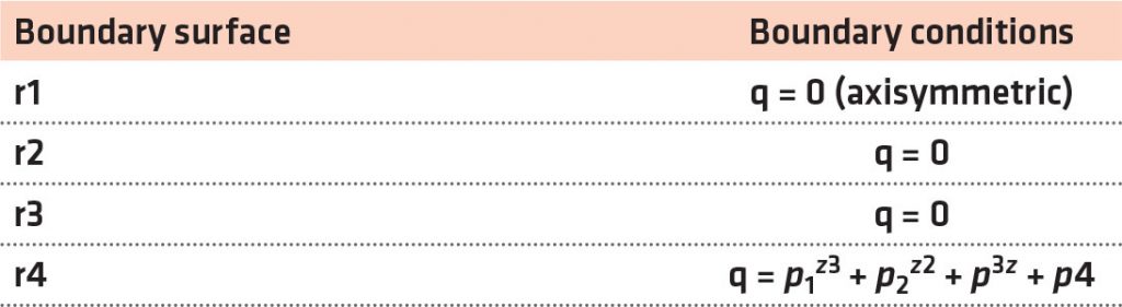

Table 2: Boundary conditions for probe heat transfer.

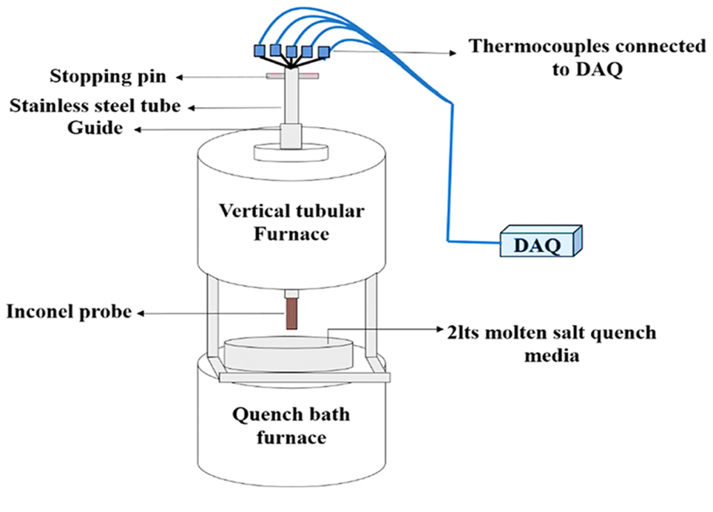

2 Experimental Section

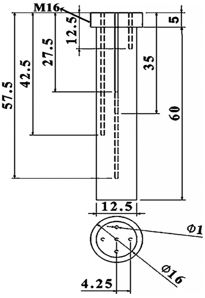

The effectiveness of the quenching medium’s cooling was assessed by adopting an Inconel probe crafted to the dimensions of 12.5 mm in diameter and 60 mm in height, respectively, with inbuilt thermocouples attached, as seen in Figure 1. The probe was perforated with five 1 mm diameter holes through electrolytic discharge machining (EDM). A single hole was created at the midpoint of the probe up to a depth of 35 mm, followed by the remaining four holes drilled radially to 5 mm, up to depths of 10, 25, 40, and 55 mm, respectively. All of these depths are threaded to 5 mm exclusively from the top of the probe.
Figure 1: Inconel probe was used for experimentation
Precalibrated thermocouples of K-type were obtained from Phoenix Temperature & ElectroMech Manufacturing Co. WLL. Thermocouples, each of them having a measure of 1 m length, were placed into the EDM drilled holes using an 800 mm steel tube, reaching into the Inconel probe. The connection between the thermocouples and the tip of the hot junction was confirmed by manually applying pressure to fasten the thermocouple onto the surface of the measuring hole. It is assured that the press fit tolerance is upheld for the thermocouple and the EDM drilled holes so that the necessary connection between the metal surface and the junction of the thermocouple is not lost during experimentation. Figure 2 gives the complete representation of the experimental setup implemented for the quenching experiment. The Inconel probe, along with the thermocouples, are fastened to the stainless-steel tube. This tube is then moved to a vertical tubular furnace. A NI-9213 data logger was connected to the thermocouples using compensation cables. This data logger was connected to a computer, which recorded the time-temperature data. This data was recorded at the rate of 10 readings per second.
The molten Ca (NO3)2-KNO3 mixture of distinct compositions formed the 2 L quench bath. Various combinations of Ca (NO3)2-KNO3 having a variety of compositions with corresponding bath temperatures, as listed in Table 1, were used for quenching experiments. The quench bath furnace was maintained at a specific bath temperature to melt the quench media. Next, the melting furnace was positioned directly beneath the vertical tubular furnace used for heating the Inconel probe, which reached a temperature of 860°C. Subsequently, the stainless-steel probe setup was immersed in the quench bath containing the molten mixture of Ca (NO3)2-KNO3. The guide was arranged to vertically lower the steel tube during the quenching process.
Identical quenching experiments have been conducted using steel probes made up of AISI 4140 having dimensions of 12.5 mm diameter and 60 mm length with a 5 mm M16 thread at the top. For about 20 minutes, the probe was maintained at an austenite temperature of 860°C before quenching it with the molten mixture which is maintained at 300 and 350°C. Thermocouples were placed within the probe to monitor the temperatures at specific points: one at the probe’s geometric center and another 2 mm away from a depth of 30 mm. The probe was sustained in the molten bath until its geometric center reached a temperature of 20°C above that of the quench bath. Following this, the probe was cooled via exposure to air. At a depth of 30 mm, the probe was divided into sections. One of these sections underwent metallographic polishing, followed by hardness measurement using a micro-Vickers hardness testing machine (HMV-G 20ST). A load of 0.5 kg and 15 seconds dwell time were employed during the hardness measurement process.
Figure 2: Quenching experiments.

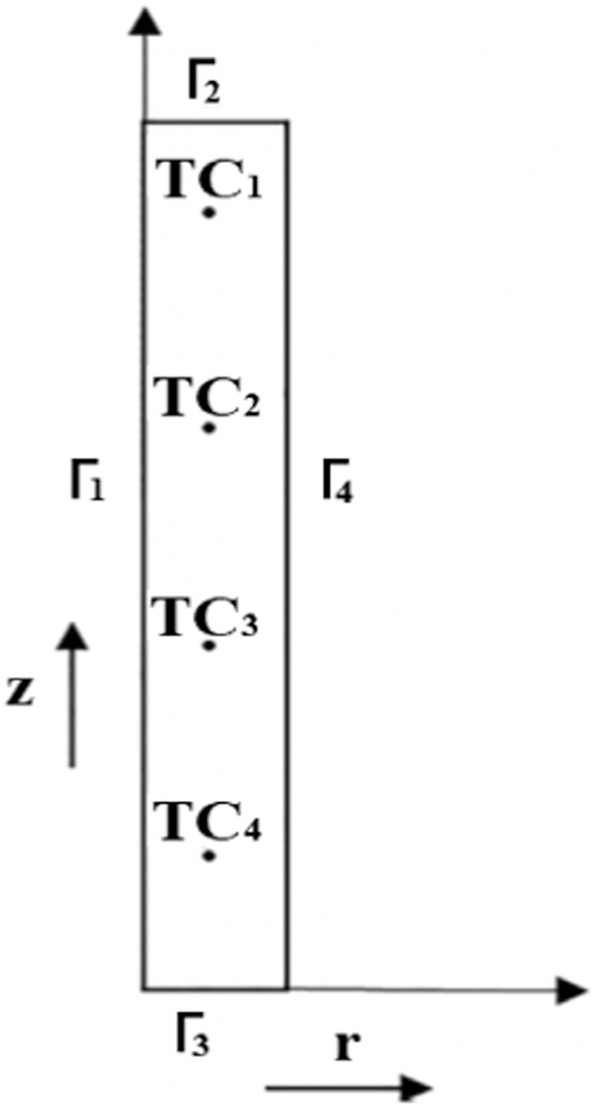

3 Heat Flux Evaluation
The interfacial heat flux for the metal quenchant was determined by using temperature data from the Inconel probes. Locations in close proximity to the probe’s surface compiled the cooling curve information, which was used in determining spatially dependent transient heat flux through the inverse heat conduction method during the quenching process. However, the location where the cooling curve data was collected was not used for inverse calculations. These thermocouple measurements served as a validation for the estimated heat flux.
Equation 1
The Fourier axisymmetric heat conduction equation governs quenching heat transfer in the Inconel probe given by Equation 1, where k is the thermal conductivity and depends on the temperature T and ρ and Cp are the density and specific heat of the material, respectively. Figure 3 provides the cylindrical coordinates for the probe of the heat-transfer model. As per Table 2, r1, r2, r3, and r4 are considered as the boundary conditions at the surfaces. Prior to quenching, the probe was heat treated to 860°C; therefore, at time t = 0, r(r, z) = 860°C. This was considered the foremost requirement for resolving the inverse heat conduction model. With the implementation of these boundary conditions, the finite element method was used to solve the Fourier heat conduction equation. The axisymmetric probe model of the rectangular cross-section was discretized into almost 6,000 rectangular elements having a mesh size of 0.25 × 0.25 mm2. The heat transfer at the interface between the metal and the quenchant was calculated by using the thermal properties of Inconel, and these properties have been used to determine the effectiveness of cooling achieved by aqueous polymer and brine solutions used for quenching. [11] As per Table 2, the bottom and top surfaces of the probe are insulated, and r4 is the only boundary surface through which quenching heat transfer is expected to occur. The interface heat flux r4 is defined as a cubic function of distance z. The parameters p1, p2, p3, and p4 for the time step (ts) form the main calculation for the inverse problem (Equation 2). As per Ozisik and Orlande, [19] the conjugate gradient method was implemented to determine the parameters. The parameters were represented as Pts. [12] z varies between 0 and 70 mm.
Equation 2
Equation 3
The thermocouple positions (r, z) TC1, TC2, TC3, and TC4 are (4.25, 7.5), (4.25, 22.5), (4.25, 37.5), and (4.25, 52.5), respectively. The temperatures measured at TC1, TC2, TC3, and TC4 are denoted as Y1, Y2, Y3, and Y4 respectively. The parameter values p1,ts, p2,ts, p3,ts, and p4,ts are determined to solve the inverse problem for which objective Sts was minimized (Equation 4).
Equation 4
Here, Yi, ts+j–1 is the thermocouple location where the temperature is measured and ts + j – 1 is the time step. The term T(Pts) was determined considering four upcoming time intervals during which the heat flux remained consistent. The conjugate gradient method-based inverse algorithm developed by Pranesh Rao and Prabhu [10] was used to determine the spatially dependent transient heat flux at the metal-quenchant interface. The current work used the same method.
4 Results and Discussion
The quenched Inconel probe maintained at different temperatures within the quench media determined the cooling curves that were later used for computing the heat flux at the interface between the metal and the quenchant. The cubic equation parameters at every time step were measured using the temperatures that were determined at four different thermocouple locations, i.e., TC1, TC2, TC3, and TC4, respectively. All of these factors were employed to represent the metal-quenchant interfacial heat flux (see Equation 3).
Figure 3: Inconel probe model to determine the metal–quenchant interfacial heat flux.

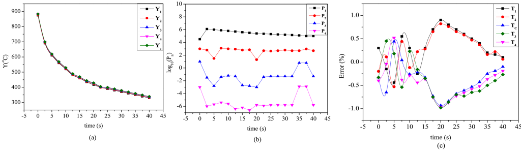

Figure 4a and 4b show the variation of temperature and transient parameters for Ca(NO3)2 medium, maintained at a temperature of 400°C. During the quenching trials, similar graphs for the quench media, as reported in Table 1, were produced. Figure 4c depicts a transient fluctuation in % inaccuracy at all thermocouple sites in the probe quenched in 100 N quench medium at a bath temperature of 400°C. The temperature at the TCc was used to verify the estimated metal-quenchant interfacial heat flow. The most significant variation between the recorded and the projected temperature at TC1, TC2, TC3, and TC4 locations was 5.5% (24°C), while quenching in 50 N salt mixture sustained at 250°C. The highest inaccuracy at the probe’s geometric center was 3.2% (24°C). The temperature discrepancy between the actual and computed values was found to be 5.5%.

Figure 4: Variation of (a) temperature, (b) transient heat flux, and (c) transient variation of % error at thermocouple positions for the molten Ca (NO3)2 quenching medium at 400°C.

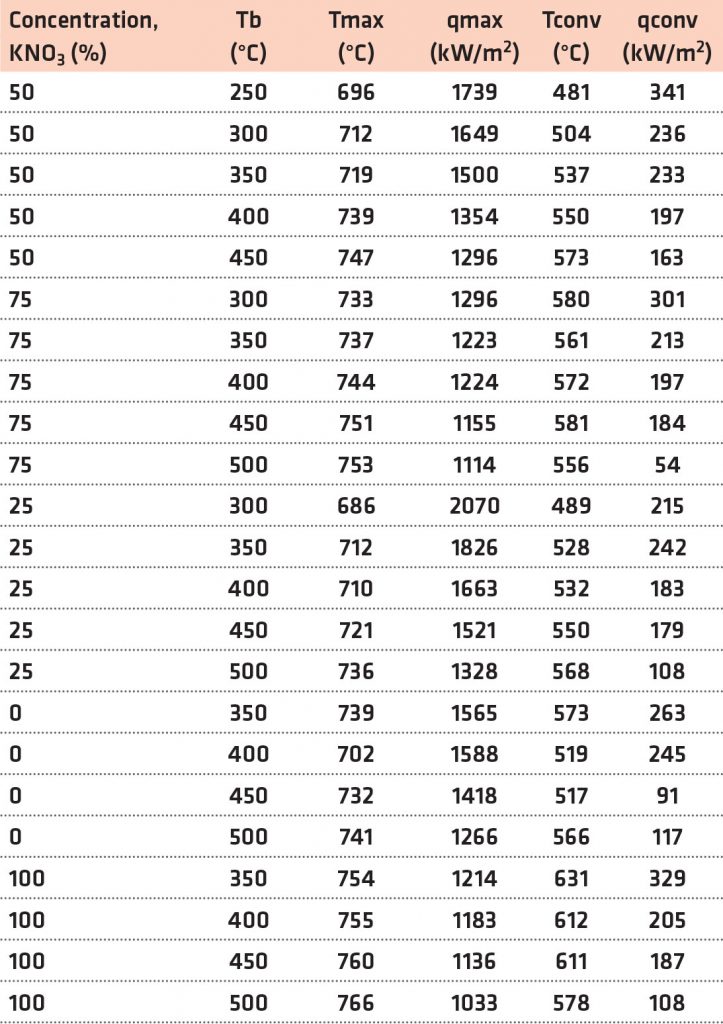

4.2 Evaluation of Critical Points in Thermocouple for Varying Composition and Bath Temperature

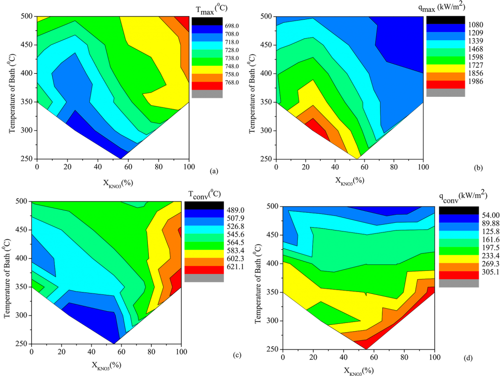

The maximum rate of heat removal throughout the nucleate boiling phase and the shift from nucleate to convective cooling were selected as the crucial stages to evaluate the quench media’s ability to cool down. [9] The terminologies qmax, Tmax, qconv, and Tconv have been used to describe the quench performance of molten Ca (NO3)2-KNO3 mixtures. Results from quenching experiments were used to construct Figure 6a-d. The data for all contour plots in Figure 6 are included in Table 3.
Equation 6
The highest average heat transfer decreased with the increase in the KNO3 content and temperature of the quenching medium. Tmax rose as the KNO3 content and bath temperature in the quenching medium increased. For bath temperatures of >400°C, qconv remained practically identical across all compositions. qconv improved with the KNO3 content in the molten salt medium at bath temperatures under 350°C. With the increase in both the concentration of KNO3 and the temperature of the quenching medium, there was a corresponding rise in Tconv. By altering the composition of the molten Ca (NO3)2-KNO3 mixtures, it is possible to attain maximum cooling efficiency.
Equation 7
Upon quenching, greater qmax and qconv values and lower Tconv values contribute to enhanced hardness in the quenched steel portion. A greater qmax value suggests a faster cooling rate, preventing the pearlitic tip of steel on the TTT diagram. In the TTT diagram, Tmax is expected to be near but lower than the pearlite tip of the steel. Reduced Tconv and higher qconv values prevent bainitic transition following quenching of the steel components. Greater peak heat flux provides faster heat transfer rates until the convective cooling period begins. Increasing heat transfer rates across Tmax and Tconv temperatures inhibits austenite transition to bainite and pearlite.

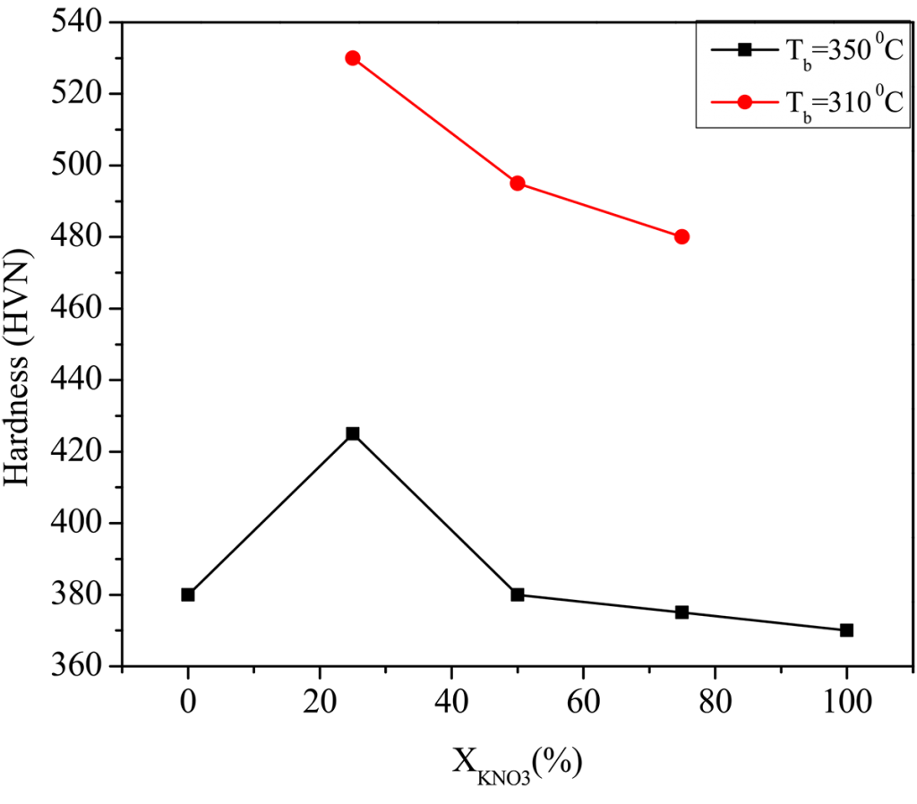

4.3 Steel Probe Quenching

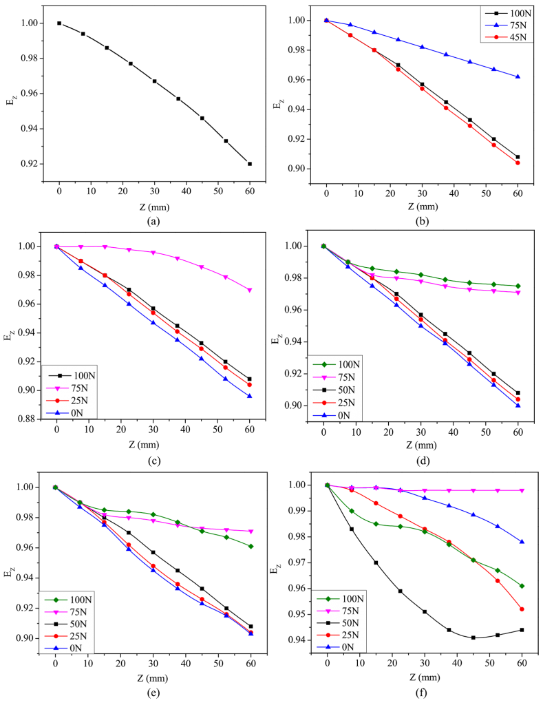

The reduction in hardness in the AISI 4140 steel probe quenched in 75 and 50 N quench media sustained at 310°C was ascribed to a considerable drop in the magnitude of qmax, as seen in Figure 7. Tmax increased, whereas qconv and Tconv did not alter significantly. The rise in the value of qconv was connected to the growth in the probe’s hardness quenched in 50 and 25 N quench medium. This stimulated the cooling rate all through the convective cooling stage, suppressing the bainitic transition of austenite. In this situation, increasing the value of qmax had no meaningful influence on the hardness of the steel portion.
Equation 8
The variation of qmax significantly influenced the steel probe’s hardness quenched in a Ca (NO3)2-KNO3 mixture, which was maintained at 350°C. The early occurrence of the convective cooling phase restricted the benefits that could have been achieved due to high qconv at higher concentrations of KNO3 in the molten bath. This is unlikely to take place in the molten bath maintained at 310°C and is indicated by the higher values of Tconv.
Figure 6: Contour plots for (a) Tmax, (b) qmax, (c) Tconv, and (d) qconv for different compositions and bath temperatures in the Ca(NO3)2–KNO3 mixture.

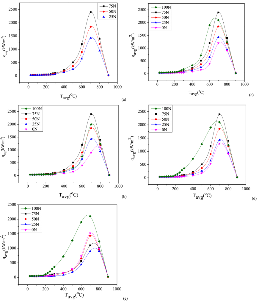

4.4. Uniformity of the Steel Probe Quenching Cooling
Equation 5 has been used to estimate the normalized energy at the interface between the metal and the quenchant. The energy extracted during quenching per unit area was determined by integrating the nodal quench heat flux over the first 50 seconds.
Equation 9
The unevenness in the heat removal across the surface of the probe is generally reflected in the spatial variation of the normalized heat energy (Figure 8). The quenched steel parts typically tend to experience nonuniform hardness and deficiencies because of this spatial variation. An increase in the KNO3 concentration in the molten bath resulted in a decreased cooling uniformity along the surface of the Inconel probe.

Figure 7: Hardness of the AISI 4140 steel probe in molten Ca(NO3)2–KNO3 mixture for varying composition of KNO3 at temperatures of 310 and 350°C, respectively.

Figure 8: Plots for normalized heat energy for the Ca(NO3)2–KNO3 mixture at temperatures of (a) 250°C,
(b) 300°C, (c) 350°C, (d) 400°C, (e) 450°C, and (f) 500°C.

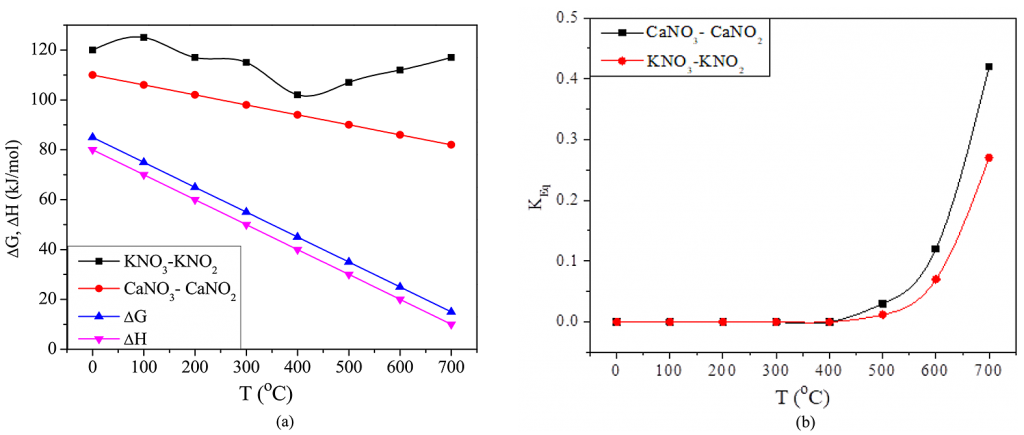

The variation in energy and enthalpy during the nitrite-nitrate reactions can be observed in Figure 9. Figure 9a shows the standard changes occurring in the decomposition of KNO3 were higher than that for Ca(NO3)2. Also, the decomposition of Ca(NO3)2 is more spontaneous than that of KNO3 for a given temperature. Due to this, the quenched Ca(NO3)2 eutectic mixture observes an extended boiling phase. As shown in Figure 9b, the equilibrium constant (Keq) for the decomposition of Ca(NO3)2 was higher than that of KNO3. All of this indicated that for a given temperature, the rate of decomposition, pressure, and surface temperature for Ca(NO3)2 was altogether higher than the KNO3 decomposition rate.
As the bath temperature increases, the nitrite-nitrate ratio also increases, and as per Equation 10, the nitrite salt resisted decomposition in the presence of nitrite in the molten bath. It is important to mention that, at the boiling phase, nitrite concentration increases close to the quench probe surface. This eventually leads to the formation of a concentration barrier that diminishes the decomposition rate of nitrites. Apparently, the end of the boiling phase occurs when the heat energy developed at the probe surface falls below the level required for nitrite decomposition.
Figure 9: (a) Variation in enthalpy and Gibbs free energy with respect to surface temperature. (b) Variation of the equilibrium constant for the decomposition of Ca (NO3)2 and KNO3.

The contour plots for varying qmax, Tmax, qconv, and Tconv were developed to analyze the cooling performance of Ca (NO3)2-KNO3 quench media for different bath temperatures.
