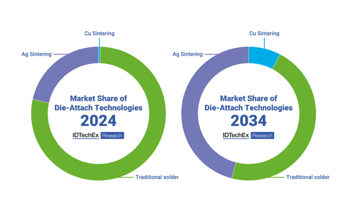

As of 2024, IDTechEx has not seen any large-scale adoption of Cu sintering technologies in EV power electronics, as Cu sintering is a much more difficult process, largely due to copper oxidation reducing the effectiveness of the bond. While copper has the potential to offer lower costs in the long run, as it is currently in the early stage of development, the copper sintering pastes are at a similar or even higher cost than silver sintering pastes. However, there are already a few companies (e.g., VW) that are testing Cu sintering. Despite the vague timeline, IDTechEx believes that copper sintering might start to get adopted by early- to mid-2025. (Figure 1)

IDTechEx asserts that innovations in die-attach technologies are crucial for ensuring effective thermal management in EV power electronics. However, given the cost-sensitive nature of the automotive industry, the adoption rates of Ag and Cu sintering technologies are significantly influenced by their expense. As of 2024, leading automotive OEMs such as Tesla, Hyundai, VW, and BYD have already begun adopting Ag sintering. With advancements in Cu sintering technologies, IDTechEx has observed several pilot projects underway, suggesting that commercial adoption of Cu sintering could commence soon. By 2034, IDTechEx projects that Ag sintering will capture about half of the market, although traditional solder alloys will continue to have a presence.
