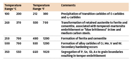

When steels are tempered between 200-350°C, the martensite precipitates cementite (χ-carbide) and any retained austenite transform to ferrite and cementite. These carbides are coarse and occur within the plates or laths of martensite. The retained austenite begins to transform above 200°C [3]. There is a slight decrease in toughness associated with tempering in the range of 250-400°C called tempered martensite embrittlement. The typical tempering reactions in steel are summarized in Table 1.
Table 1: Summary of tempering reactions in steel [4].
Tempering in the temperature range of 260-370°C (500-700°F) generally causes a decrease in toughness. This is observed by a reduction in the Charpy V-Notch impact toughness or the plane-strain fracture toughness (KIc). This decrease in toughness is referred to as tempered martensite embrittlement (TME) [5]. Another type of embrittlement, called temper embrittlement (TE), may develop in steels tempered above 425°C (800°F). It is often called 350°C or 500°F embrittlement.
