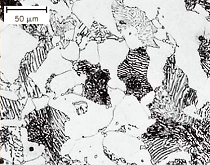

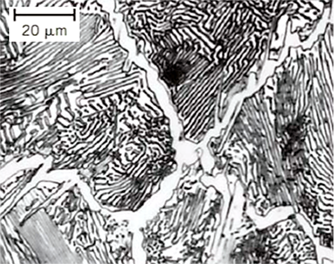

Pearlite is a lamellar mixture of ferrite (α-Fe) and cementite (Fe3C), typically formed during the slow cooling of austenite in steels. Ferrite is a relatively soft, ductile phase with a body-centered cubic (BCC) structure, while pearlite provides a balance of strength and ductility due to its composite nature [1]. In hypo-eutectoid steels, the microstructure at room temperature often consists of a mixture of ferrite and pearlite. In hyper-eutectic steels, the microstructure consists of a mixture of pearlite and cementite. These microstructures are shown in Figure 1.
Figure 1: Initial microstructures of common carbon steel: Left: Hypo-eutectic steel; right: hyper-eutectoid steel.

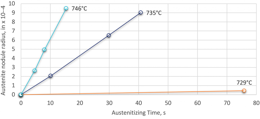

In general, finer pearlite and ferrite structures accelerate austenite formation due to shorter diffusion distances for carbon [6] [2]. Spheroidized cementite (rounded particles) dissolves more slowly than lamellar cementite, retarding austenite formation [2].
Figure 2: Austenite grain (nodule) radius as a function of austenitizing time at different temperatures [2].
As the temperature increases, the rate of transformation also increases (Figure 2). Slow heating allows for more uniform transformation and minimizes retained non-austenitic phases. Faster heating rates shift transformation temperatures upward and can lead to incomplete transformation if the holding time is insufficient for diffusion-controlled processes [3] [2] [7].
