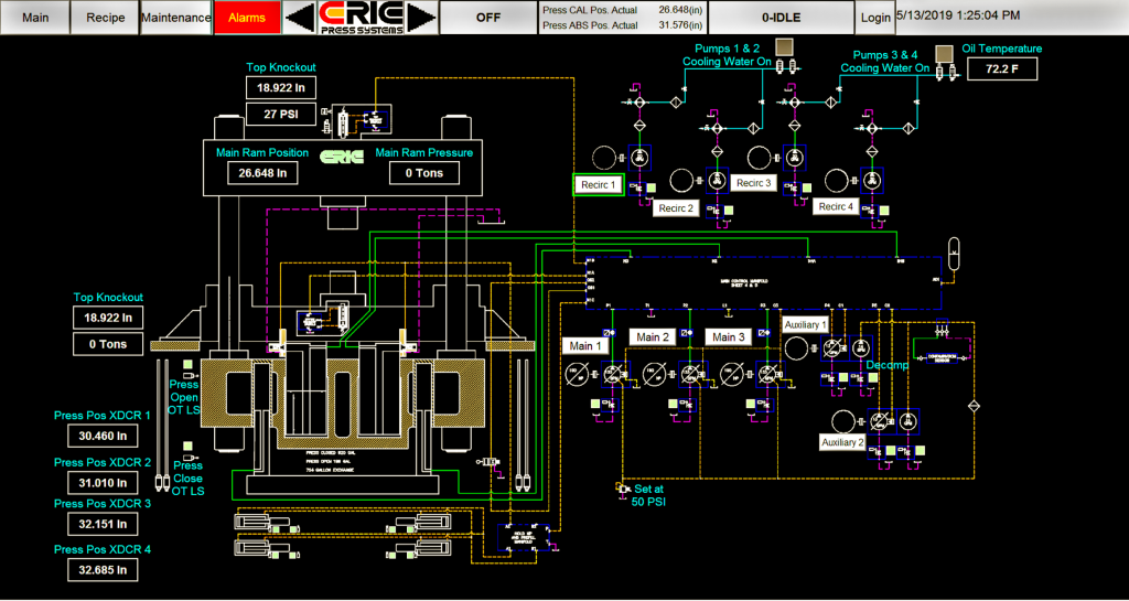

In addition, human-machine interfaces (HMIs) are transforming how operators monitor and control equipment. These graphical software tools replicate control panels and machine status, allowing users to observe operations on-site or remotely via smartphones, laptops, or PCs. Advanced HMIs offer dynamic schematics, animations, and trend data, enabling operators to compare actual performance to expected behavior.
Visual interfaces are especially helpful in training less experienced personnel as well. Live press positional and force data can be viewed as the machine transitions through the production cycle, and graphical windows into the control system allow quick identification of errors when something is out of sequence or stops unexpectedly.
In addition, touchscreen and menu-driven HMIs automate many routine tasks. Monitoring software also speeds diagnostics and allows remote troubleshooting and training support directly from the OEM.
